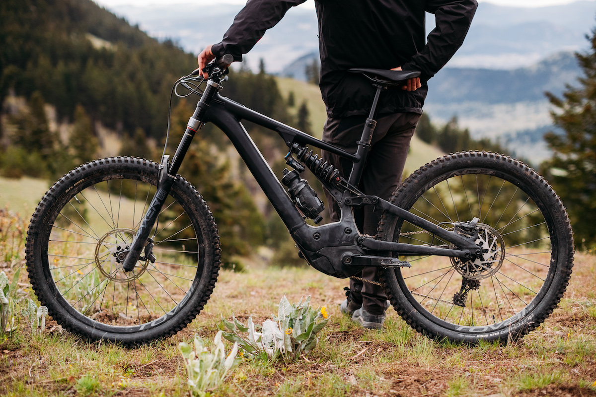

Stiffer, Lighter Frame

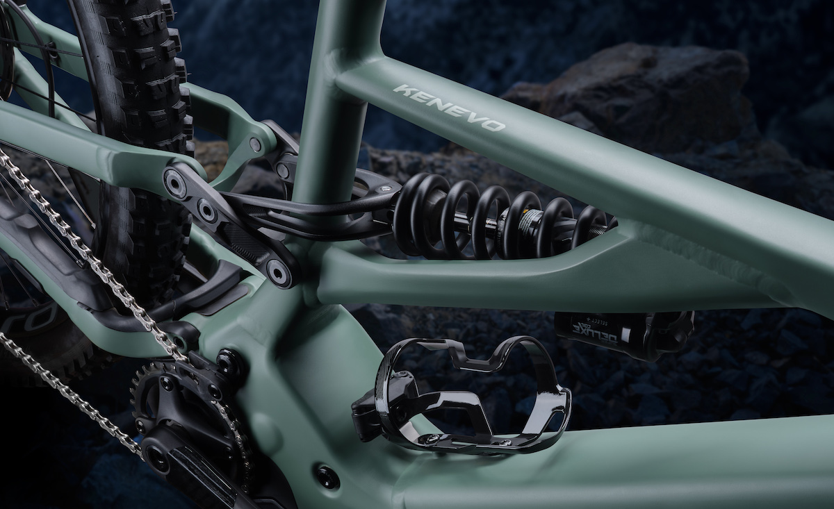

The Turbo Kenevo’s sidearm design directly connects all three mounting points of the rear-end and shock to the frame, significantly increasing both stiffness and performance over bumps. To be more specific, we’ve minimized frame flex when the rear suspension is active, so you get more precise handling in the rough.
We also took out the butcher knife and went nuts. The new Turbo Kenevo frame sheds a full kilogram (2.2 pounds). And that’s before you factor in the 400-gram weight savings from the new magnesium-bodied Specialized 2.1 motor.

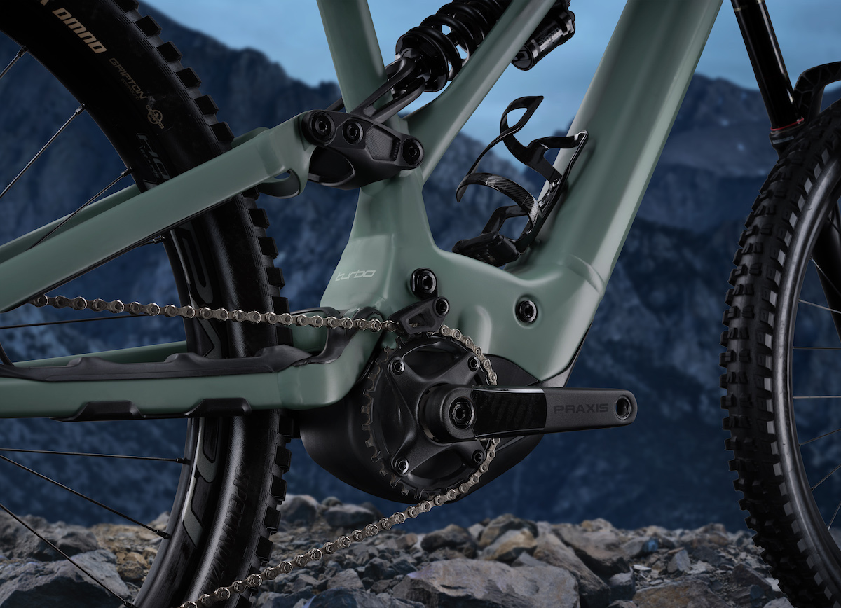

The Smoothest, Quietest, And Most Powerful Motor
When we debuted the latest-generation Turbo Levo, we also introduced the world to the smoothest, quietest, and most efficient motor out there. That same, magnesium-bodied Specialized 2.1 motor is directly mounted to the new Turbo Kenevo frame. The 2.1 motor is not only significantly lighter and smaller than the 1.3 motor that roosted on the original Kenevo, it’s also more efficient and powerful. How powerful? At peak assist, it’s like having four of you powering the pedals. You read that right: The Specialized 2.1 motor amplifies your input by 410%, while providing up to 560 watts of pedal-assist and 90Nm of torque with absolutely zero awkward surges in power.
Our 2.1 motor features a proven belt drive design and an integrated speedometer and power meter that measures speed and pedaling effort—all while precisely calculating power output. What’s more, our engineers in Switzerland spent years coming up with the Turbo Kenevo’s motor software, which is essentially the brain that powers this 2.1 motor. The result is something you’ll only find on the Turbo Levo and Turbo Kenevo—a motor that provides an incredibly smooth and natural boost to your own pedaling efforts.

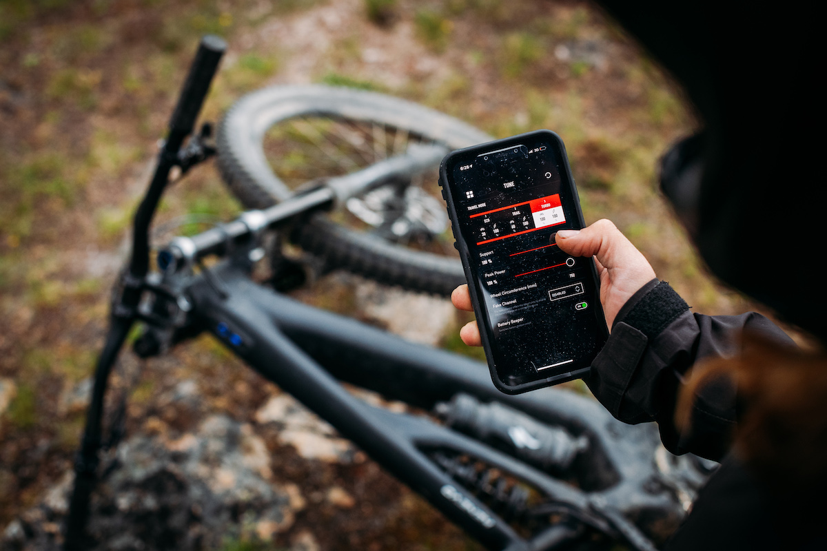

Customise Your Ride

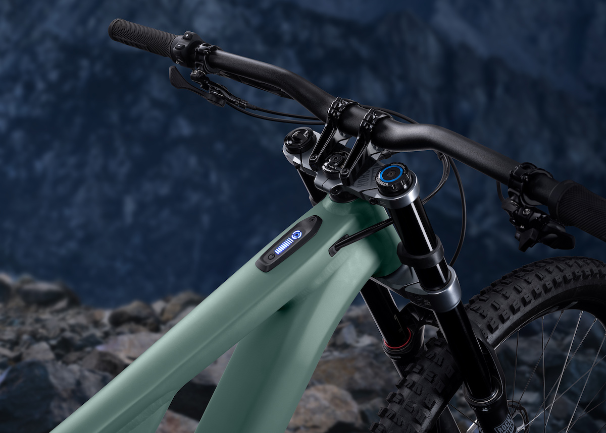

This Turbo Kenevo is even smarter and better connected than before. In the center of the top tube, you’ll find our Turbo Connect Unit that connects the bike, via ANT+ and Bluetooth®, to both the outside world and our Mission Control App. Speaking of which, we’ve added features and made Mission Control more intuitive.
You can easily customize motor characteristics, monitor your power use, control your range, perform basic system diagnoses, record and upload rides—and that’s just for starters. New to the app is our Shuttle Mode feature, which takes the sting out of long, painful climbs by giving you maximum motor support with less effort at the pedals. It’s perfect for the days when you want a fun and fast shuttle to the top.

11. Which rear shocks can I run on the Turbo Kenevo?
The Turbo Kenevo comes equipped with metric-sized shocks that use standard eyelets and no proprietary mounting hardware, so any 62.5 x 230 metric shock will fit the new Turbo Kenevo. Naturally, sticking with the same eye-to-eye length is critical to performance and safety but, as is the case anytime you decide to try on a new shock, you’ll also want to match the same basic rebound and compression damping tune listed on the shock body of your original shock.
12. Is this new Turbo Kenevo frame lighter than the previous frame?
Definitely. The new Turbo Kenevo frame features a significantly lighter down tube and motor mount. This enabled us to reduce frame weight by 1 kilogram (2.2 pounds) with the new design while also improving stiffness and sheer capability. The Specialized 2.1 motor on the new Turbo Kenevo also offers a 400-gram (.88 pound) weight savings over the Specialized 1.3 motor featured on the first-generation Turbo Kenevo model.
13. What’s the overall weight of the Turbo Kenevo? Did it lose weight overall from first generation to second generation?
Complete bike weight is actually on par with that of the first-generation Turbo Kenevo. The new Turbo Kenevo Expert weighs 24.58 kilograms (54.1 pounds). The new Turbo Kenevo Comp weighs 23.63 kilograms (52 pounds). In short, we lightened the frames and motors with this new generation of Turbo Kenevo, and then added weight back with a far more capable component package that boosts this bike’s performance in the roughest terrain.
14. What’s better on the new Specialized 2.1 motor?
First of all, we made the new Specialized 2.1 motor significantly lighter. By making the motor housing out of full-magnesium and mounting the motor directly to the frame, we were able to cut a tremendous 800 grams of weight. 400 of those grams come from eliminating the motor mount bridge, while the remaining 400 grams come from weight savings on the actual motor (the new motor weight is three kilograms). Our new 2.1 motor is also 15% smaller than the previous generation, while still being more efficient and even more powerful. It now amplifies the rider input by 410% (1.3 motor: 380%), providing up to 560 watts and 90Nm of torque.
In short: Our new 2.1 motor is better across the board, while still featuring time-proven technologies like a belt-drive and an integrated speedometer/power meter that measures speed and pedaling effort to precisely calculate power output.
15. How much lighter/smaller is the new 2.1 motor than the 1.3 model on previous Turbo Kenevo’s?
We covered some of this above, but to recap: The new 2.1 motor is 400 grams lighter than its predecessor, yet it’s more powerful, efficient, and 15% more compact. The majority of the weight savings can be chalked up to the lighter, full-magnesium motor housing and the elimination of the motor mount bridge.
16. How much weight did you cut by going to the new direct motor mount?
Since we eliminated the motor mount bridge and are directly attaching the motor to the frame, the direct motor-to-frame mounting cuts another 400 grams out of the bike.
17. How were you able to make the new motor mount a reality?
We first designed the Turbo Kenevo chassis to give riders the best possible trail riding experience, then we codesigned the motor mounting system with the manufacturer of our motors, who also helped to shape the motor specifically to the Turbo Kenevo’s chassis design. This ground-up approach enabled us to entirely remove the large (and heavy) frame forging that the motor connected to on the first-generation Turbo Kenevo and aluminium Turbo Levo models, while still ensuring the best possible frame geometry.

32. What’s so great about the Specialized Mission Control App?
Our Mission Control App provides riders with full control over their Turbo Kenevo. It allows you to fully customize the motor settings to the personal needs and preferences, diagnose the bike and extract a report, record/save/analyze rides, upload rides to third-party platforms, and even get control over your range via our Smart Control feature.
33. Which operating systems does the Mission Control App support?
Our updated Mission Control App is still supporting iOS and Android operating systems. You simply have to go to either the Google Play or Apple App Store, search for Specialized Mission Control, download the app, and register yourself. Once you’ve done that, you’re set to get more out of your Turbo Kenevo.
34. What kind of improvements have been made to the Mission Control App?
We developed our Mission Control App completely from scratch, and it now comes with a bunch of exciting improvements. First and foremost, we designed a completely new user interface for the app, which is more intuitive to navigate through. We’ve also added new features into the app, like the “Stealth Mode” that allows you to turn off the LED lights on the TCU (if preferred), or the “Shuttle
Mode” that lets you access maximum power output with less pedaling force (if desired). And last but not least, we made the app more stable and reliable
