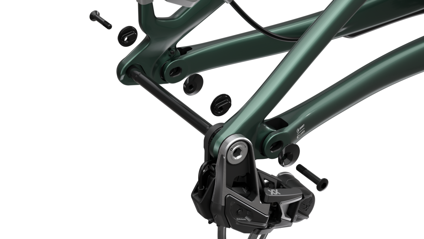

The geometry is highly adjustable. A three-position head tube, two-position bottom bracket, and chainstay flip chips allow riders to fine-tune the setup to their terrain and style. In its stock configuration, the S4 sits at a 65-degree head angle, 77-degree seat tube angle, 480mm reach, and 339mm bottom bracket height.
The geometry is highly adjustable via a three-position head tube, two-position bottom bracket, and chainstay flip chips, but the more interesting story is how it compares with the Levo 4, and how this translates on the trail. The Levo R sits shorter and lower overall, with a steeper head angle, less trail, and a bottom bracket 11mm closer to the ground. That translates directly into quicker steering, a lower centre of gravity, and a more planted feel through corners. The longer chainstays bias weight rearward to maintain traction on steep climbs. As a geometry package it feels agile and responsive without sacrificing control.

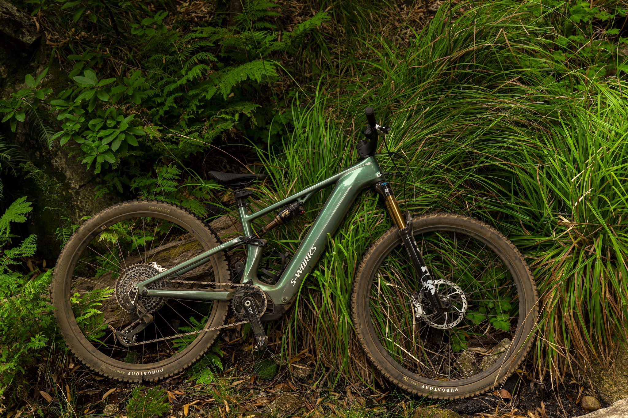

- Turbo 3.1 motor with up to 850 W peak power and 111 Nm torque (S-Works)
- FACT 11m carbon frame – 530 g lighter than Levo 4
- 140/130mm chassis with dedicated 29-inch wheels
- GENIE suspension technology with Rally-specific tune
- Highly adjustable geometry (head tube, BB, chainstay flip chips)
- Modular battery system: 600Wh, 840Wh, or up to 1,120Wh with Range Extender
- SWAT downtube storage (Wattage Cottage)
- MasterMind T3 display with MicroTune assist control
- Smart Charger achieves 0 – 80% in under an hour
- Connected via Specialized App with OTA updates, Strava/Garmin integration, and Apple Find My

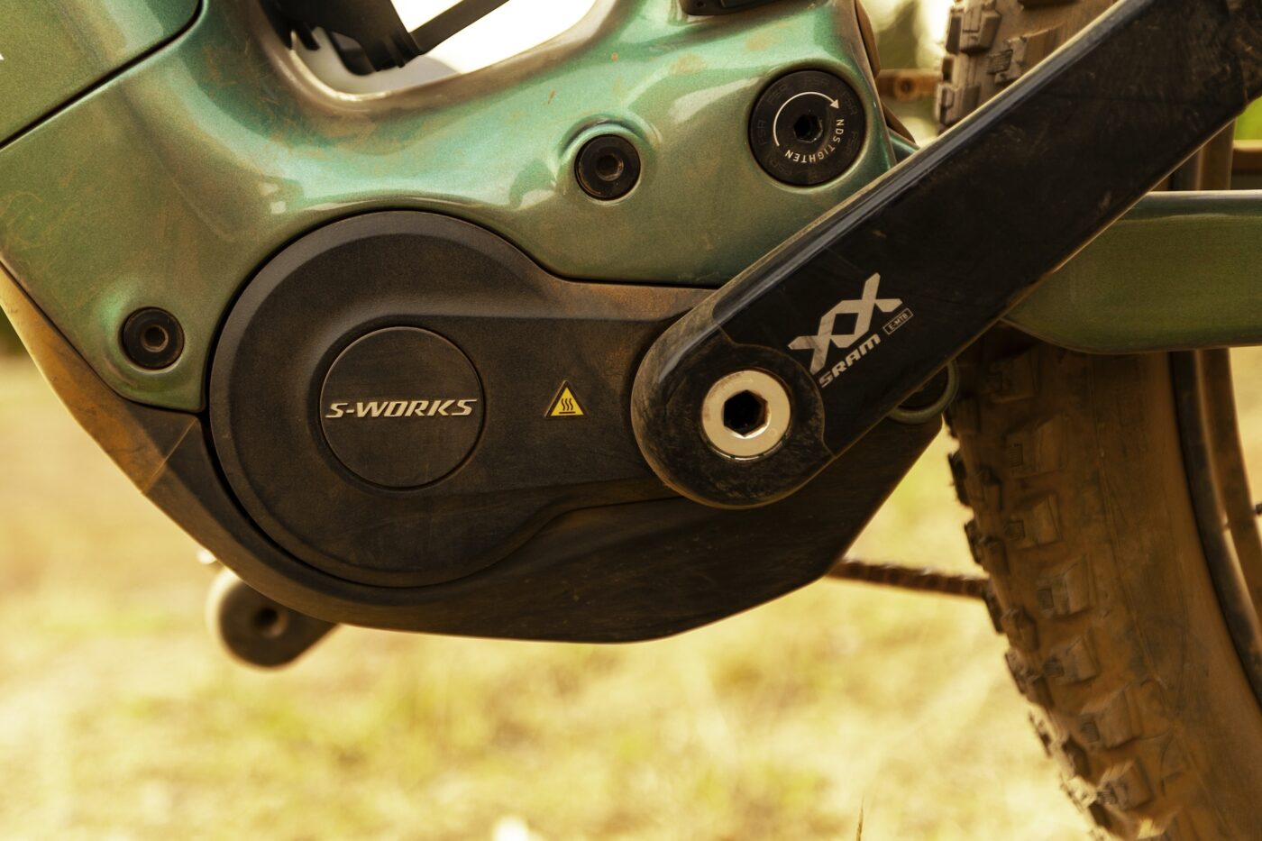

Super Power
SuperNatural Power Delivery
Levo R masters previously impossible climbs, low-speed technical terrain, and high-speed situations with up to 850 watts of peak power and 111 Nm of intuitive, SuperNatural amplification. It is the difference between riding it and eating it. The Turbo 3.1 system amplifies rider input with precision that preserves traction and balance, delivering smooth torque at low cadence, confident control at speed, and the ability to climb steep, loose terrain where others lose traction.
S-Works models: 850 W / 111 Nm. Other models: 810 W / 105 Nm.

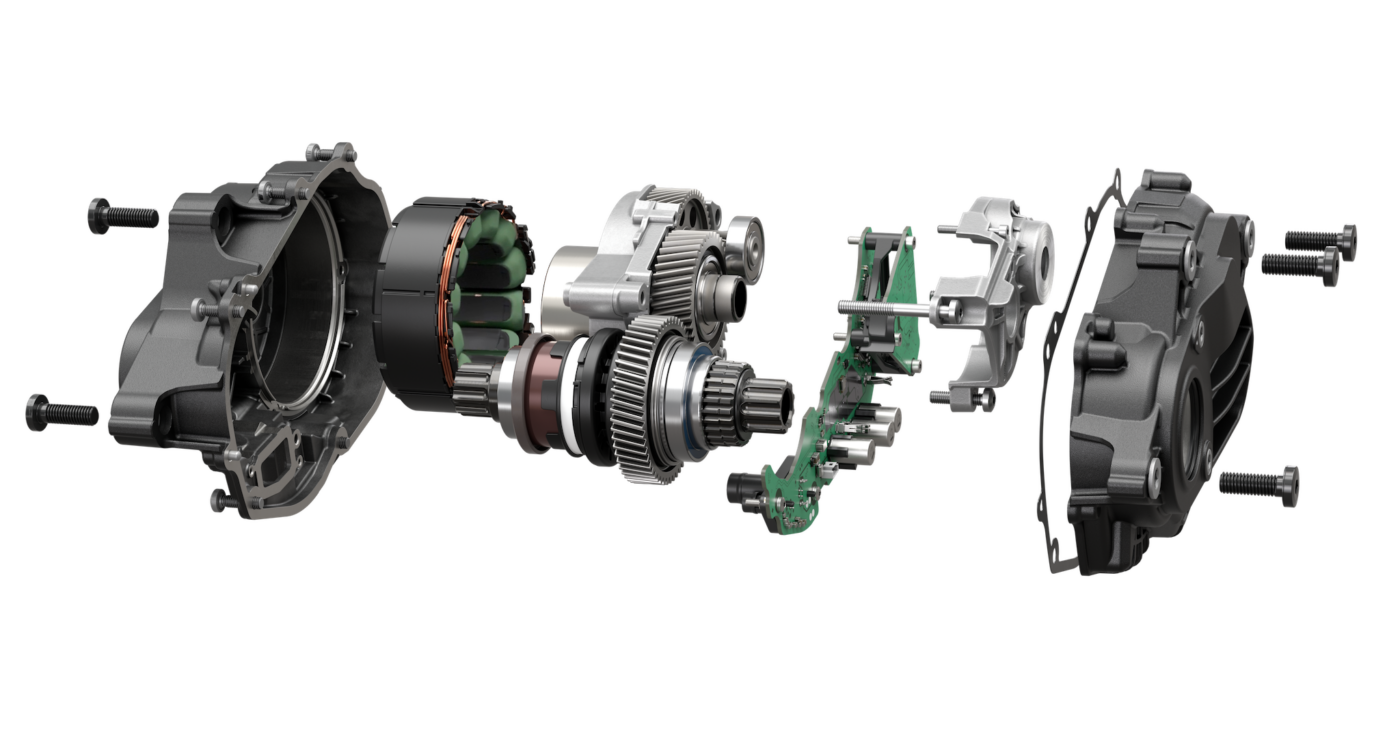

Super Durability and Efficiency is an Inside Job

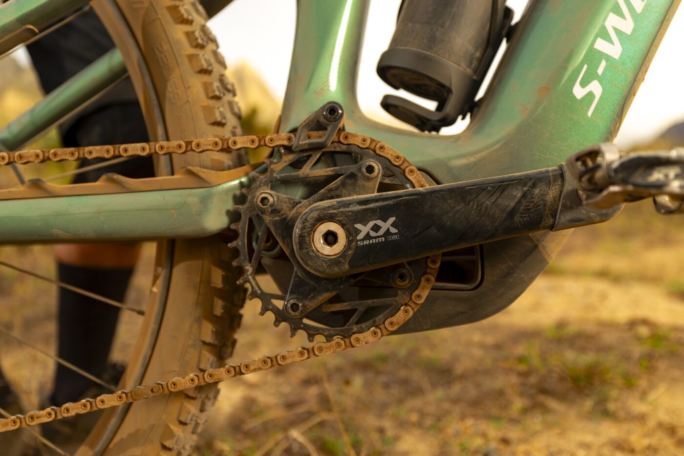

Durability, efficiency, and the signature Levo purr come from full-metal gears with HardDrive coating and a decoupled drive side housing. CoreCoat further quiets the motor and keeps it cool.
- CoreCoat winding encapsulation enhances heat dissipation, boosts durability, and ensures ultra-quiet, reliable performance.
- 2X larger, full metal gears are less susceptible to heat expansion, delivering consistent performance throughout the ride.
- HardDrive surface treatment creates an ultra-smooth, hardened finish on gears, ensuring long-lasting, efficient, and quiet operation.
- Motor mechanism is completely decoupled from the driveside housing to minimize structure-borne vibrations for quieter, more refined performance.

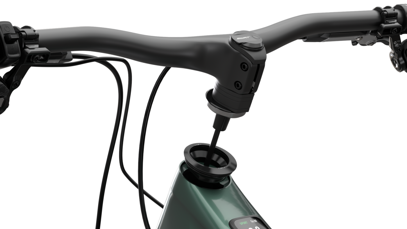

Adjustable Geometry for Those Who Like to Tune
The Levo R geometry delivers an exceptional ride right out of the box, combining capability with nimble manners in tight sections. Riders who love to fine-tune can easily personalise their geometry:
- Headset Angle: Steep (+1°) / Middle / Slack (-1°) — set the head tube angle steeper for sharper steering or relaxed for greater stability.
- Chainstay: Short (-6mm) / Long — adjust the wheelbase for stability with a longer setting or enhanced manoeuvrability with a shorter one.
- Bottom Bracket: Low / High (+5mm) — adjust to a high position for better clearance or low for stability.

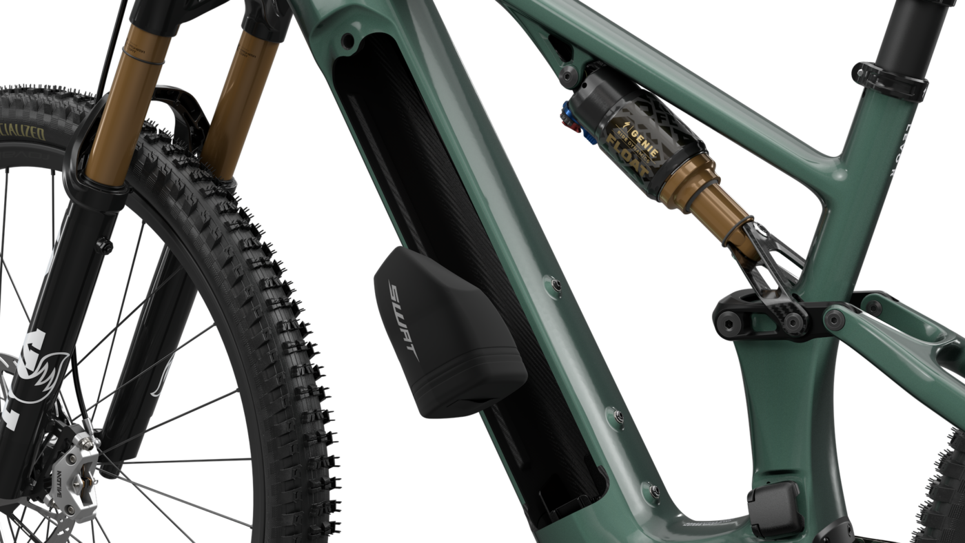

SWAT Downtube Storage
Stash your trailside fix-it kit in the downtube Wattage Cottage. Specialized pioneered internal downtube storage, and now they’re the first to bring it to an e-MTB. Secured above the battery magnetically, the SWAT bag holds trailside essentials like a tube and CO2. Swap in the smaller aftermarket 600Wh battery for extra space for a jacket or other gear.

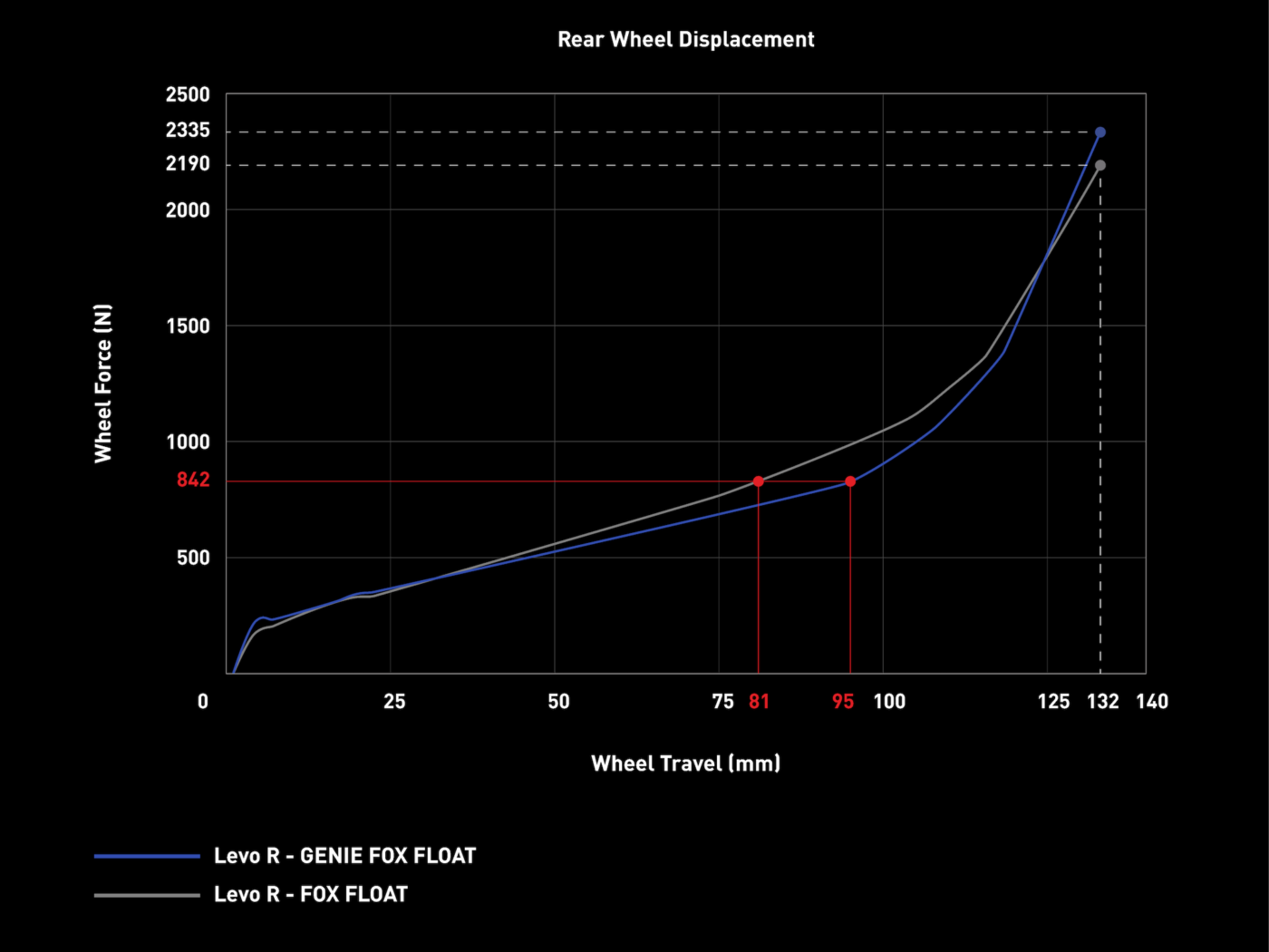

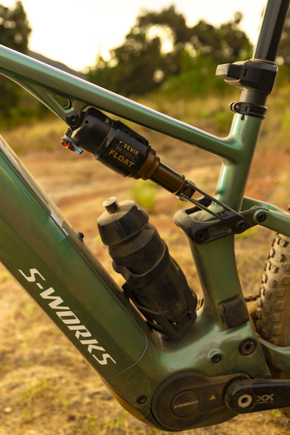

The patent-pending GENIE system returns with a Rally-specific tune. The FOX FLOAT GENIE delivers a flat, coil-like spring curve through the first 70 percent of travel, followed by a progressive ramp-up in the final 30 percent. The result is improved traction, consistent support, and controlled bottom-out resistance.
The Proof is in the Wheel Rate
GENIE suspension technology delivers control-enhancing, linear performance of a coil spring in the “bump zone,” paired with a progressive spring curve at the end of the stroke to prevent bottom-outs.
The GENIE FOX FLOAT shock on Levo R delivers more travel compared to a standard FOX FLOAT for the same bump force, ensuring superior control, traction, and a more comfortable ride. Simply put: GENIE rides like a longer-travel bike.
At 842 Newtons of force at the rear wheel, GENIE delivers 17.3% more travel: Levo R with GENIE FOX FLOAT achieves 95mm of travel versus 81mm with a standard FOX FLOAT. At the same time, GENIE requires more force to bottom-out — keeping you in control when the trail gets rough.

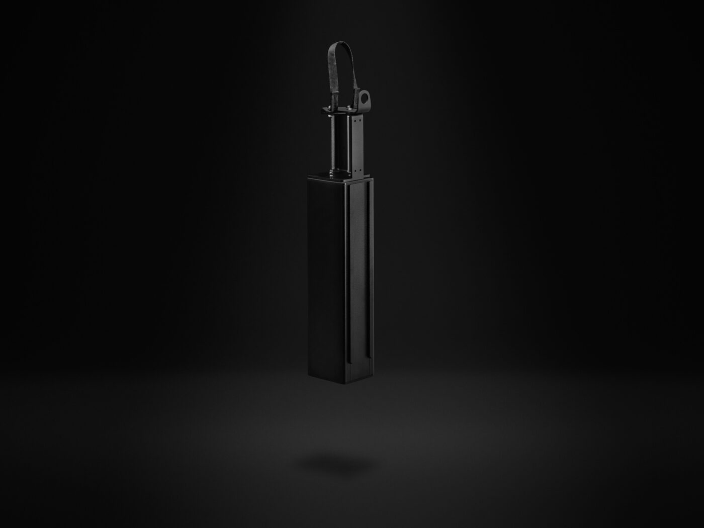

Levo R’s modular battery system allows riders to balance weight and range. The stock 840Wh battery powers extended missions. The aftermarket 600Wh battery delivers a lighter, more agile setup. Add the 280Wh Range Extender for rides extending beyond four hours. All batteries meet IP67 water and dust resistance standards.
Configurable Power System
Batteries swap quickly through the Wattage Cottage side hatch. The system automatically recognises battery capacity and adjusts Smart Control and MicroTune parameters accordingly. Configure the system to match the mission, not the other way around.
- 1,120Wh On-Board: ~3.75 hours max range
- 840Wh Battery: ~2.5 hours max range
- 600Wh Battery: ~1.5 hours max range

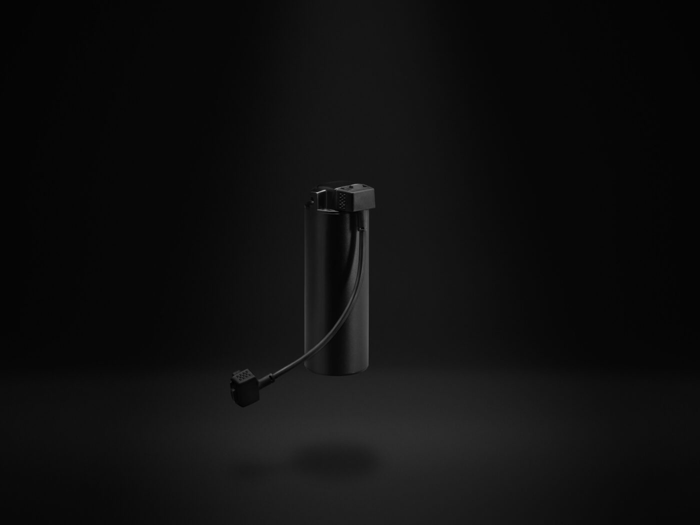

- 280Wh Range Extender

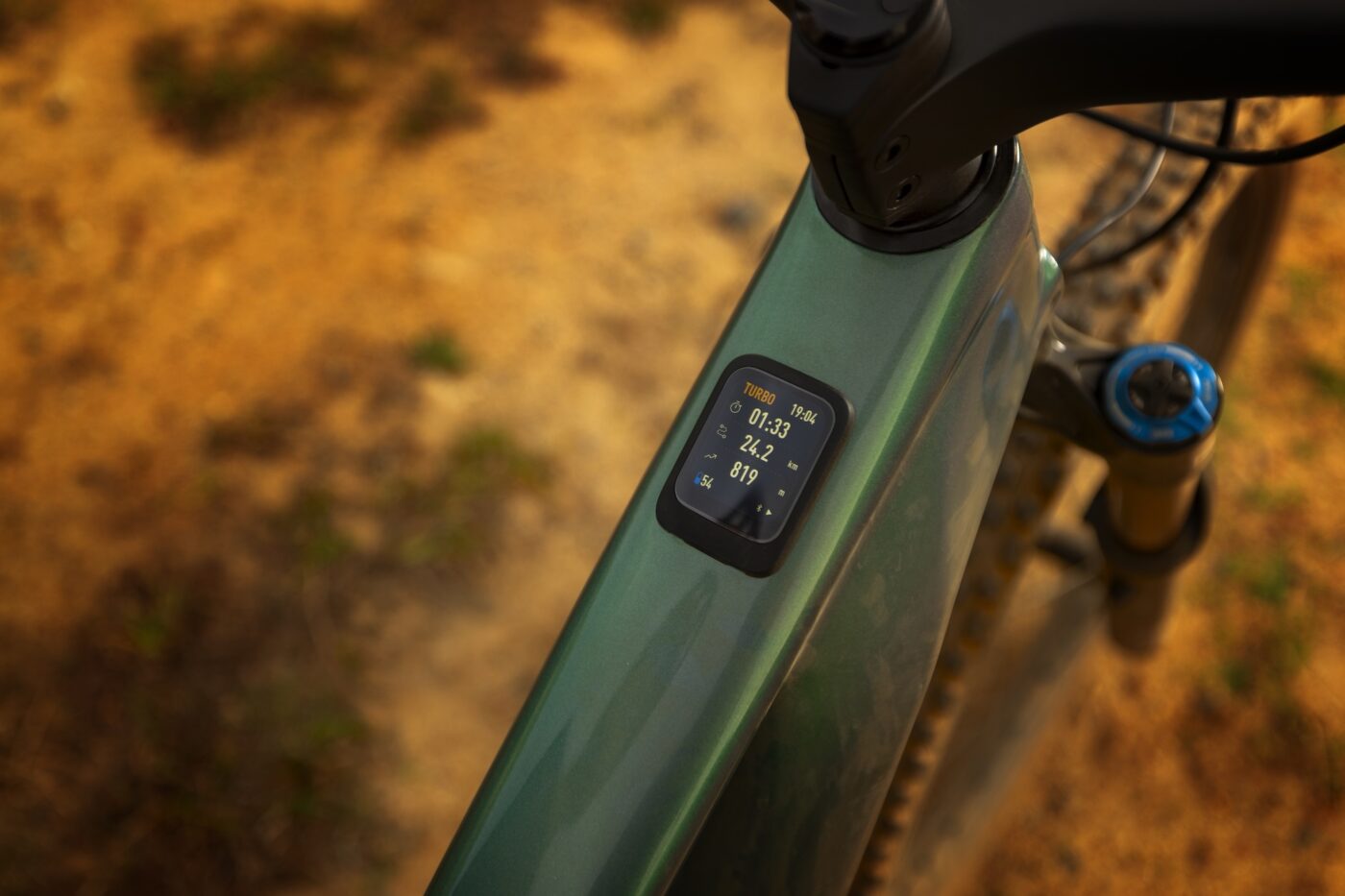

MasterMind T3 — The Big Brain
The 1.78-inch MasterMind T3 display delivers high-resolution clarity with 368 x 448 pixels of customisable, real-time data. Paired with Levo R’s Rally motor tuning and battery options, it functions as a digital co-driver, helping riders manage effort, output, and range.
MicroTune Control
Adjust assist levels in 10 percent increments on the fly. Dynamic MicroTune provides automatic access to full power during hard accelerations, maintaining efficiency while preserving immediate response when needed.

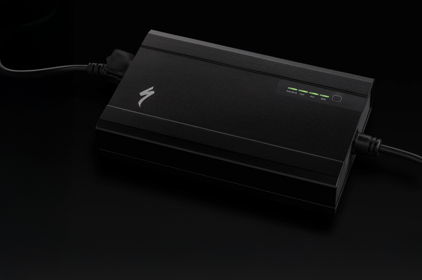

The standard 5A charger delivers 0–80 percent in 90 minutes. The optional 12A Smart Charger (included with S-Works models) achieves the same in under an hour. Efficient thermal management and battery tuning ensure long-term health without slowing riders down.
