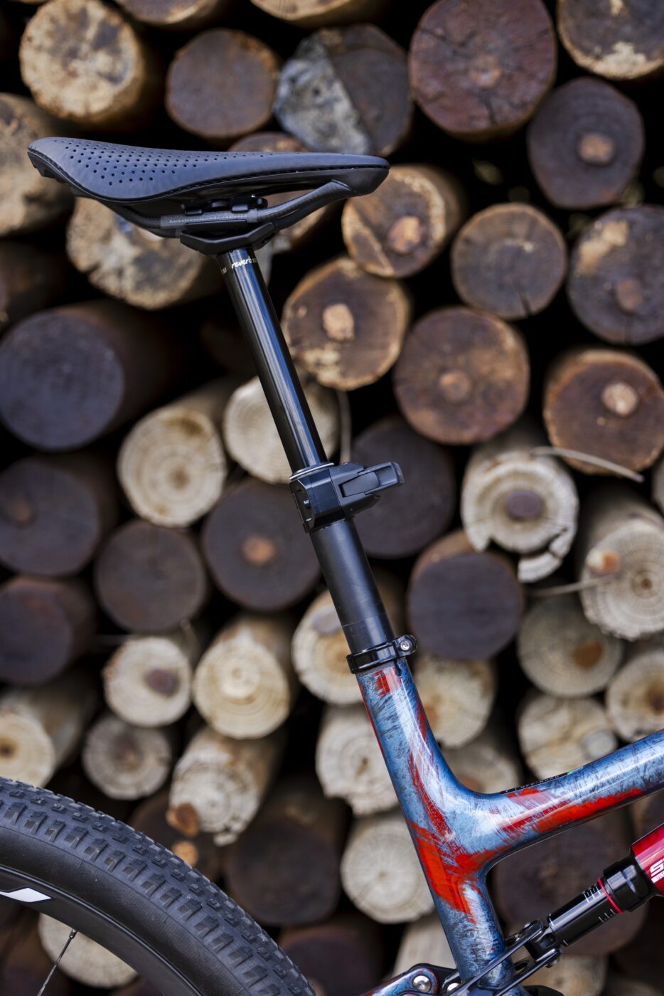

After the prologue Matt changed his seat post from the Reverb AXS to the standard carbon post, depending on the stages, noting: “I can feel that the carbon post is lighter when I stand”. Interestingly, the Reverb AXS seat post appears to be a whole new design from SRAM.

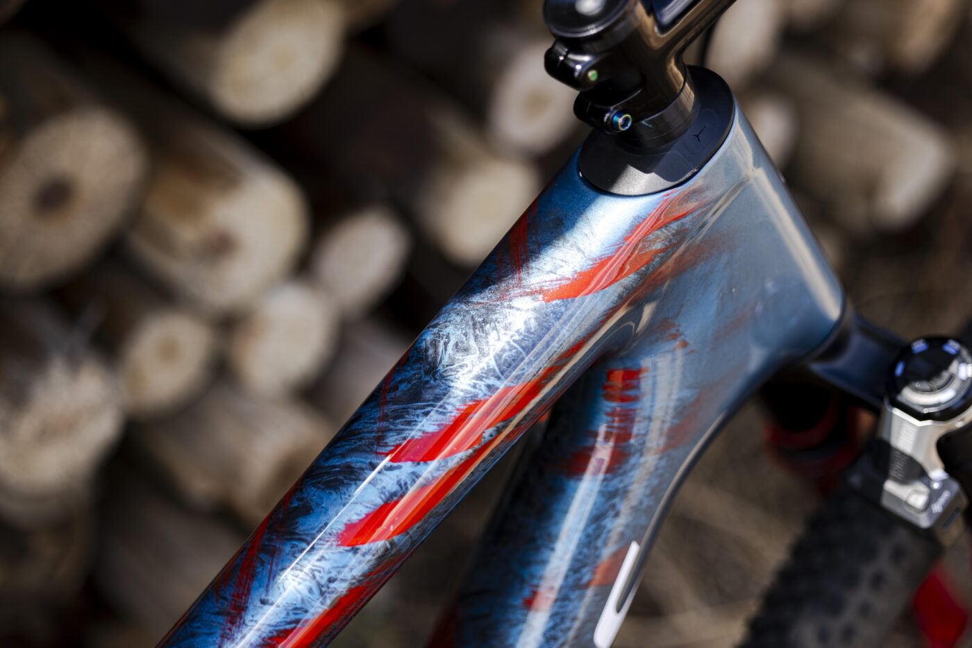

| Frame | S-Works FACT 12m Carbon, Progressive XC Race Geometry, Rider-First Engineered, SWAT downtube storage, threaded BB, 12x148mm UDH compatible rear dropout, 120mm of travel, Optimised for wireless drivetrain and seatpost |

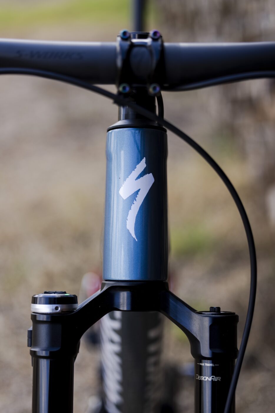

| Fork | RockShox SID ULTIMATE Flight Attendant, Ride Dynamics developed 3 position, Debon Air, 15x110mm, 44mm offset, 120mm Travel. [Matt was changing the DOT fluid mid week for a firmer climbing setup and this was micro tuned with the Flight attendant suspension.] |

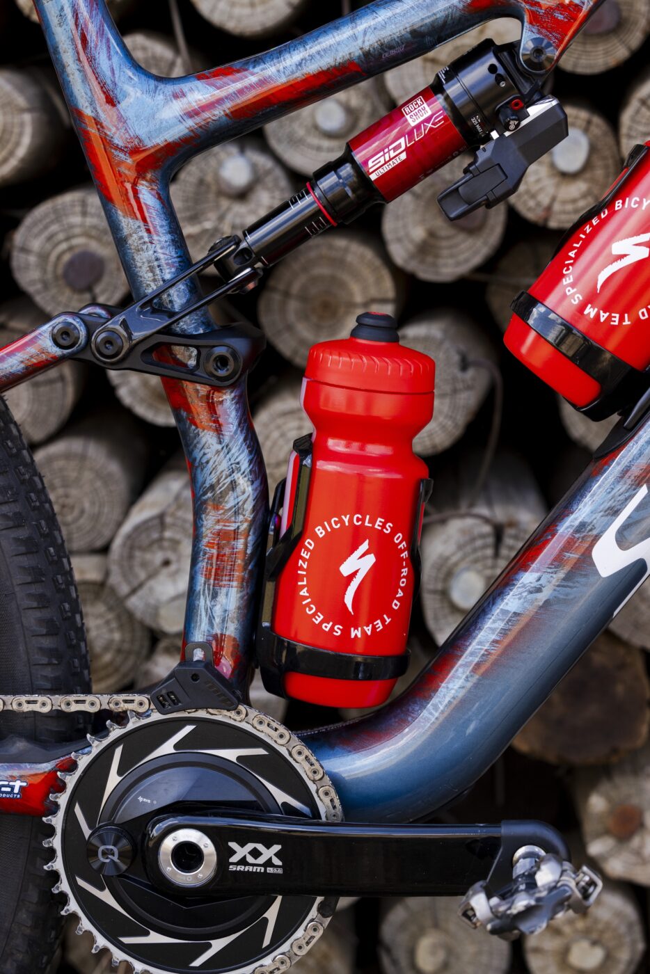

| Shock | RockShox SIDLuxe ULTIMATE Flight Attendant, Ride Dynamics developed 3 position, Solo Air, 190x45mm |

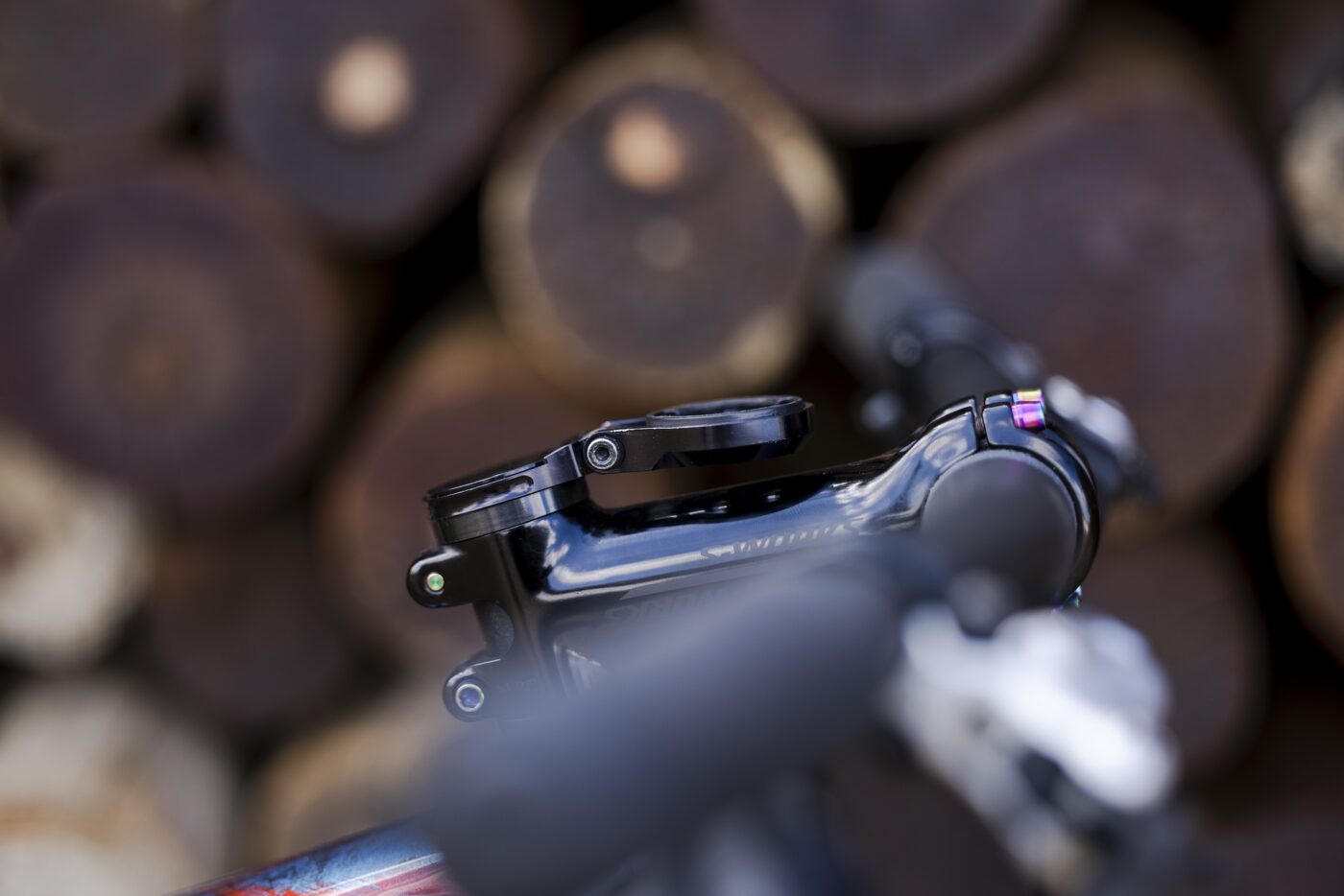

| Stem | S-Works SL, alloy, titanium bolts, 6-degree (Same as Alpinist Stem) |
| Headset + top cap | Epic 8 Stop Top Cap – Computer mount. |
| Seatpost | RockShox Reverb AXS & Specialized Carbon 34.9, Titanium Bolt |

| Rear derailleur | SRAM XX SL Eagle AXS |
| Cassette | SRAM XX Eagle AXS |
| Crank arms | SRAM XX SL Eagle Power Meter Crankset, 175mm |
| Chainring + size | 40T [Changed per stage] |
| Chain | SRAM XX SL Eagle |
| Bottom Bracket | SRAM DUB, BSA 73mm, Threaded |

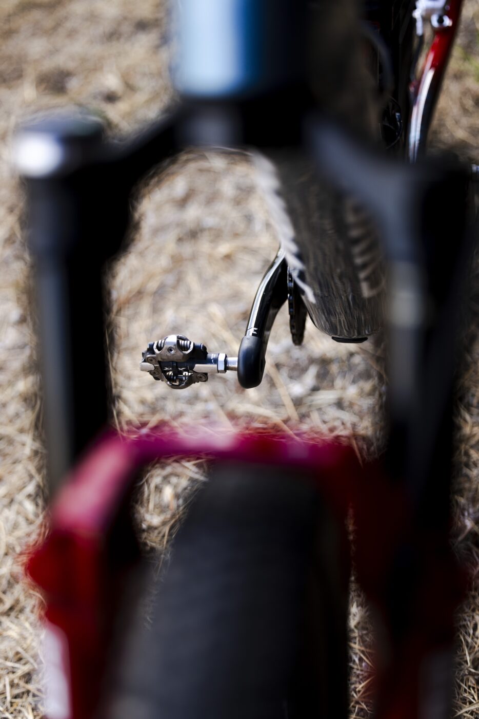

| Pedals | Shimano XTR with a cable tie on the centre axle area. |
