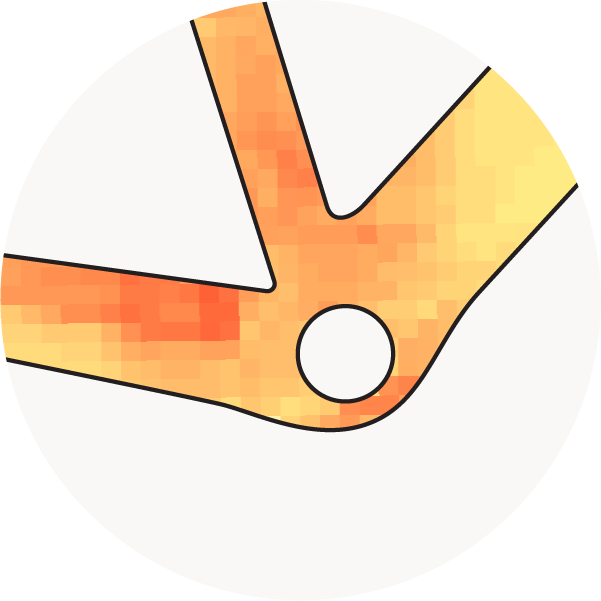

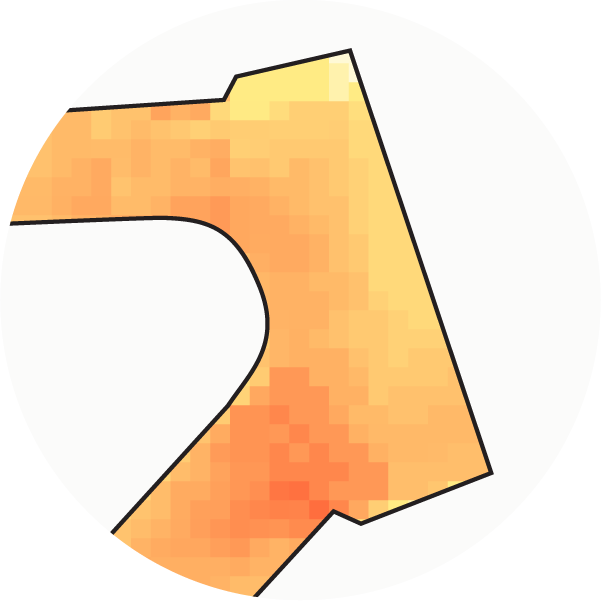

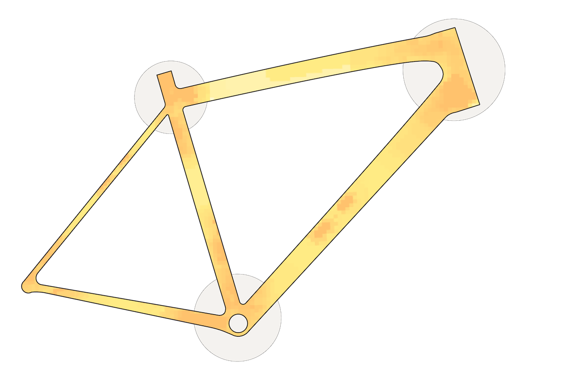

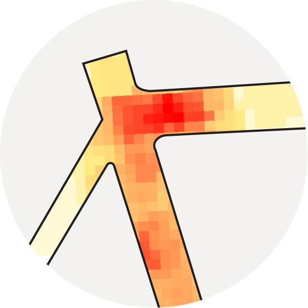

We know that shape contributes to the vast majority of a bike’s performance, and that’s why Aethos was born from a “Eureka” moment in the test lab. Our engineers studied the flexing and breathing of carbon frames in the pedaling test rig, and they realized the industry’s understanding of how forces flow through a frame was incomplete and ripe for massive improvements. We used staggeringly large supercomputer simulations—more than any humans can do in a lifetime—to subtly alter round tube shapes. This made their shapes more conical in key areas to deliver huge gains in stiffness and balance with the minimum amount of material. There’s nothing extra here except more stability and integrity.
Just so we’re clear, this is a shape story of how and why the shapes work within this bike. The outcome of Aethos represents an entirely new way of designing bikes. Why’s this really cool? Because it will shape how we build all of our bikes moving forward.
No Lazy Fibers
Now, if the vast majority of the frame’s performance is dictated by shape, then the remainder plays itself out in the actual materials used and the manner in which they are connected—the frame’s layup.
Continuing to study how these frames move under load helped determine that there were too many “stiffness layers” (or extra plies) added in the creation of traditional frames. So, with these new tube shapes, we needed an entirely new way to lay-up frames. Thankfully, it’s one which resulted in reducing the number of needed plies by 11% compared to the S-Works SL6 (which was known for being pretty damn great already). By utilizing larger, longer, and more continuous, unbroken plies, we were able to achieve more consistent positioning than on any frame we’ve made before.
The interesting thing to note is that the wall thicknesses of the tubes, themselves, are substantial throughout the frame, but because of the smaller number of the stiffness layers, the overall weight went down significantly. The only thing along for the ride should be you.

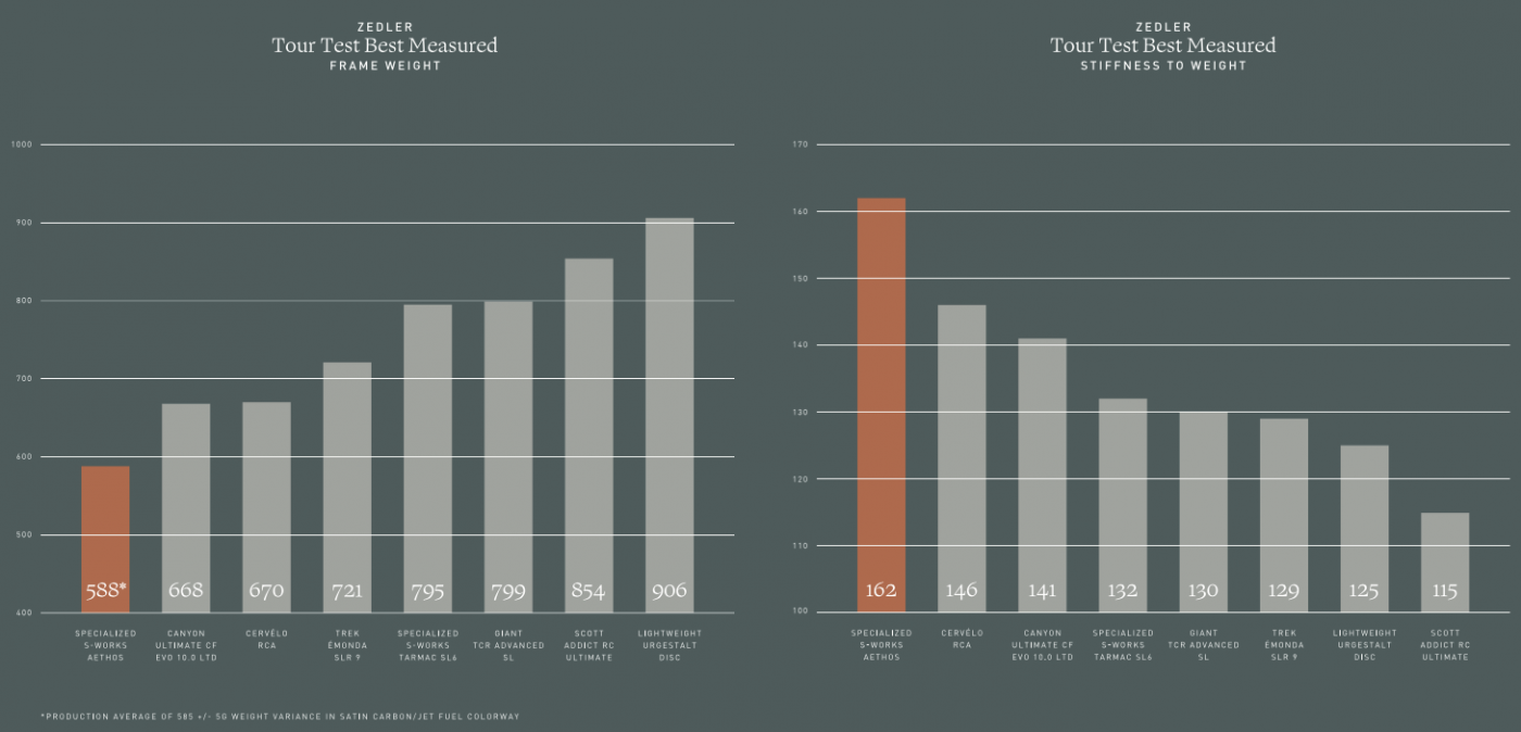

The first frame was 545 grams. We put it on the test machine and the frame behaved so beautifully—it was so stable. We only had to add 10 grams, and we could test-ride the frame. That was the moment we knew we had discovered something big.
AETHOS ENGINEERING LEAD Peter Denk
Stiffness To Weight Number Defines Efficiency
Accidentally Illegal
We chased ride quality with Aethos, not a number. That said, we know a light, stiff, and balanced bike is magic at the pedals. The result, however, is the lightest disc road frame ever produced, with no gimmick builds and a weight as light as 5.9kg. Aethos is very illegal in some racing circles, yet it’s still rated for a 275-pound rider and possesses all the telepathic handling, response, and stiffness targets that you’ve come to expect from every bike we make. (Psst – don’t tell the UCI).

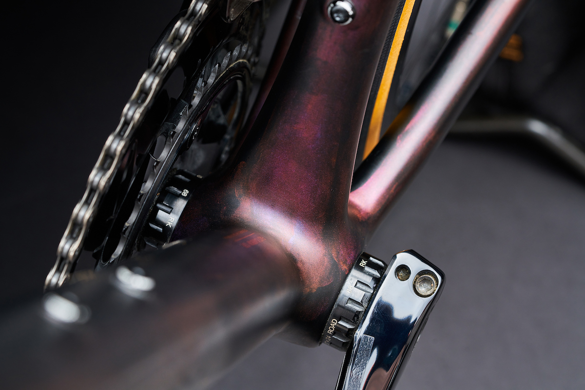

ccs-62657-0-33266500-1602156547.jpgThreaded Bottom Bracket

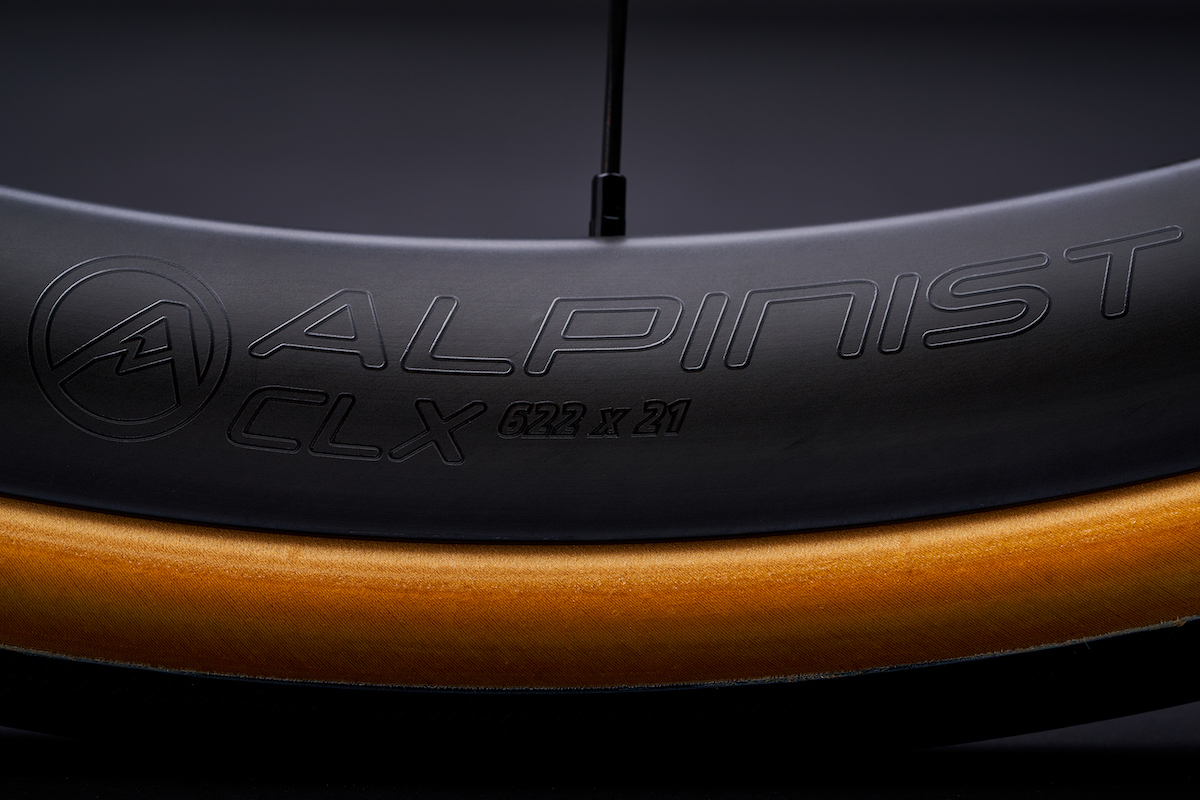

ccs-62657-0-20739400-1602156841.jpgAlpinist CLX

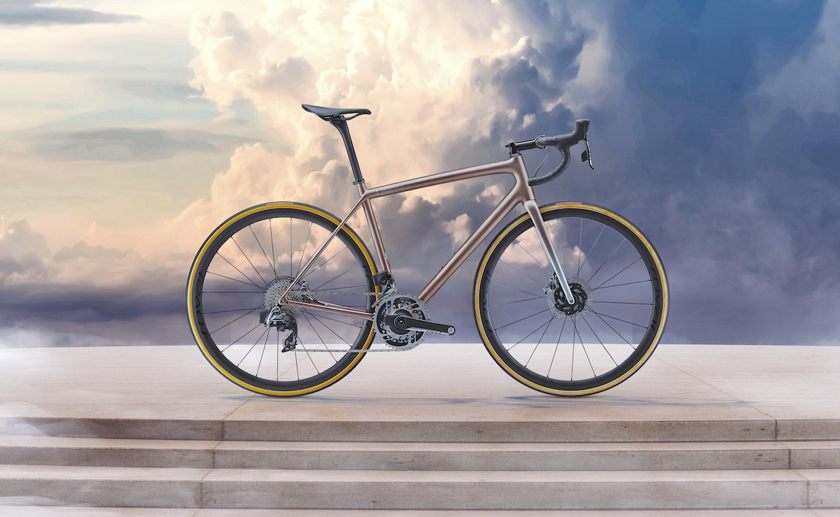

How much does the Aethos weigh?
The S-Works Aethos uses our most premium FACT 12r material and layup to achieve a painted frame weight of 585g in the lightest colorways.
The complete out-of-the-box weight of the S-Works Di2 model is 6kg in the Carbon/Chameleon Red Gold colorway.
What about the different colourways?
The lightest frame colorway is the Satin Carbon/Jetfuel that weighs 585g. Other colorways will add roughly 25g (like Satin Carbon/Chameleon Red Gold or Satin Carbon/Gloss Black Chrome) to 45g (like Gloss Clay/Flake Silver or Satin Flake Silver/Chameleon Red Gold) more.

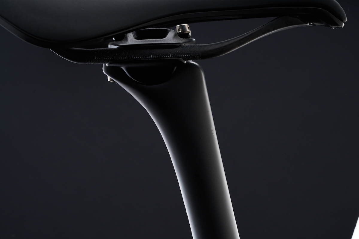

What offset will the Roval Alpinist seatpost come in?
The Roval Alpinist seatpost is available in a 12mm offset and in 300mm and 360mm lengths. All complete bikes and framesets will be spec’d with this Roval Alpinist post.
