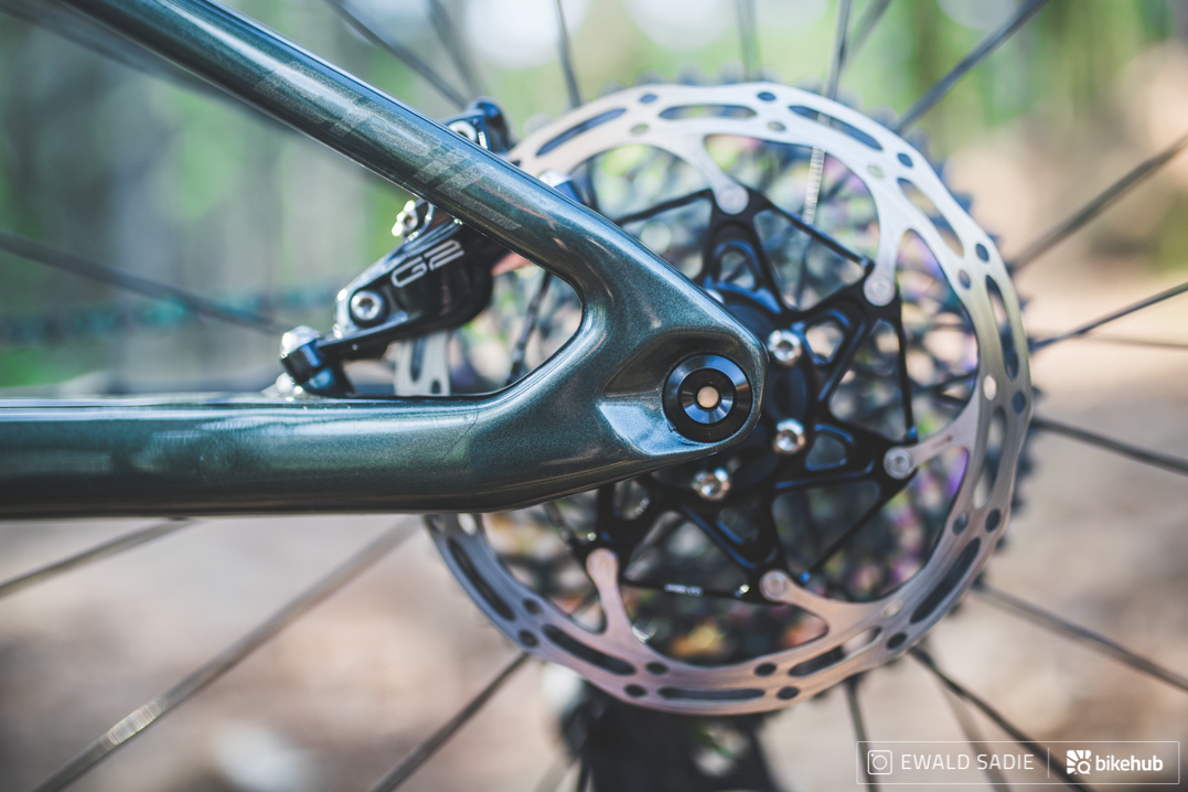

The New Rear Triangle

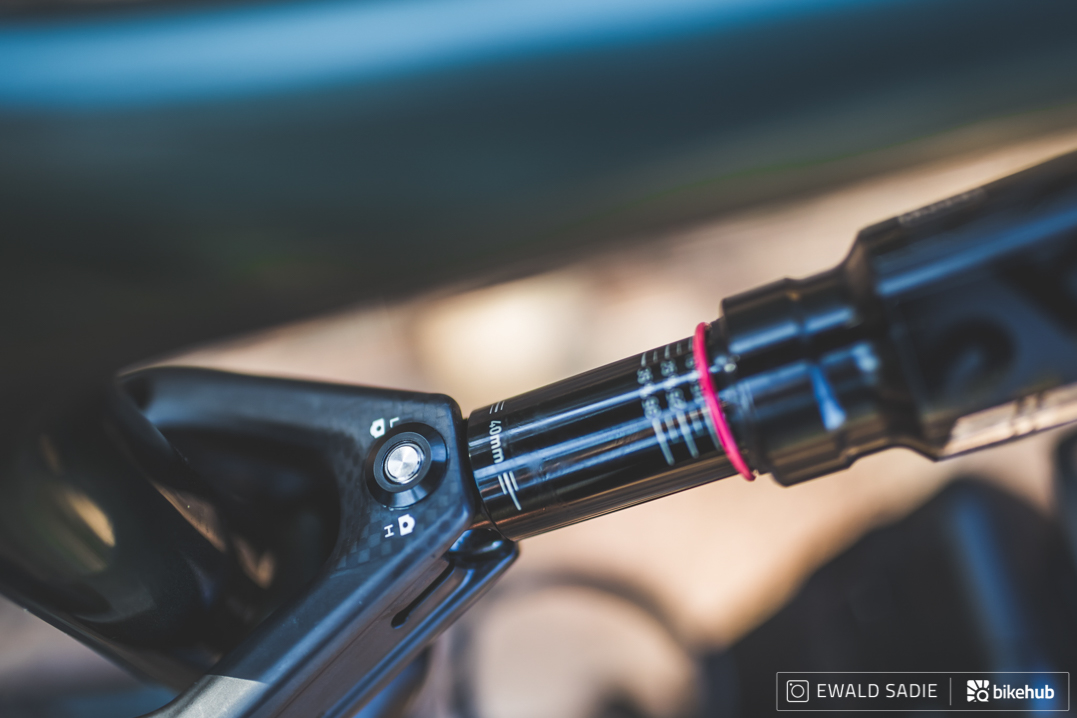

The Epic Evo is designed around an all-new 110mm suspension system which pairs with a 120mm travel fork. The front triangle is the same as the Epic but the rear is a unique design specifically tailored to the Evo’s broader riding style. To the casual observers, the most notable changes from the Epic are the separation of the shock from the seat stay via an additional link and the absence of the Brain system.

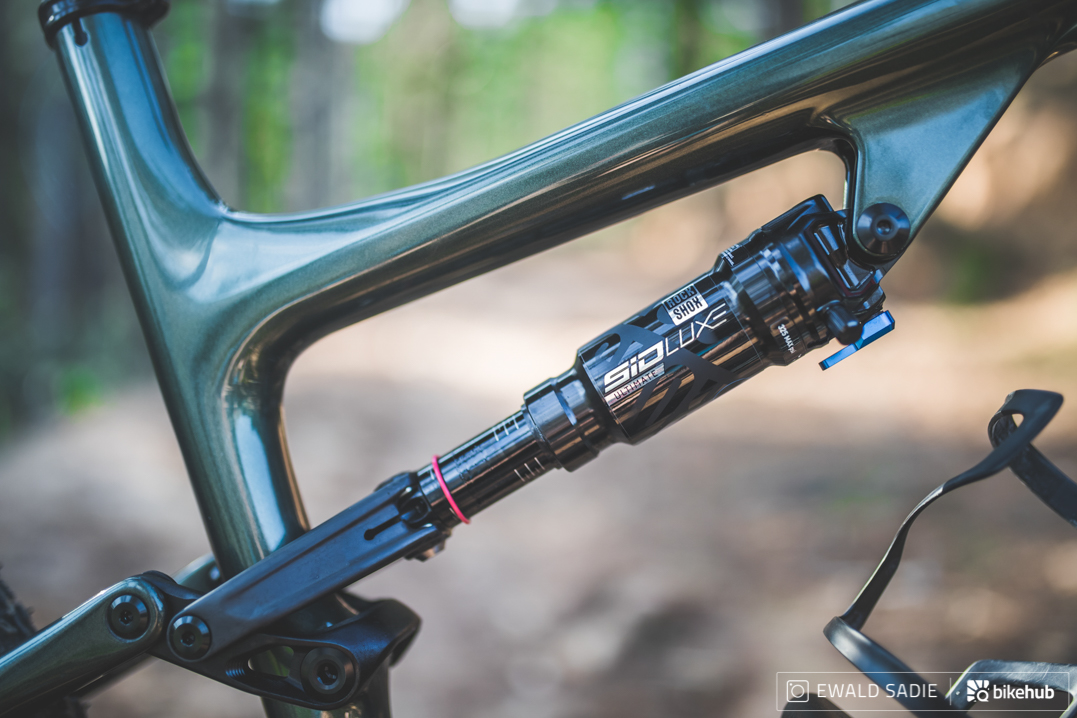

The Brain system has been swapped for a metric shock. The shock has undergone Specialized’s custom Rx tuning but, unlike the Brain shock, you can have it serviced by your local suspension mechanic. In fact, there are no proprietary designs or parts on the Epic Evo frame meaning any bike shop can fully service the bike.
If you do really want the Epic EVO components but on an Epic frame with a Brain, the new Epic is approved to take a 120mm fork as the front triangles are identical across the two models. Your local bike shop should be able to replicate the Epic EVO components on a new Epic for you.

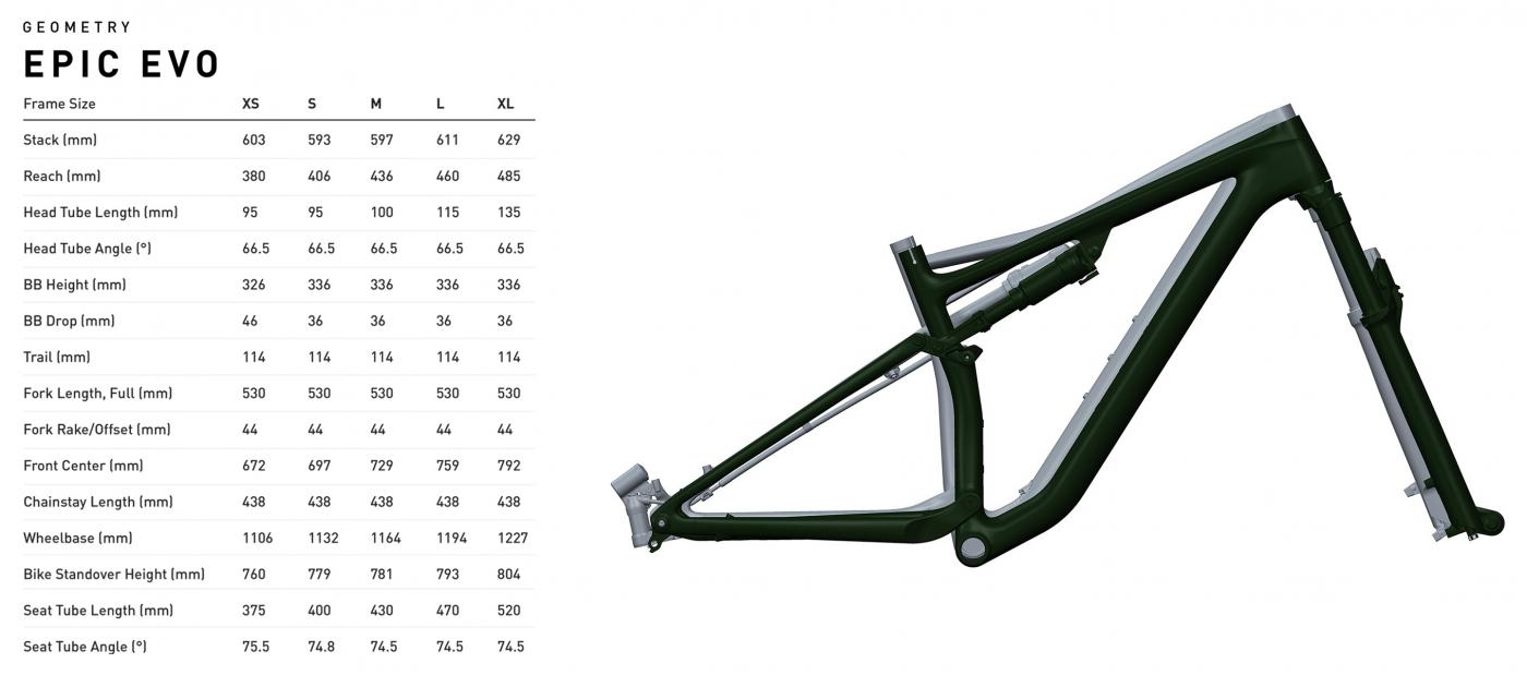

Geometry
The Evo’s 66.5-degree head angle is one-degree slacker than the new Epic and two degrees over the previous Evo. Combined with a lower bottom bracket height, the new Evo is set to be more composed on the trails. The seat angle has been steepened by ¾ of a degree to improve pedalling efficiency. The Evo also has a FlipChip to steepen the angles by half a degree and bring the bottom bracket up by 6mm to sharpen the handling and increase clearance.
ccs-62657-0-59386300-1592923713.jpgLeft: The Epic Evo geometry chart. Right: The new Epic Evo frame profile versus the previous Epic Evo.

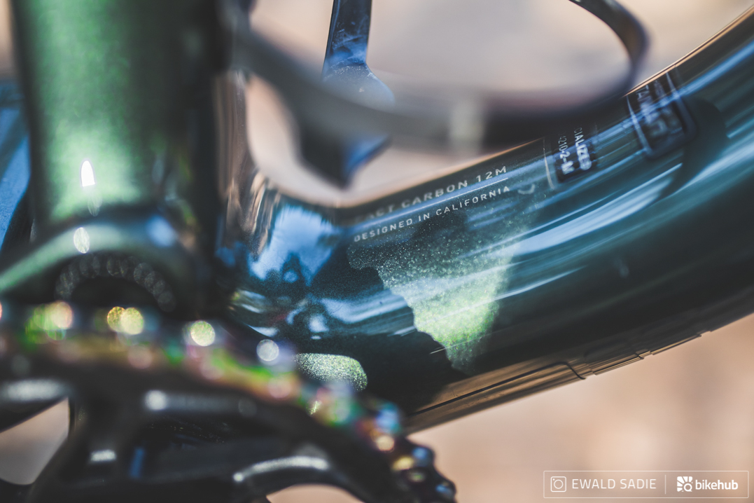

The S-Works frame is constructed from FACT 12m carbon materials while the rest of the carbon frames in the range make use of FACT 11m carbon for the same stiffness and weight gains as the current S-Works frames. Without the Brain system, the Epic Evo frame is actually a couple hundred grams lighter than the race-orientated Epic frame. Yes, I know what you’re thinking but mountain bikes are not all about weight, the Epic still pedals more efficiently.
The S-Works Evo Fact 12m frame weighs 1659 grams while the Epic Evo Pro FACT 11m frame weights 1757 grams. These measurements include frame, shock, hanger, axle, and bolts.

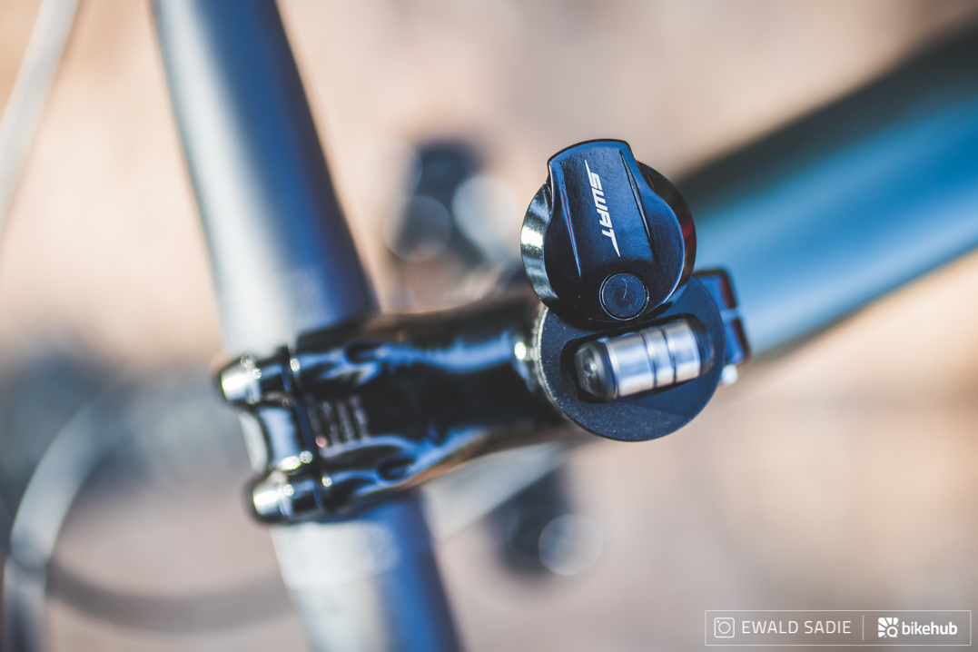

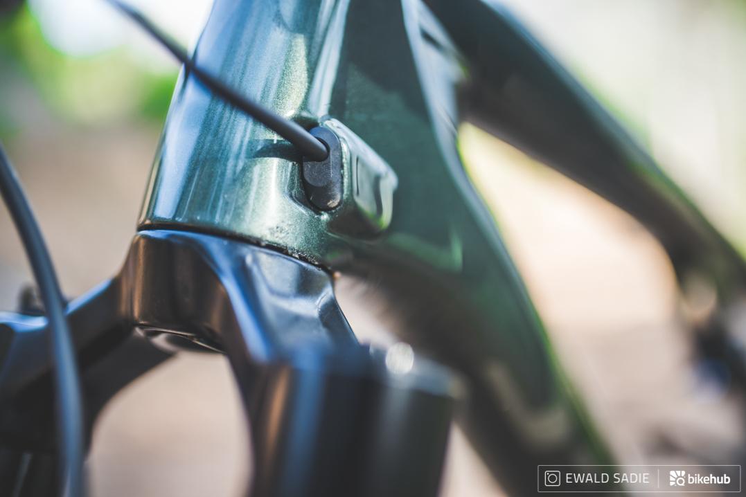

Maintenance and Frame Protection

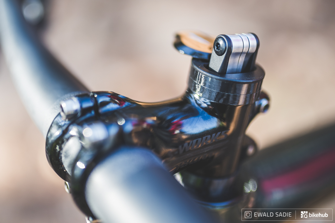

With electronic shifting and dropper post, our S-Works Epic Evo test arrived with an internal routing cable port for only the rear brake. This can be increased to accommodate shifter and dropper post routing with other ports where applicable. There is also routing for a cable shock lockout should you desire although you’re going to need to buy a different shock. The bottom bracket is BSA 73mm, so it’s threaded for easier maintenance. The chainstay protector features the raised sections first seen on the Stumpjumper and they work exceptionally well to rid the bike of any chain slapping sound.

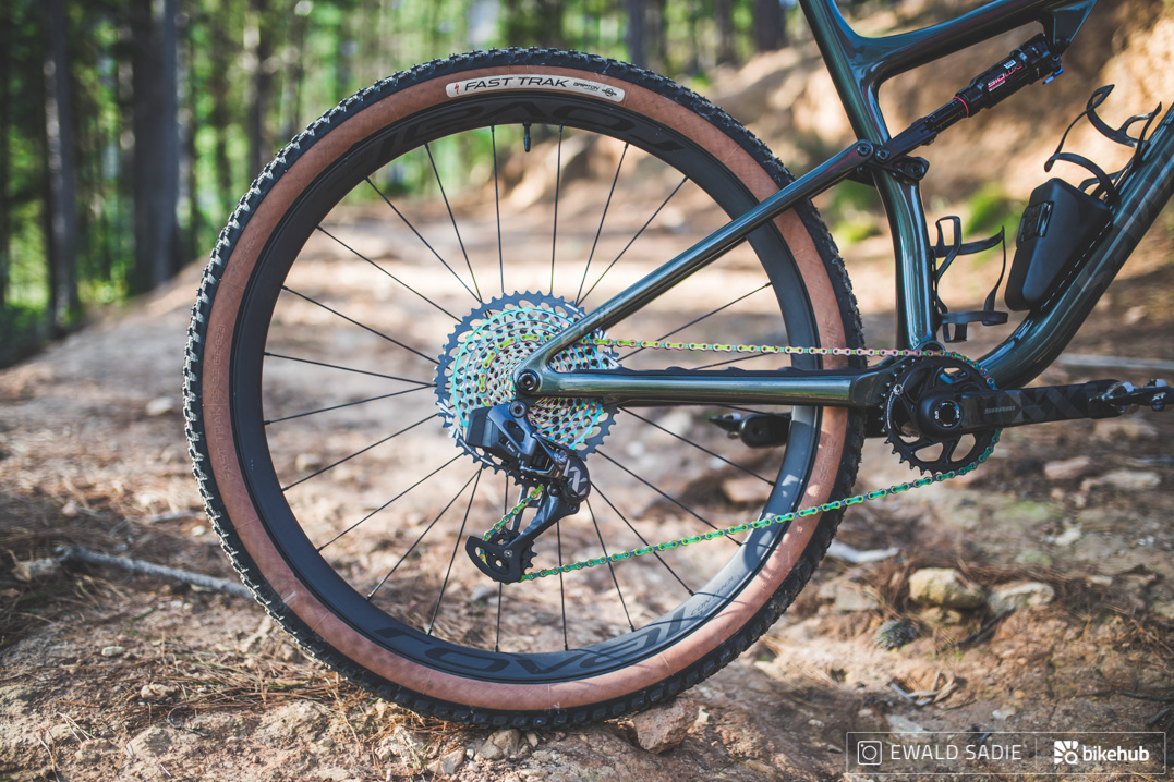

Through the model line-up the Epic Evo formula features a 120mm fork, a dropper seat post, 4-piston brakes, and the Ground Control / FastTrak tyre combo.
Our test bike was the S-Works model featuring some of the best goodies available. The one component that exceeded expectations is the Roval Control SL wheels. They are impressively light, suitably wide, and use DT Swiss’s excellent ratchet hub internals. As I said in the S-Works Epic review, the new Control SL is the best light-duty mountain bike wheelset that I’ve ridden.

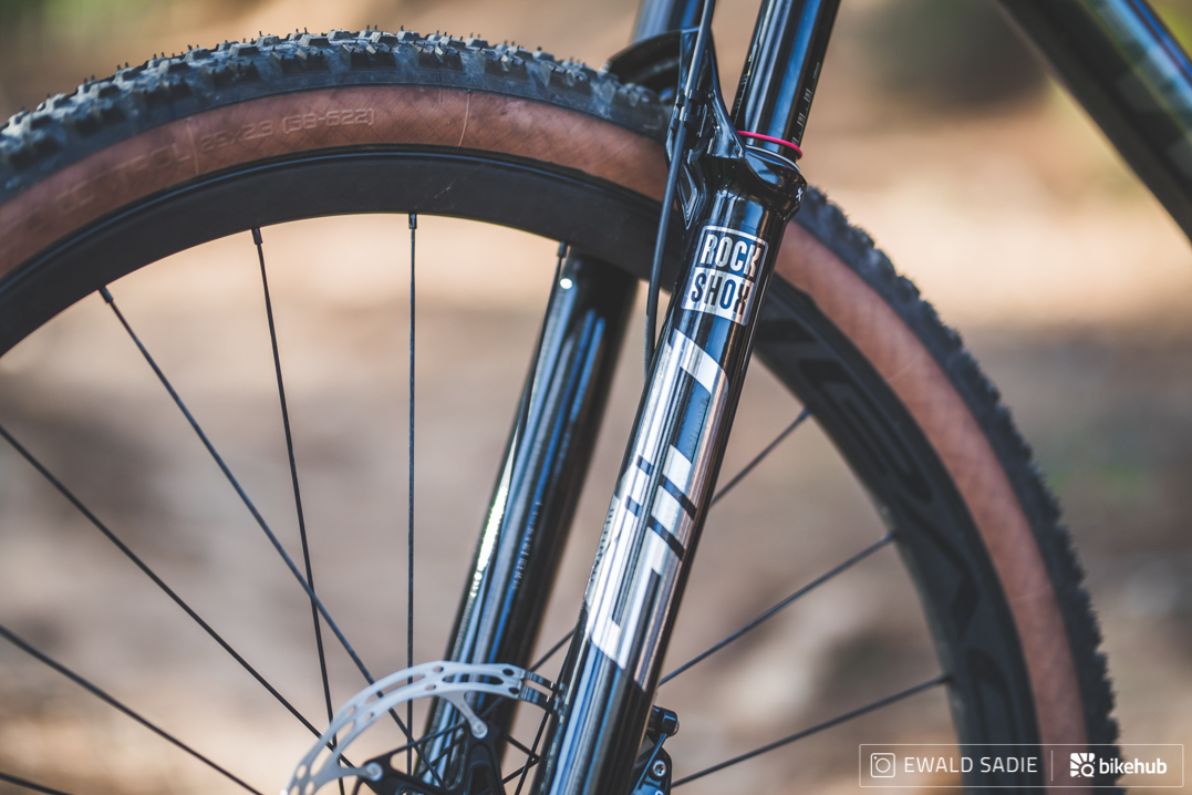

Fork: Rockshox’s 35mm stanchion SID ULTIMATE gives the 120mm SID platform some much-needed stiffness to perform on bike such as the Epic Evo.
Groupset: SRAM’s XX1 Eagle AXS drivetrain is a luxurious joy to use but not a reason alone to seek out the S-Works model.
Brakes: The SRAM G2 Ultimate brakes with their 4-piston calipers are more than up to the task of stopping this speedy 10.4 kg bike.

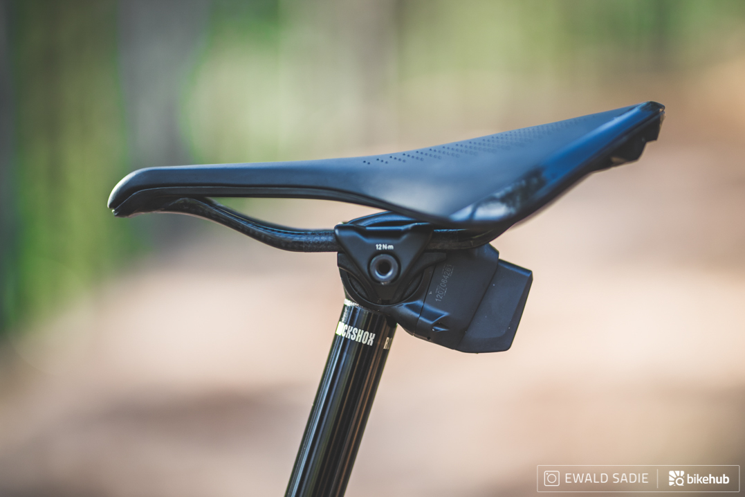

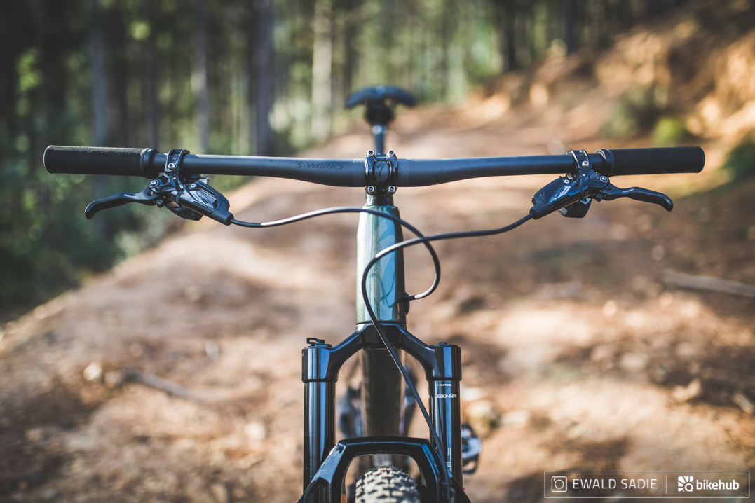

Cockpit: The star of the cockpit is the wireless RockShox Reverb AXS seatpost. Again, like the AXS drivetrain, it’s a luxury rather than a necessity. You also get S-Works carbon handlebars and an S-Works Power saddle.

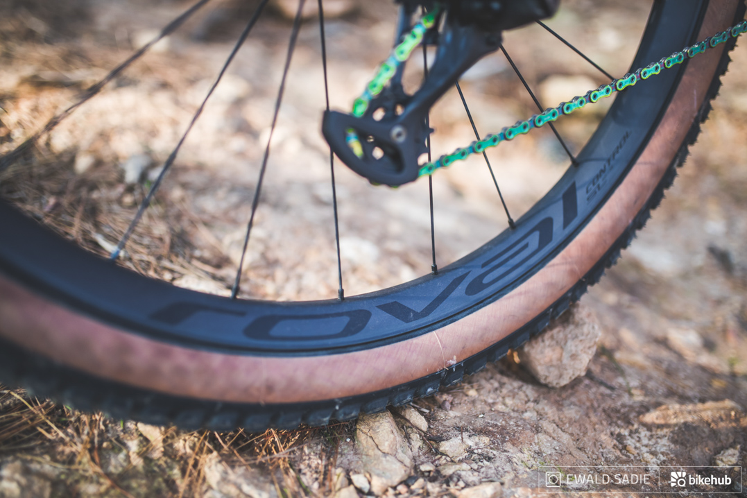

Tyres: The tyres are a combination of Specialized’s Ground Control and Fast Trak. It is an excellent pairing for fast-paced trail duties that I had ridden on my own bikes. So I was instantly comfortable on the Epic Evo. It’s worth noting that Specialized did elect the Control casing over the more robust GRID casing for this bike but that is an easy fix should you feel that you want more protection.

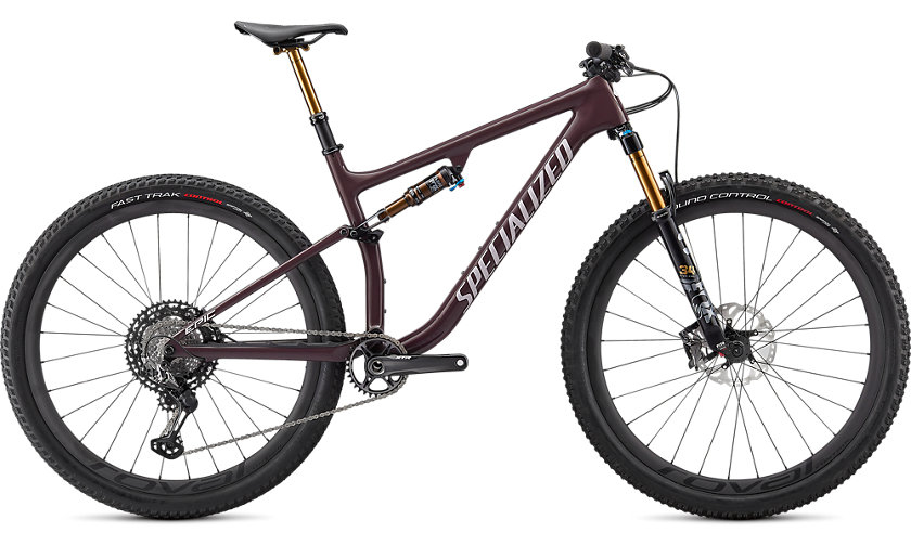

Epic Evo Pro
  • FrameFACT 11m Full Carbon, Progressive XC Geometry, Rider-First EngineeredTM, threaded BB, 12x148mm rear spacing, internal cable routing, 110mm of travel
  • SwatSWAT EMT Cage-Mount Tool
  • Rear ShockFOX FLOAT DPS Factory, Rx XC Tune, EVOL Air sleeve, Kashima Coat, 3-position adjustment w/ Open Mode Adjustment, 190x40mm
  • ForkFOX FLOAT Step-Cast 34 Factory, Fit4 damper, Kashima Coating, 15x110mm, 44mm offset, 120mm of travel
  • StemSpecialized XC, 3D-forged alloy, 4-bolt, 6-degree rise
  • HandlebarsS-Works Carbon XC Mini Rise, 6-degree upsweep, 8-degree backsweep, 10mm rise, 760mm, 31.8mm
  • GripsSpecialized Trail Grips
  • Front BrakeShimano XTR M9120, 4-piston caliper, hydraulic disc
  • Rear BrakeShimano XTR M9120, 4-piston caliper, hydraulic disc
  • Rear DerailleurShimano XTR M9100,12-speed,ShadowPlus
  • Shift LeversShimano XTR M9100, 12-speed
  • CassetteShimano XTR M9100, 12-speed, 10-51t
  • ChainShimano XTR M9100, 12-speed w/ quick link
  • CranksetShimano XTR 9100,Hollowtech 2, 162 q-factor, 32t Chainring, SM: 170mm, M-XL: 175mm
  • Chainrings32T
  • Bottom BracketShimano,BB-MT800,Threaded
  • RimsRoval Control Carbon, 25mm internal width, Zero bead hook, Tubeless ready, 28h
  • Front HubDT Swiss 350, 15x110mm spacing, 6-bolt, 28h
  • Rear HubDT Swiss 350, Star Ratchet, Shimano Microspline driver body, 12mm thru-axle, 148mm spacing, 28h
  • SpokesDT Swiss Competition Race
  • Front TyreGround Control, Control casing, GRIPTON® compound, 60 TPI, 2Bliss Ready, 29×2.3″
  • Rear TyreFast Trak, Control casing, GRIPTON® compound, 60 TPI, 2Bliss Ready, 29×2.3″
  • SaddleBody Geometry Power Expert
  • Seat PostFox Factory Transfer, Kashima, 30.9mm, 125mm / 150mm travel
  • PriceR140,000.00

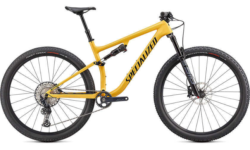

Epic Evo Comp
  • Rear ShockRockShox Deluxe Select+, Rx XC Tune, Two Position, Rebound Adjust, 190x40mm
  • ForkRockshox SID Select+, Charger RL Damper, Debon Air, 15x110mm, 44mm offset, 120mm Travel
  • HandlebarsSpecialized Alloy Minirise, 10mm rise, 750mm, 31.8mm clamp
  • Front BrakeShimano SLX, M7120, 4-piston caliper
  • Rear BrakeShimano SLX, M7120, 4-piston caliper
  • Rear DerailleurShimano SLX M7100,SGS,12-speed
  • Shift LeversShimano SLX, M7100, 12spd
  • CassetteShimano SLX, CS-M7100, 12-speed, 10-51t
  • ChainShimano SLX, M7100, 12-speed
  • CranksetShimano SLX 7100, Hollowtech 2, 32t Chainring, SM: 170mm, M-XL: 175mm
  • Chainrings32T
  • Bottom BracketShimano,BB52,Threaded
  • RimsSpecialized Alloy, Tubeless Ready, 25mm internal width, 28h
  • Front HubShimano MT400-B, Centerlock 28h, 15×110 Boost
  • Rear HubShimano MT510-B, Centerlock 28h, 12×148 Boost, Microspline
  • SpokesDT Swiss Industry
  • SaddleBody Geometry Power Sport, hollow Cr-Mo rails
  • Seat PostX-Fusion Manic, infinite adjustable, two-bolt head, bottom mount cable routing, remote SRL LE lever, SM: 100mm travel, M: 125mm travel, L-XL: 150mm travel
  • PriceR78,000.00

With the new Roval Control SL rims, you are supposedly 22% less likely to pinch flat but you still might want to put on some GRID tyres to really thrash the bike through the rough stuff. That said, I usually ride on GRID tyres but I found the Control version to be far grippier in comparison.

Those tyres... they hurt me eyes
agreed. looks like a taxi
Hairy
Jun 24, 2020, 7:49 AM
you guys have no class ... those brown sidewalls are sexy in real life!
MTBeer
Jun 24, 2020, 7:50 AM
ja as sexy as a taxi
