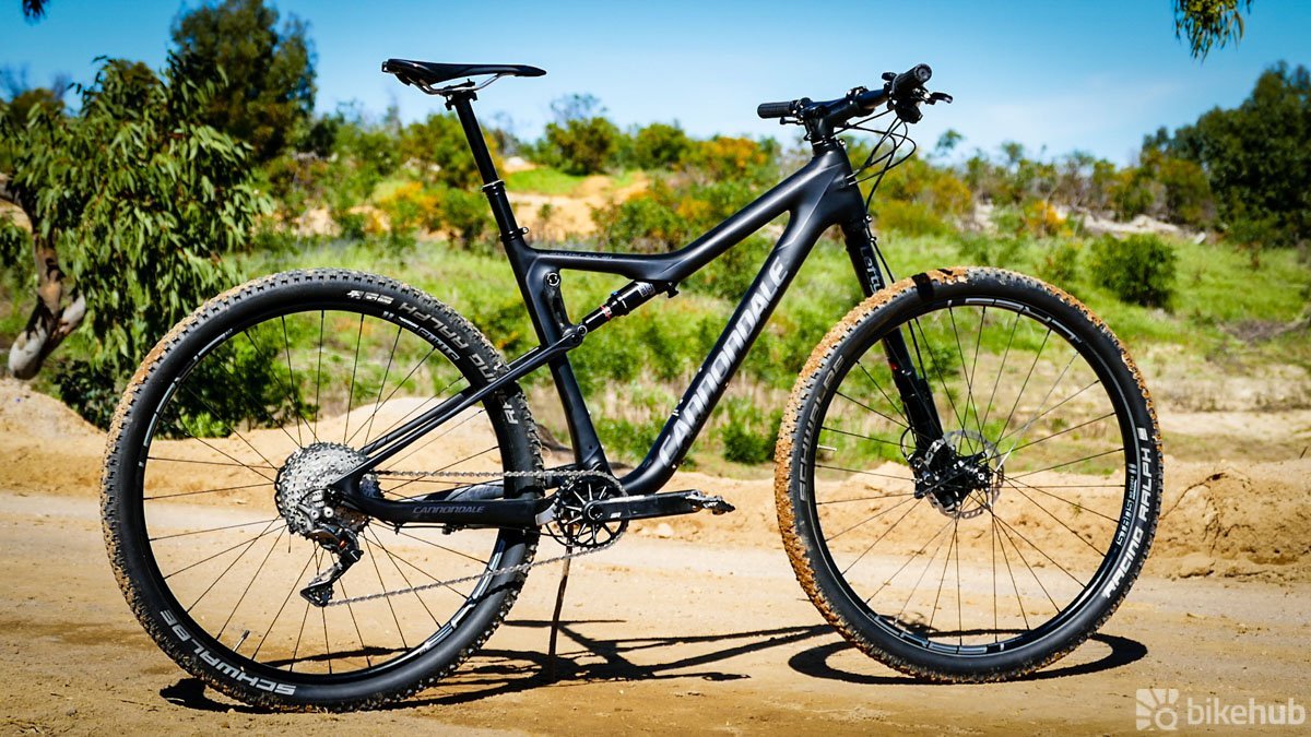

Cannondale have applied what they call System Integration (Si) to the Scalpel range to create a complete package that works seamlessly. They have tailored the set up across the size curve including 650b wheels on the XS and S, and women’s sizes.
While still plainly a Scalpel, the Scalpel-Si has brought the design up-to-date with straighter lines and a refined look. Most obvious is the new suspension design which tucks part of the rear shock into the top tube, resulting in an elegant lining-up of the seatstay, shock and toptube. There is also now space for two bottle cages in the front triangle.
It’s not just all looks either, Cannondale claim that the new Scalpel-Si carbon frame is one of the lightest dual suspension mountain bike frames in the world with a frame weight of just 2,118g including the shock, hardware, and axle on the Hi-MOD version. Which, according to Cannondale’s numbers, make it 240g lighter than the 2016 Specialized S-Works Epic frame.

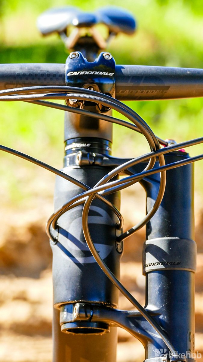

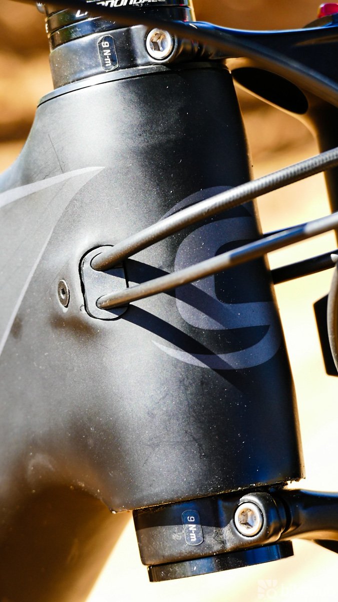

The new internal cable routing system plays its part in keeping the Scalpel-Si looking neat. The ports on the redesigned head tube provide an easy path for the cable to enter the frame while also holding the cable neatly in position with a “lockable system”. Should you desire to run a Shimano Di2 drivetrain, Cannondale have designed a system for mounting the battery inside the top tube just above the shock mount. There is also provision for an internally routed dropper post which, thanks to the routing system, can be done while running a Di2 drivetrain.
While the bike may still look much like the Scalpel of old, the geometry has seen a complete overhaul with a number of changes resembling what we’ve seen happening on trail bikes. The previous Scalpel was a take-no-prisoners race bike geared at covering distance and conquering climbs. While the Scalpel-Si still claims to do the same, it acknowledges the technical challenges of modern cross-country courses with a number of dramatic geometry changes to help riders negotiate the tough stuff.

Cannondale have given up on their proprietary steerer standard in favour of a slightly more common 1.5” steerer, which should improve the aftermarket stem options for the Scalpel-Si. The new steerer sizing means that older Lefty forks are not compatible with the Scalpel-Si. The changes in the Lefty’s rake also means that the new Lefty hub has seen some sizing changes and, as a result, is not backward compatible, although the older hubs can be used on the Scalpel-Si with an adaptor.

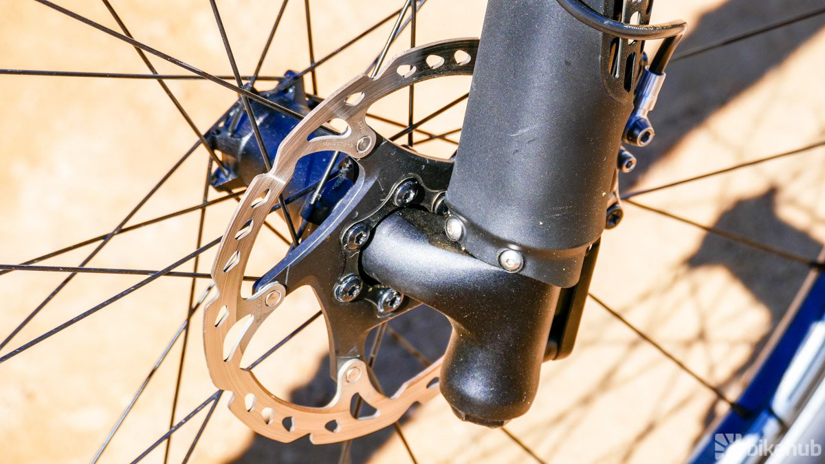

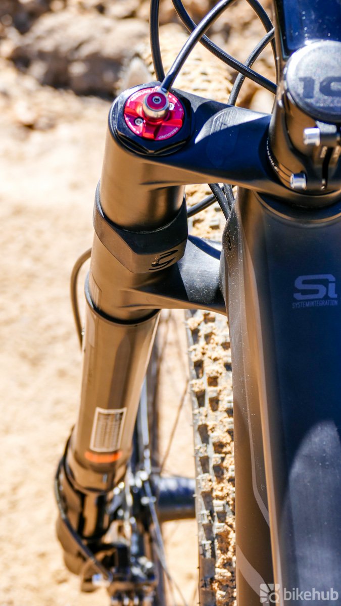

Fork

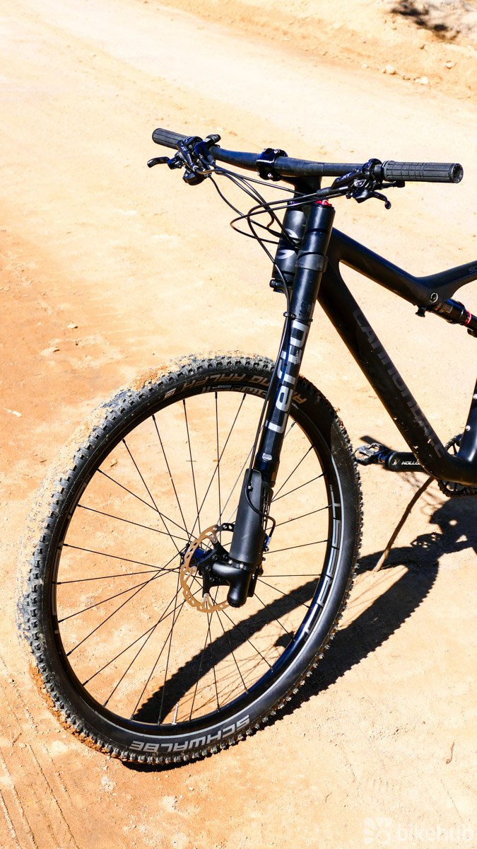

The Scalpel-Si Carbon 3 comes fitted with the Lefty 2.0 boasting XLR Isolated Damper Technology with XC+ tune and XLoc Full Sprint remote. The XLoc Full Sprint does an excellent job of locking the fork out, as it will go from plush to just about rigid with the push of the button. The general stiffness of the Lefty 2.0 puts Rockshox’s and Fox’s latest XC offerings to shame which is not what one would expect from a fork that is not really a fork. The Lefty’s small bump performance is good without diving through its travel at the first sight of uneven terrain. Sure, there is still only 100mm, but it handles what it has on offer very well.
On my first ride, there was a slight knocking noise sitting inside the fork’s first 20 mm of travel. This turned out to be the lower guard and I was able to remedy a fix trail-side.

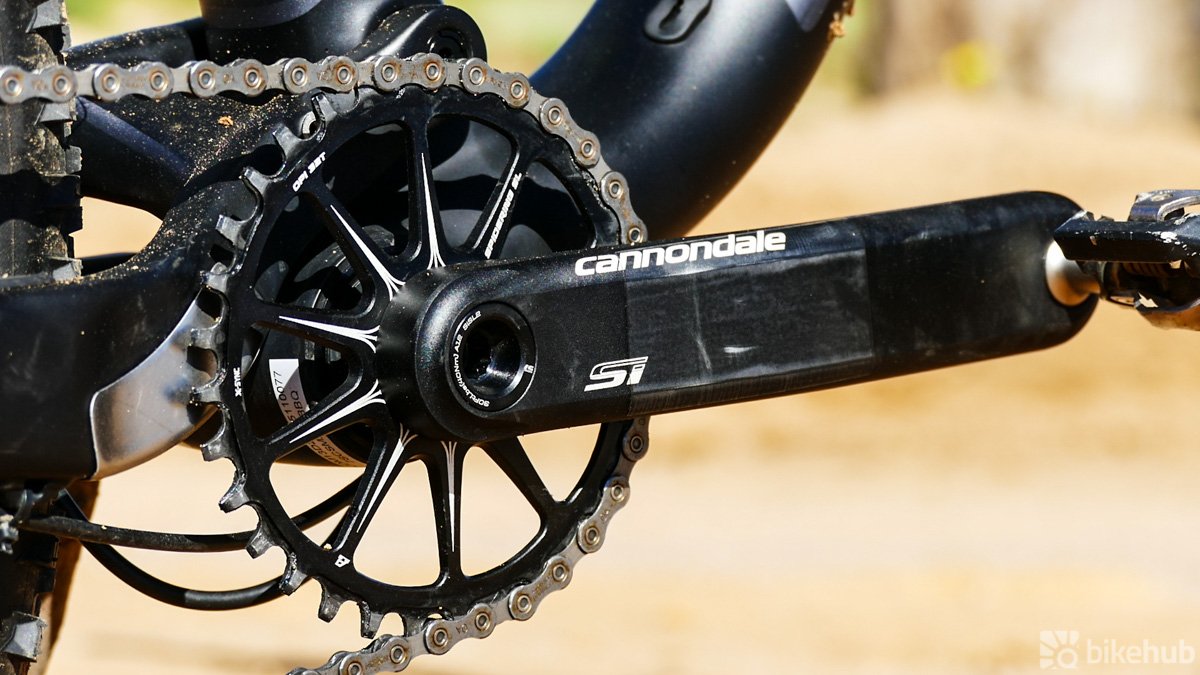

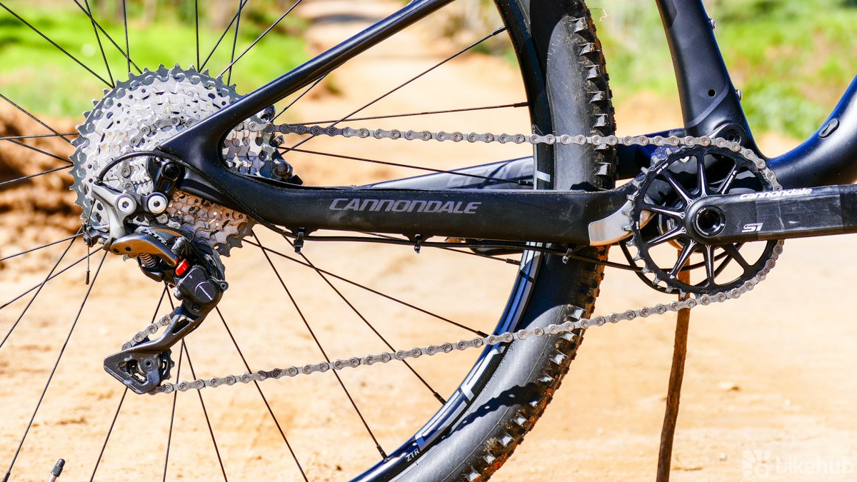

A mix of Shimano XTR and XT is powered by a Cannondale Si crank with a 32T Ai SpideRing. As mentioned in my review of the Silverback Sesta, I find the 11-42 Shimano cassette ratio too narrow for a 1x drivetrain on an XC bike. With the 32T chainring, I was spinning out at around 35km/h leaving me to coast it out. Fortunately, the Scalpel now comes specced with Shimano’s 11-46 which will help a great deal as. This range will allow most riders to up the chainring to a 34T and for the fitter amongst us to bump that to 36T.

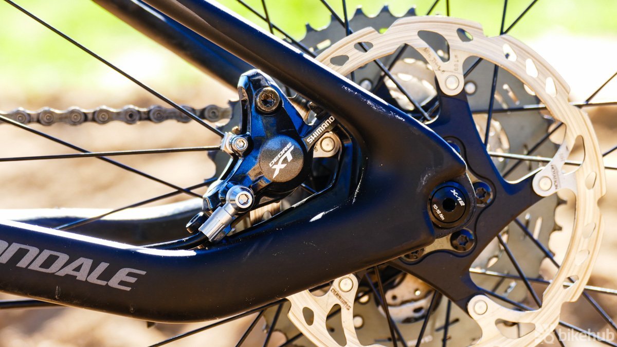

Brakes
Shimano XT M8000 brakes are paired to 160mm front and rear rotors. Stopping power was good and the rotors did well at slowing the bike down. Fitting beefier tyres (and resulting higher speeds) did show that I would probably go to a 180 mm rotor in front sooner rather than later if only to be on the safe side.

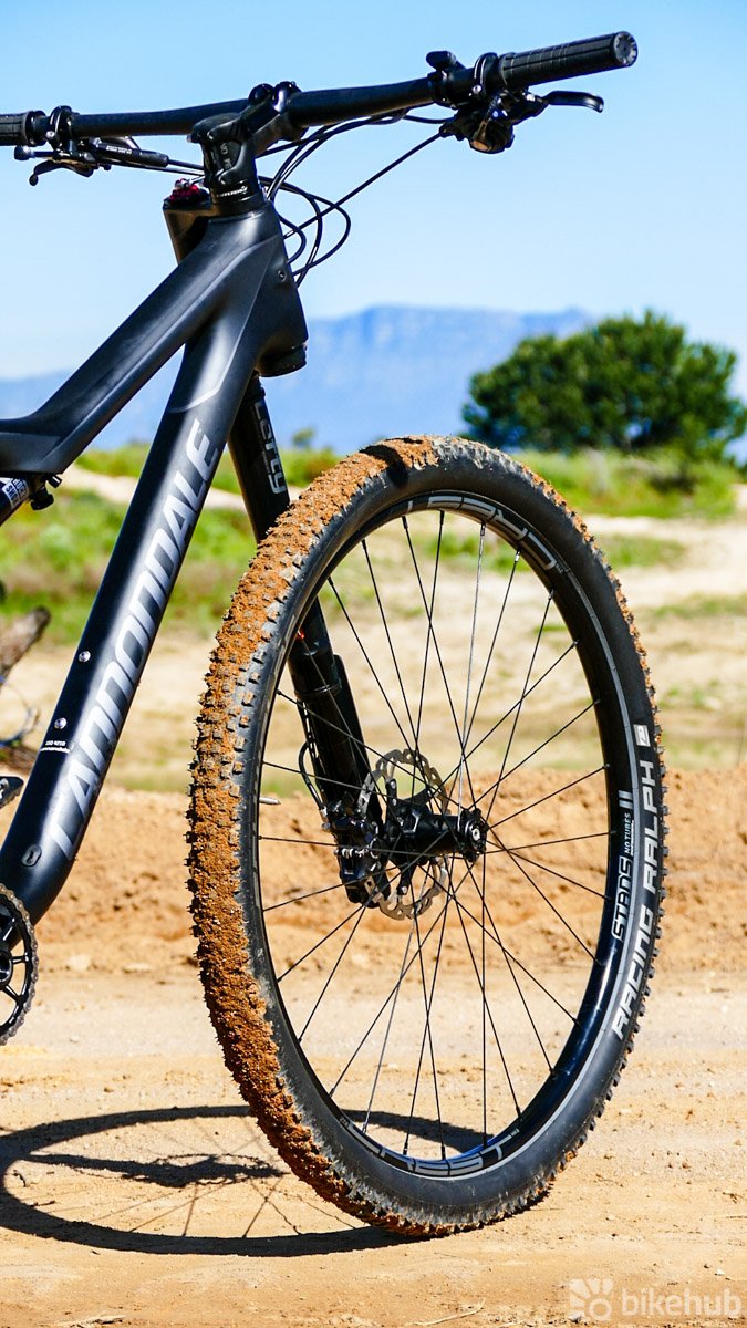

Tyres

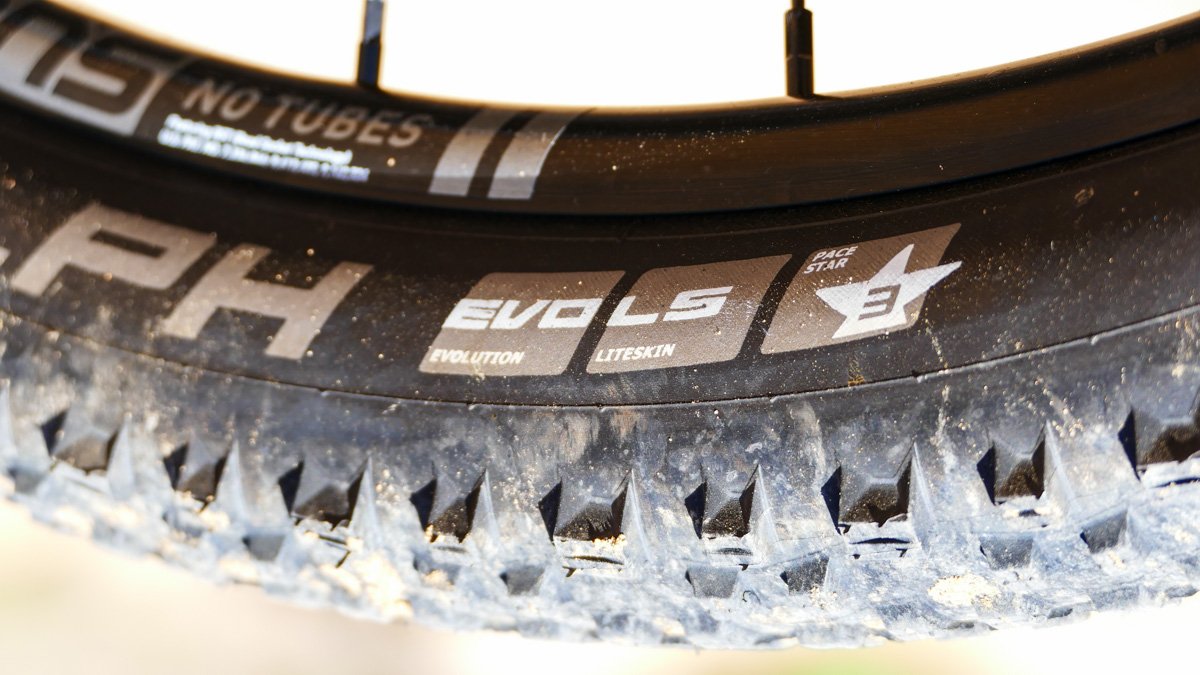

The only specification choice on this bike that I can fault are the tyres. Schwalbe’s LiteSkin tyres are simply too flimsy and thin for South African conditions. Their paper-thin sidewalls caused the tyres to roll on their carcass. The only partial solution is to increase tyre pressure which leads to a loss of grip and traction, and an unnecessarily hard ride. With the overall weight of the bike already very competitive, I see no need to compromise with these tyres – especially as they only offer a 90 gram saving per tyre over the Snakeskin model.

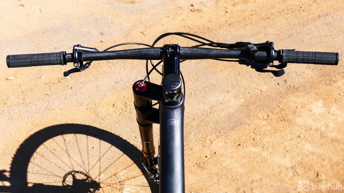

To round off the package, the Scalpel-Si comes with a 760mm carbon handlebar and 90mm stem. It was great to see this combination on a cross-country race bike. It suits the bike perfectly and offers great control and composure to a segment that is known for twitchy or nervous bikes. The Cannondale branded grips are comfortable and stayed secure through the roughest sections, thanks to inner lock rings.

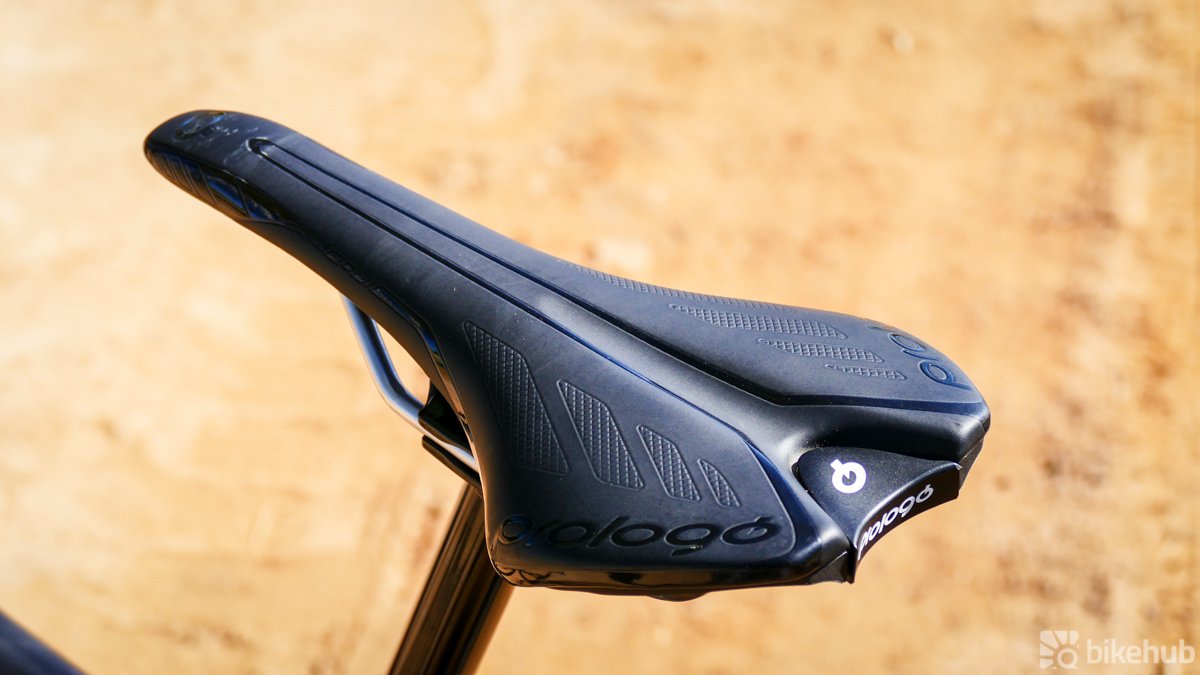

Prologo’s Zero II STN has been surprisingly comfortable, after some recent abuse by other saddles following acclimatization to Specialized’s Power saddle. Although the basic shape is similar to other cross-country saddles, the Prologo Zero seems to have got the mix just right.

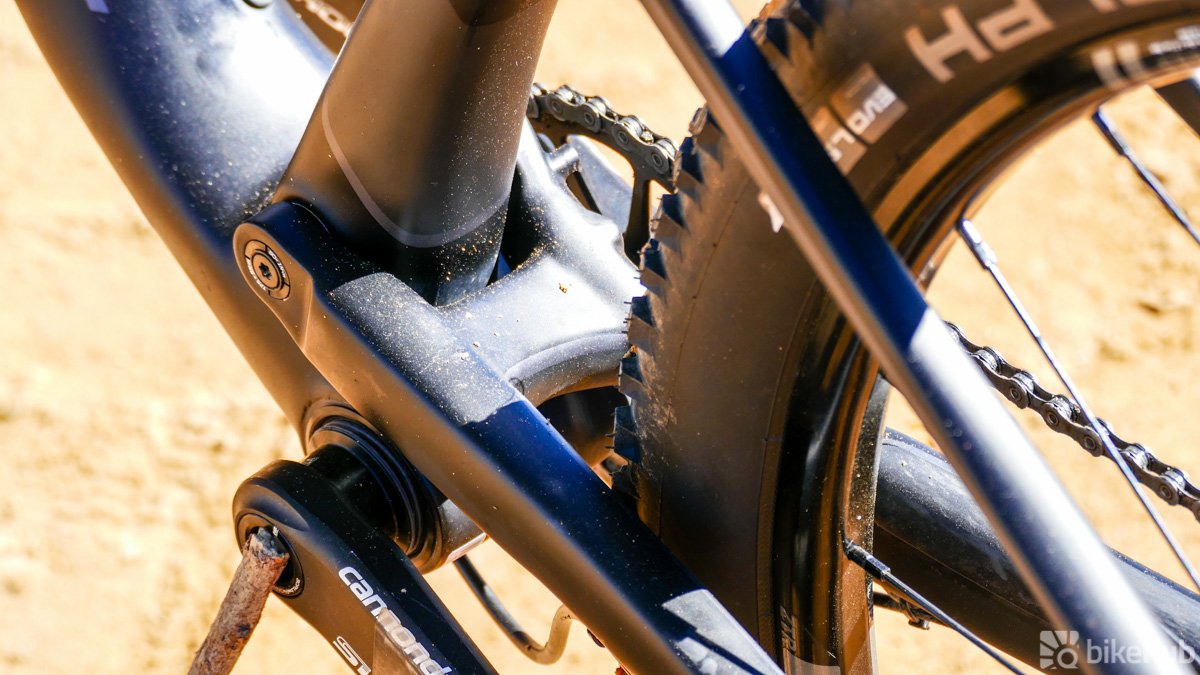

The main pivot located just above the chainring, along with what feels like a relatively stiff compression tune on the shock, gives decent pedaling characteristics when the trail points up. Under load the rear feels stiff, not giving away any hard-earned watts. There is no denying that the Scalpel-Si is a great climber. Whether grinding away or putting the hammer down, every pedal stroke translates into forward motion, making light work of long ascents. The bike’s excellent pedaling manners meant that I could leave the suspension fully open and active at all times. This helped with extra grip and traction and no need to remember to flick a switch or push a remote when the party starts.
Any concerns about the slacker head angle turning the front wheel into a wanderer can be dismissed. It stayed planted and on track over the steepest climbs and showed no signs of ill-manner over technical, uphill sections. I’m sure the 55 mm offset fork and 73.5° seat tube angle play a big part in this. What all of this means to you is the ability to focus on choosing the best line and getting to the top in the fastest possible time.

  • The LiteSkin tyres will need replacing
