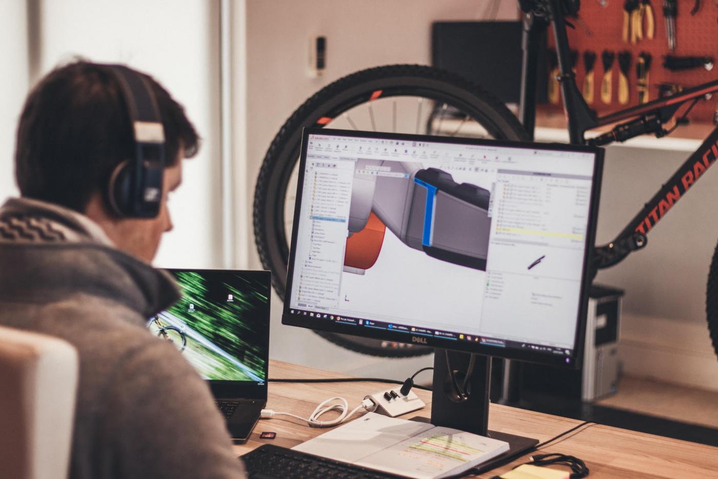

Then we put the drawings into CAD and start modelling everything up as a 3D model, where you can start checking the clearances and finalising the lines. Once a design is close to the final product, I print it out on the 3D printer in the office. One of the difficulties with working in CAD is the vague sense of scale. With 3D printing, you can check in real life whether the parts are the correct proportions.

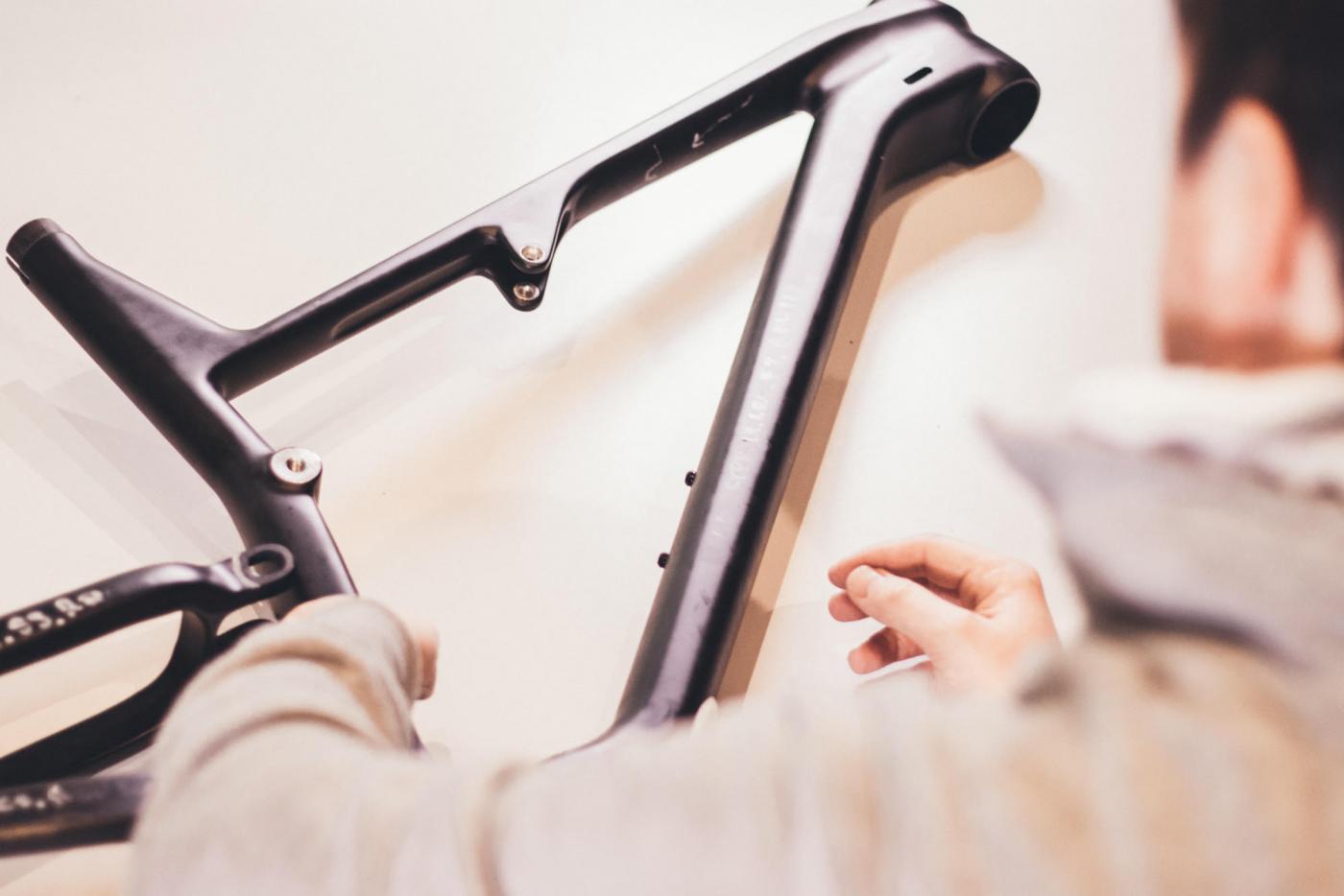

The finished design is then sent to the frame factory. Here the factory’s specialist reviews the design for manufacturing and analyses the forces at a carbon ply-by-ply level. This cuts down on the amount of physical testing to optimise the frame.
