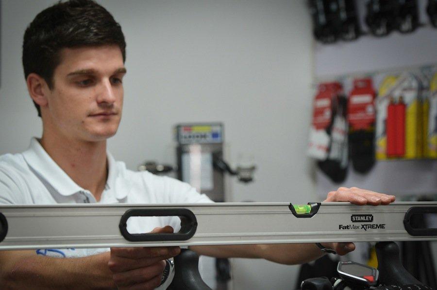

When it comes to mountain bike handlebars, wider is better. They offer you more control, easier breathing and better positioning for balance. This makes you more stable and slower to fatigue. However, handlebars that are too wide can also leave you feeling over stretched or unbalanced on the front of the bike, therefore it is important to have your handle bar width measured relative to your shoulder width if you are unsure where to begin. It is also worth considering the terrain you’re riding. Those who ride more ‘open’ trails at higher speeds are much more likely to benefit from a wider bar. Whereas slow-speed single track terrain will require a narrower handlebar, as it can get tiring weaving a wide bar through tightly spaced trees. So think about the environments you will be riding before going as wide as possible.
When it comes to fitting a wide bar, the first thing to understand is that bar width is closely linked to stem length. So as you add bar width you should also reduce stem length. A more ‘balanced’ position on the bike should be the aim when referring to mountain bike setup, therefore, handlebar height should also be considered when looking at a riders’ overall position on the bike. If you have ever had that daunting feeling of your handlebars lifting slightly as if you are going to ‘wheelie’ the front of the bike on those very steep up-hill sections, you are more than likely too high on the front end of the bike, which will cause your weight to be very much towards the back of the bike which will make the front end feel very ‘light’.
Another similar cause of this ‘unbalanced’ feeling could also be due running the incorrect shock pressure, especially on dual suspension mountain bikes. This topic will be discussed more in depth in coming articles.

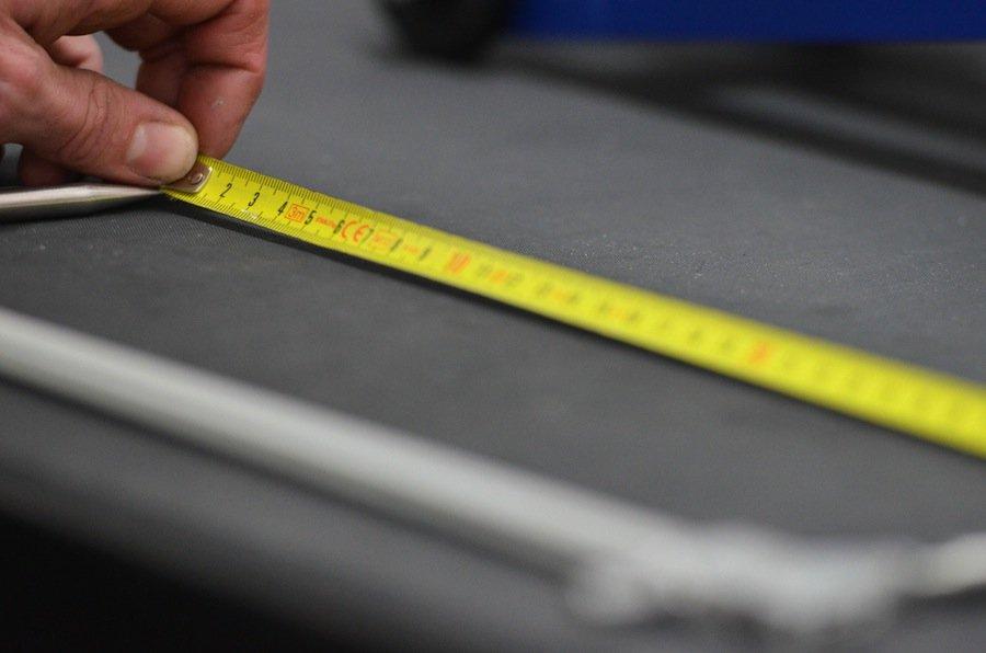

Shoulder width will also be the determining factor when choosing the correct width of bar for your road bike. The most common handle bar widths you will find are; 400mm, 420mm and 440mm. Selecting a handlebar that is too narrow for you may result in the bike feeling ‘twitchy’ or unbalanced on fast downhill sections and corners, whereas a bar that is too wide may give the feeling of falling forward and excessive use of the neck and shoulder muscles to support the upper body would be the case.
Lever position and shape of bar
When purchasing and fitting handle bars for your road bike the width will be a relatively simple choice to make compared to the decision made on the shape of bar, and should be given some serious thought when making this choice.
If you are a more flexible rider looking for an aggressive racing position on the front end, then the handlebar shape you should consider would be a bar with a longer reach on the tops of the bars (approximately 85mm) to position the brake levers further and the stretch torso out, and a lower handle bar drop (approximately 140mm) to achieve a bent elbow position in the drops.
