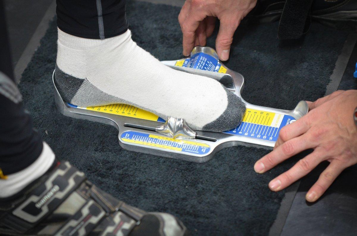

“Hot feet” is caused by the compression of the nerves between the metatarsal bones of the forefoot – instigated by a number of different factors relating to shoe choice. When purchasing the correct shoe, the shape of the shoe should be considered before the size. It is recommended having your foot correctly measured to determine length and width which will assist in determining which cycling shoe best suits your foot. This will also give you a good idea of the position of the ball of your foot within the shoe, which will ultimately affect your cleat positioning.

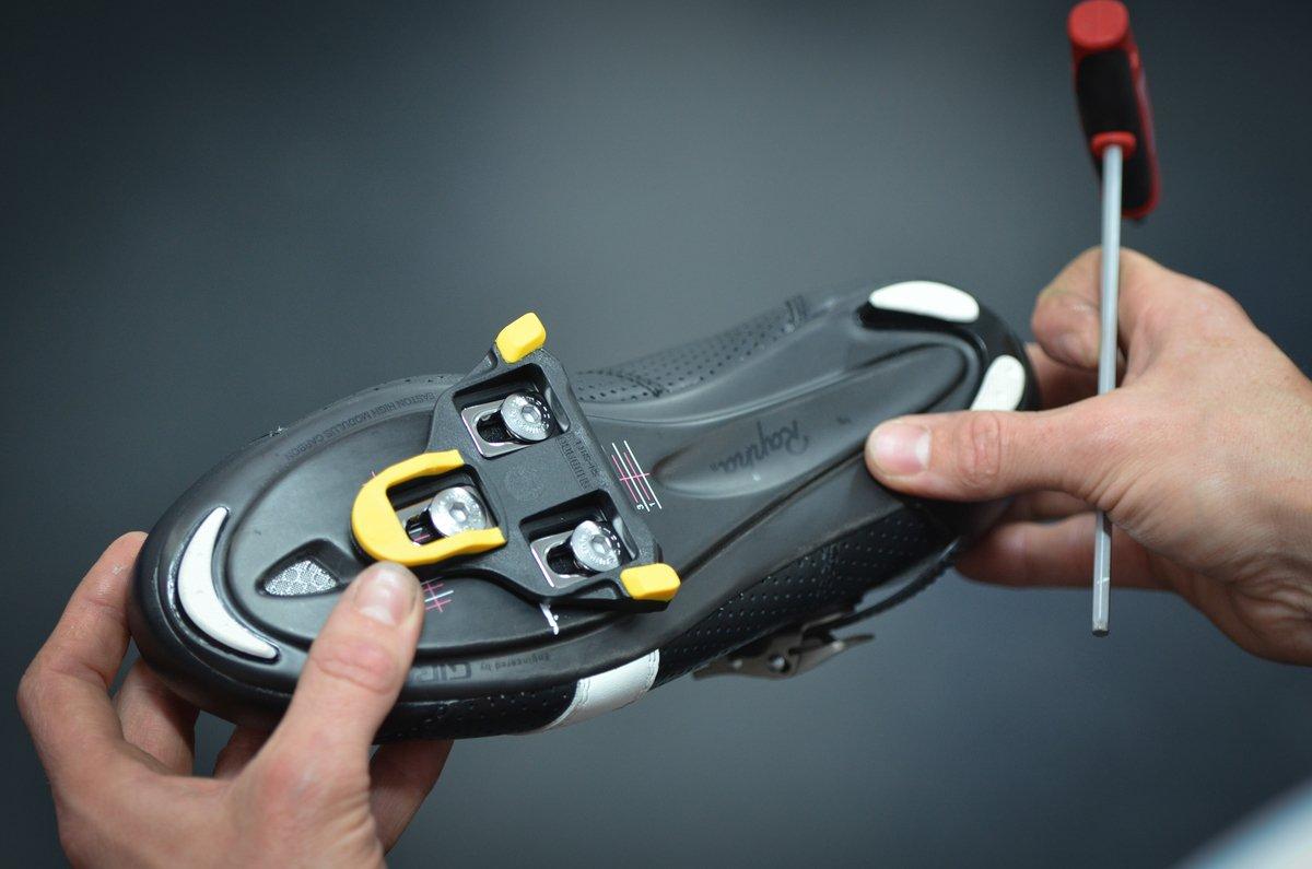

Cleat positioning has a much greater impact on a riders’ overall position on the bike than one would perceive. The power generated by the rider is transferred directly to the bike via ones feet on the pedals. This relationship between foot and pedal needs to be optimised to achieve efficient and comfortable performance.
The common belief that the ball of foot should be positioned directly over the pedal axle is not necessarily true. When considering cleat position on the shoe, imagine the foot as a lever. The further forward the cleat is placed relative to the ball of foot, the greater the effort will be required to stabilise the calf through the motion of the pedal stroke. This may cause excessive heel drop especially when shifting back on the saddle on long climbs, and it may also place excessive pressure on the knee in certain cases.
On the other hand, the more rearward the cleat position on the shoe relative to the ball of the foot, the less the required effort would be to stabilise the foot on the pedal. However, this can cause an unnatural ‘stretching’ motion for the pedal axel, and may result in loss of power when standing up to accelerate quickly.
