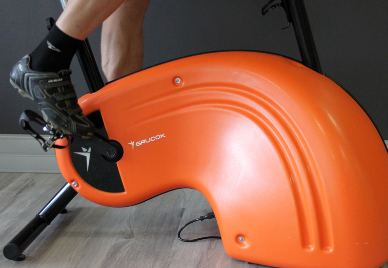

Grucox:
The grucox bike is an isokinetic ergometer. It may look like a standard gym bike, but its pedals are motorized and move at a pre-programmed cadence. Due to it being isokinetic (pedals moving at a constant rate / cadence), it is excellent for improving strength developments. Most notably, the grucox bike allows you to resist against the pedals. This resistance motion allows you to perform eccentric only cycling. Several research studies have demonstrated that eccentric cycling results in greater strength, power, and muscle mass gains than normal concentric cycling. Eccentric training may also be beneficial to reduce the risk of overuse injuries and help prevent osteoporosis.
ccs-62657-0-39312900-1494998992.jpgPhoto credit: Sports Science Institute of South Africa.
Grucox bikes can be found at several medical and sports centres. The Sports Science Institute of South Africa has recently opened a dedicated endurance studio, which contains, wattbikes and Grucox bikes for members to train on.

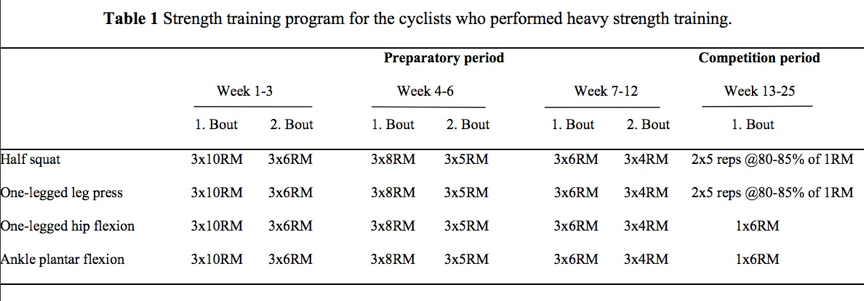

Rønnestad, Hansen and Raastad performed a study in 2010 with two groups of cyclists where comparisons between pre and in-season strength training were made.
The comparisons for cycling performance were done on muscle cross-sectional area, oxygen consumption and strength during a 12-week preparation phase and a 13-week in-season maintenance program. Group 1 followed a structured program of endurance and heavy strength training twice per week for the 12 weeks preparation phase while Group 2 only focused on a structured endurance program with no strength training.
Once completed, the next 13-weeks were a competition phase where Group 1 carried on with the maintenance strength work once a week while Group 2 carried on with no strength work or maintenance.
The end results were significant:
Group 1:
  • Mean Power 40km TT test: Increase of 8% after preparation phase and an additional 6% performance increase after the competition phase.
  • Overall leg strength increased by 23%
Group 2:
  • This group was limited to a 4% increase in 40km TT power after the preparation phase.
  • They also had no additional improvement after the competition phase.
However, don’t rush off to the gym and start lifting every weight you can find. Strength training requires adaptation and you should therefore start with shorter, less frequent sessions using lighter weights. This will prevent injury, and will also prevent excessive muscle damage and stiffness so that you will still be able to walk to ride your bike in subsequent days.
The protocol used in the Rønnestad et al. study used only four simple exercises. Their periodised strength-training program is outlined below.
ccs-62657-0-83065000-1494936878.pngFigure from: B. Rønnestad. E. Hansen, and T. Raastad, “In-season strength maintenance training increases well-trained cyclists’ performance,” European Journal of Applied Physiology. 110(6): 1269-1282. (2010). RM = Repetition Maximum, The maximum weight you could lift for the given number of repetitions.
