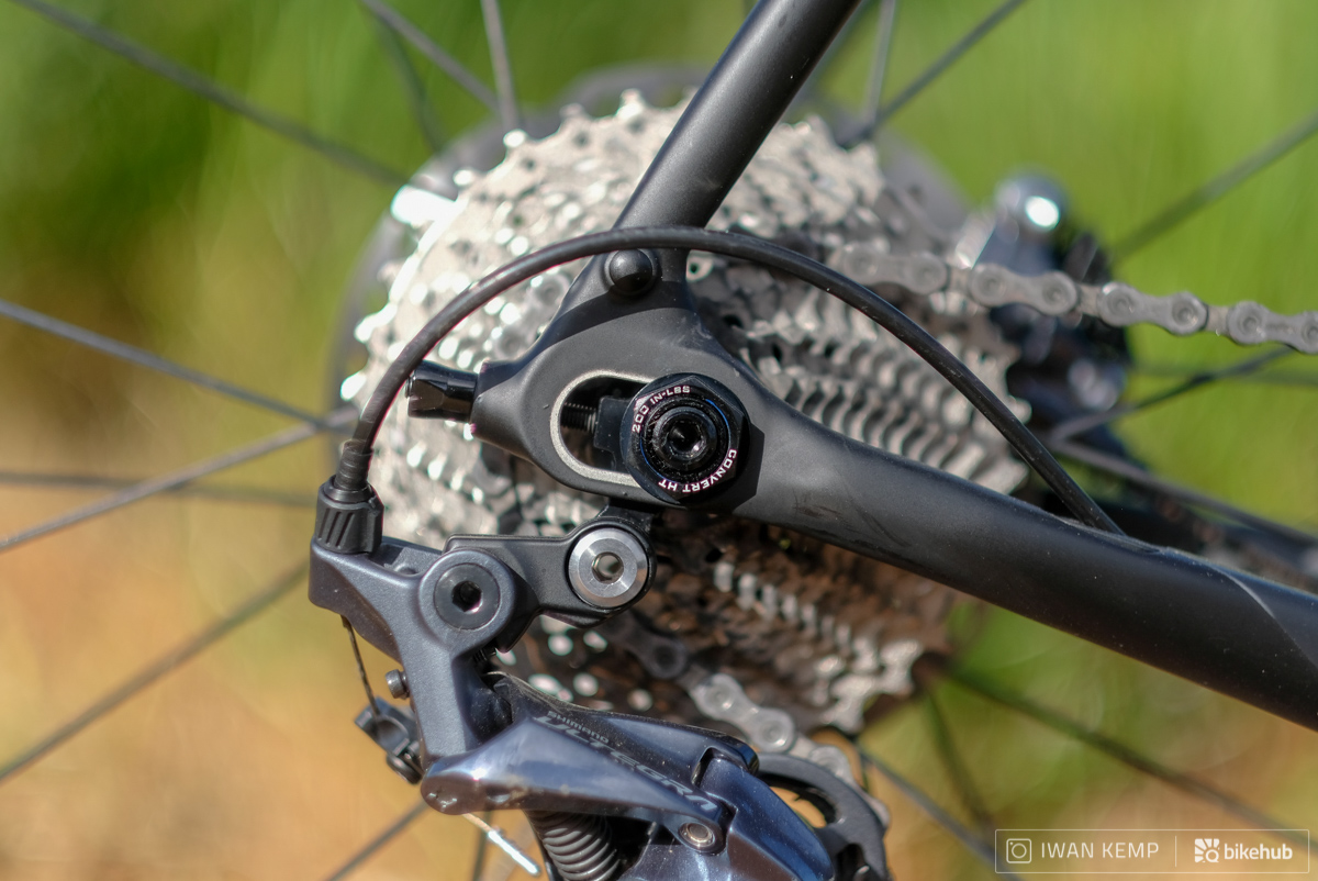

The chainstay length and wheelbase also match the Boone but with a slight twist. The Stranglehold dropouts let the rider adjust the bike’s geometry and gearing based on the requirements of the day’s ride and personal preference. The longest setting increases the bike’s stability for longer rides or bike-packing while shortening the wheelbase provides snappier, more responsive handling for gravel racing. The adjustment range is 15 mm for a 425 to 440 mm chainstay length. The dropouts also facilitate quick, no-fuss conversion to single speed.

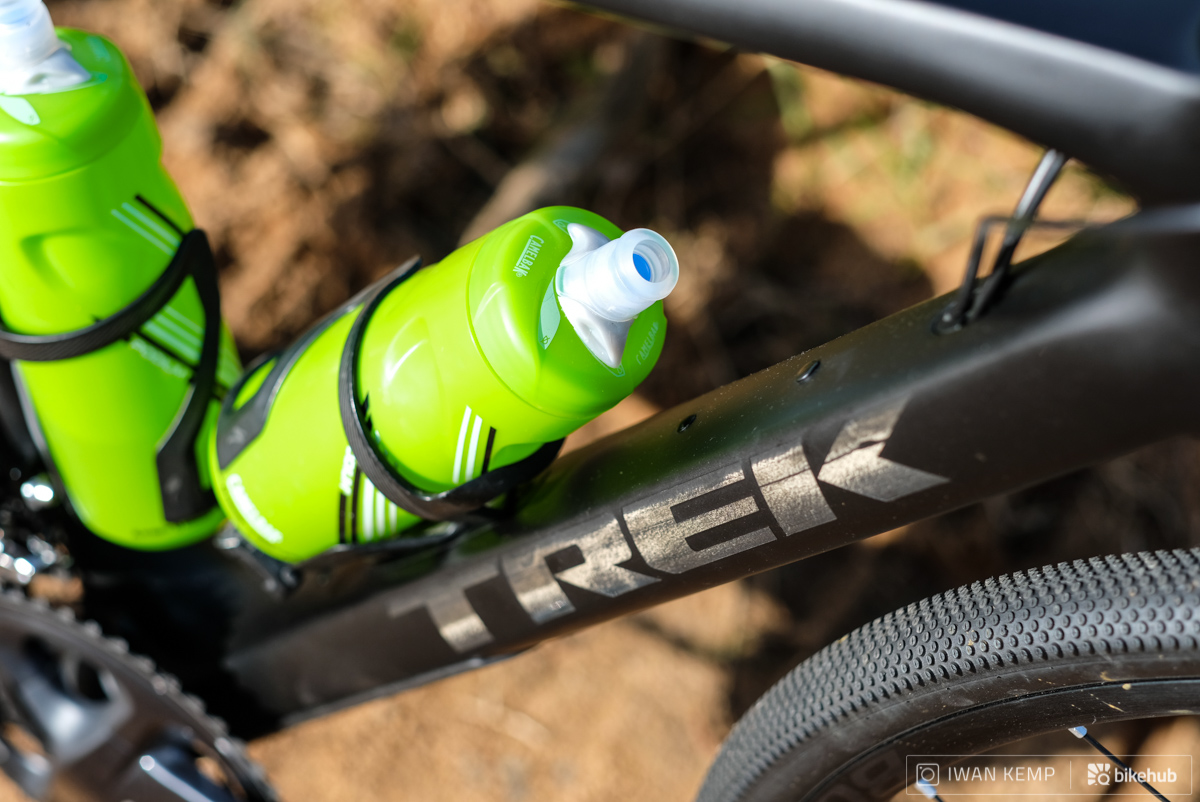

Hardcore gravel riders can rejoice at the detail that has gone into the Checkpoint. Extra mounts on the top tube, seat tube and both sides of the downtube make it easy to carry extra gear and water with size 49, 52 and 54 cm frames accepting three bottle cages with four cages on sizes 56, 58 and 61 cm. Lowrider fork mounts will hold a rack such as Trek’s 720 fork rack while rear rack mounts provide the option to haul even more cargo. Hidden fender mounts give foul-weather riders the option to give themselves and their bikes some relief from wheel spray. There is even a top tube mount to quickly attach an easy-to-reach bag for on-the-go essentials.

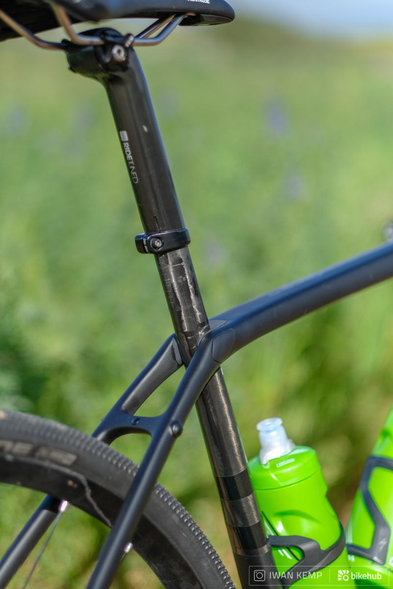

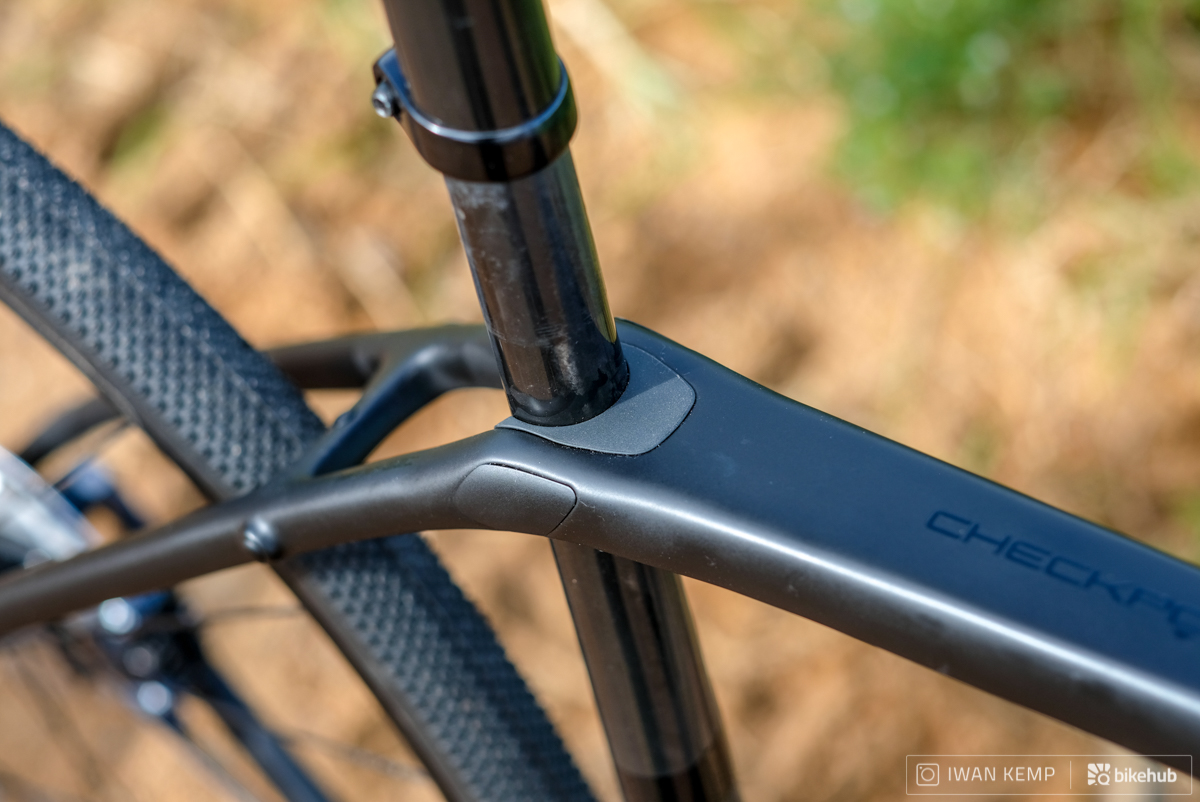

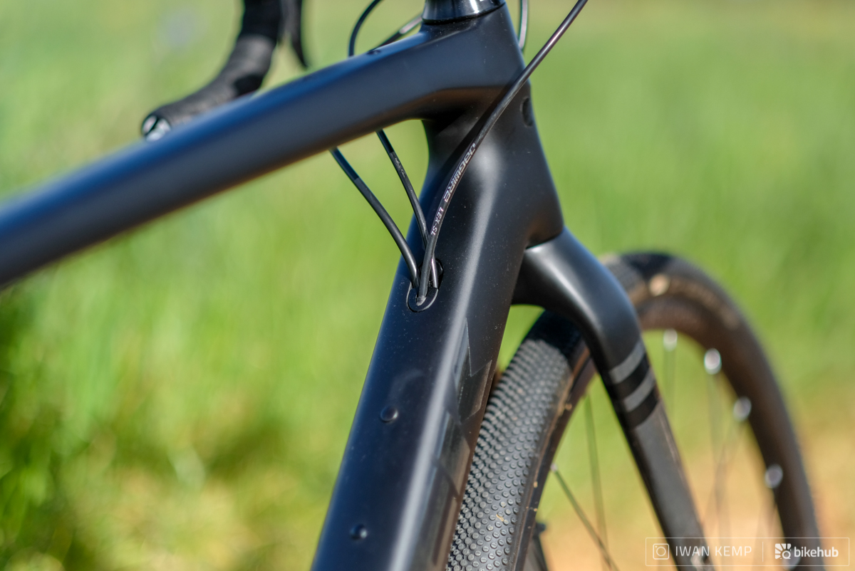

The Checkpoint SL 6 features the same rear IsoSpeed decoupler used on Trek’s Domane and Boone models. It aims to minimize fatiguing vibrations from uneven road and trail surfaces, ensuring greater comfort for the rider. The SL model also comes with a carbon seatmast cap and Trek’s Carbon Armour to protect the downtube from carbon smashing debris. All Checkpoint models feature front and rear thru axles and Control Freak internal cable routing. There is even a chain-catcher to ensure the chain does not drop when the going gets rough.

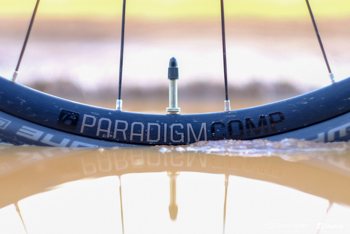

The rims and tyres are tubeless ready, but you will need to invest in a tubeless conversion to get rid of the standard inner tubes. Throw in the frame’s capability to run tyres as wide as 45c and you have a bike that ticks all the gravel boxes.

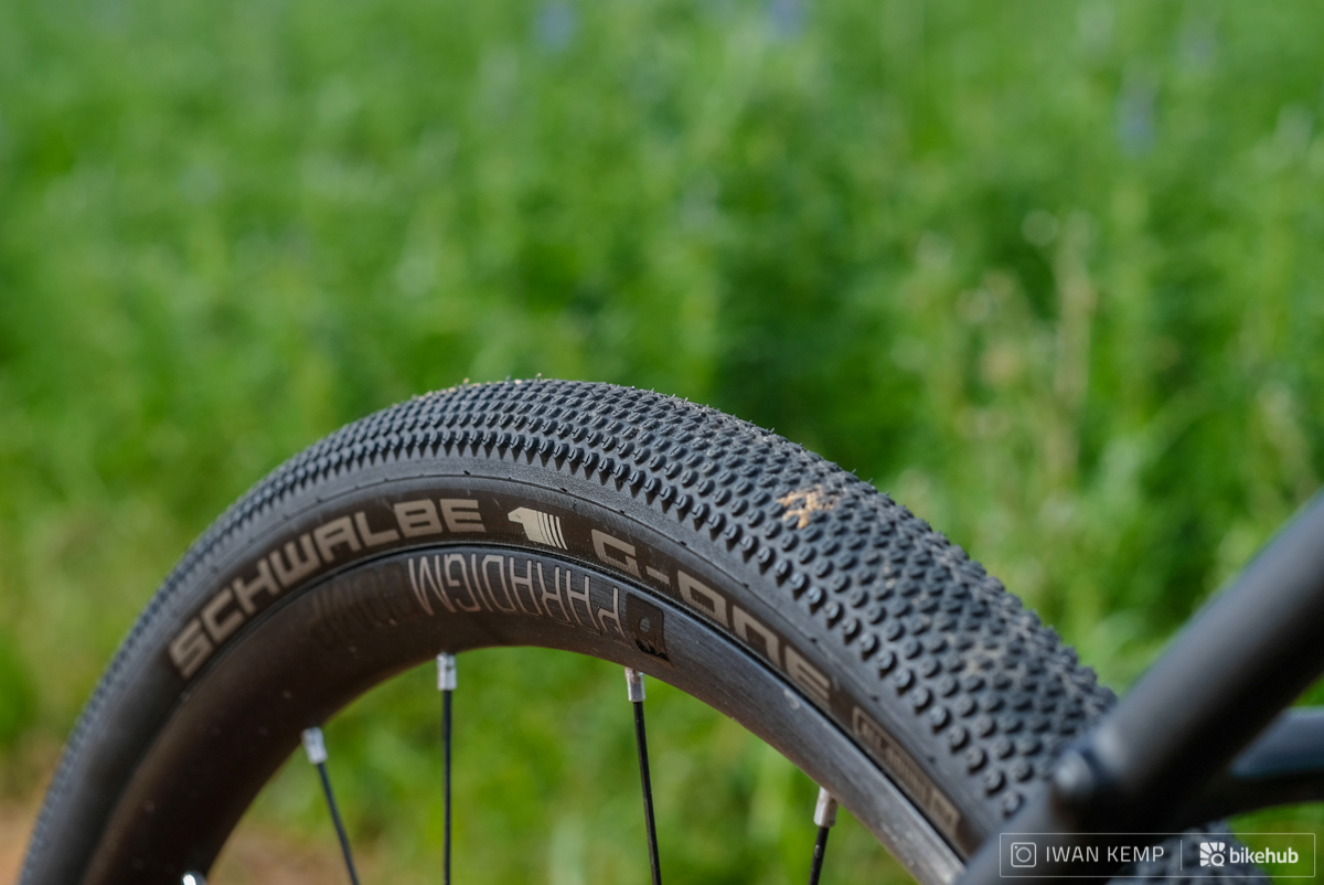

  • TyresSchwalbe G-One Allround, aramid bead, TL Easy, 700 c 35 c

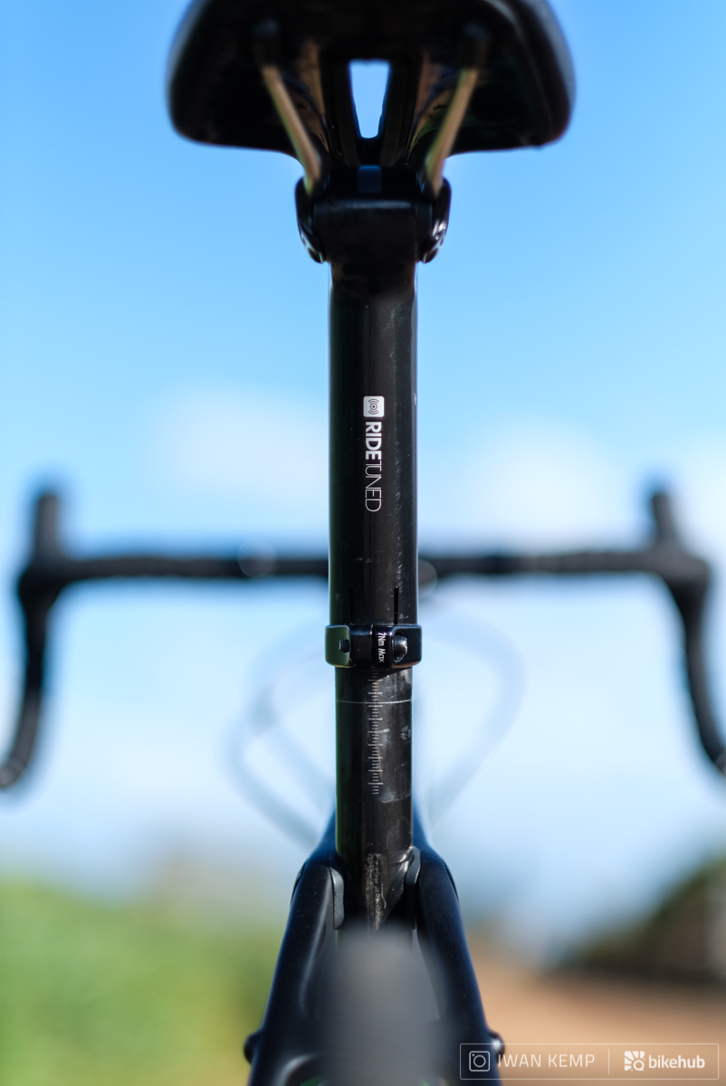

  • SeatpostBontrager Ride Tuned carbon seatmast cap, 20 mm offset

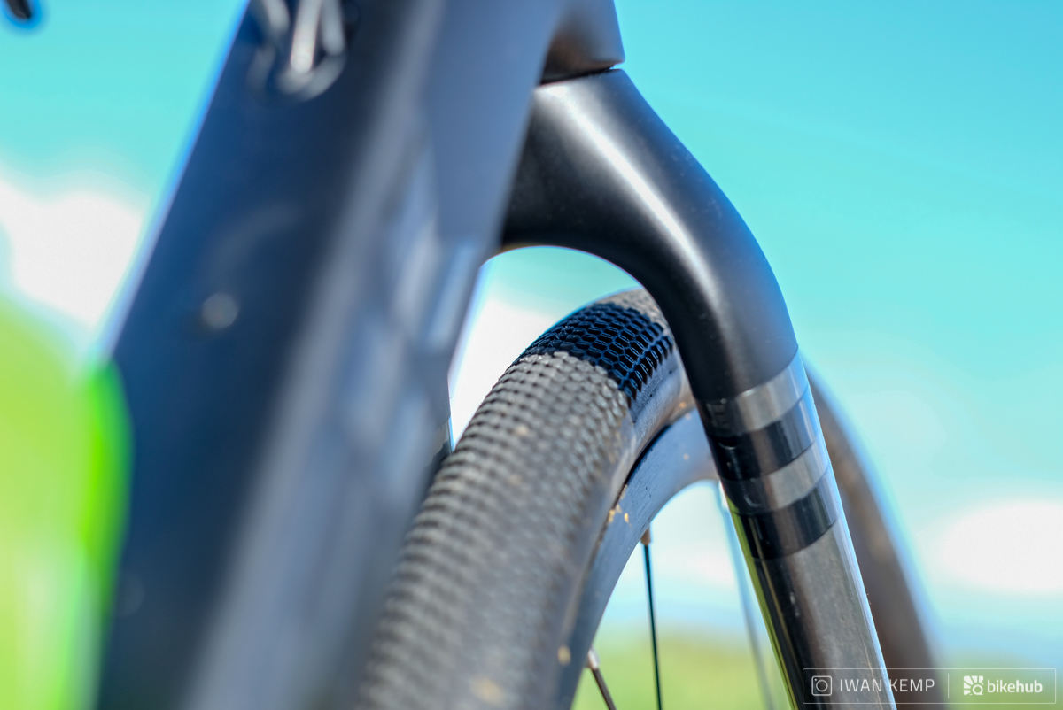

The 35mm Schwalbe G-One Allround tyres performed very well in most conditions with the low profile dimpled tread being grippy enough for gravel riding while only showing its shortcomings on the trails – as you might expect. On the road, the tyres are fast, rolling along with little noise or drag. The G-One’s thrive on dry trails with muddy or very loose conditions causing them some trouble. This is not really a comment on their performance, but rather of the nature of the low profile gravel tyre.

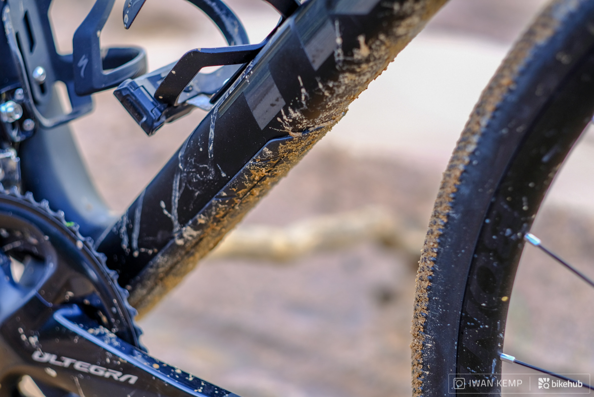

Through the mud and rain, there were no signs of clearance issues or a noisy bike. The Checkpoint’s dropped chainstay reduces chain slap and on the trail noise, negating some benefits of a clutch derailleur. Some riders may prefer a 1x drivetrain but I felt that double chainring setup made it a more versatile ride when there was tar or faster, smooth sections in the mix.
