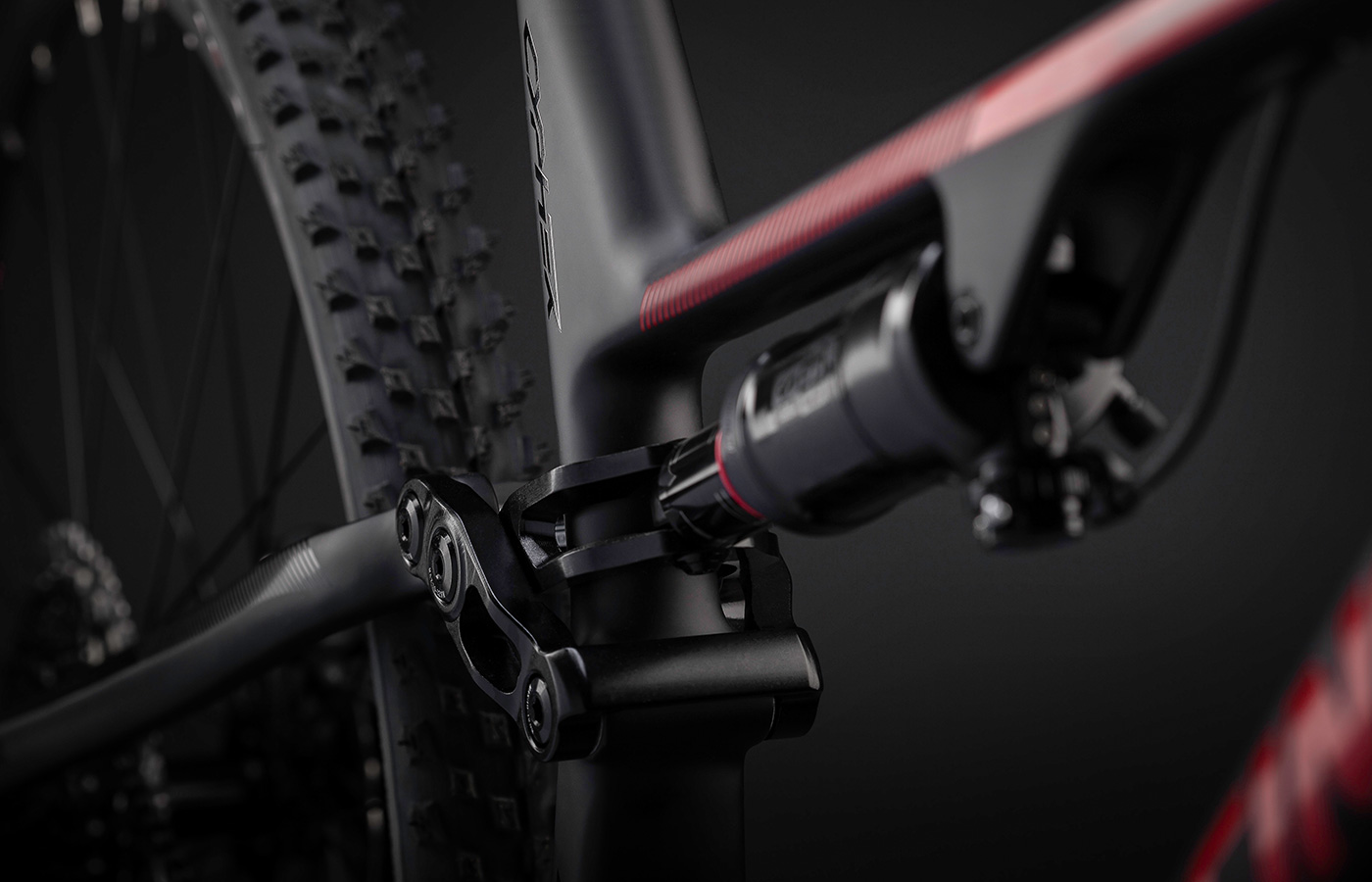

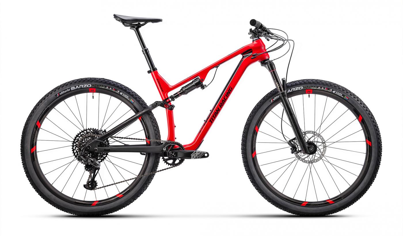

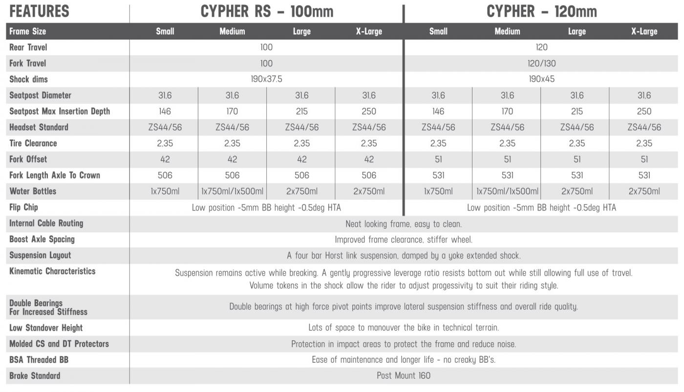

The new Cypher and Cypher RS fits right into this new age of riding with its progressive geometry. In short, the Cypher and Cypher RS is a short travel bike based on the metric shock standard. Using a metric standard shock allows for the design of two travel variations using the same frame by taking advantage of the ability to adjust the stroke length of the shock without affecting the eye-to-eye dimensions. A difference of 7.5mm on the stroke translates into 20mm of travel at the rear axle resulting in two variants; the 100mm Cypher RS has a 37.5mm stroke length while the Cypher has a 45mm stroke.
In addition to the extra 20mm’s of travel on the Cypher it is spec’d with a wider 780mm bar compared to the 750mm flat bar on the Cypher RS. Other subtle hints to the capability and intended riding style of the Cypher include wider 2.35 tires and a Manic 125mm dropper post.

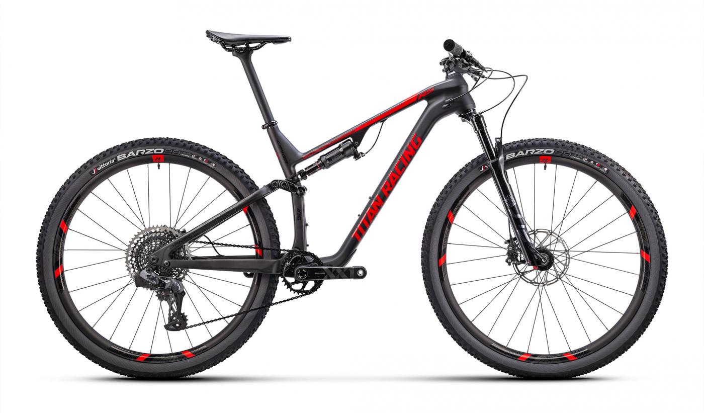

CYPHER RS – 100mm of travel front and rear
CYPHER – 120mm of travel front and rear

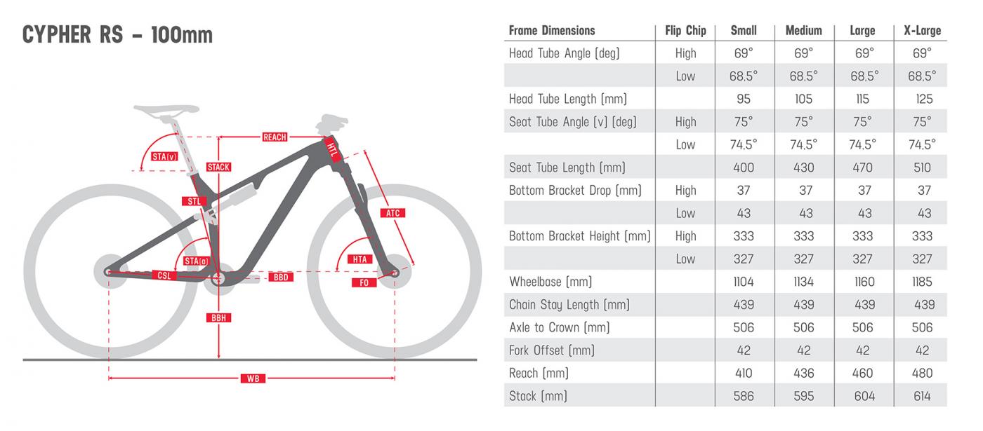

Cypher RS – 100mm
  • 100mm rear wheel travel
  • 100mm fork
  • BB height – 333mm (High setting) (*Est. Vittoria Barzo 2.25 tire)
  • Head tube angle – 69° (High setting)

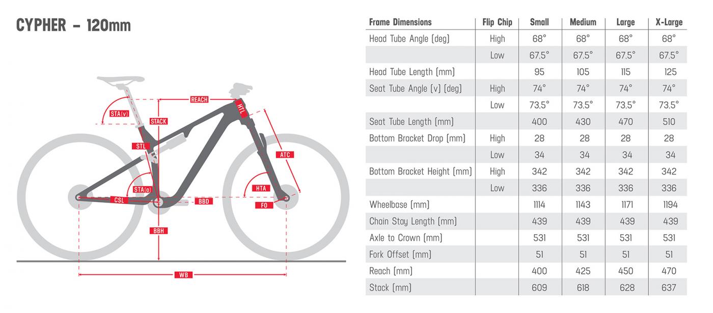

Cypher – 120mm
  • 120mm rear wheel travel
  • 120mm fork
  • BB height – 342mm (High setting) (*Est. Vittoria Barzo 2.35 tire)
  • Head tube angle – 68° (High setting)

One bike with a little more variety, because every trail is not the same. The decision to include a flip-chip into the design expands the riding capabilities of the Cypher and Cypher RS, enabling the ability to customise the geometry to the preference of the rider for trail conditions. In the low position, the head angle is reduced by half a degree, and the BB drops by 6mm. This allows riders to take full advantage of the bike and hit the descents and technical sections with elevated velocity.

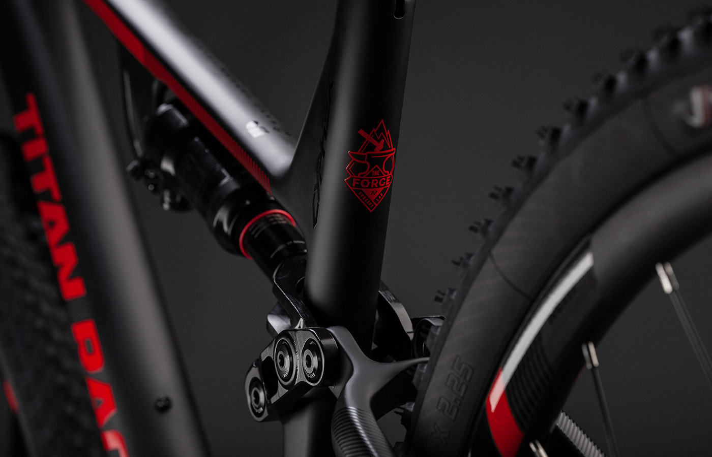

Both the Cypher and Cypher RS have been designed around 1x drivetrains specifically. A gently progressive leverage ratio is balanced between the ability to resist harsh bottom outs while still allowing the full use of travel. Progressive means that more force needs to be applied the further into the travel the rear axle moves in order to compress the shock – this makes for a supportive ride feel that is stable and composed. The leverage rate has been optimised so that it is not overly progressive, allowing for full use of travel. Anti-squat figures have been calculated to function optimally around 85-115% on 32T – 34T chainrings, those being the most popular size for 12-speed drive systems.
The Details

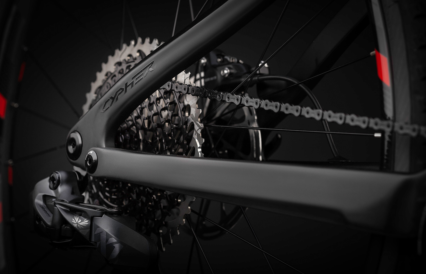

Keeping up with industry trends and innovations the Cypher and Cypher RS frame use BSA threaded BB cups as opposed to press-fit for ease of maintenance and rider concerns over creaky BB’s. Additionally, the frame has internal cable routing solutions for a stealth dropper post, all gear shift cables, rear brake, and a remote lockout cable for the rear shock. Rear-axle standard is Boost 148, which allows us to maximise tire clearance without having to compromise on the rear centre length. The Cypher and Cypher RS can carry two water bottles inside the front triangle where they can be easily accessed while riding, a must for racing. A low standover height is perfect for those technical sections and showing your buddies your best whip.
