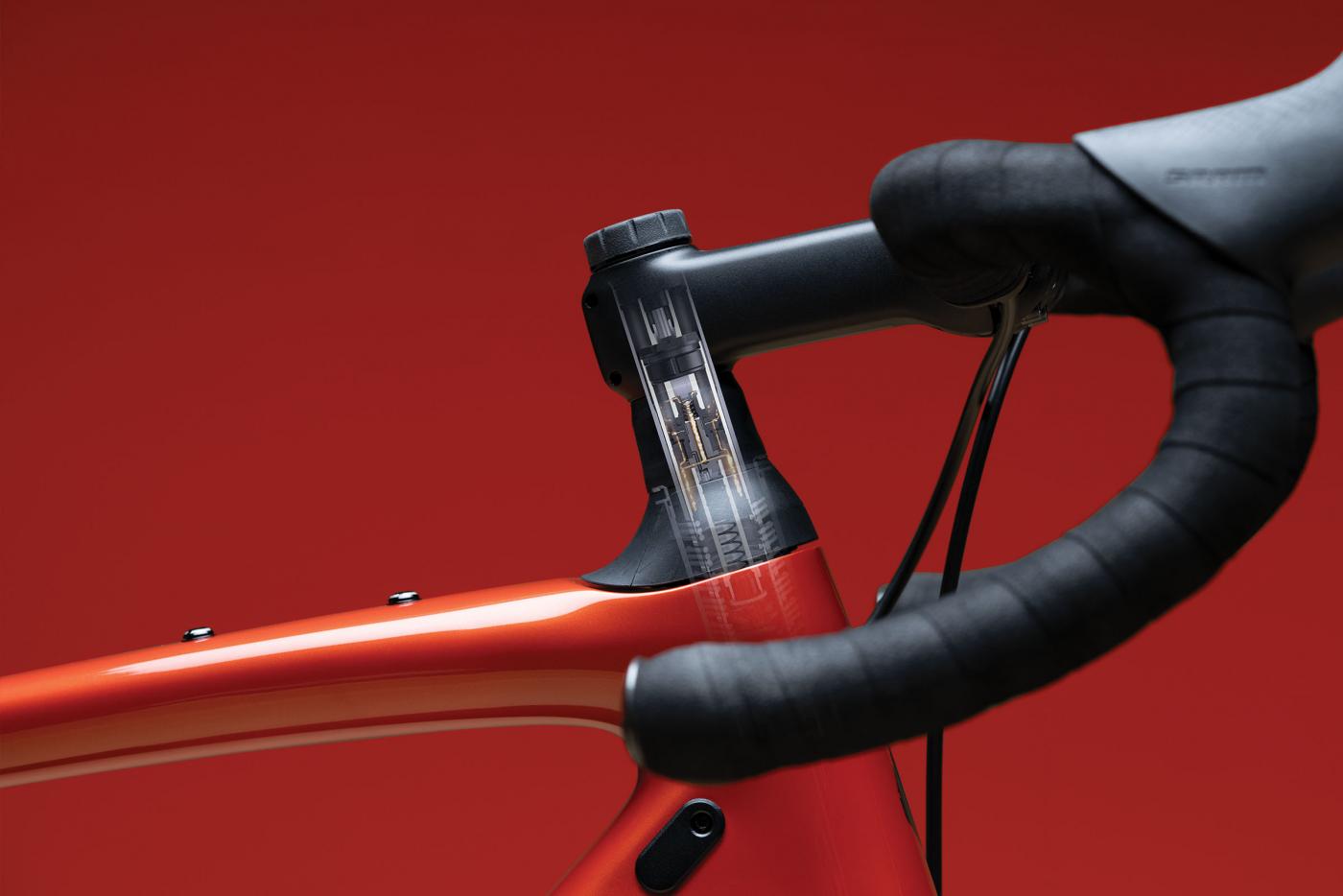

Future Shock 2.0
Sure, we made Future Shock for cobbles, but turns out it’s the ultimate technology for riding rough road, thick gravel, and chunky dirt. Future Shock 2.0’s adjustable, hydraulically damped travel keeps you in control and on target, all while protecting your hands, arms, and shoulders from the battering.

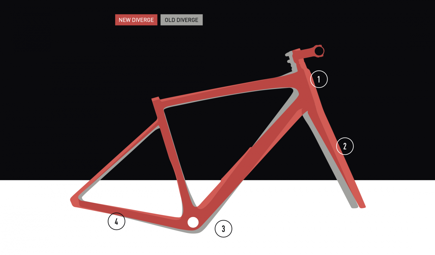

“What geometry is a gravel bike supposed to have?” Wrong question. “What does the gravel rider need?” That’s more like it. Status quo tossed out the window, we created geometry so progressive it’s a revelation in the saddle. That little voice in the back of your head saying, “Stay off the brakes, you got this,” just got a lot louder.
1. Longer and Slacker
Inspired by the Epic, a slacker headtube, longer reach and shorter cockpit keeps the Diverge stable so you can stay in control and on the gas in soupy gravel and rutted dirt.
2. Offset
With some slide rule wizardry, the Diverge’s new fork has increased offset to ensure all that stability at speed never feels slow at the bars or ‘floppy’ at the front wheel.
3.Go Higher, Stay Lower
We raised the Diverge’s bottom bracket by 6mm, improving pedaling clearance and making it more nimble, but at 80mm of drop, it’s still among the lowest in gravel for true stability.
4.The Short and The Long Of It
At 425mm, the Diverge’s chainstays keep the wheel tucked under the rider for lively acceleration and nimble handling, while perfectly balancing the bike for ultimate confidence.

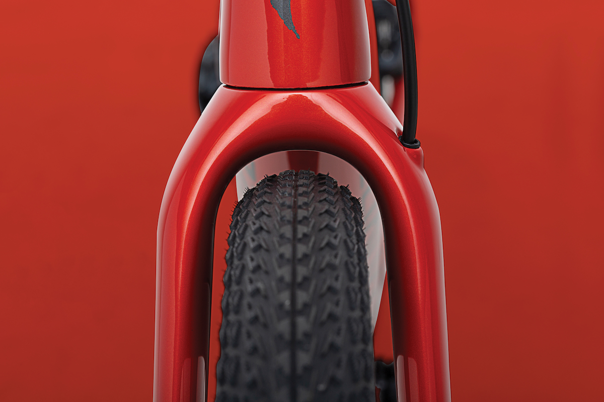

More Clearance = More Fun
Nothing unlocks potential like tyre clearance. Luckily, we’re feeling generous. Very generous—47mm on a 700c wheel and 2.1” on 650B. Crazy, we know, but wait until you rip a descent with that much rubber. Hallelujah!

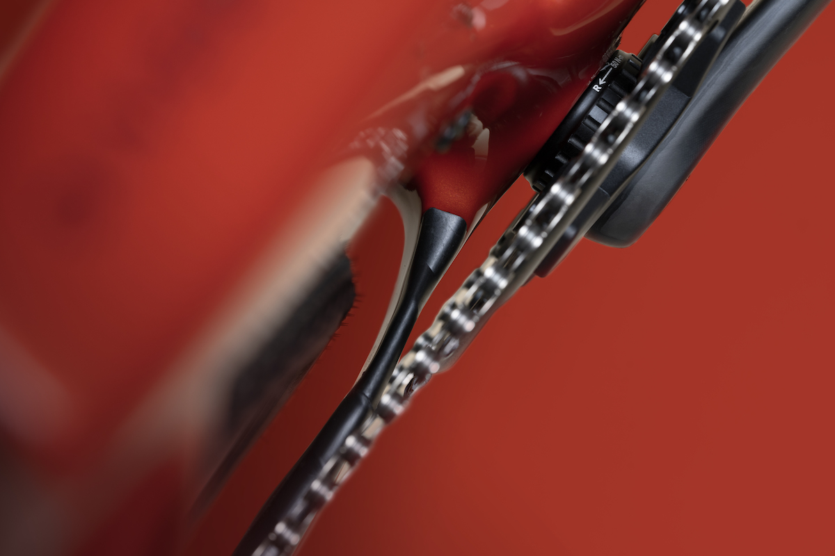

Chainstays Reinvented
We wanted mega-tyre clearance, but we didn’t want to resort to long chainstays or a heavy, vulnerable, dropped-stay design. The answer? Our drive side chainstay is a narrow, solid beam of carbon between the tyre and chainrings. You can have your cake and eat it too.

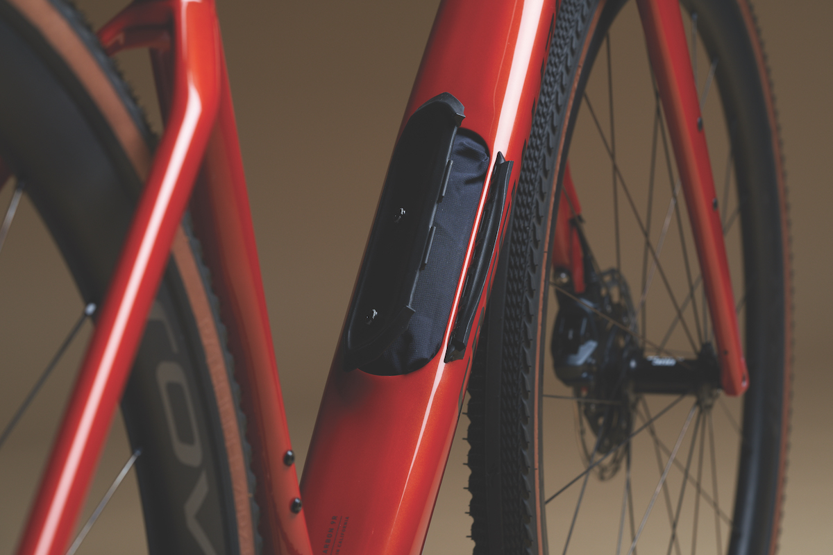

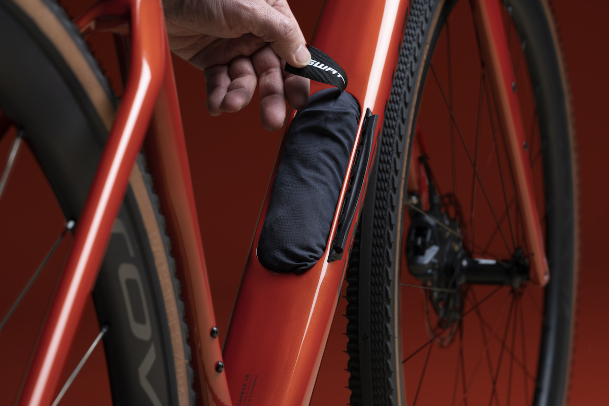

Everything You Need, Right Where You Need It
The Diverge’s internal SWAT compartment takes gear out of your pockets and puts it low in the frame, improving handling and keeping you more comfortable. Go ahead and rip past that first aid station, or take extra gear to escape farther into the unknown. Dual SWAT pouches keep it all dry and organised.

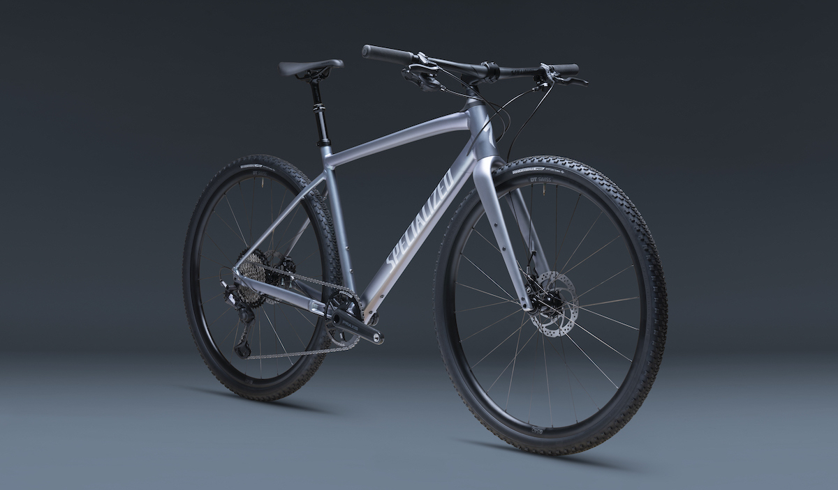

Shockingly Faster, Seriously Funner – The Diverge EVO
But wait, hang onto your flannel! We’re not done pushing, prodding, and challenging this thing called gravel. What’s next? Who the hell knows? But we’ve made the bike that’ll find out. The Diverge EVO is an alloy badass, a gravel rig with flat bars in the key of “Send It!” Slacker, longer, and fitted with the new Rhombus tyre—whatever you get into, send us video.
ccs-62657-0-11227600-1588862658.jpgThe Specialized Diverge EVO is a longer, slacker, more capable gravel bike.

What is the difference between Future Shock 2.0 and Future Shock 1.5?
Future Shock 1.5 delivers 20mm of suspension to the front end of the bike, providing the rider with increased control and comfort on all terrain. Its location on the bike is critical to providing axial compliance and isolating the suspension action from rider pedaling inputs.
Future Shock 2.0 is our most advanced offering. On top of the benefits of Future Shock 1.5, it adds a hydraulic damper that provides both compression and rebound damping. There is also an adjustable dial to control the level of damping and make the front end firmer, if desired.

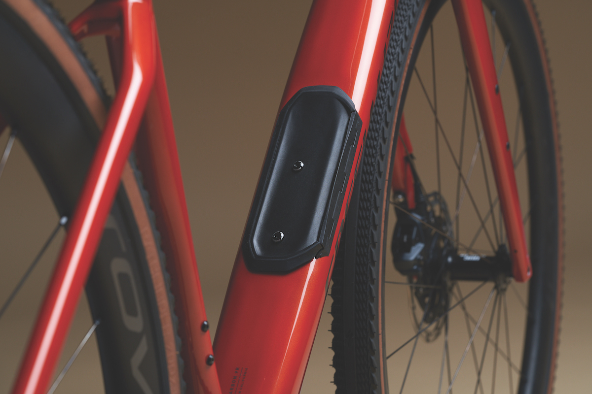

Is the SWAT door different than on mountain bikes?
No—we’ve utilised the same, tried and true SWAT door that is on Specialized mountain bikes.
What can I store in the SWAT down tube?
Your imagination is the limit when it comes to down tube storage. We have designed two specific SWAT pods to fit inside the frame and keep your gear protected. The larger SWAT pod is designed for storing a tube, tyre lever, and CO2, while the smaller pod is designed for other items such as a multi-tool or keys. Specialized SWAT jackets pack into their breast pocket and can be stowed in the down tube as well.
