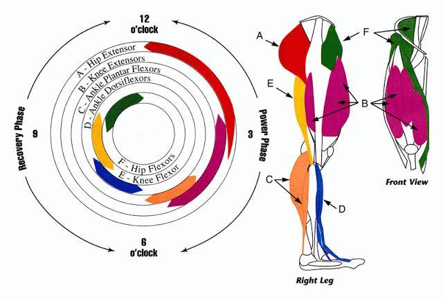

With reference to the diagram above, the main power phase of the pedal stroke is from 1 o’clock to 5 o’clock. This is where a rider will produce the most force during the pedal stroke. The major muscle groups used here are the glutes and quadriceps.
The next phase can be seen as a transition phase between the power phase of the stroke and the recovery phase. This usually occurs between 5 o’clock and 7 o’clock, and is most commonly known or explained as that sensation of “scraping mud off the bottom of your shoe”. This is where the dorsiflex muscles of both the calf and ankle are used; they can be referred to as a stabilizer of the entire lower leg. This motion will set your foot up as a lever for the next phase.
In the recovery phase of the pedal revolution the leg will move from 7 o’clock to 10 o’clock using the hamstring to pull up through the back of the stroke, all the time ensuring the foot is kept level to gain most leverage out of the foot.
