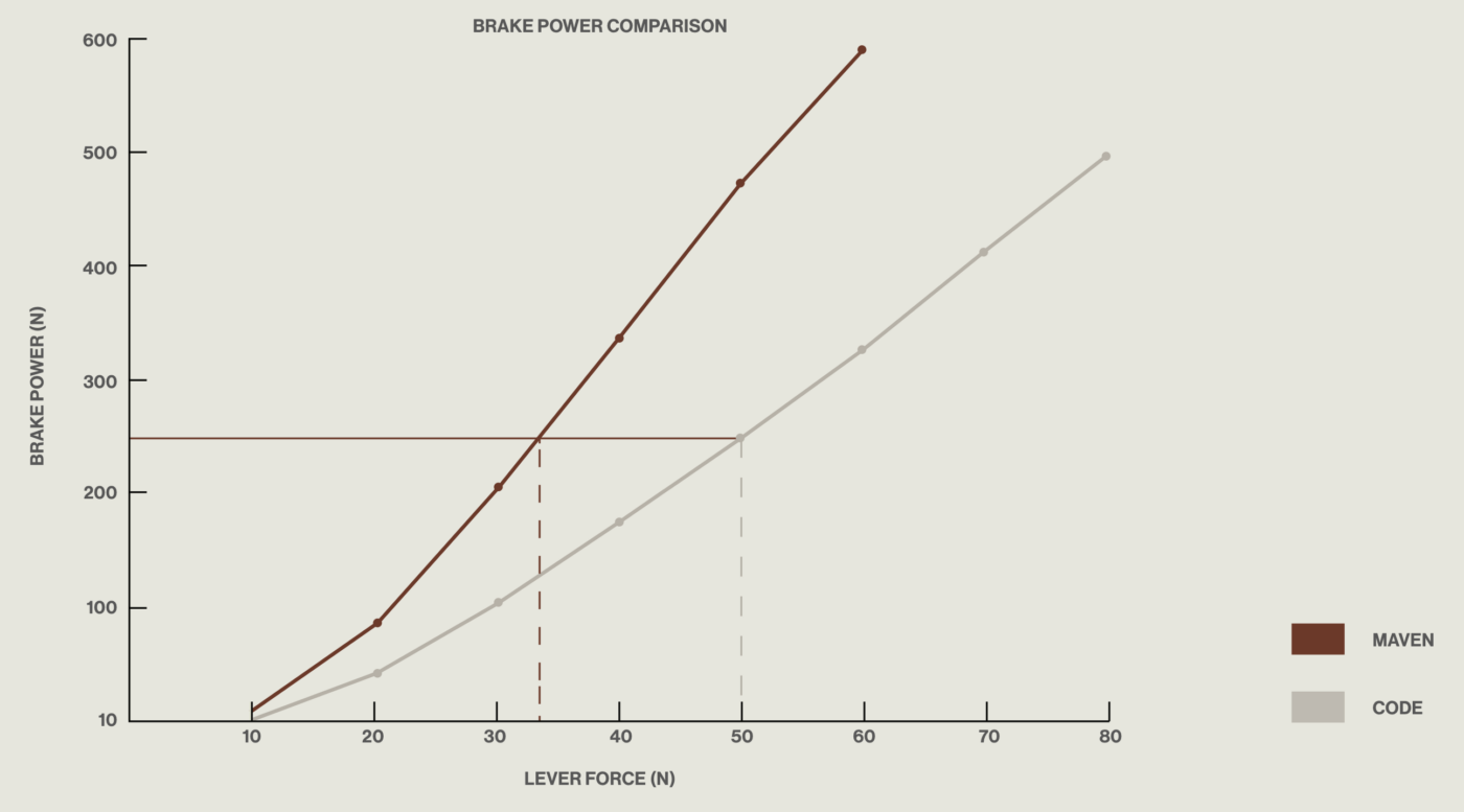

Maven produces nearly 50% more power than one of the most capable brakes ever, SRAM Code. While it’s tempting to focus on this fact alone, Maven is about more than brute force.
Less Effort
More important than overall power is usable power. With Maven, it takes 32% lighter force at the lever to generate the same amount of power as Code, reducing fatigue and boosting control for rowdy DH terrain, relentless e-mtb laps, and long enduro stages. Ride harder, and longer, Maven delivers the best of both worlds.

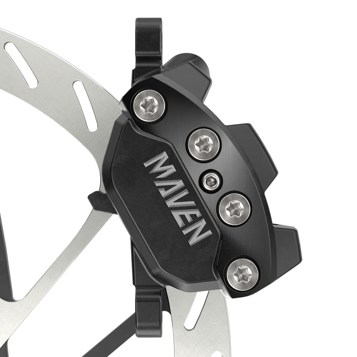

Power in Surplus

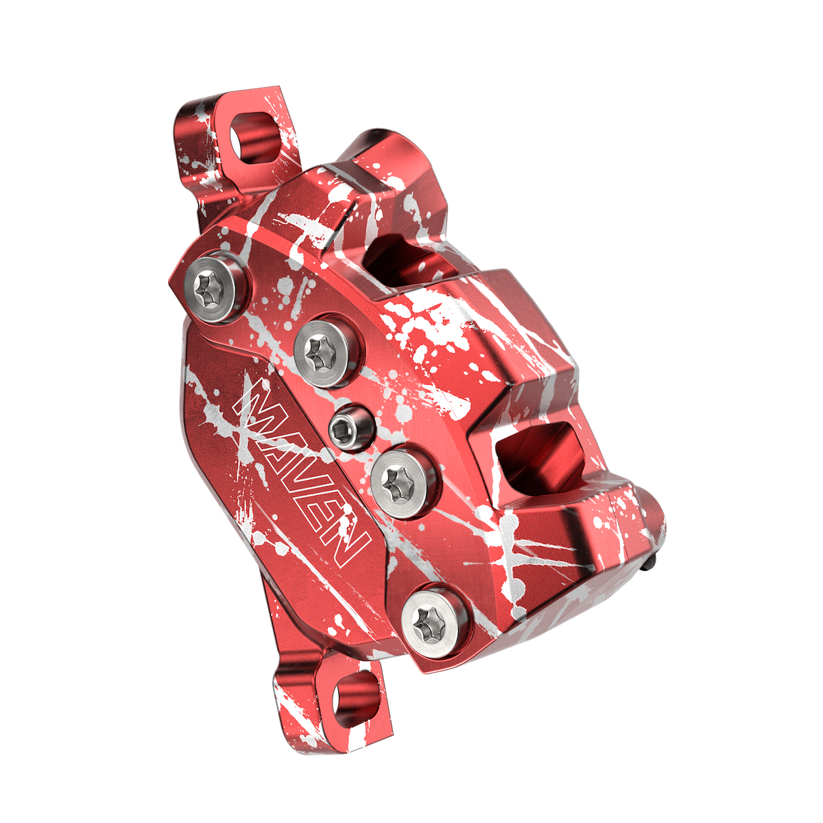

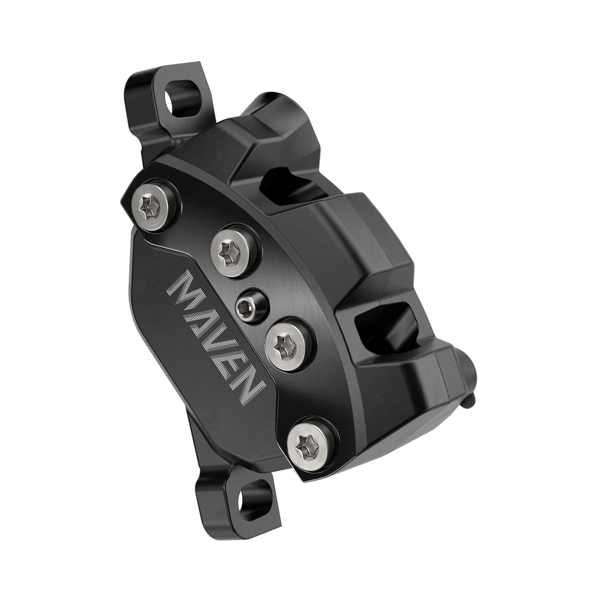

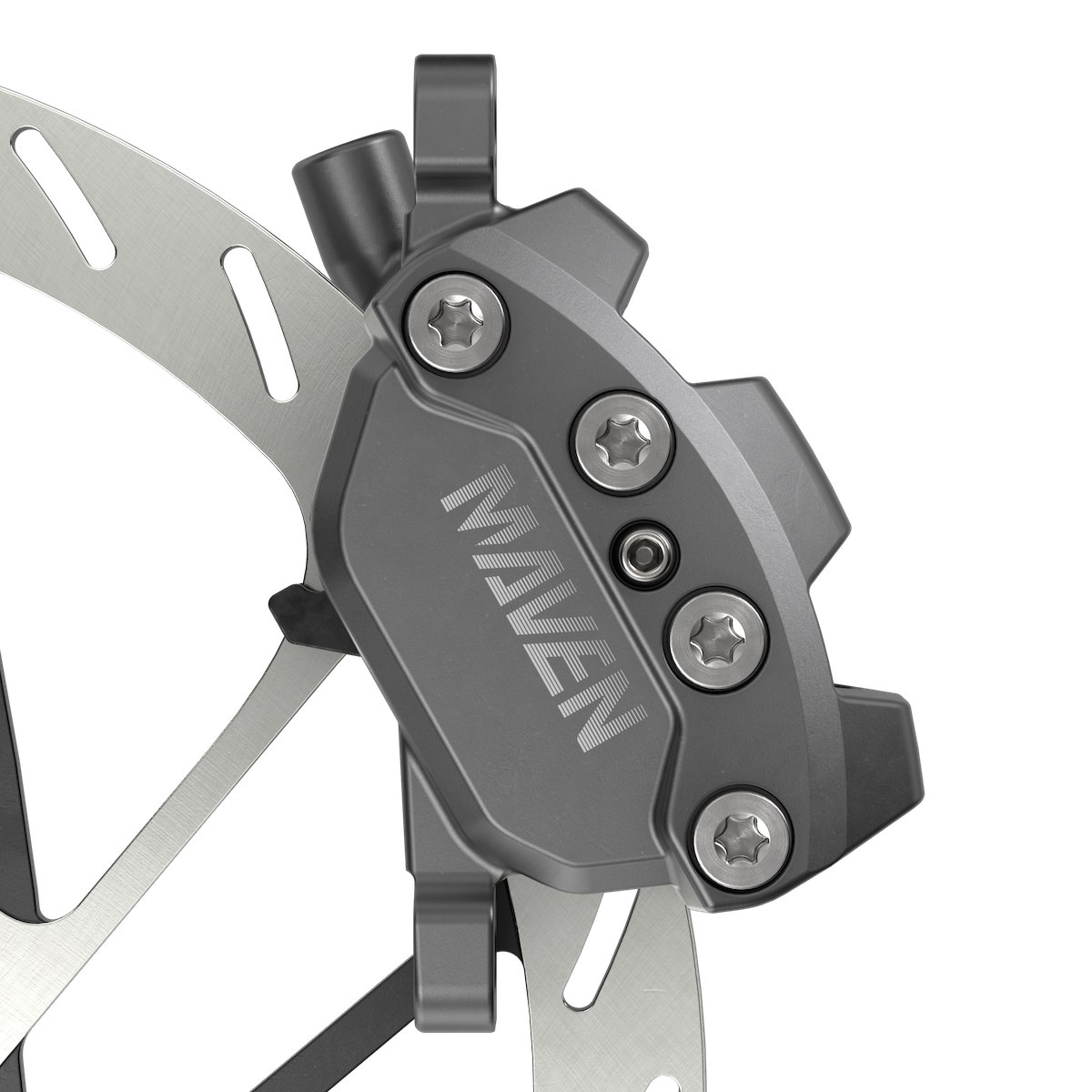

With four caliper pistons measuring 19.5mm and 18mm, there’s no way around it: Maven caliper pistons are simply huge, providing more force against the pads for more friction with less effort.
Profressive Power for Control
Optimized for Maven, SwingLink delivers a rate of leverage that changes throughout the lever stroke. The farther you pull along the arc, the more power Maven sends to the pistons. This progressive power delivery offers unrivalled control. As opposed to the binary characteristic of an “on/off” feel.
Better Ratio
Huge caliper pistons mean nothing unless the ratio of piston size in the lever is designed to work with them. Power is determined by the relationship between these piston sizes, and Maven delivers a superior optimization of this ratio.

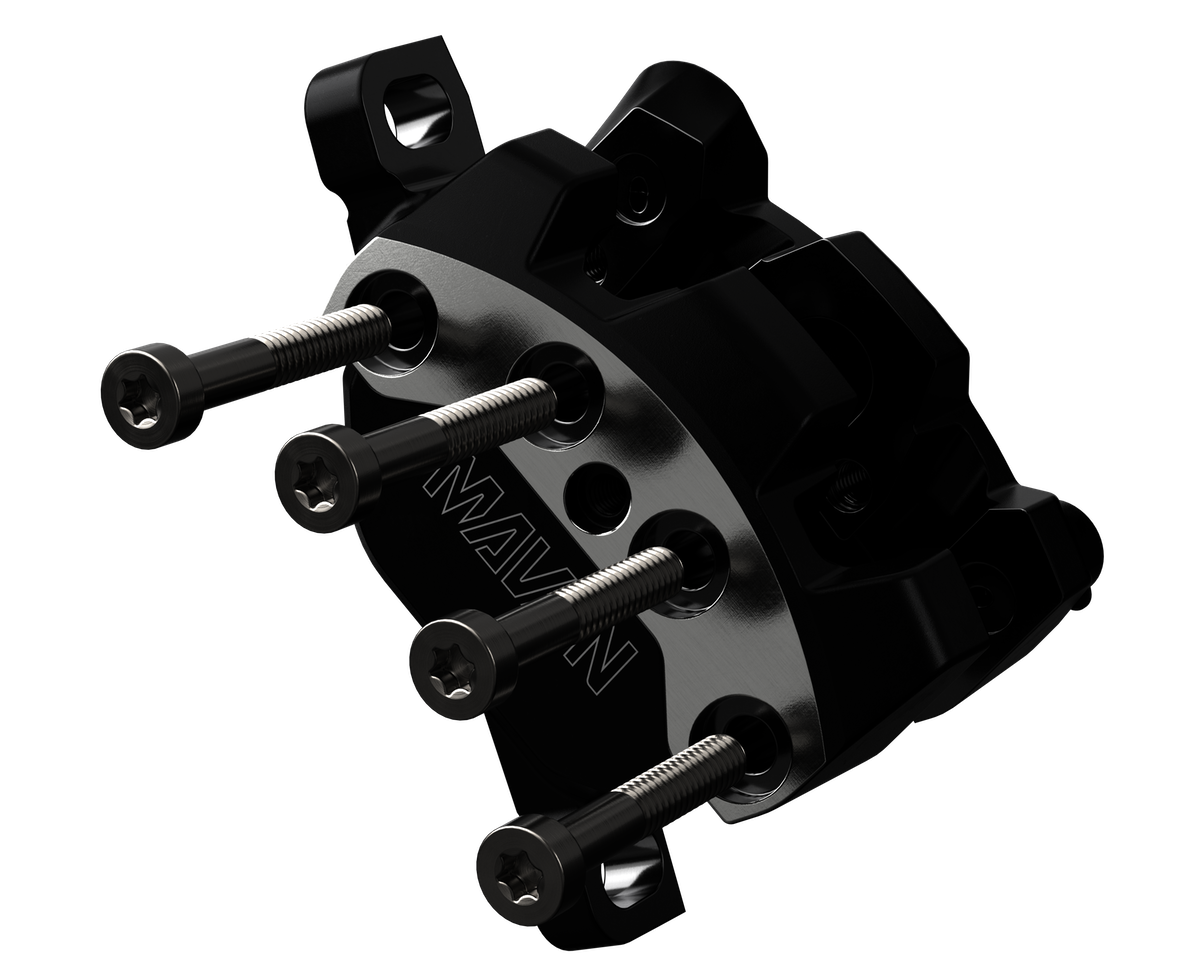

Four Bolts for Power
Measure any brake caliper under power and you’ll find flex. Maven’s four caliper body bolts aren’t just for show. They reduce power loss at the caliper, translating to a solid feel in the lever, befitting its power.

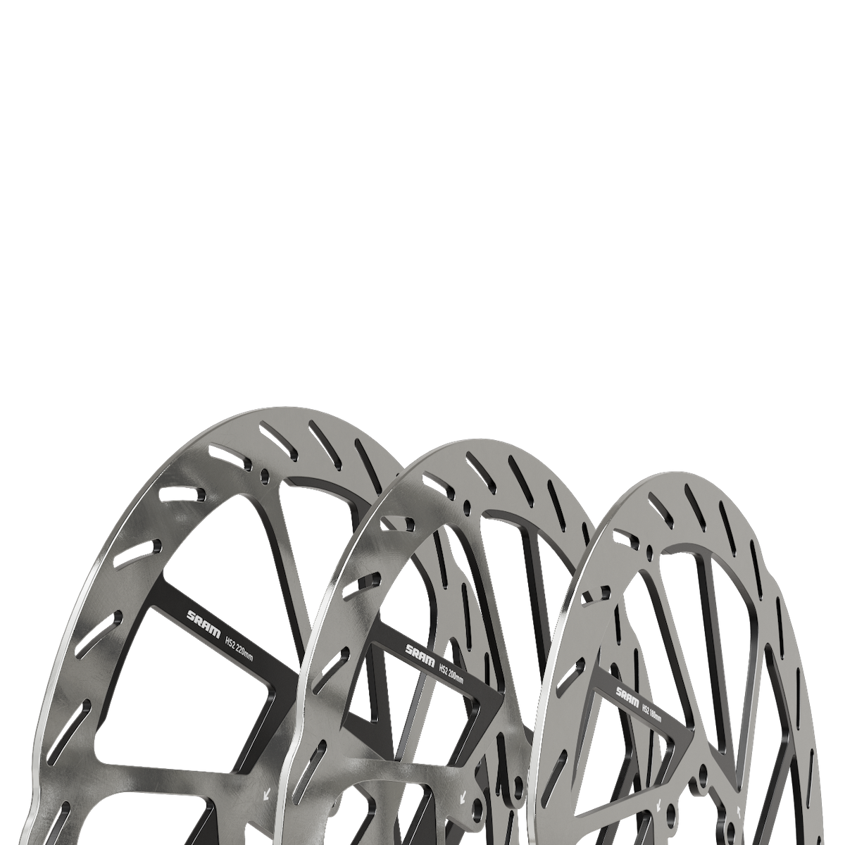

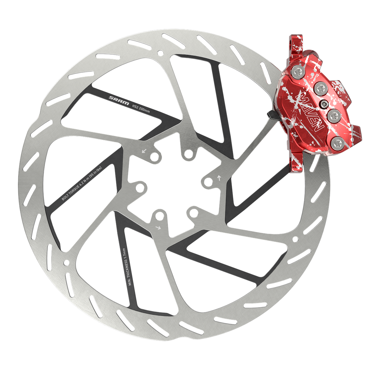

Rotors
Start small – the smallest rotor size that your frame and fork can accept is the recommended starting point when tuning Maven.
For every 20mm jump in rotor size, the mechanical advantage is 14%. This means that going from a 180mm rotor to a 220mm rotor would boost system power by 28%.
But too big of a rotor could also lead to not enough heat being generated, and a smaller rotor where the optimal amount of heat is being generated could actually have more bite on the trail. Paying attention to the colour of the spokes on your rotors can be a tell of how your rotors are performing.
  • Browned or bronzed discoloring means the size is optimal.
  • Purple or rainbow discoloring means your rotors are running too hot and sizing up would be suggested.
  • No distinct discolouring would suggest they aren’t getting hot enough and sizing down would lead to optimal performance.
  • Choose HS2 rotors for 7% more power and better heat management, or CenterLine rotors if less power and weight saving is the objective.

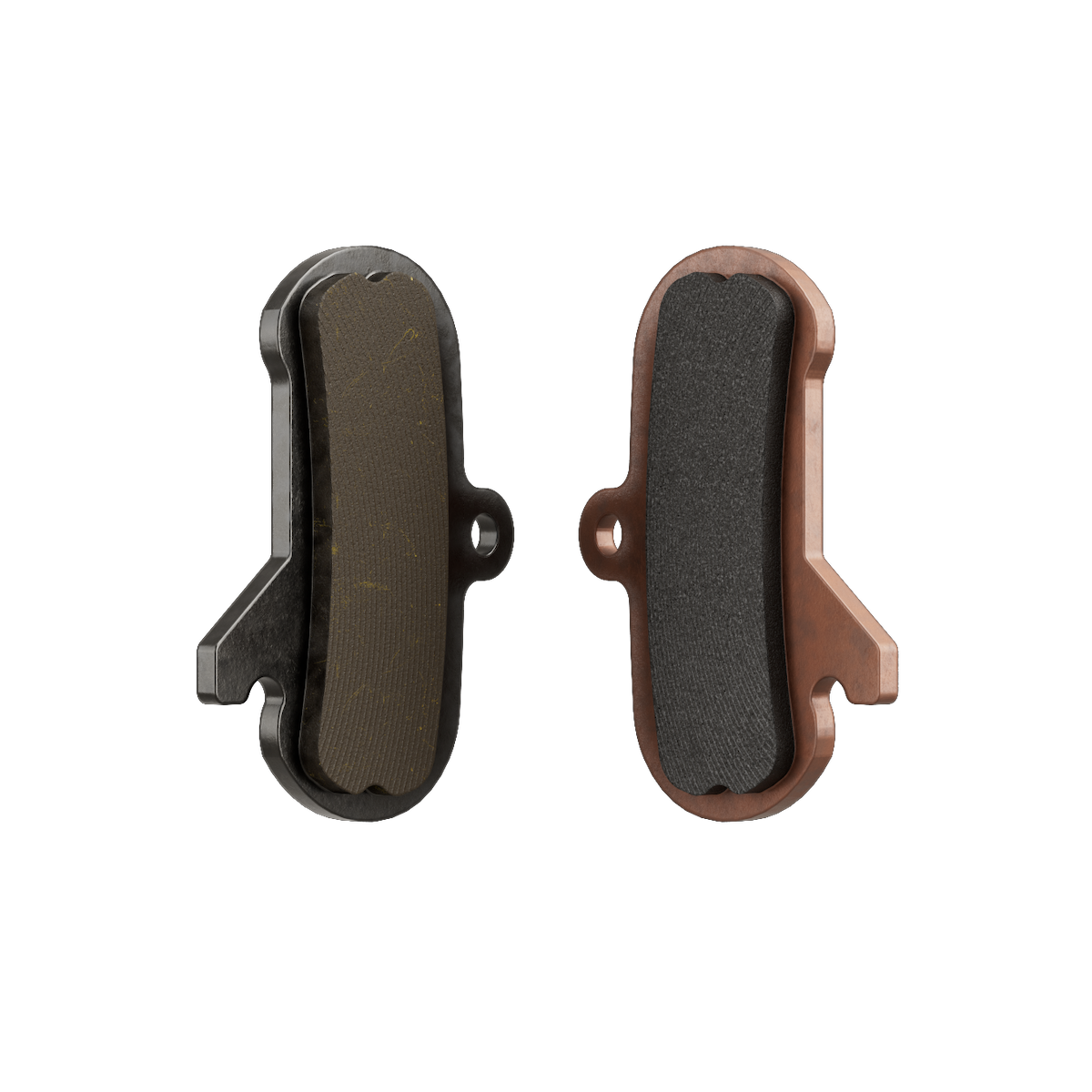

Brake Pads
Maven’s unique XL pad shape is available in two compounds, each with their own distinct characteristics.
  • Organic brake pads are great if you are wanting a strong initial bite feel and less overall noise. They offer the best performance in drier conditions.
  • Sintered brake pads are great if you are looking for the most resistance to sustained heat. They also offer better performance in wet or muddy conditions.

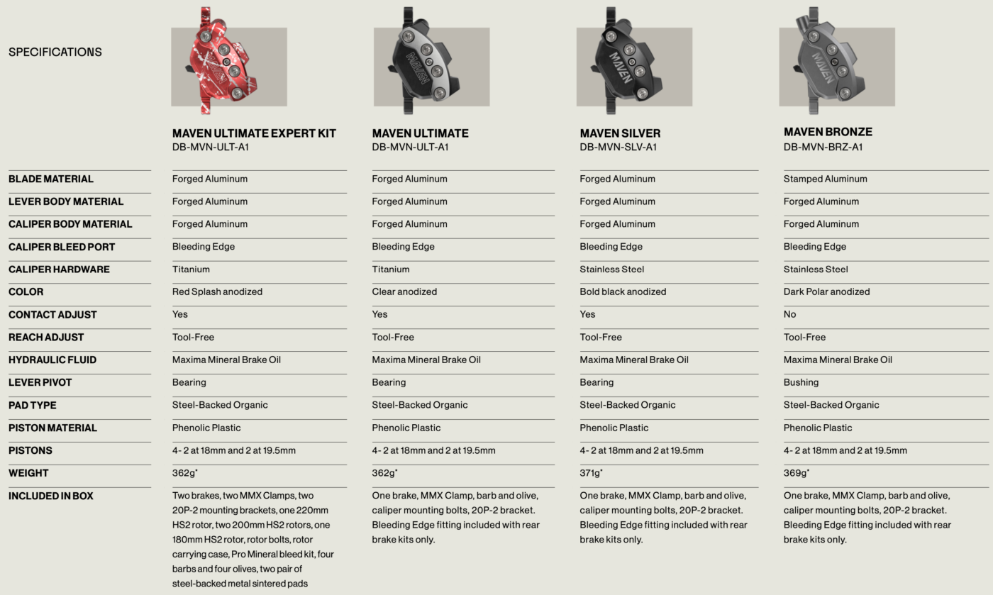

Maven Models

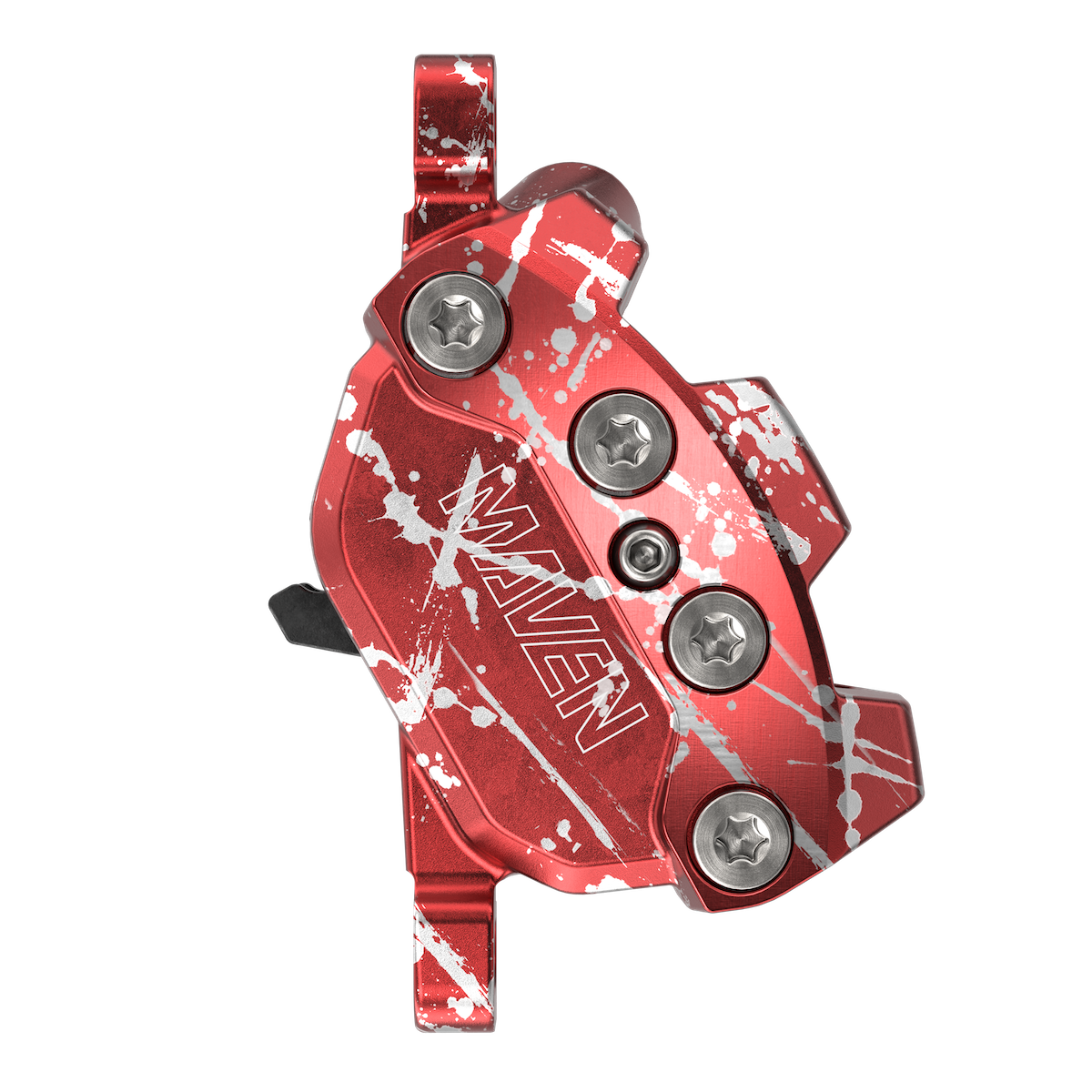

MAVEN ULTIMATE EXPERT KIT
Every course is different. As conditions change, so does the tuning of your brakes. The fully loaded limited edition Maven Ultimate Expert Kit is designed to provide everything they need to tune their Maven Ultimate brakes for optimal brake performance. Edition 1 comes with exclusive red splash anodized calipers that set the brakes apart from the rest of the collection.
  • 2x organic and 2x sintered XL brake pad sets
  • 4x HS2 rotors (1x 220mm, 2x 200mm, 1x 180mm)
  • 2x 20p brackets
  • 2x MMX clamps
  • Maven Ultimate brake set with limited edition Red Splash anodized calipers
  • Pro mineral oil bleed kit
  • Rotor travel bag

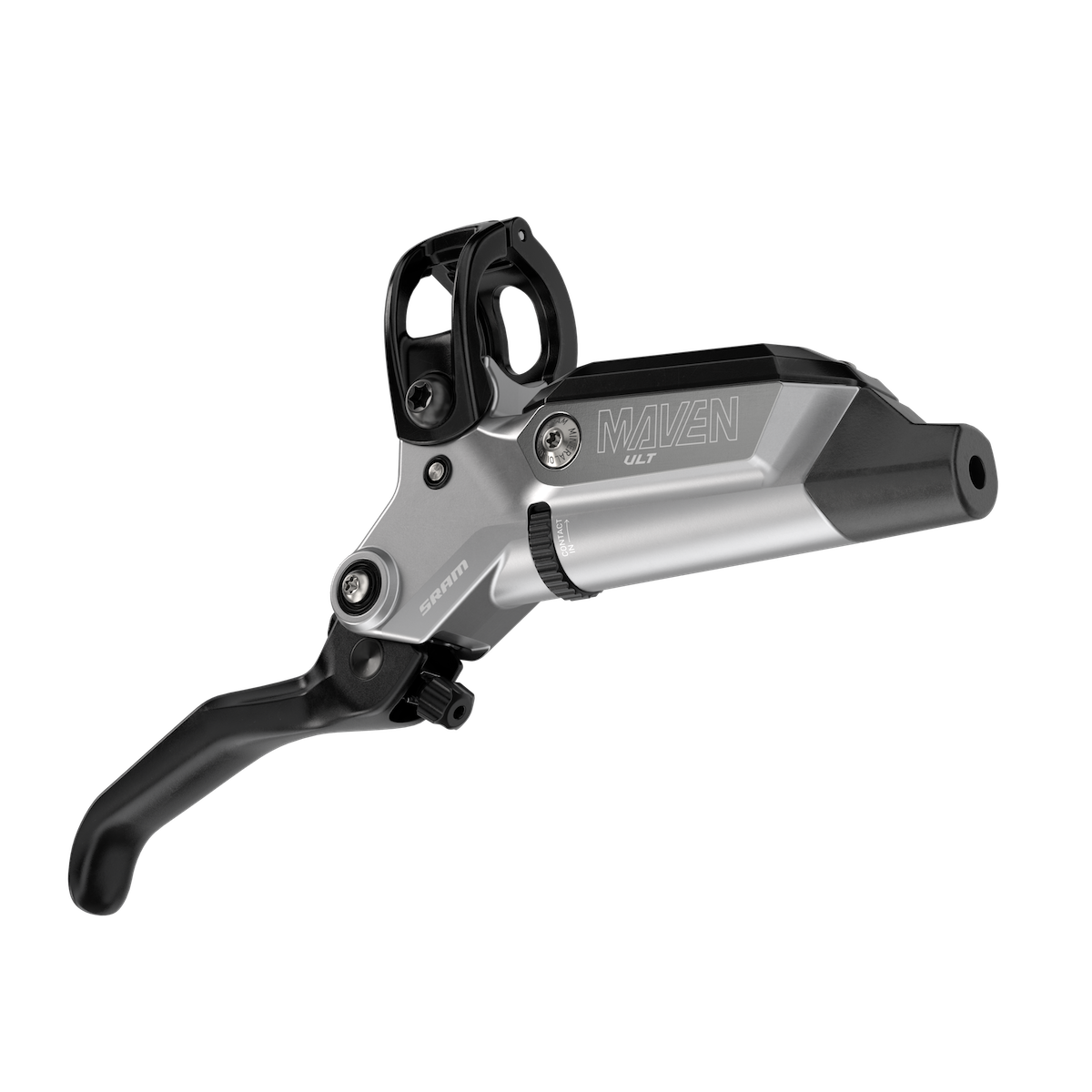

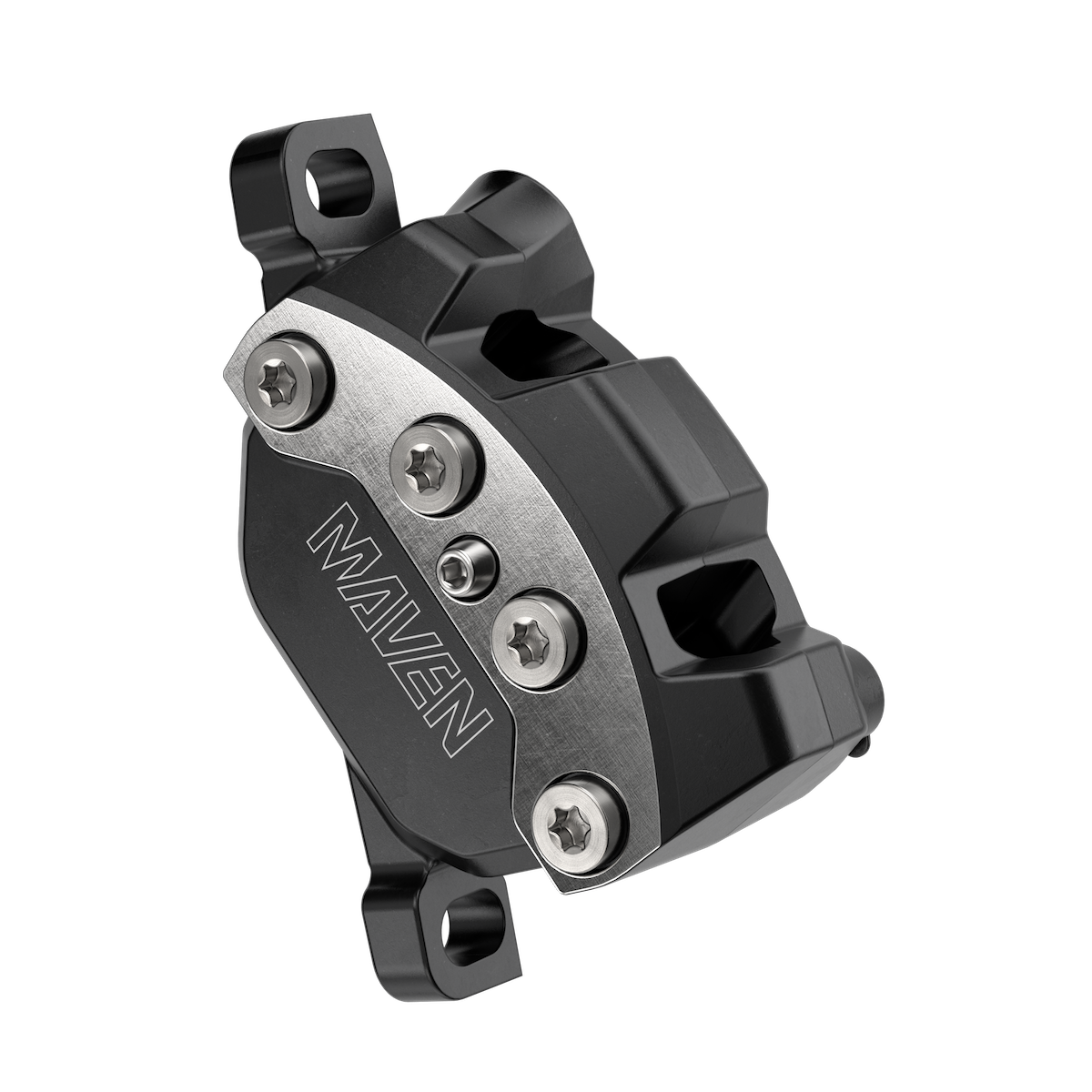

MAVEN ULTIMATE
Maven Ultimate pairs a sleek high polish lever body to a caliper with machined edges and titanium hardware for a finish worthy of any modern super bike. And for unrivalled ease of customization, features tool-free Reach and Contact Point Adjust. Maven is the expert, but Maven Ultimate is the pinnacle.
  • 18 and 19.5-millimeter pistons for best-in-class power
  • SwingLink for signature SRAM lever feel
  • Stiff 4-piston caliper with best heat management and easier bolt access
  • Organic pads come standard for the best modulation and the quietest ride
  • Stealth lever architecture for a sleeker, more modern ride
  • Mineral oil for low maintenance and performance
  • Designed for use with Maxima Mineral Brake Oil only
  • Ultimate worthy polished lever body and titanium hardware
  • Contact Point Adjust and tool-free Reach Adjust

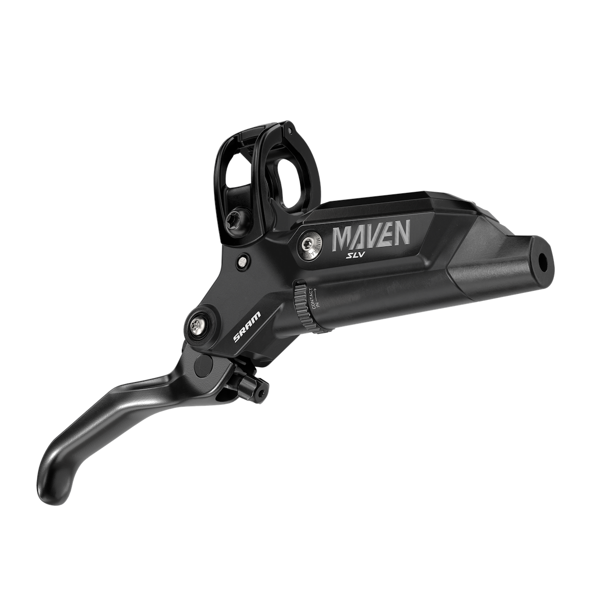

MAVEN SILVER
Maven Silver features a bold black anodized finish with stainless hardware. And for unrivaled ease of customization, features tool-free Reach and Contact Point Adjust.
  • Bold black anodized finish

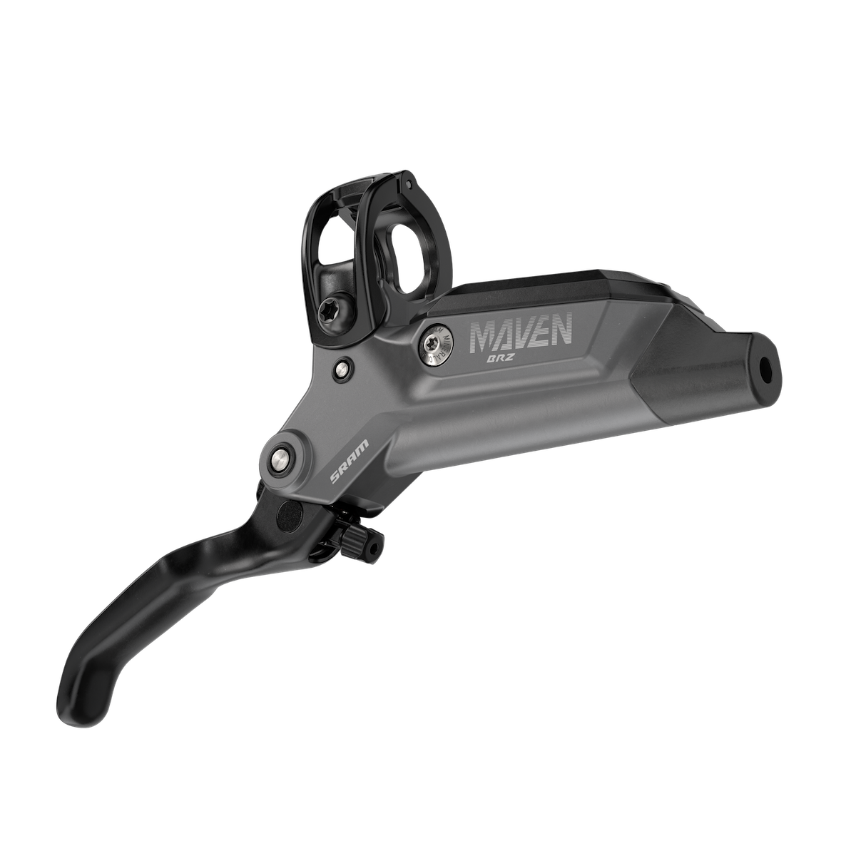

MAVEN BRONZE
Maven Bronze features a Dark Polar anodized finish, and for ease of customization includes tool-free Reach Adjust.
  • Mineral Oil for low maintenance and performance
  • Dark Polar anodized finish

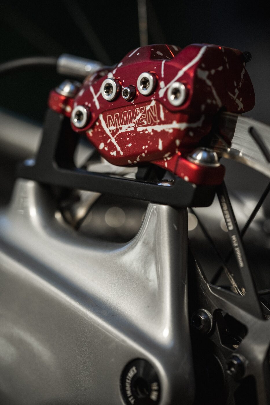

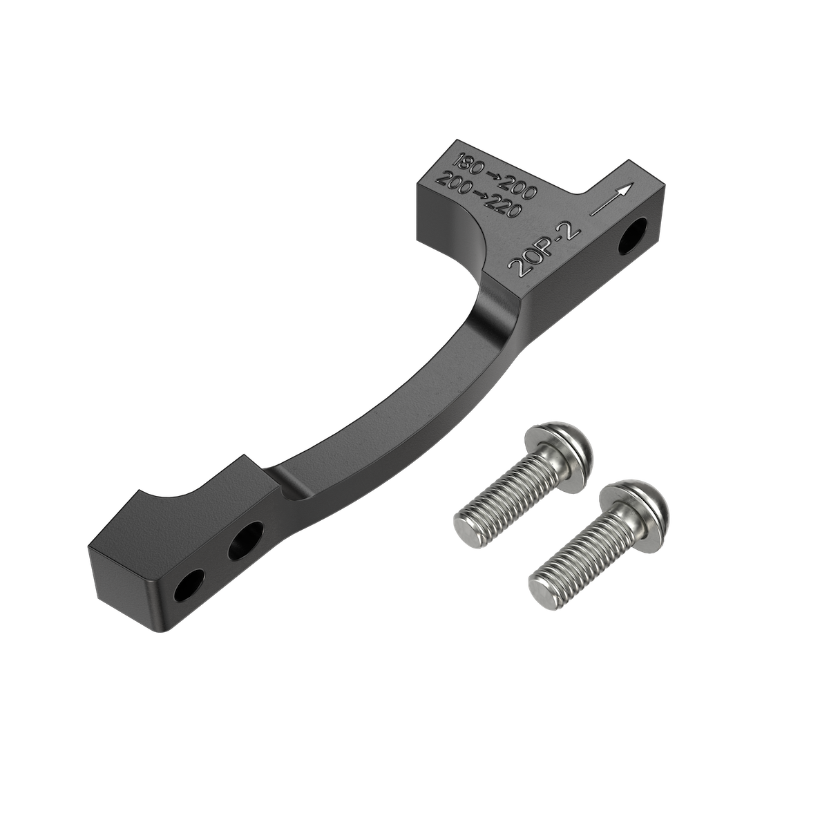

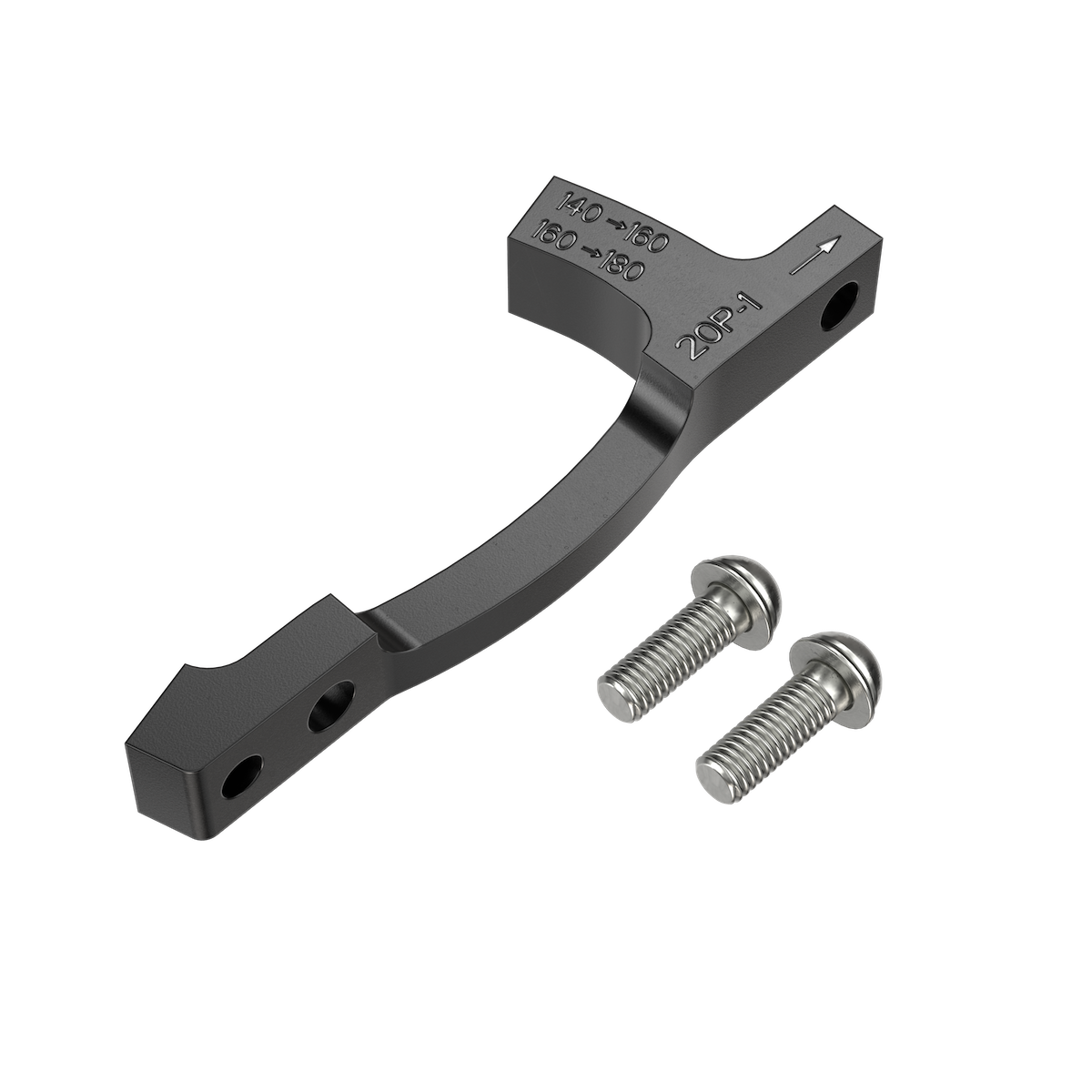

POST BRACKET 20P STANDARD MOUNT
It’s a bracket that makes sense. With a simplified approach to hardware, just four 18mm mounting bolts are required, and for the best possible rotor to caliper alignment, two size-specific brackets cover the four common rotor size combinations.
  • Maven requires this bracket for 20mm jumps
  • 20P-1 bracket for 160mm and 180mm rotors
  • 20P-2 bracket for 200mm and 220mm rotors
  • Four 18mm mounting bolts included
  • Stainless steel hardware
  • No CPS (concave/convex) hardware required

Why does the Maven caliper have four bolts instead of two?
Maven’s four caliper body bolts aren’t just for show. They create a stiffer caliper, which reduces power lost through flex, translating to a solid feel in the lever.
Why do the Maven brake pads load from the bottom?
The Maven caliper features four bolts holding the two halves together, resulting in a much stiffer caliper with a firmer lever feel. The four bolts are placed directly above the brake pads requiring the pads to be loaded from the bottom.
