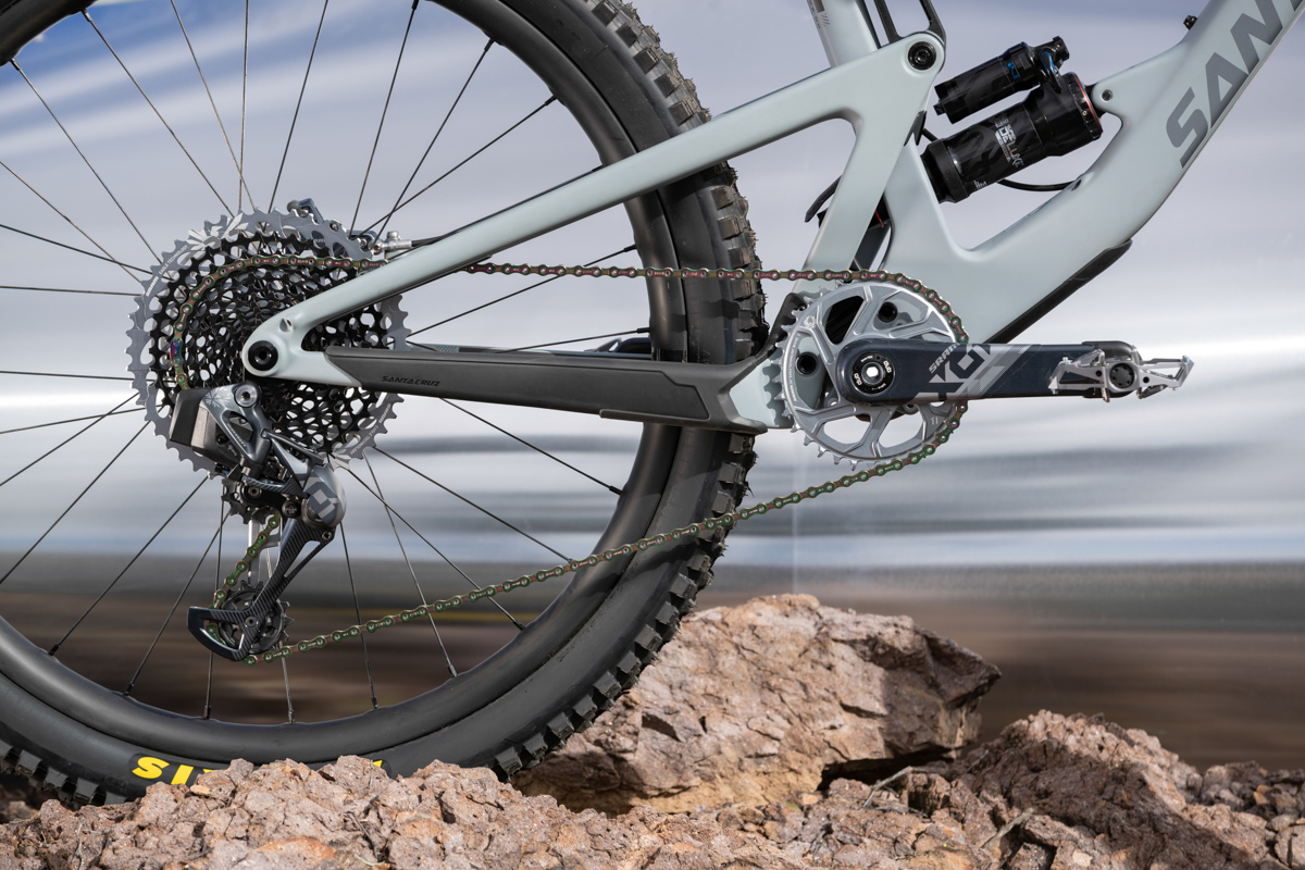

Eagle AXS XX1 vs Eagle AXS X01
At launch, Eagle AXS will be available on SRAM’s XX1 and X01 specification level groupsets.

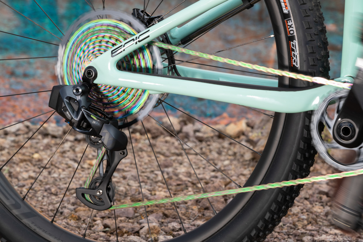

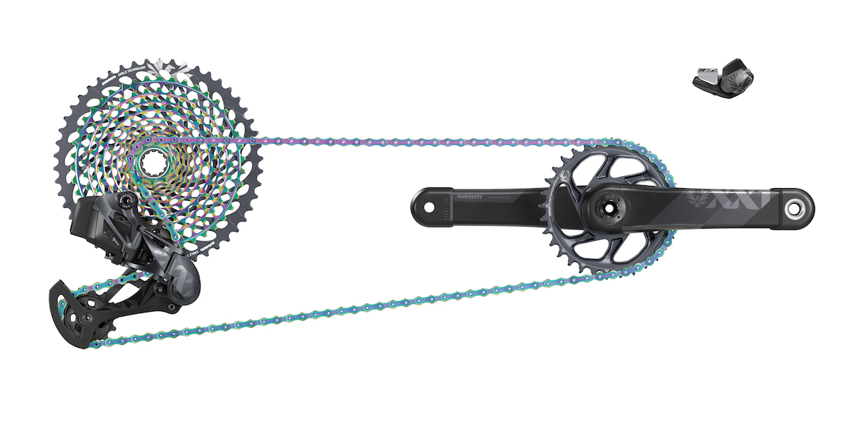

The Eagle AXS XX1 groupset employs cutting edge weight-saving materials such as a carbon derailleur cage and titanium hardware and is available in an oil-slick looking rainbow colourway. The XX1 groupset is marketed as being suitable for cross-country and light trail use.

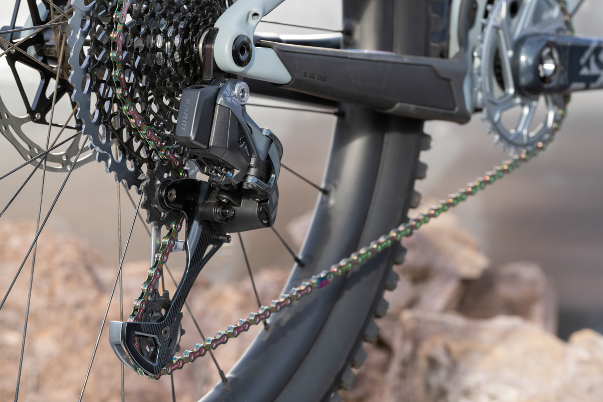

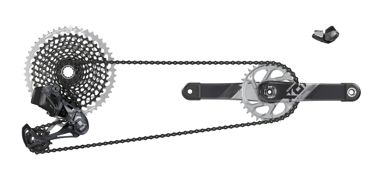

The Eagle AXS XO1 groupset with a forged aluminium cage and stainless steel hardware is said to cope better with more aggressive trail and enduro riding styles. It is available in a black and polar (powder grey) colourway

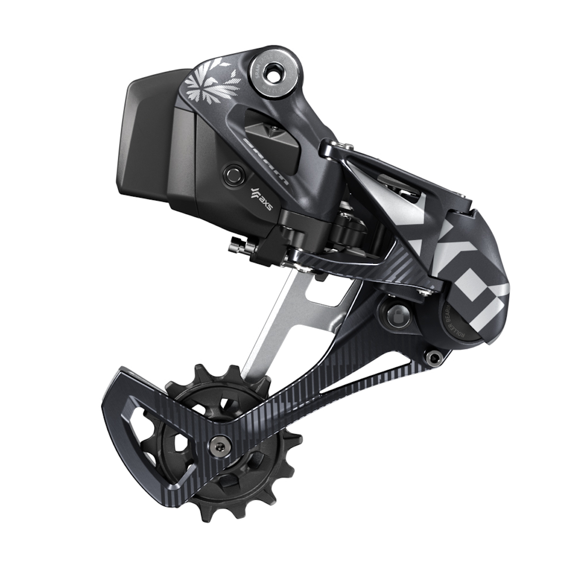

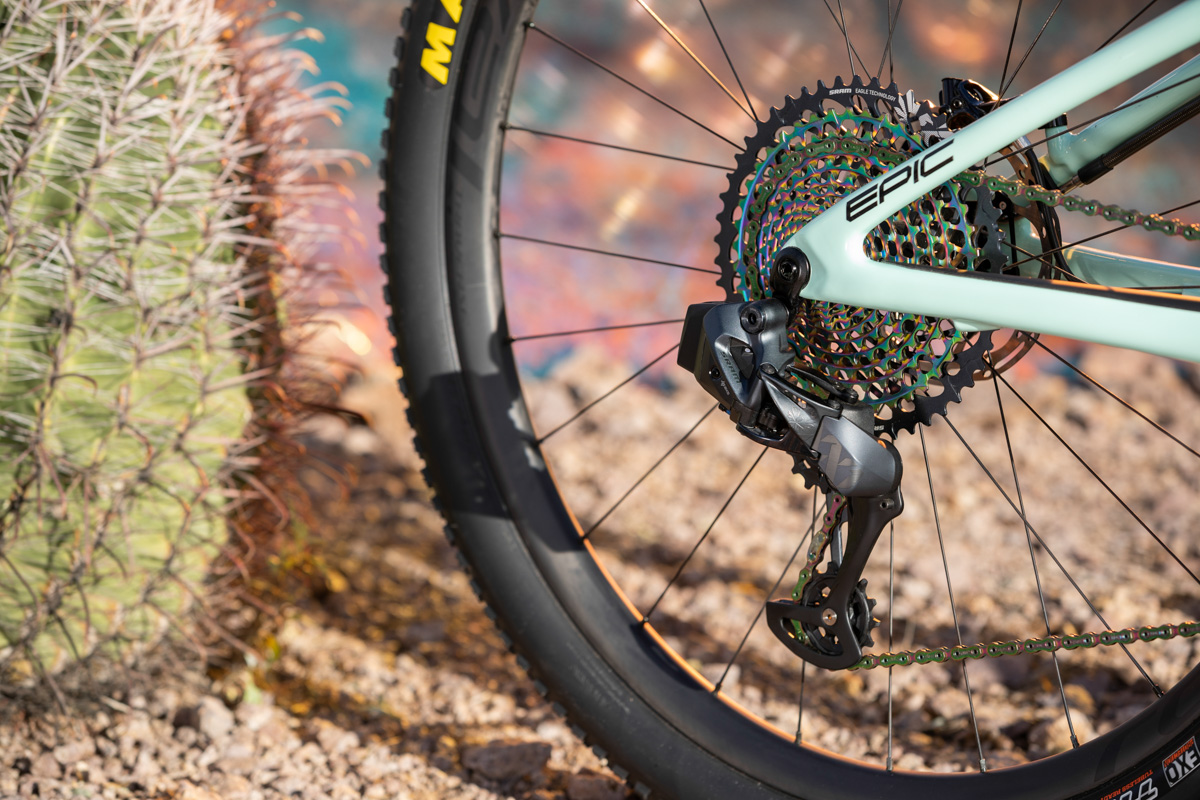

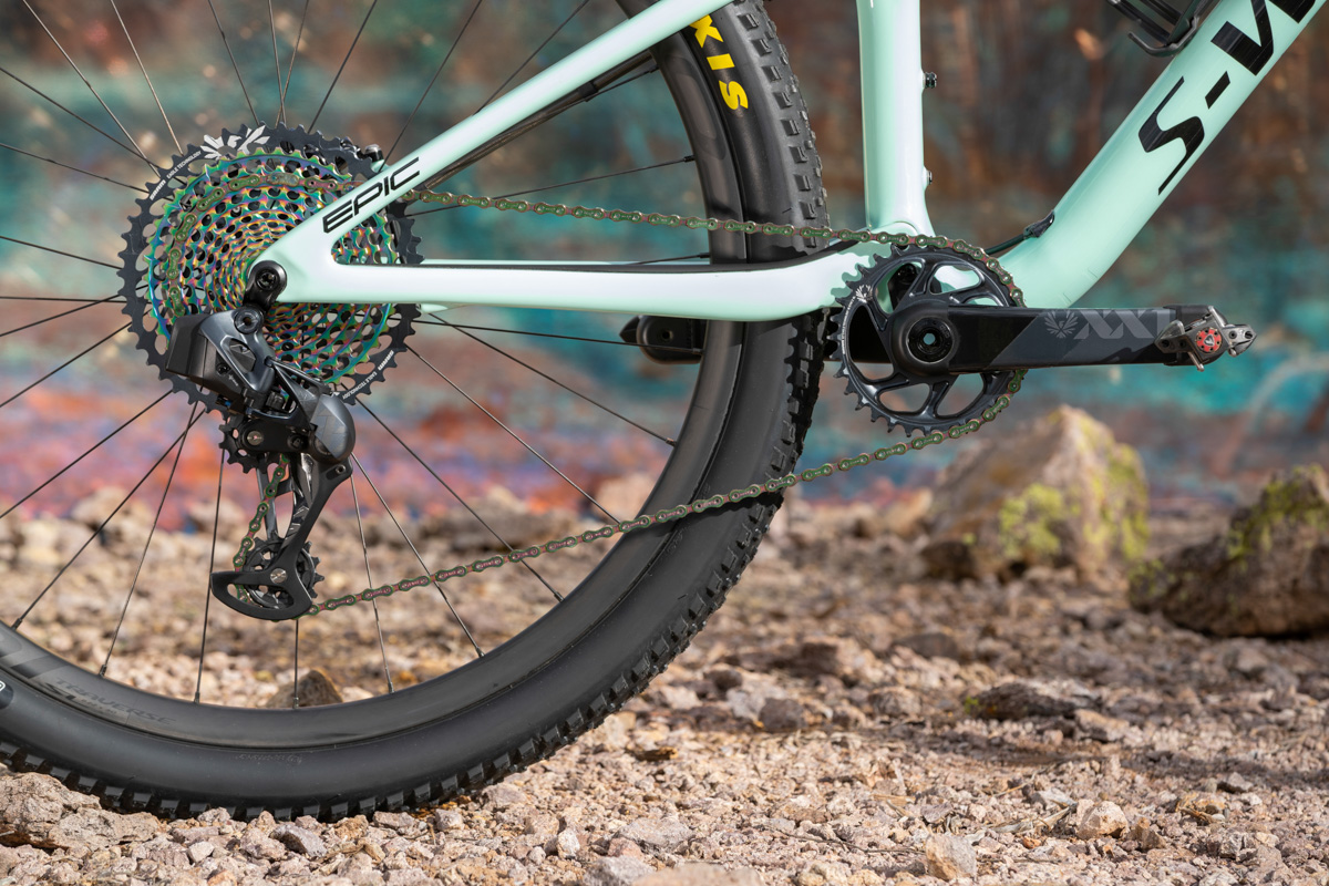

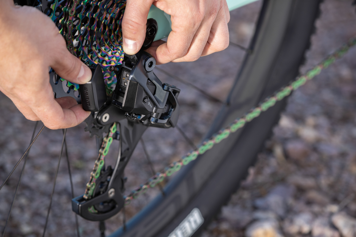

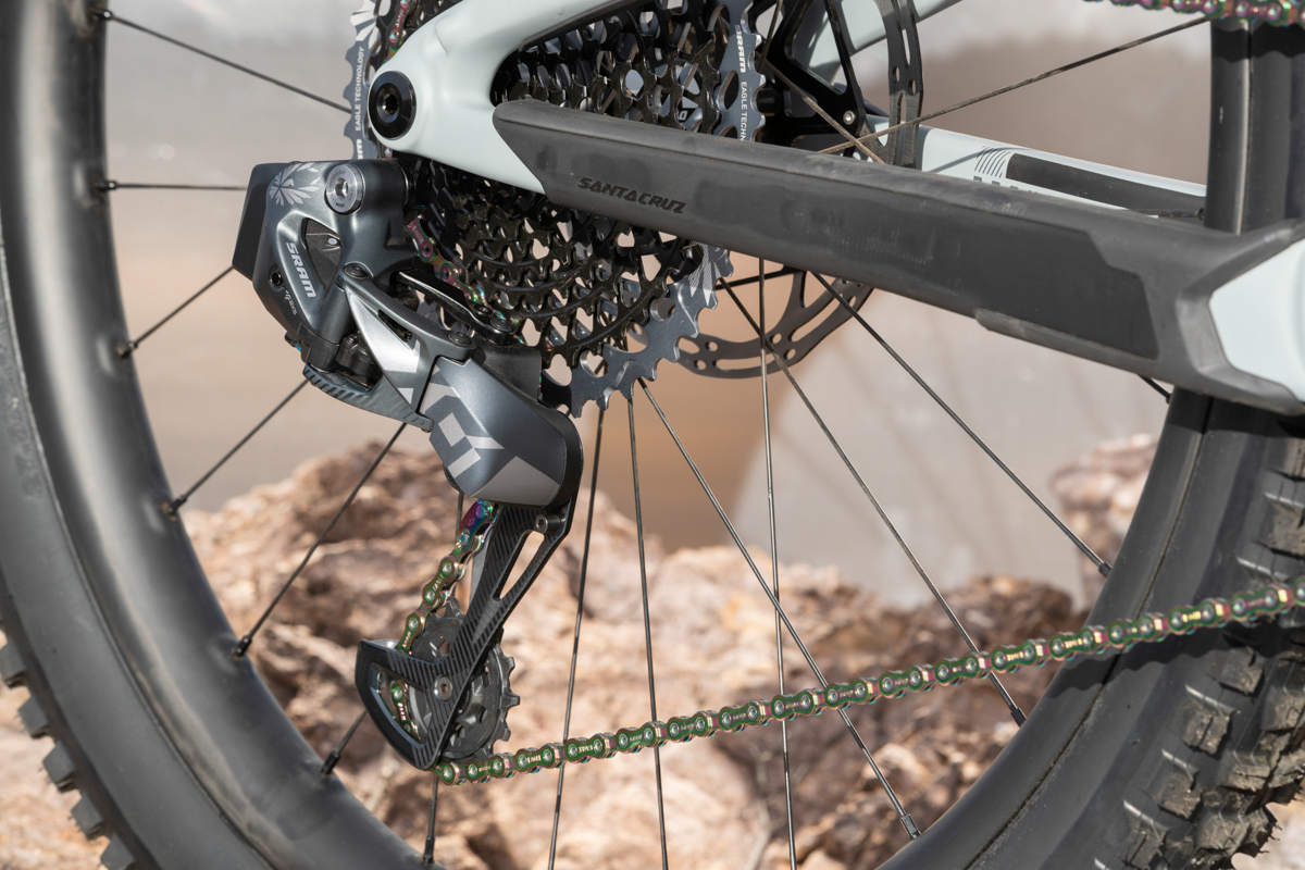

Eagle AXS Derailleur
The Eagle AXS derailleur is the core of the new Eagle groupsets. SRAM boast that the electronic derailleur gives the rider faster, more consistent shifting and that it can operate effectively under heavier loads than its mechanical counterparts.
Other than the lack of cables sprouting out the back, the battery is the most notable addition to the Eagle AXS derailleur. The battery is hot-swappable with the Reverb AXS battery and even the newly launched RED eTap AXS road groupset batteries. The battery is said to last between 20 to 25 hours, depending on your shifting habits. The battery is removed for charging by releasing a single clip. The charge time is reportedly one hour.
The Eagle AXS derailleur features SRAM’s Type 3 roller bearing clutch for chain management. Due to the different dynamics and forces in mountain biking, the newly announced Orbit fluid clutch is only being applied to road derailleurs.
Impact protection
The Eagle AXS derailleur has a smart impact protection system called Overload Clutch. In the event of an impact, the motor disengages, allowing the derailleur to move more freely. This helps to protect the motor system from harsh forces as well as the derailleur body and the attached hanger. After the impact, the derailleur is designed to return to the position that it was in on impact, creating a seamless experience for the rider.
Furthermore, the derailleur cage is 10mm further from the ground than the mechanical Eagle derailleur, allowing more clearance to avoid colliding with objects on the trail.

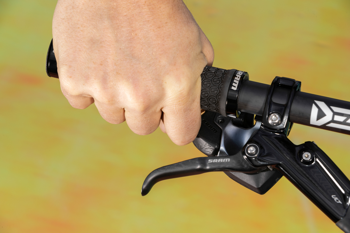

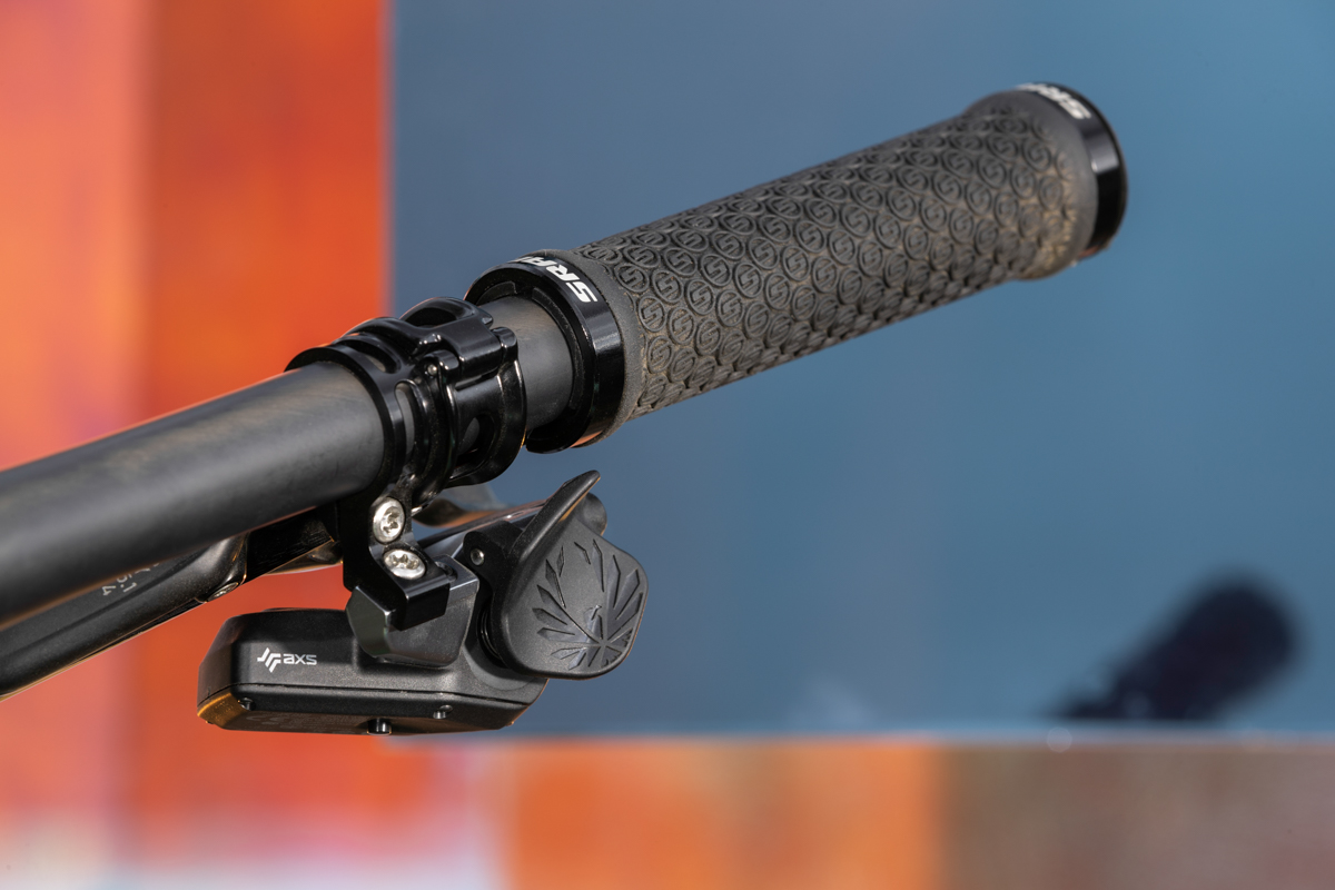

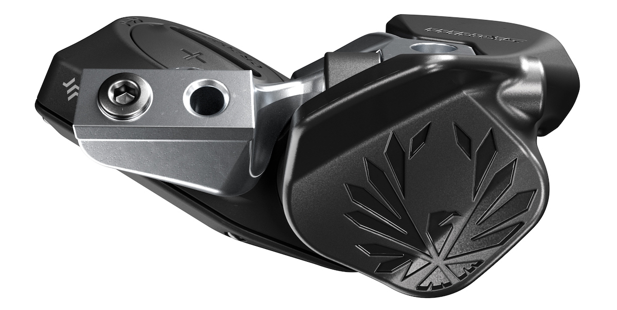

Eagle AXS Controller

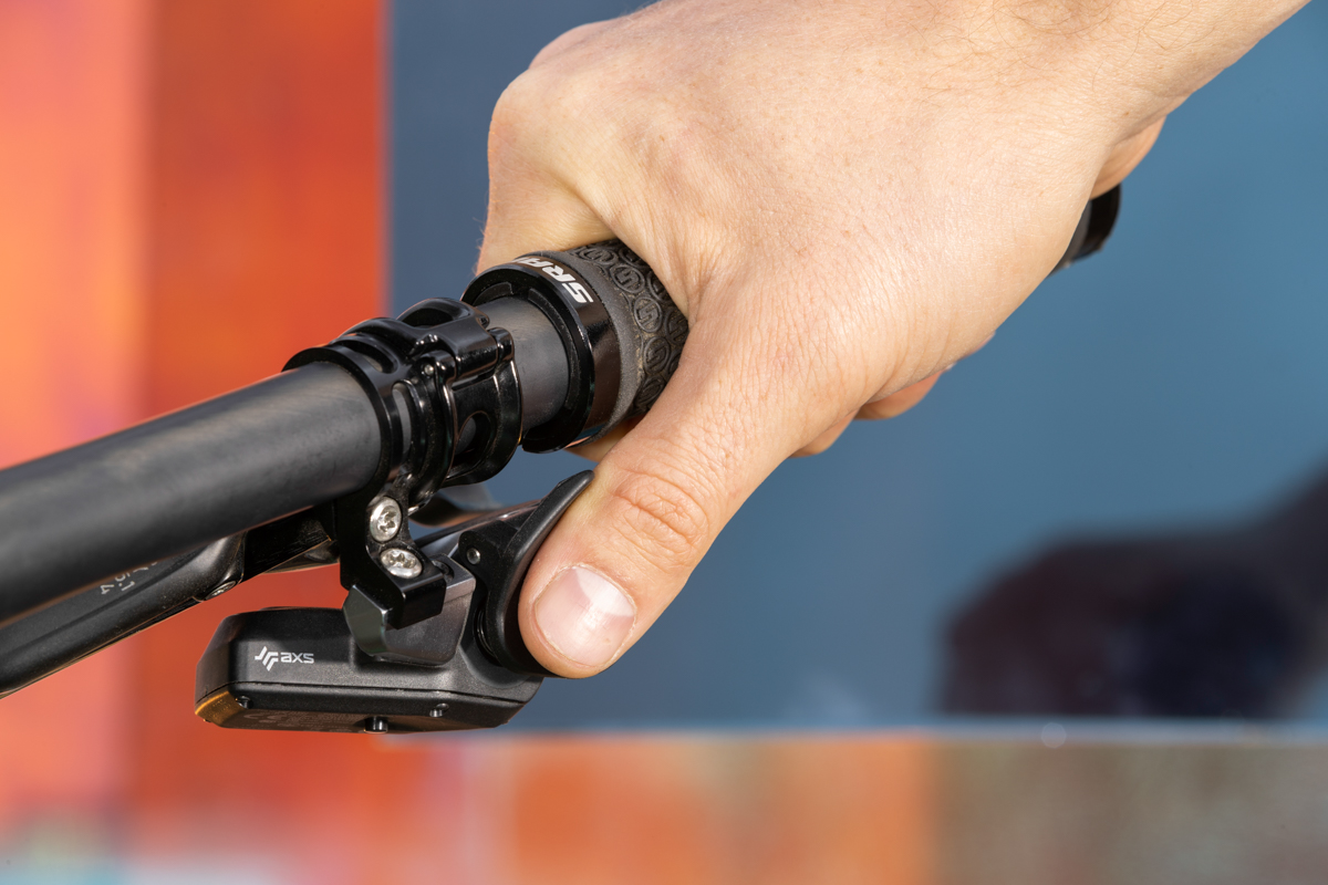

The Eagle AXS controller throws conventional mountain bike shifting out the window. In fact, the word controller has replaced shifter in SRAM’s marketing material. With wireless communication, there are no cables, housing or wires. The result is a completely new ergonomic experience with the rider pushing buttons on the controller to operate the derailleur.
The controller touchpoints are customizable through the AXS app with three functions available: inboard shift, outboard shift and dropper post activation. There is also a paddle on the front-side of the controller near your index knuckle that can be used to make quick gear changes without lifting a finger from the handlebar. SRAM are labelling it the “secret sprint paddle”.
The Eagle AXS controller is powered by a CR2032 watch battery which, according to SRAM’s claims, should last most people for up to 2-years.

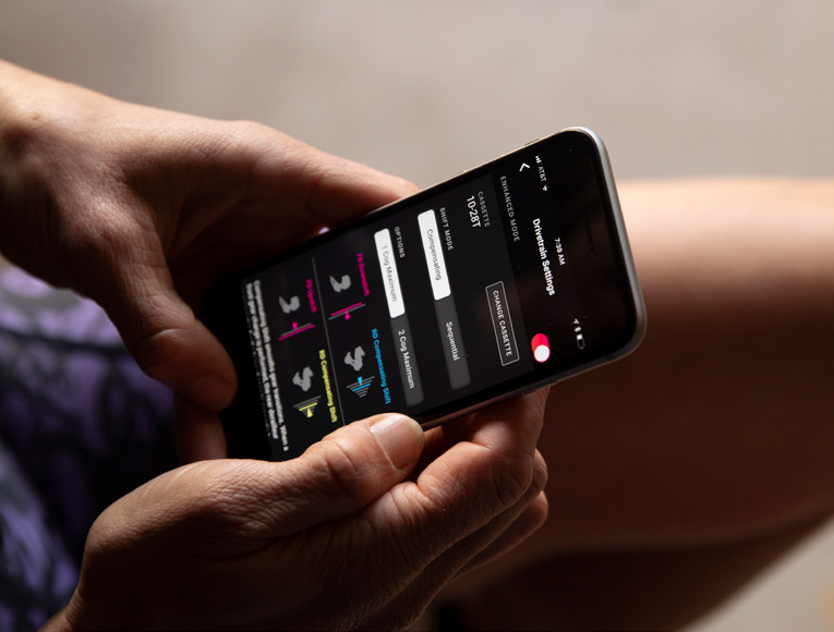

Customizing
The AXS App allows for a deep level of personalisation through your smartphone. From the app, you can change the behaviour of the components and controls, get maintenance reminders, update the firmware, and see the battery status. The app is available for both Android and iOS.

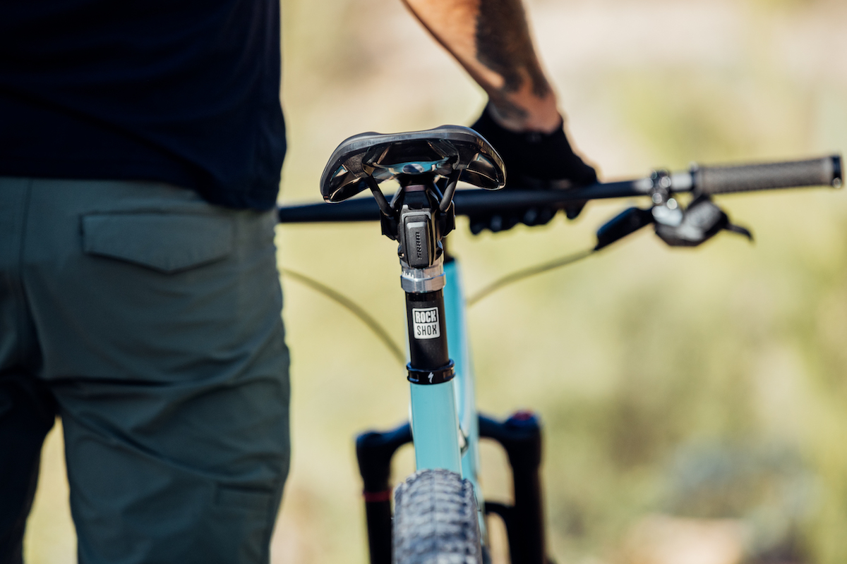

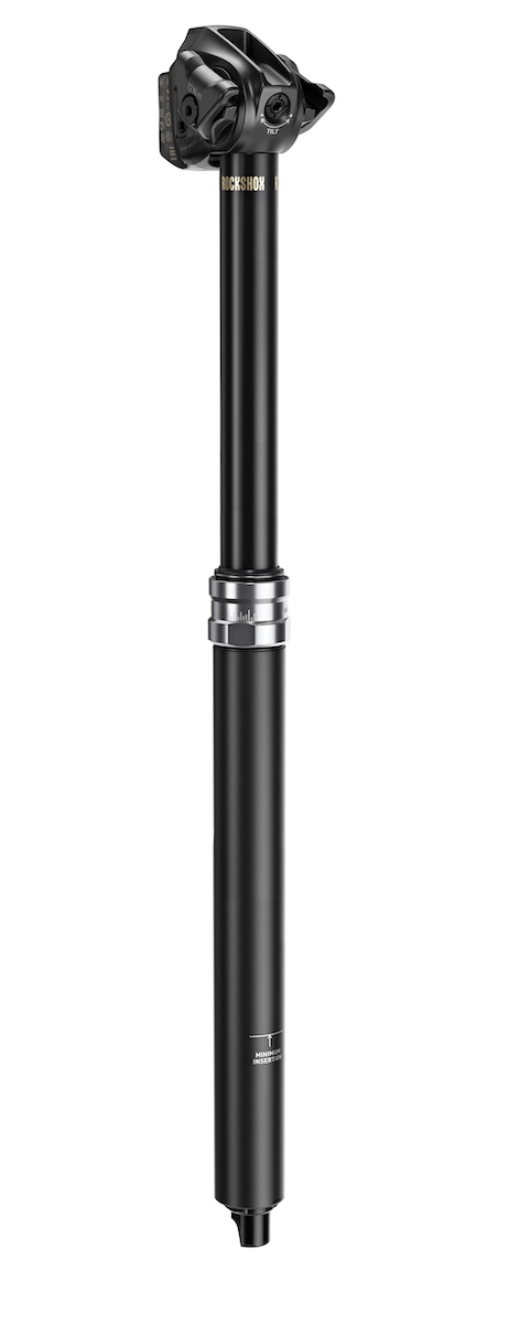

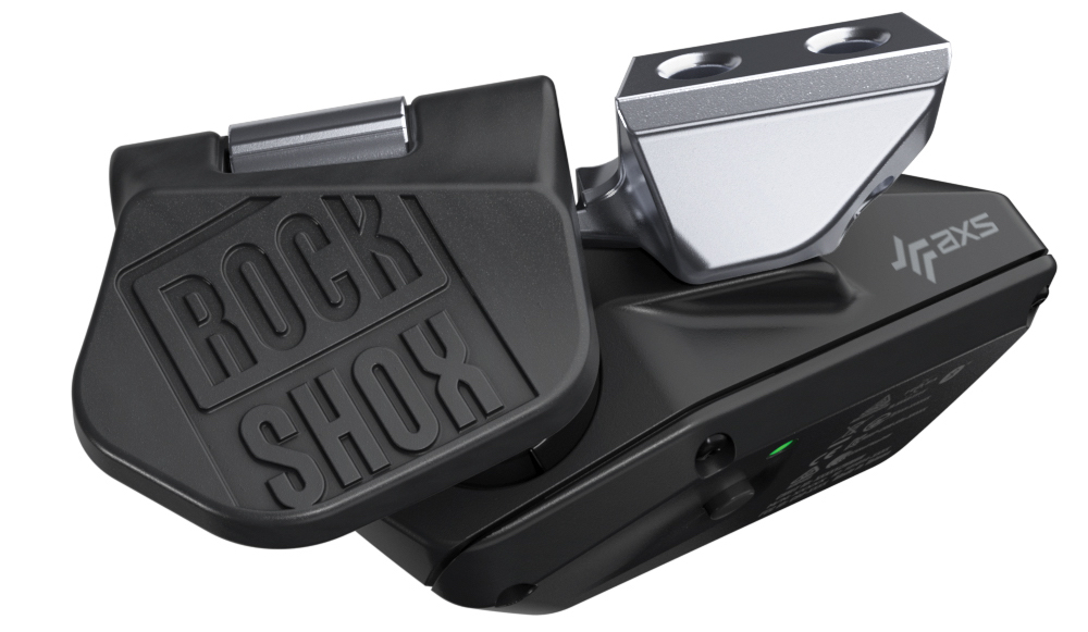

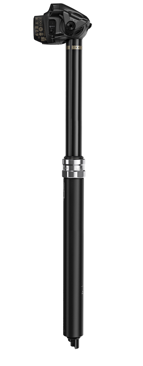

Reverb AXS
The Reverb AXS is a wireless-electronic dropper post. The post is activated by a controller similar to the Eagle AXS controller.
The new Reverb has seen some upgrades internally. A new internal floating piston and lubrication design are said to reduce friction, decreasing the force needed to depress the saddle and improving the speed of actuation. There is also a vent valve which can be used to separate air and oil that might mix across chambers. Thereby improving performance and removing the squishy post feel without further servicing.
Like all AXS components, the Reverb AXS will communicate and function with other AXS labelled parts. As mentioned before, this allows both Eagle AXS and RED eTap AXS components to control the Reverb AXS dropper post.
The Reverb AXS uses a SRAM battery (the same as the derailleur batteries on Eagle AXS and Red eTap AXS) at the seat post while the controller is powered by an ordinary CR2032 battery.
Specifications:
  • Diameters: 30.9mm, 31.6mm, 34.9mm
  • Travel:100mm, 125mm, 150mm, 170mm
  • Lengths: 340mm, 390mm, 440mm, 480mm
  • Compatibility: Zero Offset, 7mm Round Rail, 7X9mm Oval Rail, Matchmaker or Discrete Clamp

SRAM XX1 Eagle AXS
XC spec and ready for the trail. XX1 Eagle AXS utilizes the proven backbone of SRAM 1x. With the lightest weight materials and a 500-percent gear range. More secure and longer wearing X-SYNC2 chainring. The pinnacle of performance, paired with the connected components of Eagle AXS. Ready for the new gen of superbikes.
Features:
  • XC Focus
  • Carbon cage
  • Titanium hardware
  • Rainbow colourway
SRAM X01 Eagle AXS
There’s an element of the unknown when it comes to running new trail and racing blind. Enduro spec follows suit. X01 Eagle AXS utilizes the proven backbone of SRAM 1x. 500-percent gear range. More secure and longer wearing X-SYNC2 chainring. The resilienaluminium aluminium cage, paired with the connected components of Eagle AXS. Ready for the new gen of super bikes.
Features:
  • Enduro focus
  • Forged aluminium cage
  • Stainless hardware
  • Black/Polar colourways

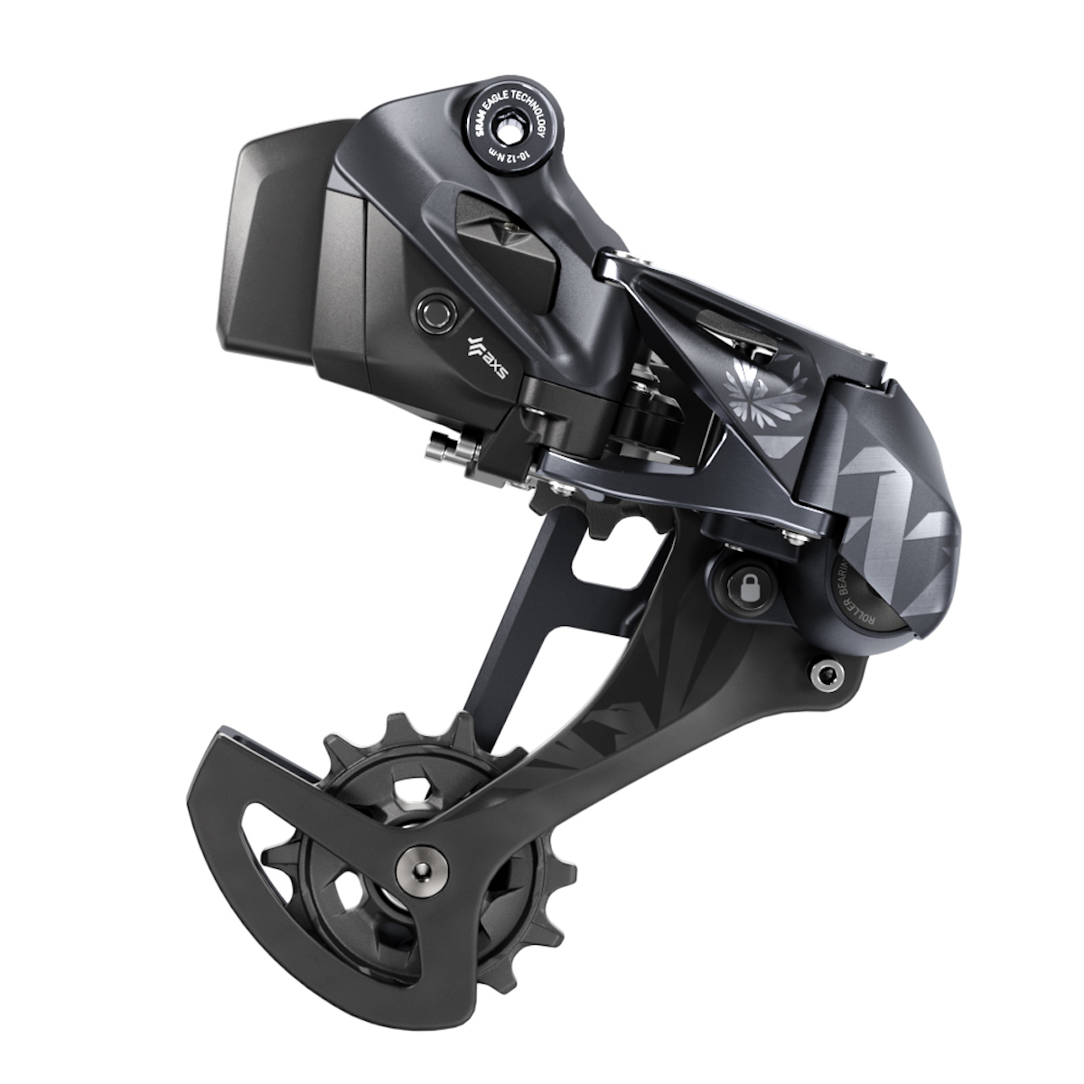

More than a mechanical derailleur with a battery and a motor bolted on, the Eagle AXS derailleur is the brain of
the whole AXS system. Trim it at set-up for zero rub, making the near-silent operation of Eagle even more stealth—all while improving drivetrain longevity.
It features a shorter cage for 10mm more ground clearance, with more chain wrap on the cassette to sit slightly further forward, and further inboard from mechanical Eagle. Instantaneous shifts from a single touch even while under World Cup-winning chain loads recorded in the heat of racing and affirmed in the test lab.
No cable, housing or wires to manage opened up design and engineering possibilities with the Eagle AXS controller. Helping us pioneer a completely new shifting experience with new ergonomic touchpoints that take just enough effort to press.
Touchpoints that are totally customizable to your preferences, allowing you to choose which button does what through the AXS app. Choose from three functions: Inboard shift. Outboard shift. Dropper. Use one of the touchpoints to control your electronic Reverb AXS dropper seatpost. And the power save mode in the controller wakes up after a single touch to save battery when not in use.
The Secret Sprint Paddle
Beyond the controller’s standard paddle, an included “Secret Sprint” paddle oriented on the front-side of the controller near your index knuckle allows for quick shifts with virtually no change to your grip on the handlebar.

Eagle AXS Impact Protection
The Eagle AXS derailleur is smart enough to protect itself. The built-in Overload Clutch was designed to disengage on impact, return to position and shift back into gear.
The primary purpose of the Overload Clutch is to protect the derailleur’s shift motor, but it serves to protect your derailleur and derailleur hanger from damage as a by-product. A very helpful by-product.

The AXS App
The AXS app is the built-in componentry software that makes it possible to both program and personalize Eagle AXS to your specifications. Letting you adjust and personalize controller assignments for shift commands and your electronically activated Reverb dropper post right from your mobile—to make it exactly how you want it. Have your left controller do upshifts or downshifts.
Assign a paddle to your AXS enabled Reverb that feels most intuitive to you. For the first time, AXS introduces digital possibilities for riders to customize, personalize, control, and improve the ride. Even when off the bike. Effectively allowing you to create your very own Eagle AXS “fingerprint.”
Use it. Or don’t.
All that’s needed to get riding is to mount the Eagle AXS drivetrain, pair it and get out there. The AXS app is only needed for further personalization or to gain access to the data the system has accumulated. Whenever you choose.
Beyond personalization.
Far beyond rider personalization, the seamless integration between AXS hardware and software communicates with your SRAM id. Like sending service reminders when it’s time to check your wear components. And so much more. Allowing you to improve your bike when you’re not even touching it.
