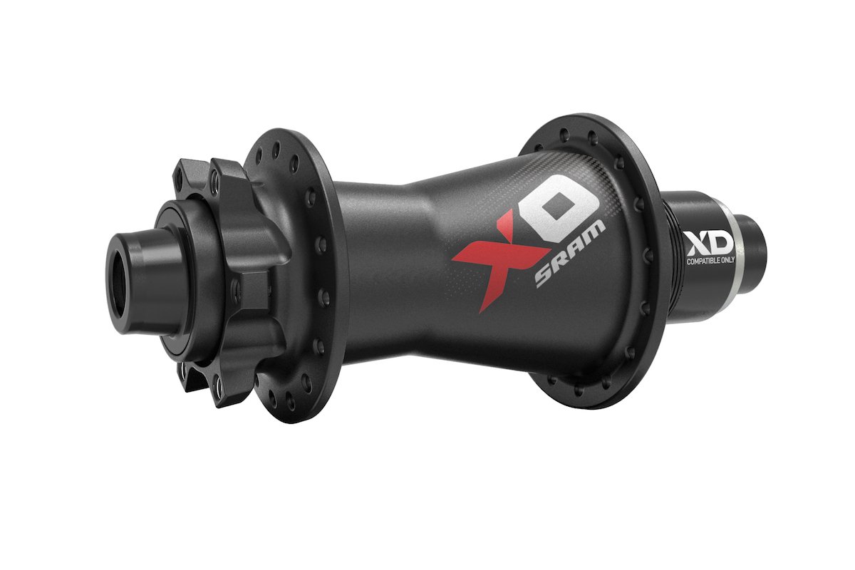

The new SRAM X0 DH hubs are built around strength and durability. Our 52 point ratchet design gives you quick and reliable engagement. The X0 hubs are built with precision machined bearings giving you lower resistance, faster revolutions and no wasted time on drag. The hubs are also convertible to different axle types with removable end caps. From pawl tooth to spoke flanges, we took the extra time on the X0 DH hub so you won’t have to.
Features and Benefits:

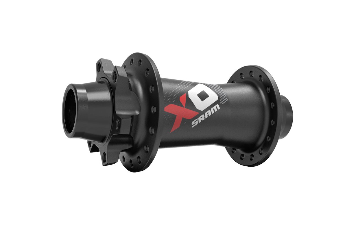

  • NEW Rear DH option: 12×150 and 12×157
  • 20×110 interface already available on existing front hub
  • Tapered aluminum axle is stronger without added weight
  • DOUBLE TIME™ mechanism for quick engagement
  • SPEEDBALL™ bearings for smooth action
  • 32 spoke holes
  • Glossy black with silver accents and sand-blasted black with red label
  • 3D forged hub shell with SEEKER™ flanges
  • Convertible to all axle types
  • Available in XD™ or 10-speed driver body
  • Weight: 130g (front), 265g (rear)

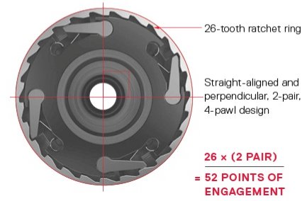

DOUBLE TIME™
This straight-aligned, 4-pawl design turns the 26-tooth ratchet ring into 52 points of contact. The result: smooth 6.9º engagement without reducing tooth size or offsetting internal geometry—which means serious long-term durability.

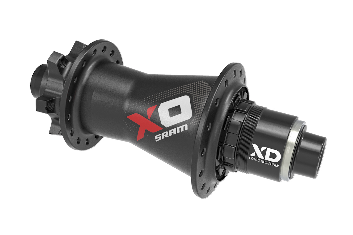

XD™ DRIVER BODY
XD™ is a cassette driver body design that allows the use of a 10-tooth small cog and provides an improved interface with the cassette.

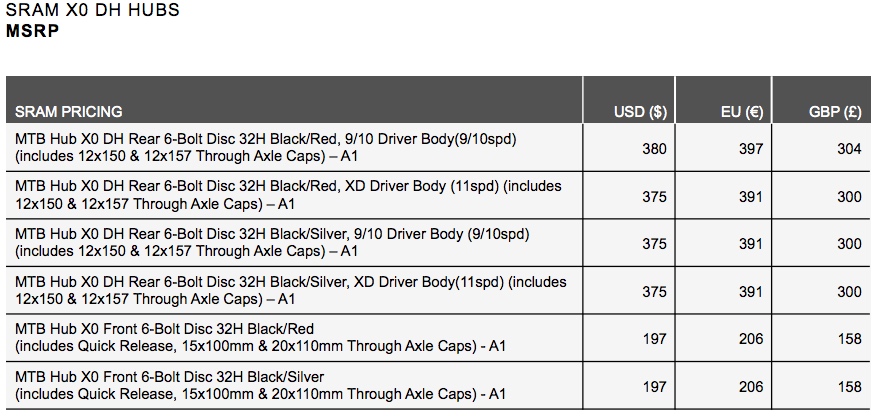

Pricing
