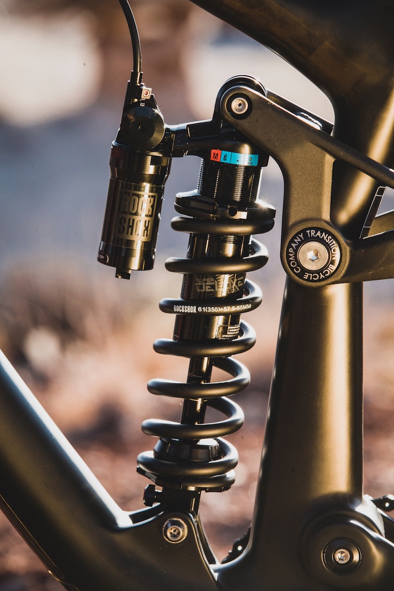

Super Deluxe allowed us to ditch old design constraints, and simply focus on building the best possible rear shock. And with that old thinking no longer holding us back, we began to wonder why coil-shock performance had to be limited to purely downhill and enduro applications and why there should be any pedaling compromise associated with a coil shock.
No option spared
In the words of a famous enduro racer, “Lean back and hang on”, because the all-new Super Deluxe Coil brings the consistency and feel of a coil sprung shock to trail and enduro bikes, and the benefits of metric design to downhill bikes. And with remote-lockout options, riders can capitalize on pedaling power anywhere, not just on fire roads.
Sag gradients – coil setup
All Super Deluxe Coil models feature sag gradients printed on the shaft to facilitate the correct setup.
Steel springs will be available from RockShox in 50 lbs increments from 250 to 650, depending on length.

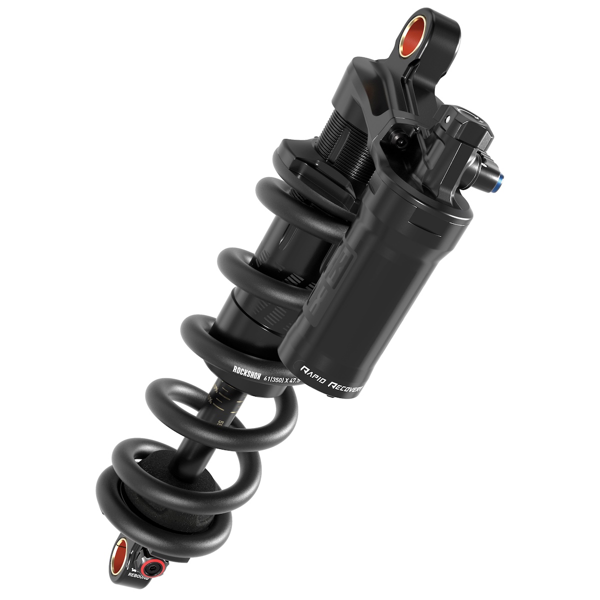

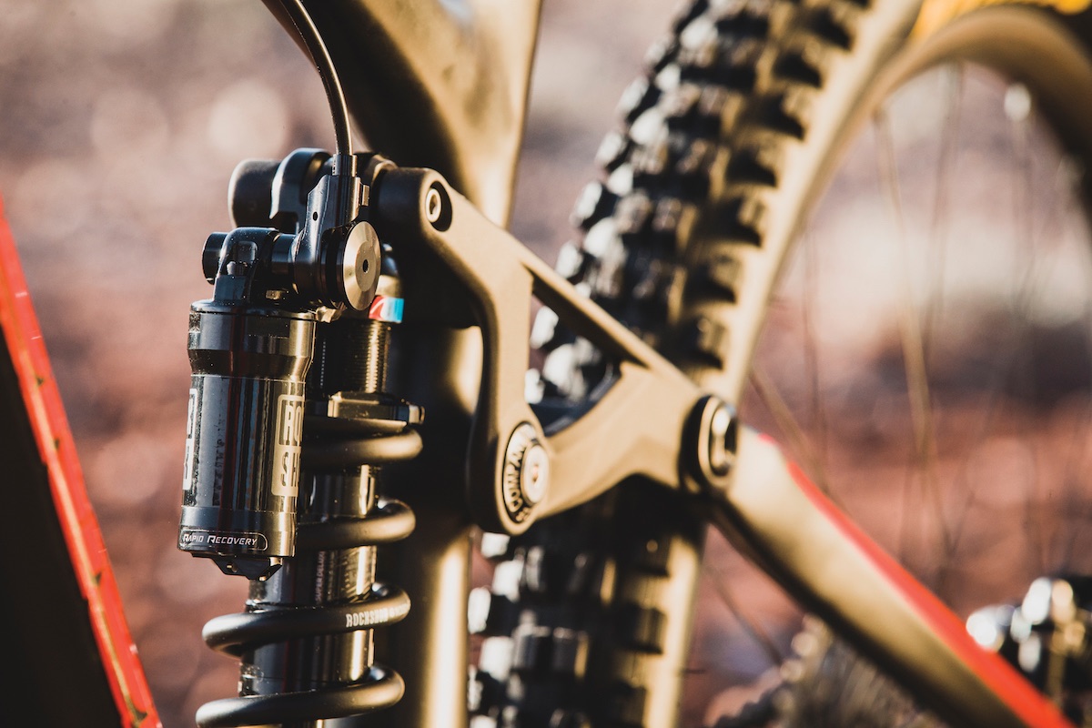

Super Deluxe Coil RCT
Solid Threshold adjustment for pedaling performance, low speed compression adjustment to fine tune the ride to any trail and condition, the unmistakable feel of a coil spring and RockShox’s Super Deluxe design. A unique blend that’s now a reality, to push the benefits of coil shocks to bold new places.
Availability: OEM only (selected AM options to be announced)
Features and benefits:
  • Native metric design
  • Consistent, coil-spring performance
  • Independently tunable compression circuits/checked rebound
  • Mounting options: trunnion mount, bearing mount, Standard DU.
  • External rebound damping adjustment
  • 2-position threshold adjustment (Open/Pedal) with low speed compression adjustment in Open mode
  • Steel springs available in 50lbs increments from 350lbs to 650lbs (depending on length)
Usage: Trail and Enduro

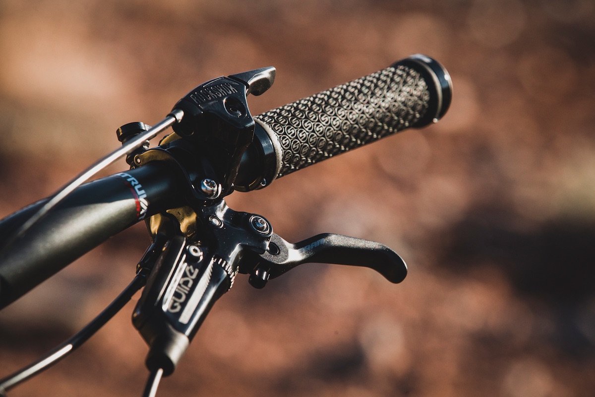

Super Deluxe Coil RT Remote
Remote rear shocks are no longer reserved for the XC elites – and Super Deluxe Coil RT Remote has already proven it with its 2016 EWS title with Cecile Ravanel. Riders can conserve energy and accelerate faster by switching to the “Threshold” mode, and click back into “Open” for full shredding capabilities.
  • 2-position, remote-operated threshold adjustment (Open/Pedal) via OneLoc remote
  • In and Out cable routing

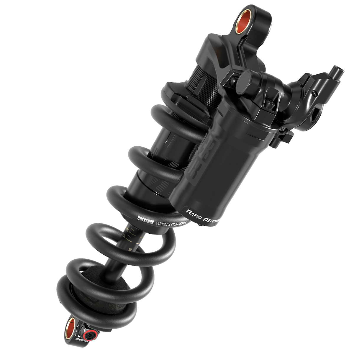

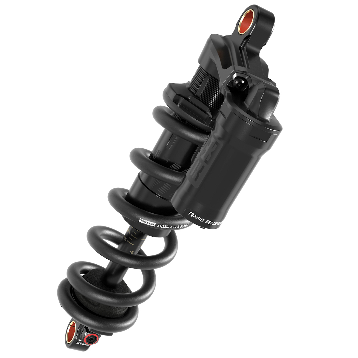

Super Deluxe Coil RC World Cup
RockShox metric rear shock technology meets downhill World Cup racing – a shock designed for the new breed of downhill bikes, ultra-capable and light as never before. No-compromise damping, with precise low speed compression and rebound adjustments to dial in a podium-worthy ride.
  • Low speed compression adjustment
  • Metric Vivid replacement
Usage: Gravity

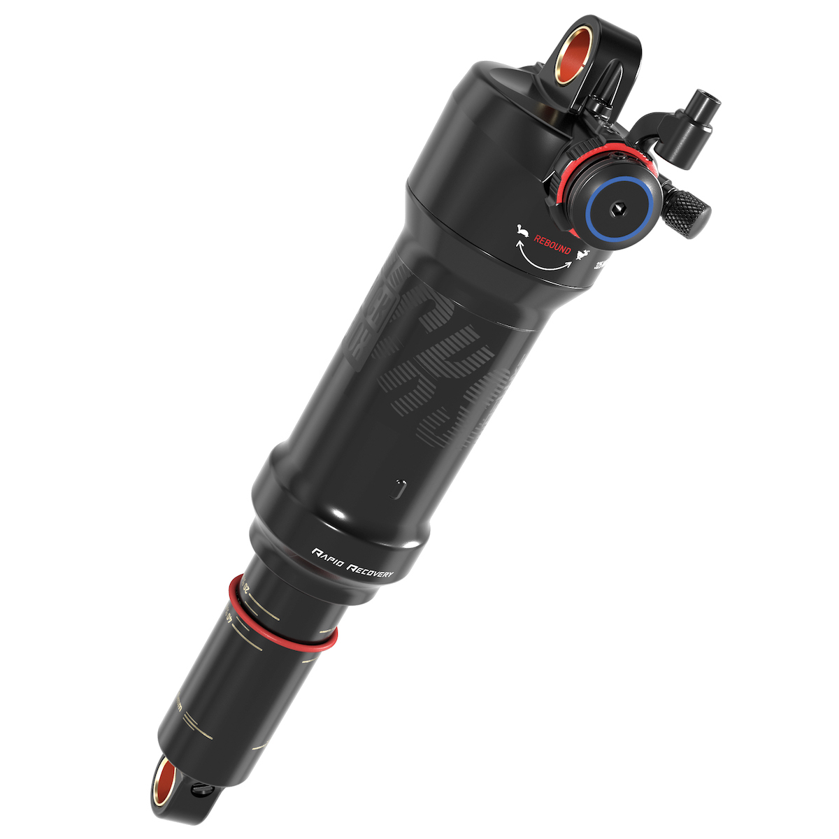

Super Deluxe Coil R
No-nonsense performance for all coil-worthy applications, from the latest breed of trail and enduro bikes to downhill and park rigs that leave room in the budget for a season pass at the local hill. All the benefits of the Super Deluxe Coil package in a shock that’s as easy to understand as it is fun to ride.
  • Metric Kage replacement
Usage: Trail, enduro, gravity

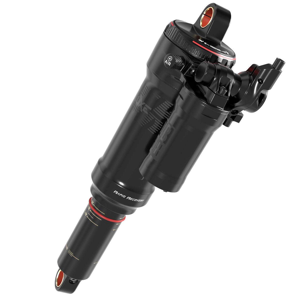

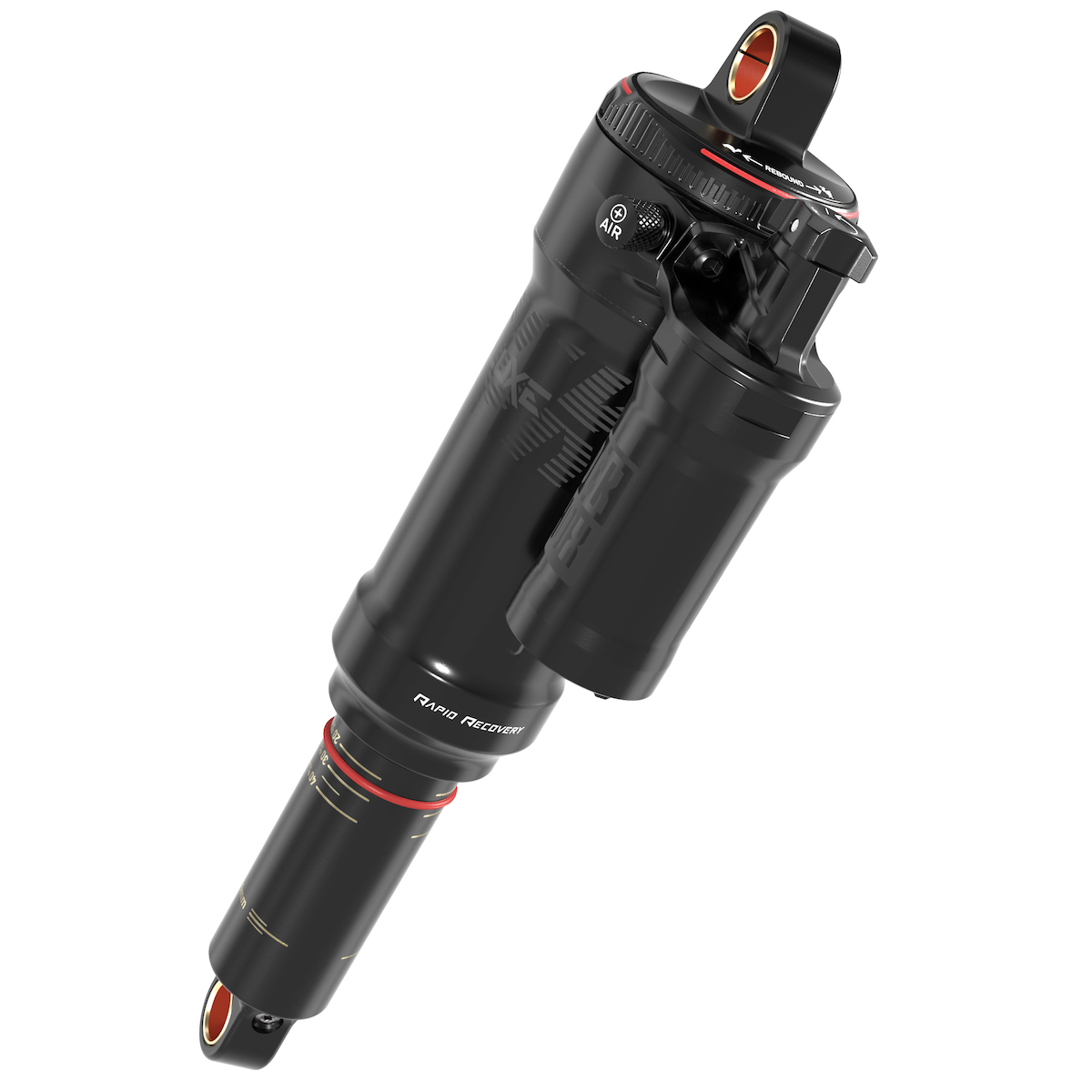

Super Deluxe RCT
Solid Threshold adjustment for pedaling performance, low speed compression adjustment to fine tune the ride to any trail and condition, and the proven performance of RockShox’s revolutionary Super Deluxe rear shock in a package that’s ready to tackle any challenge.
Usage: Trail and enduro

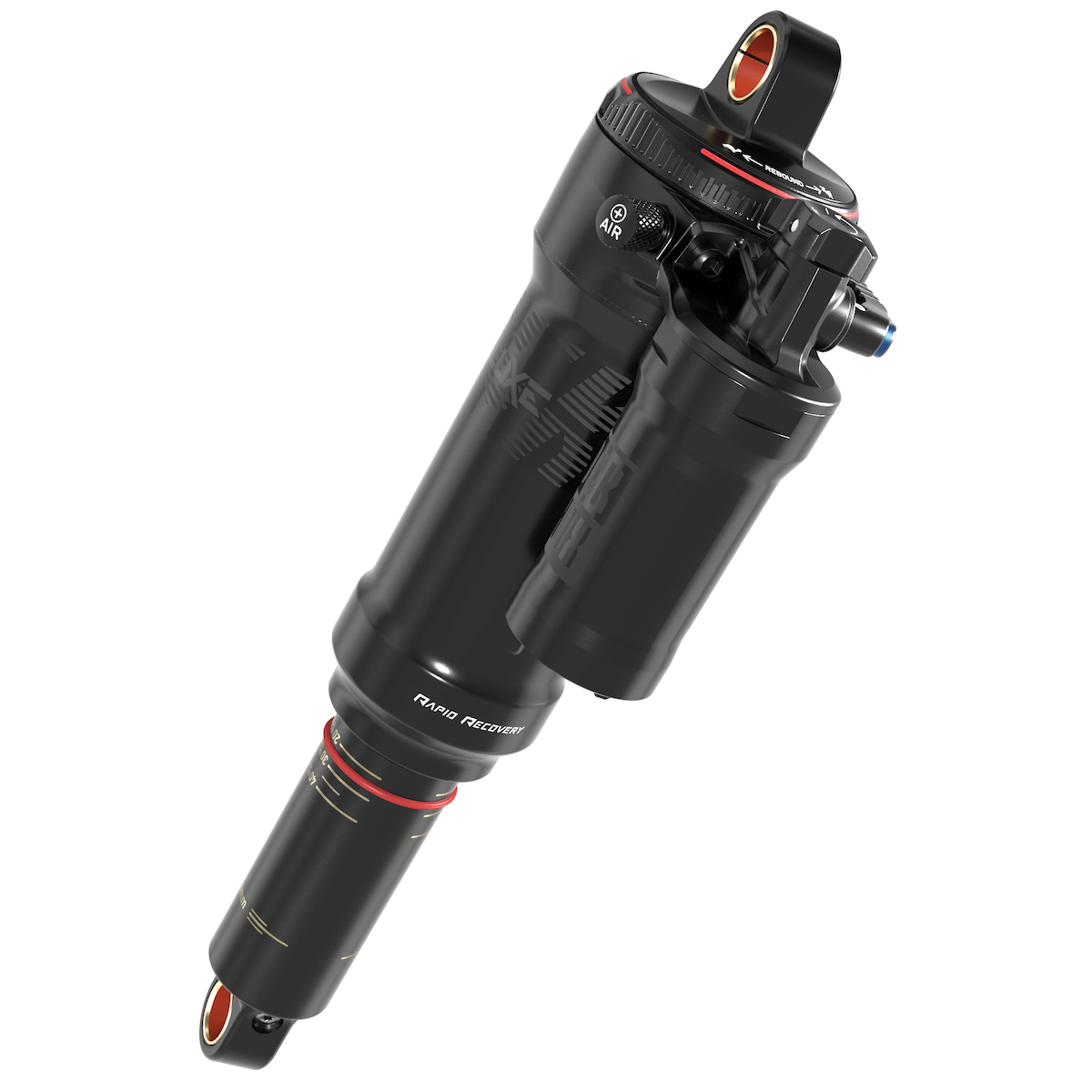

Super Deluxe RT Remote
Remote rear shocks are no longer reserved to the XC elites – and Super Deluxe RT Remote has already proven it with its 2016 EWS performance under the likes of Jerome Clementz and Cecile Ravanel. Riders can conserve energy and accelerate faster by switching to the “Threshold” mode, and click back into “Open” for full shredding capabilities.
Usage: Cross country and trail

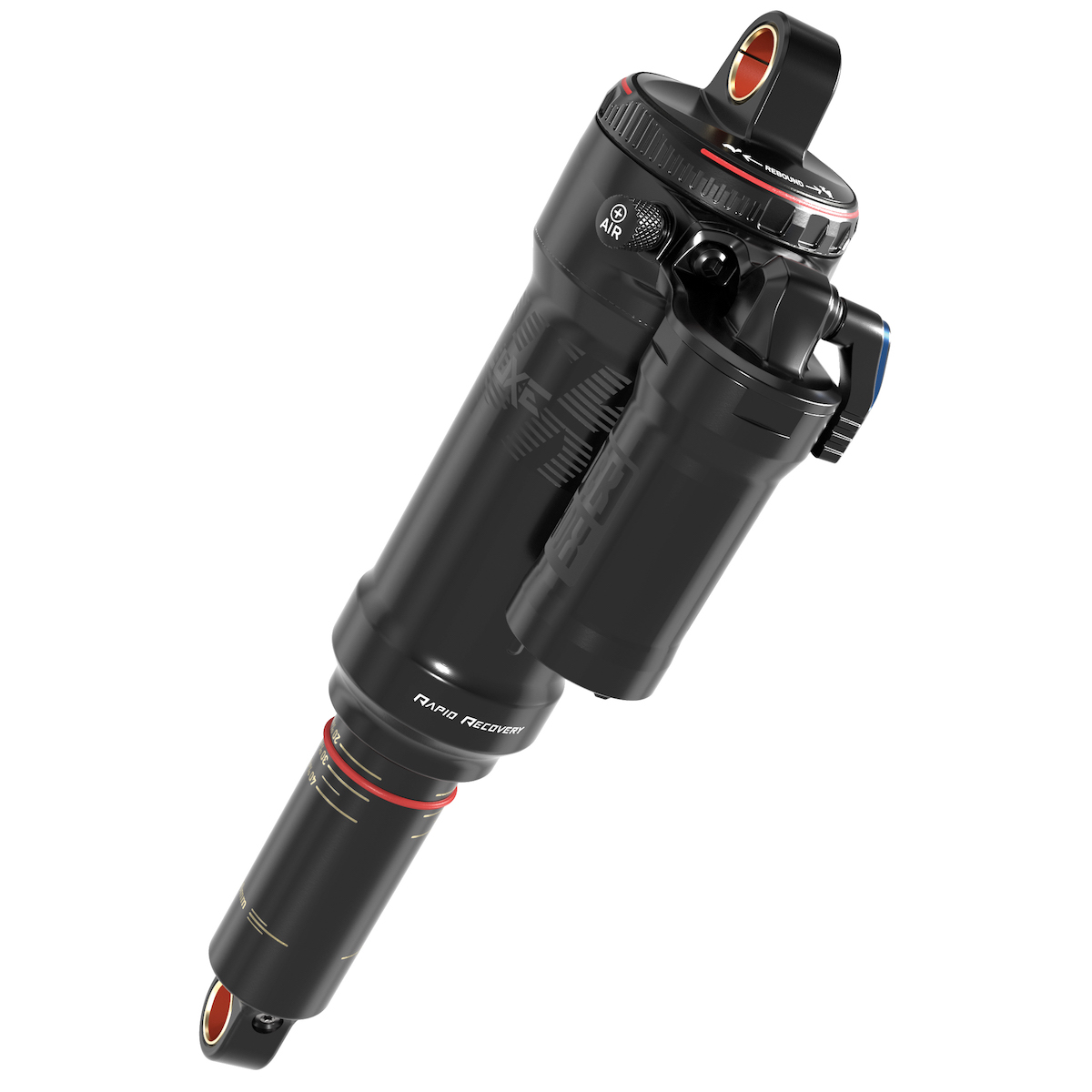

Deluxe RL Remote
The efficiency of an Open/Lock remote switch meets the benefits of RockShox’s metric shock design. The ultra-low activation force required to operate Deluxe RL Remote via the OneLoc remote means that riders can access the efficiency of the Lock position more often.
  • 2-position, remote-operated threshold adjustment (Open/Lock) via OneLoc remote
