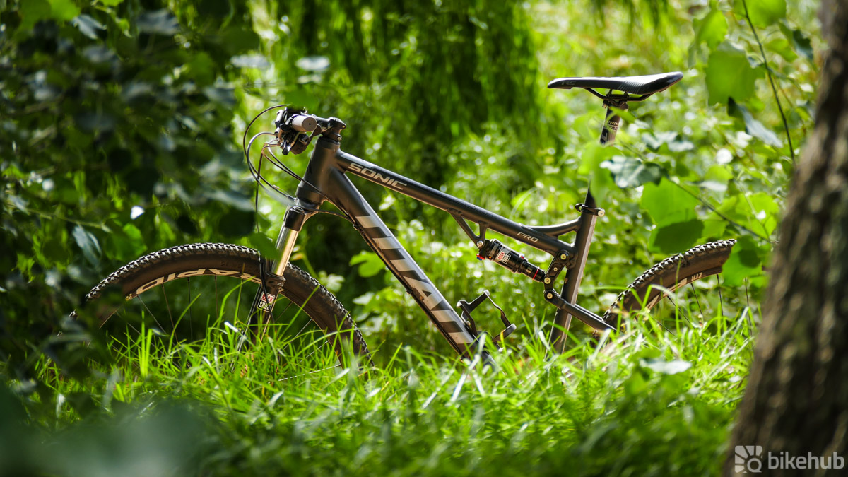

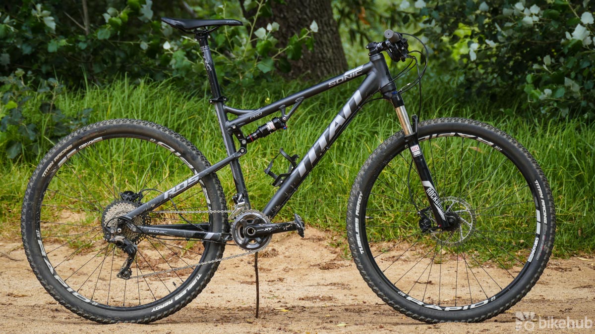

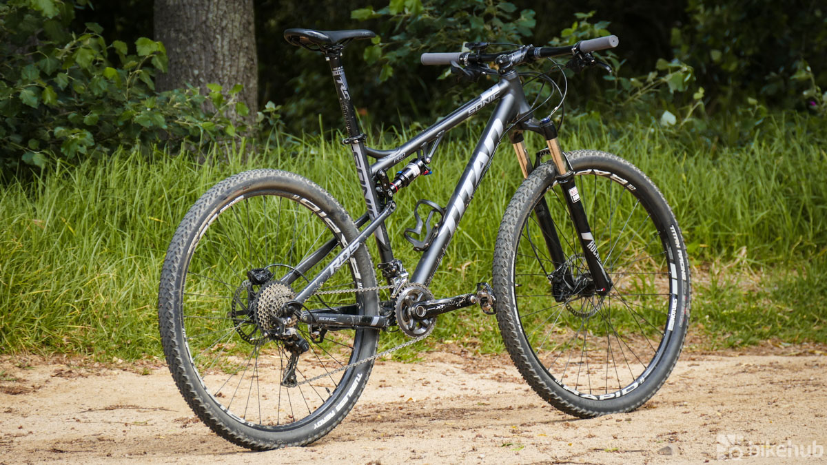

The first thing that struck me when I saw the bike in the flesh was just how much the round tubes resemble the elegant simplicity of a steel bike. Cable routing is external all the way through with hoses and cables guided under the downtube. A low top tube means that the standover height is good and there is space for one full size water bottle inside the front triangle. Titan employs a welding technique around the head tube called Smooth Welding. It is an advanced welding technique that produces a smoother, more visually appealing finish. It certainly shows on the front end of the bike which blends seamlessly into the various tubes.
On paper, the Silverback Sprada appears to be the Sonic’s closest rival. Take a look at the geometry numbers and the Sonic sits somewhere in the middle of the contemporary cross-country bikes (e.g. Pyga Stage, Scott Spark RC, Cannondale Scalpel Si) and more traditional race bikes (e.g. Specialized Epic, Silverback Sesta and Momsen VIPA). While compared to the mighty Anthem X 29er, the Sonic is slacker (70° vs 71.5°) and the chainstays are slightly shorter (455mm vs 462mm).

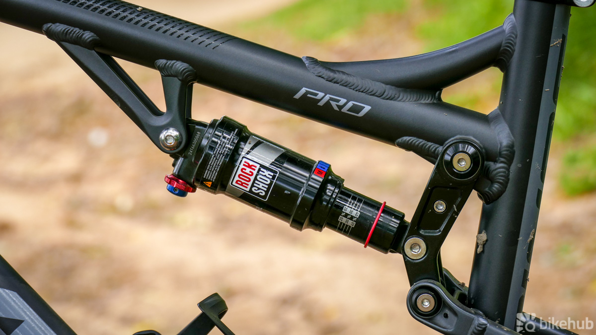

  • Rear SuspensionRockshox Monarch RL Air

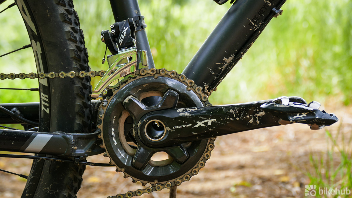

  • CranksetShimano XT 36-26T

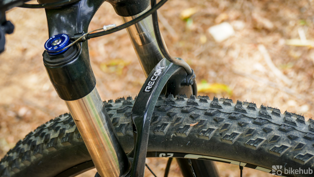

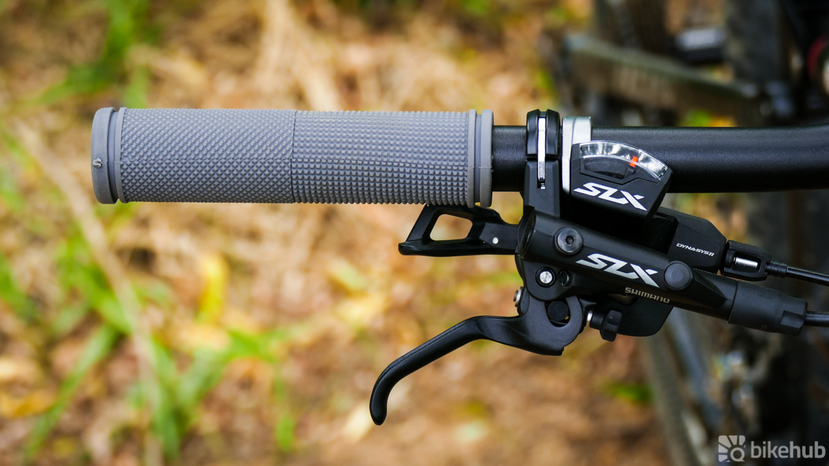

There are a few features I would have liked to have seen on the Sonic. The first is routing for a dropper seatpost. A year or two ago you could have said that I am mad wanting a dropper post on a 100 mm bike, but it has become commonplace for just about all mountain bikes to have dropper routing as standard. Even if, at worst, it is external only. Secondly, it would have been nice to see a better fork on the top of the range model. I am not sure what impact that would have had on the selling price, but with an eye on keeping prices reasonable, it might have been a stretch. Having said that, the fork’s performance was not bad

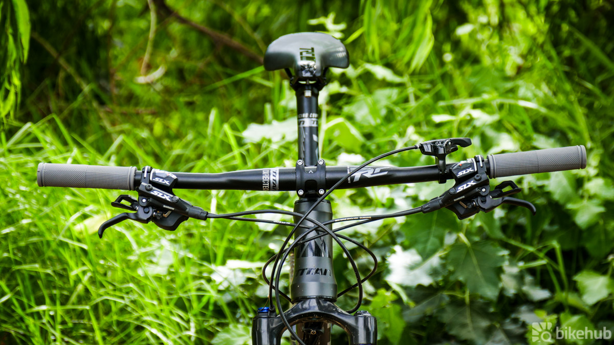

I would have also rather seen the lockout operating the shock instead of the fork. On a dual suspension bike, I would much rather be able to stiffen up the pedalling platform through the shock than the fork. That said, the shock is mounted within convenient reach just below the top tube. If I bought a Sonic, and considering my preference to generally leave the fork open, I would probably remove the remote completely to neaten up the cockpit and to have one less part that can go wrong.

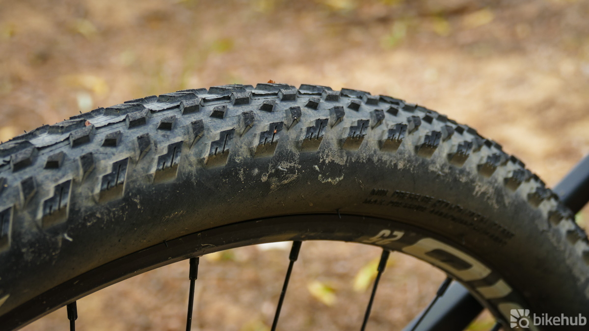

The tubeless ready Titan 2.10″ tyres are worth mentioning. The 60tpi compound offers good traction with predictable grip when leaned over. These tyres help to add to the confidence inspiring ride, allowing the rider to focus on the best line choice.

Looks like they have used the Specialized licenced Horst Link rear suspension. When done properly this a superb design. Any info available on this?

I agree - a fork lockout is one of the most useless features on a bike. Unless you spend the entire time pedaling uphill while standing. Its far more useful to have a fork that sinks into and uses its travel when it really gets steep allowing you to keep front end traction. The only time I have ever used the lockout on my bike is on tar. So not very often at all...
