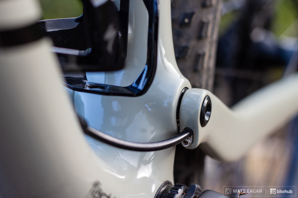

Along with some changes to the geometry, one of the bigger developments to the new Epic was replacing the FSR suspension with a single pivot design, removing the rear pivot. The new design engineered compliance into the chain- and seatstays to assist the suspension as it moves through the travel. Specialized say that by removing the pivots in the chainstays, they reduced weight, improved stiffness, and pedalling efficiency.
ccs-62657-0-62966600-1536738969.jpgThe Epic frame has removed the rear pivot system replacing it with flexible stays.

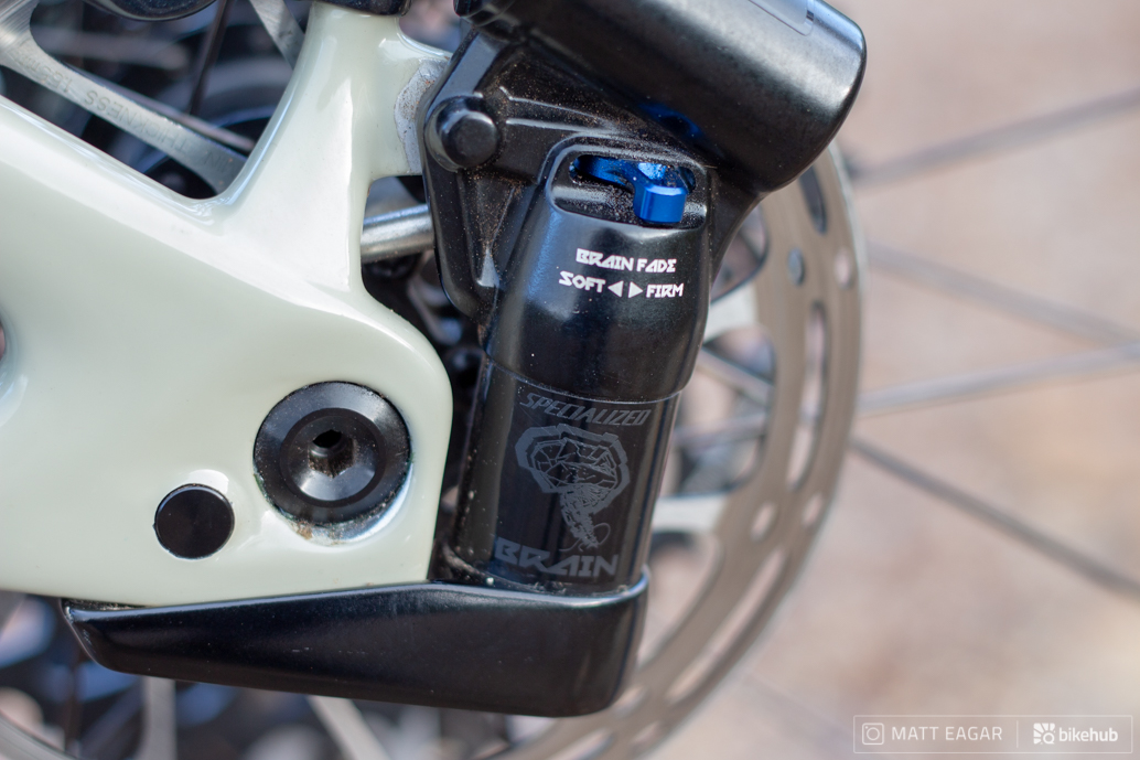

The Brain system is placed behind the rear axle with hosing travelling neatly up the seatstay into the shock.
The Epic EVO uses exactly the same Brain system used on the Epic. The newer Brain 2.0 design moved the location of the brain unit to behind the rear axle with Specialized having worked on the internals to improve oil flow, which they say leads to a more responsive, sensitive system. The forks used on the two currently available Epic EVO models do not make use of the Brain technology.

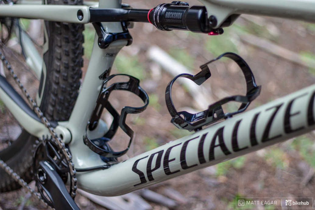

ccs-62657-0-53602500-1536738963.jpgTwo bottles, full throttle!
The frame has space for two water bottles within the front triangle. This becomes even more of a consideration when the bike arrives fitted with a dropper seatpost, making it trickier to apply a seatpost mount. The Epic EVO includes a Specialized side entry bottle cage and accompanying multi-tool attached. There is also the additional mount to fit the Specialized SWAT box which can carry a tube, bomb and adaptor, tyre lever, and multitool. Other frame features include internal cable routing, for everything but the Brain hose, and an integrated chainstay protector.

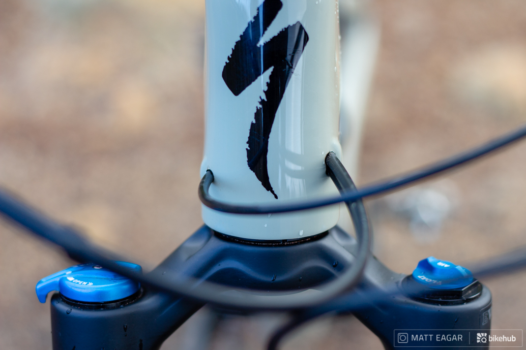

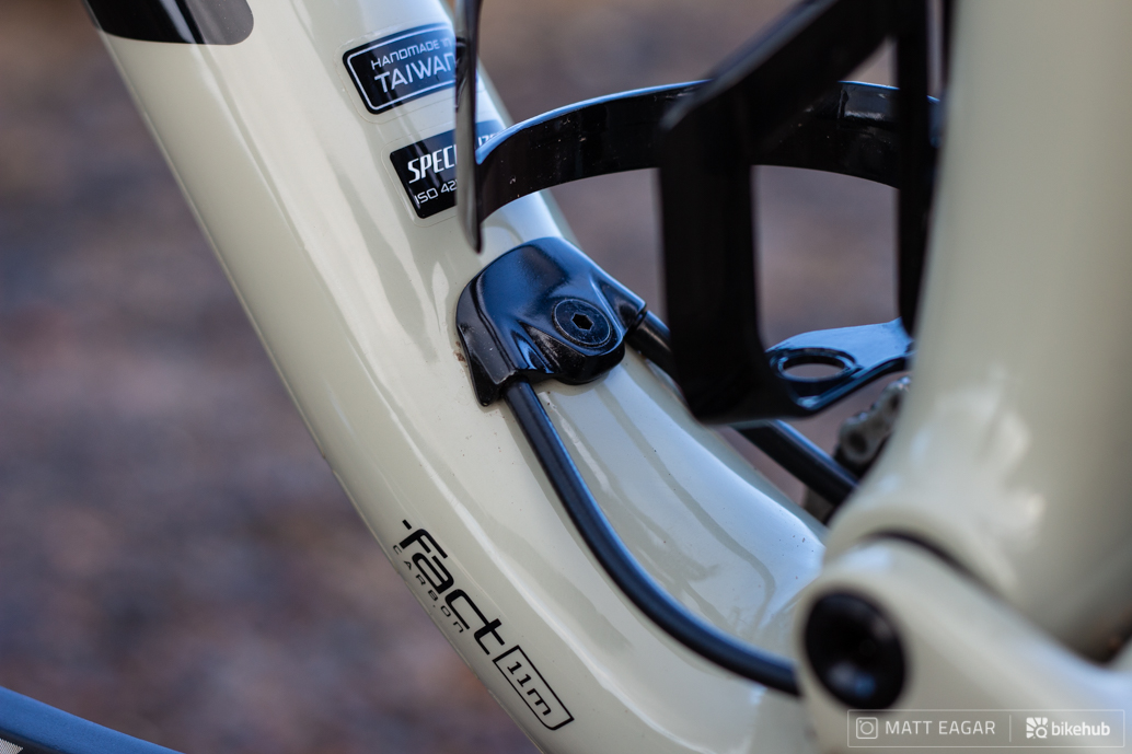

The internal cable routing is neat and silent.

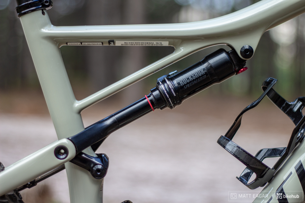

Shock: The shock is a custom collaboration between RockShox and Specialized. The shock is connected to the Brain system via hosing that travels down the seat stay to the non-drive side rear axle. The shock features Specialized’s AutoSag which assists in getting the air pressure within range quickly.

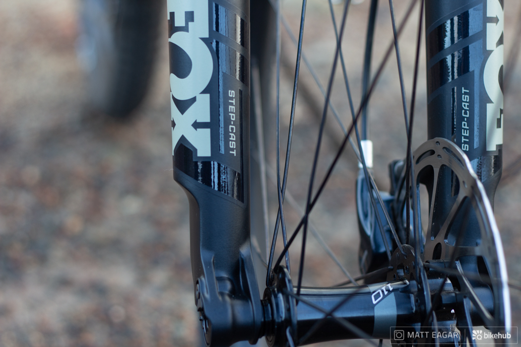

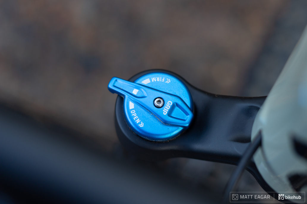

Fork: The 120mm fork is a defining characteristic of the Epic EVO and on the Expert model it is a Fox 34 Step-Cast. The Fox 34 a trail fork with a slightly beefier build than lightweight cross-country fork. It provides a sturdy platform to charge through technical trails.
Considering the pricing and specification level of the Expert, I was initially a bit underwhelmed to see the GRIP damper used over the premium FIT4 option. But after spending some time with the fork, I struggled to find any significant shortcomings in the forks performance.

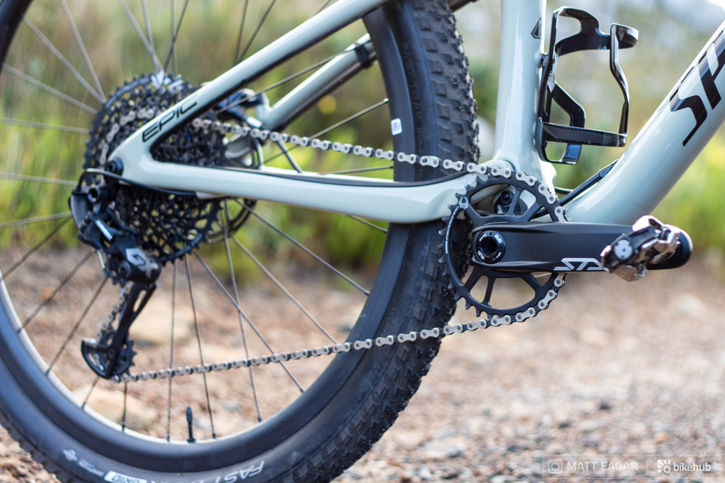

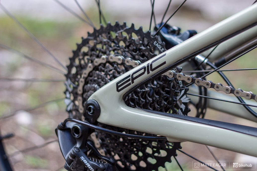

Drivetrain: The drive system is a SRAM GX Eagle groupset, apart from the Truvativ crankset. The GX Eagle drivetrain arguably performs as well as the pricier X01 and XX1 levels but at the cost of a few hundred grams. The GX components are also much more affordable to replace when they wear out or get damaged.

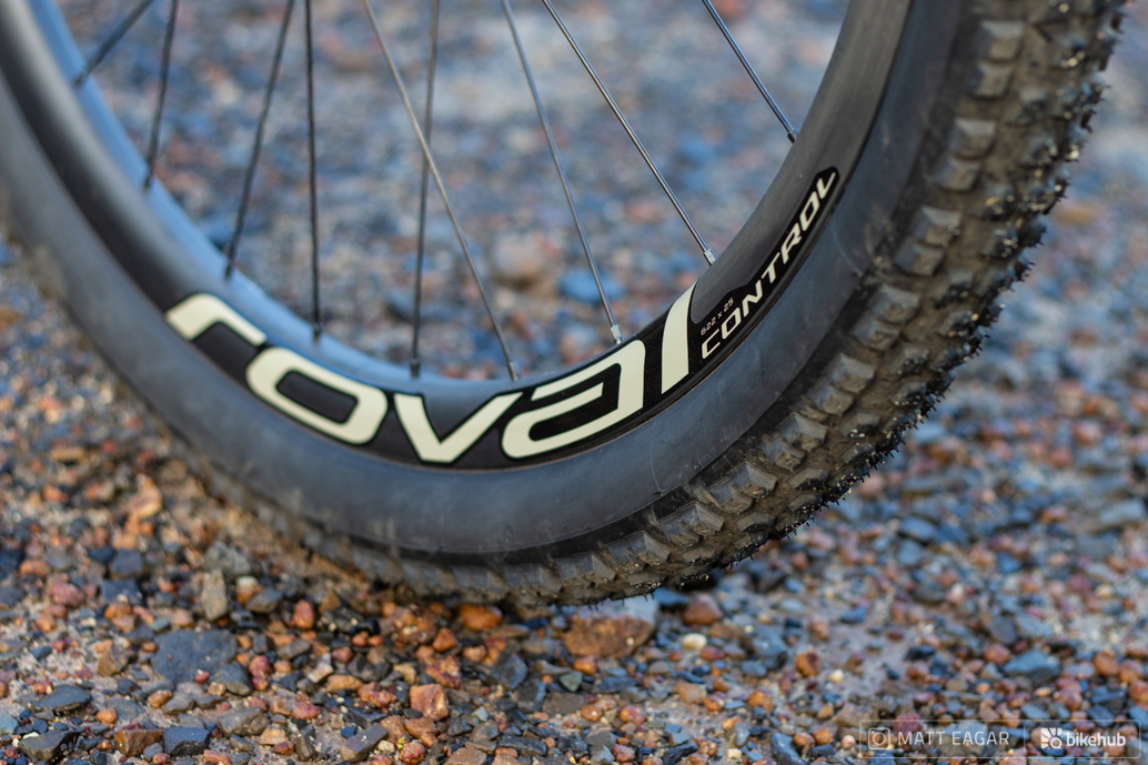

Wheels: The Epic Expert EVO rolls on Roval carbon rims with a well-suited 25mm internal diameter. It is a tricky task balancing the right level of parts with the bikes final price tag. In this case, the additional stiffness, acceleration, and control through rough trails that carbon rims offer are well worth the upgrade over aluminium hoops. Even if it comes at the cost of a fitting a ‘cheaper’ GX Eagle drivetrain.

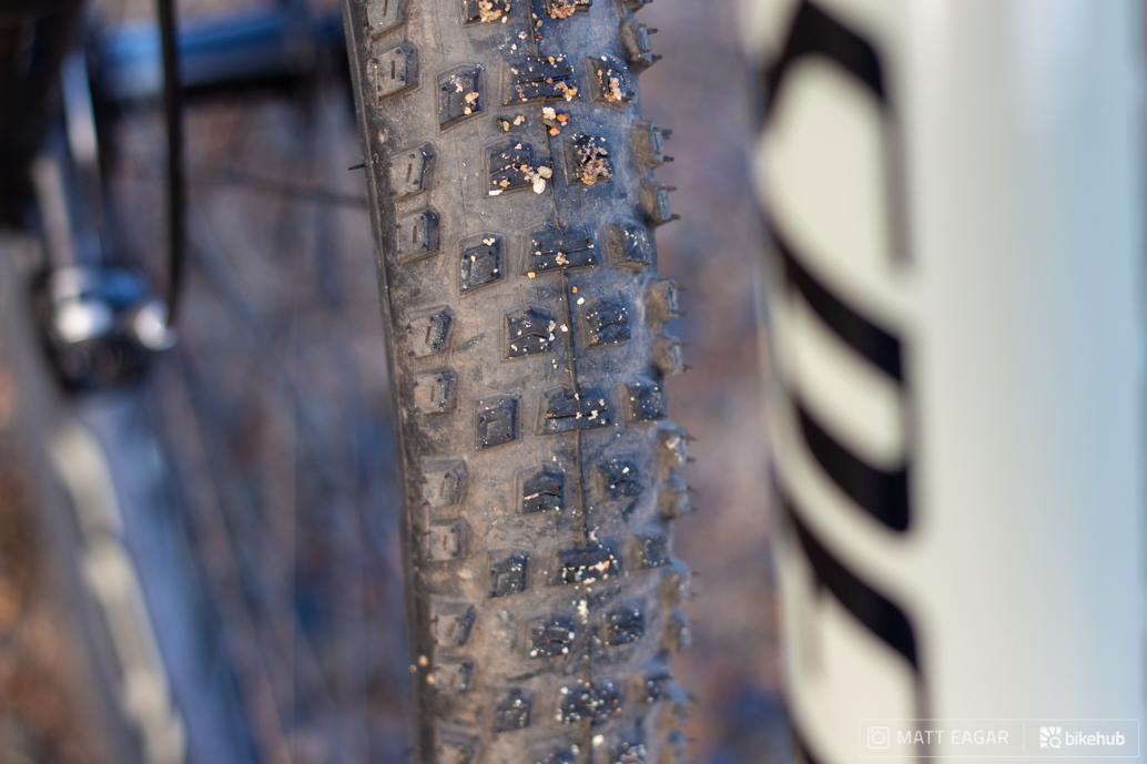

Tyres: The Epic EVO sticks with the light, more efficient rolling Fast Trak tyre (although the tougher GRID version) on the rear while bulking up on traction with a Ground Control on the front tyre. A logical choice for a bike with the EVO’s intentions. The newer Ground Control is an excellent tyre for the EVO, providing a surprising amount of grip without feeling heavy or clumsy on the flats and climbs. It’s a tyre that happily keeps up with the versatility of the Fox 34 fork.

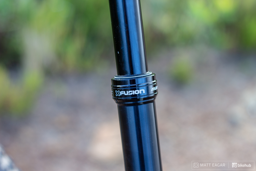

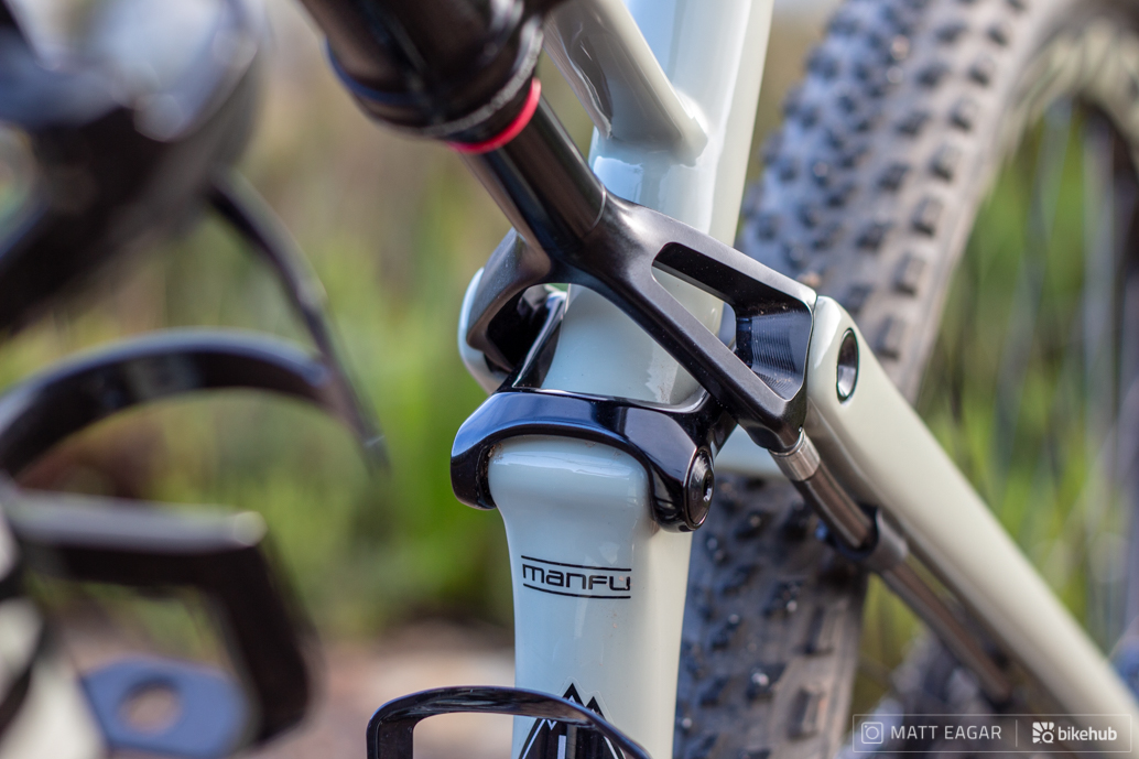

Controls: In the cockpit, the most obvious deviation from the typical Epic formula is the dropper seatpost. The dropper seat post can help keep us amateurs out of the hospital and smiling on the single track. Use it!
Interestingly, Specialized has shied away from their own Command Post dropper posts on the Epic EVO. Instead, equipping an X-Fusion post with 125mm travel on the larger sizes. While I do prefer more travel on a dropper post for trail riding, on a cross-country bike I find 125mm to be more than adequate.

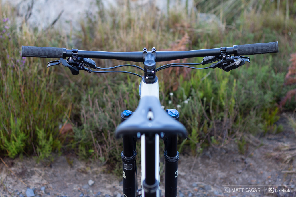

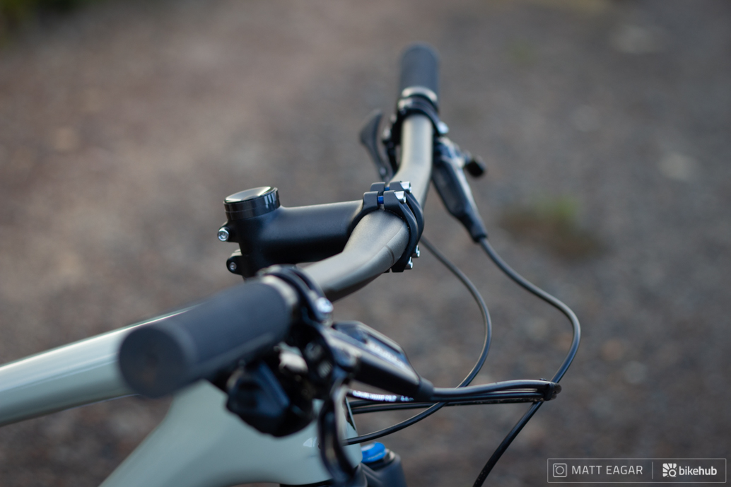

The Epic EVO also sports a longer aluminium handlebar than the racier Epic, growing from 720mm to 750mm. Easily shortened should you not appreciate the added width. The stem length on the extra large bike was a suitable 80mm. My butt thoroughly enjoys Specialized saddles, so the stock Phenom saddle needed no changing. I found the Specialized grips a bit hard for my desk jockey hands, with the raised bits causing some irritation on longer rides.

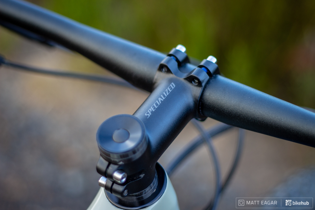

  • STEMSpecialized XC, 3D-forged alloy, 4-bolt, 6-degree rise
  • HANDLEBARSSpecialized Alloy Minirise, 10mm rise, 750mm, 31.8mm clamp

  • RIMSRoval Control Carbon, 25mm internal width, tubeless-ready
  • FRONT TIREGround Control, GRIPTON compound, 60 TPI, 2Bliss Ready, 29×2.3″
  • REAR TIREFast Trak, GRID casing, GRIPTON compound, 60 TPI, 2Bliss Ready, 29×2.3″

A large part of the Epic EVO’s climbing ability is down to the Brain system. It works supremely well to keep the bike stiff under pedalling power while opening up for most bumps, even working to hold traction well on technical ascents. It is hard to gauge on the rough mountain side climbs but smashing the pedals on the tar shows no sign of suspension movement. It may sound trivial but I appreciate freeing up my own brain without the need to consider a lockout. Hit a climb, it’s already locked out. Drop down single track, it opens up when needed. It’s a similar sense of relief that you feel when making the switch from two-by to a single chainring drivetrain. It also makes the Specialized cockpit one of the cleanest looking in the business.
ccs-62657-0-27907700-1536738981.jpgEven with the dropper post lever, the Epic EVO offers clean controls.
Of course, there’s the infamous knocking sound and feel as the Brain opens to allow the shock to absorb the bumps and jolts. It’s still there with the newer Brain design and I can understand how the feeling might grate your nerves. I found that after a few rides I quickly tuned it out. I’ve always taken the knock as a reminder that the system works.

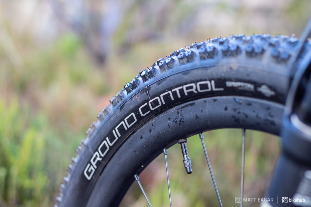

The latest Ground Control design adds an additional knob offering reliable and predictable grip which urges the rider to push the front wheel into the bends. The previous tyre had problems with a vague feel when leaning over in a turn, making it susceptible to a scary washed out feel while transitioning to the outer tread.
