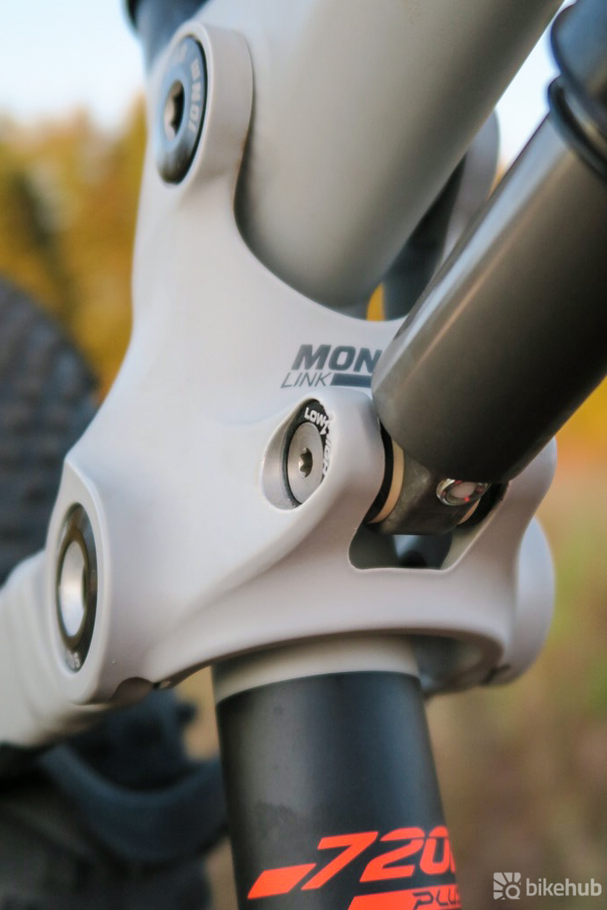

The frame is hydroformed using custom butted 6061 Alloy and designed around a link driven single pivot with a forged link activating the rear shock. The ace up its sleeve is adjustable geometry by way of a shock mount chip in the linkage. This is done by removing the shock mount chip and flipping it into either “high” or “low” mounting position. Doing this will change the bottom bracket height by 5.5mm and the head and seat tube angles by 0.5 degrees. It has a knock-on effect on other measurements as well – in actual fact, only the chainstay and seat tube lengths remain untouched.
Scott utilizes a progressive leverage curve and a relatively low main pivot which follows the current industry trend. This allows a more supple suspension at sag but with some ramp up as the wheel moves towards bottom out. Helping to give the Genius good small bump efficiency but keeps it from bottoming out or diving through its travel when the going gets rough. The relatively low main pivot location was a clear decision by Scott to maximize pedaling efficiency.

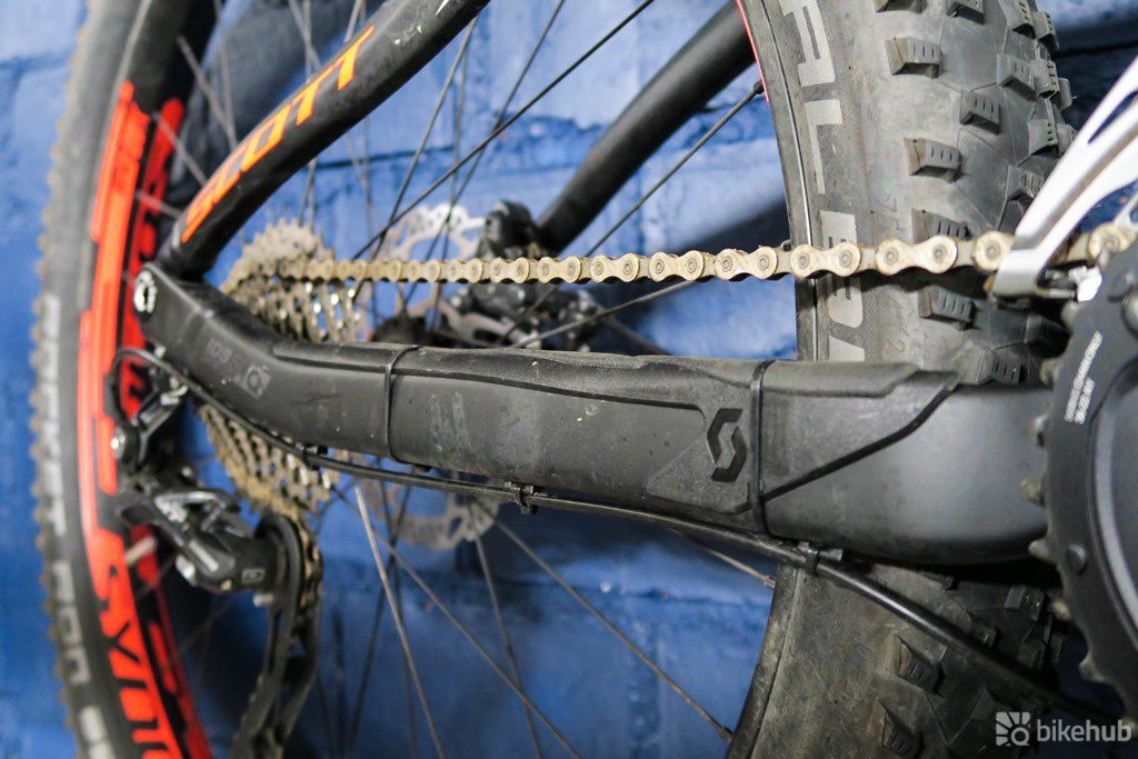

A “chainblocker” plate protects the frame from chain suck by blocking it from falling off the inner ring and damaging the frame. The system is compatible with 3x and 2x drivetrains. The optional ISCG adaptor allows riders to run a chain device for single or 2x chain set and is removable when not in use. More attention to detail can be seen in the IDS-SL dropout system which works with 142x12mm, 135x12mm and 135x5mm QR rear axle standards with bolt torque specs printed on the bearing caps.

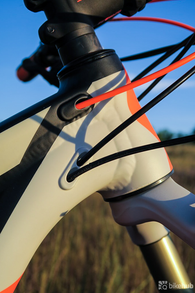

  • Internal cable routing

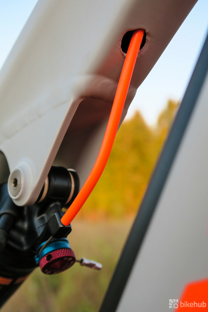

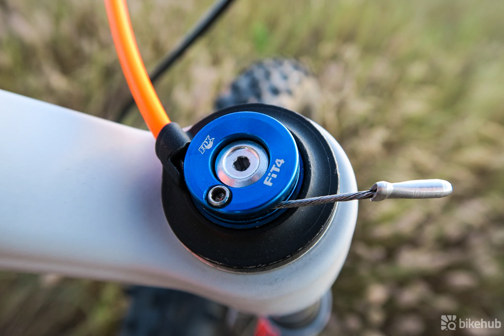

Twin Loc Lever System
https://vimeo.com/6849224
Like most of their bikes, the Scott Genius Plus comes fitted with their patented TwinLoc system which is controlled by a handlebar mounted lever. When the lever is pushed to switch the shock to Lock mode, the fork is simultaneously put into Climb mode. Switching to Traction mode limits the rear shock’s travel to 100mm and puts the front fork into Trail mode.
The reduction in travel in Traction mode is achieved by reducing the shock canister’s air volume, creating less sag, which in turn raises the bike’s ride height, and slightly steepens the head angle. Pushing the lever to its second stop locks out the shock and fork entirely, turning the Genius Plus into a rock solid pedaling machine.
I’m not the biggest fan of the Twin-loc though. I can appreciate it on a bike that is meant to a beast in climb mode or where saving vital seconds can mean the difference in a podium or not, but on a bike that is meant to slay trails, I’d prefer to be able to separate front and rear lock out. Although I ride bikes as open as possible most of the time, I do add a bit of platform to the rear every so often, but just about never to the fork. The twin lock out lever also makes for a very busy cockpit.

Fork: It’s great to see Scott fitting a Fox 34 as it will go a long way to keep you and the bike in check on technical terrain. With the traction and grip that comes with 2.8-inch tires, the extra stiffness and control from the Fox 34 was a welcome relief. The performance of the Fox 34 Float Performance FIT4 was good and a massive improvement over the 32 on the standard Genius 720 tested earlier this year.

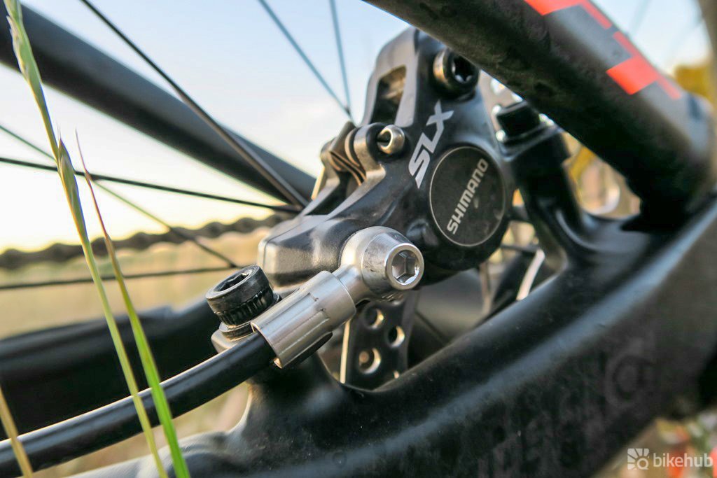

Brakes: We’ve said it before and we will probably say this a good couple of times more – Shimano SLX brakes offer very good value for money with the stopping power and overall feel on offer. Paired with 180mm rotors front and rear, there was no faulting these brakes.

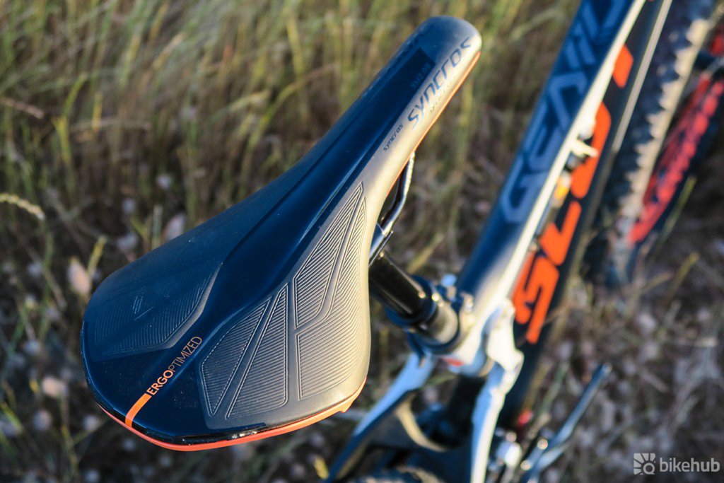

Saddle: The Syncros XM2.0 with Cromoly rails was comfortable and its orange base fitted in nicely with the rest of the bike.

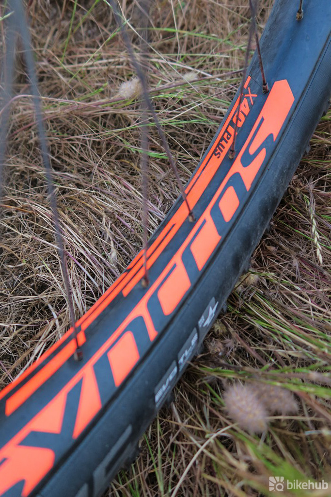

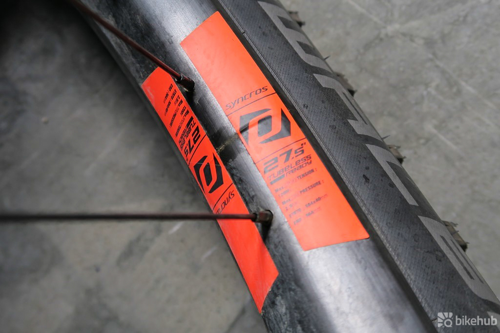

Wheelset: The Syncros hubs made by Formula are laced to Syncros X-40 rims using DT Swiss Champion spokes. I have no reference for 27.5+ wheels other than a couple of quick spins. What I can say is that I like the fact that Syncros has gone suitably wide with them. There are some plus bikes running on rims that are narrower than what is considered the norm on 27.5″ and 29″ wheelsets. If plus bike rims are too narrow, the contact patch size decreases resulting in less traction – negating the whole point behind going Plus.

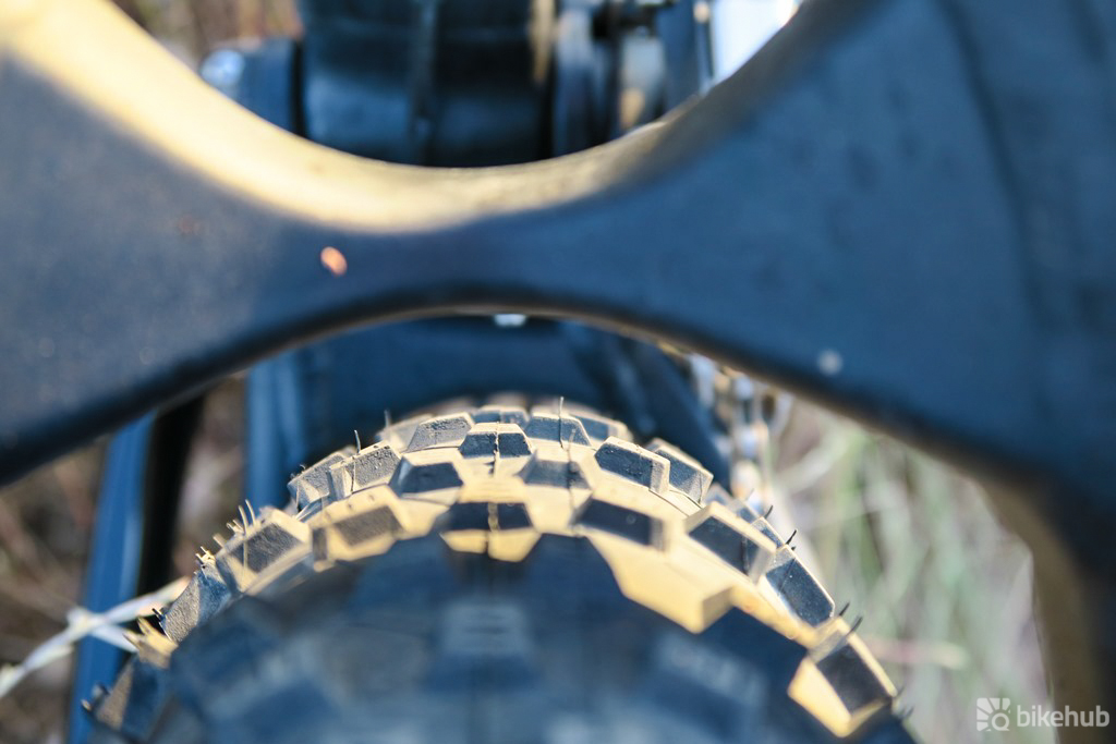

Tyres: All Scott Plus bikes will be supplied with Schwalbe Nobby Nics or Rocket Rons dependent on model. The Genius Plus 720 comes with a Nobby Nic Evo front and a Rocket Ron Evo rear. The 820 gram 2.8″ tyres look like their counterparts but on steroids. With 27.5+ being this new to the market there is very little reference and comparison available. We hope to change this in 2016 by spending as much time as possible on different plus bikes, tyres and wheels.

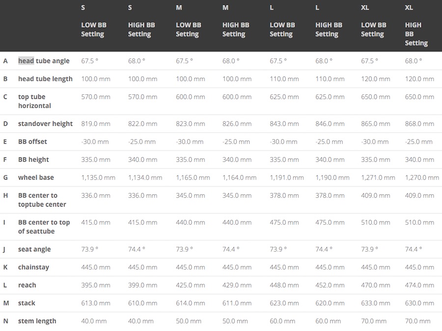

Geometry
From the Manufacturer:
The phrase “Any Trail, Any Time“ was coined a few years back to describe the Genius series. The all NEW Genius 720 Plus makes that phrase ring even truer. Adding plus sized wheels to what is already one of the most capable rigs on the market ups the level of traction, comfort, and most importantly fun hogging. Sporting an Alloy frame, the 720 comes in at a lower price point. Rocks, roots and boosts beware, this bike is ready to rumble.
