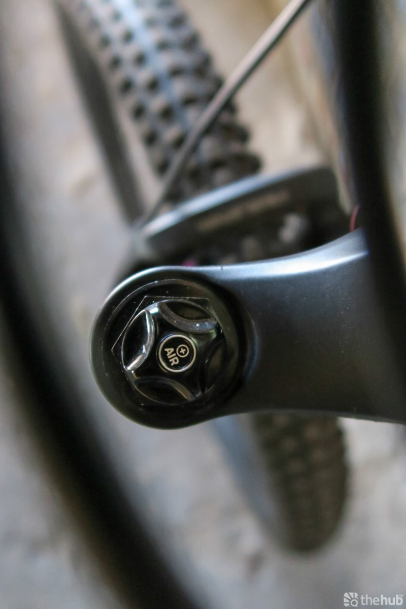

Updated for 2014 with a Solo Air air spring (only one adjustable air chamber), the 2015 is unchanged and is available in every wheel size and travel options to please most trail riders.
The addition of a Solo Air spring saves a few grams over the previous dual air spring and does away with the need and ability of adjusting two separate air chambers on either end of the fork stanchion. Although, at first accused for dumbing down fork tuning, the result has been a smooth, stiction-free ride with minimal set up time. With the new Solo-Air design, a small dimple on the wall of the inner leg allows air to bleed from the main air spring to the negative spring, automatically balancing the two pressures. While Dual Air allowed for a good deal of flexibility in tuning, most people arrived at fairly evenly matched pressures in the negative and positive chambers. Solo Air does just that with one less valve and no chance of getting it wrong.

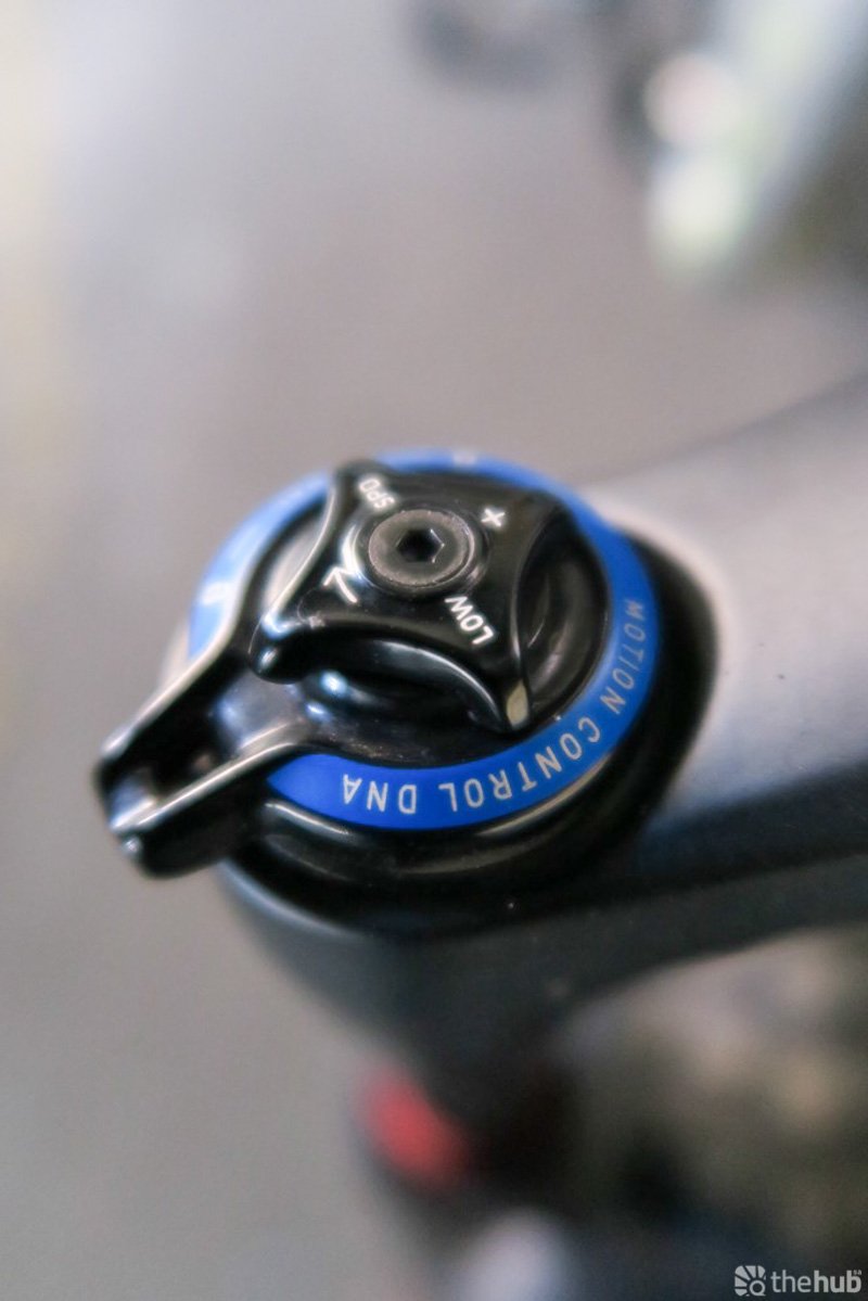

Motion Control RCT3 damping allows the choice of three settings, adjustable with the flick of a switch. Open, Threshold (extra resistance in the beginning of the stroke but not locked out), and Lock-Out. The Lock-Out setting is not a complete locked out and firms things up. Low speed compression can be tuned with eleven clicks of the black dial on top of the blue Motion Control switch, while high speed is pre-set.

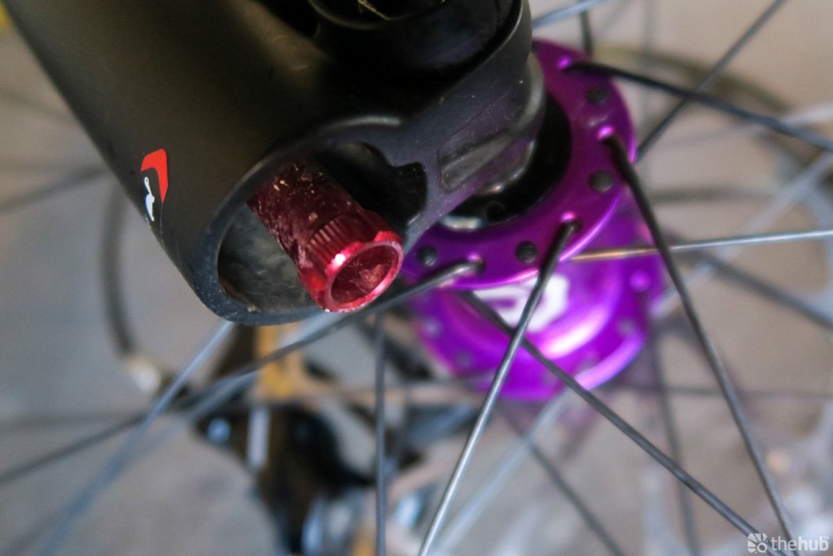

A tapered (1.125″ to 1.5″) head tube and 15 mm through axle are standard spec, with RockShox’s trademarked Power Bulge and 15mm Maxle Lite adding extra stiffness to combat flex in the lowers.

As usual, I left the fork in the fully open mode and adjusted the low speed compression to fine-tune the firmness. The lock setting is very firm and close enough to completely rigid and I have only used it once or twice doing some intervals on tar or gravel district roads. The middle “Threshold” setting does a good job to limit bob under heavy load, but is not a setting I would use often as it rids the fork of small-bump compliance. Whilst there is a learning curve to fine-tuning the RCT3 damper, initial set-up is easy, thanks to guides on the fork. An air pressure chart gives starting PSI measurements, travel & sag indicators on the stanchions and fast & slow rebound directions are displayed on the fork.
