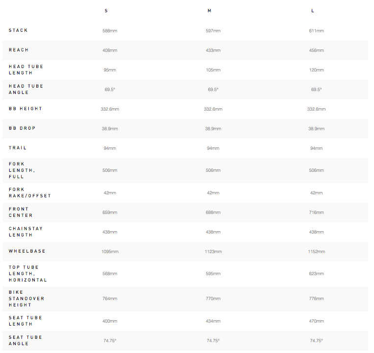

The head tube angle has slackened from 70.5 to 69.5 degrees, the chain stays have shortened by 10 millimetres to 438 millimetres, the reach has been extended 15 millimetres to 433 on the medium frame. In addition, the wheelbase has grown by 11 millimetres to 1123 millimetres on a medium frame. The seat tube diameter has been expanded from 27.2 to 30.9 millimetres which means that a greater range of dropper posts can now be accommodated.

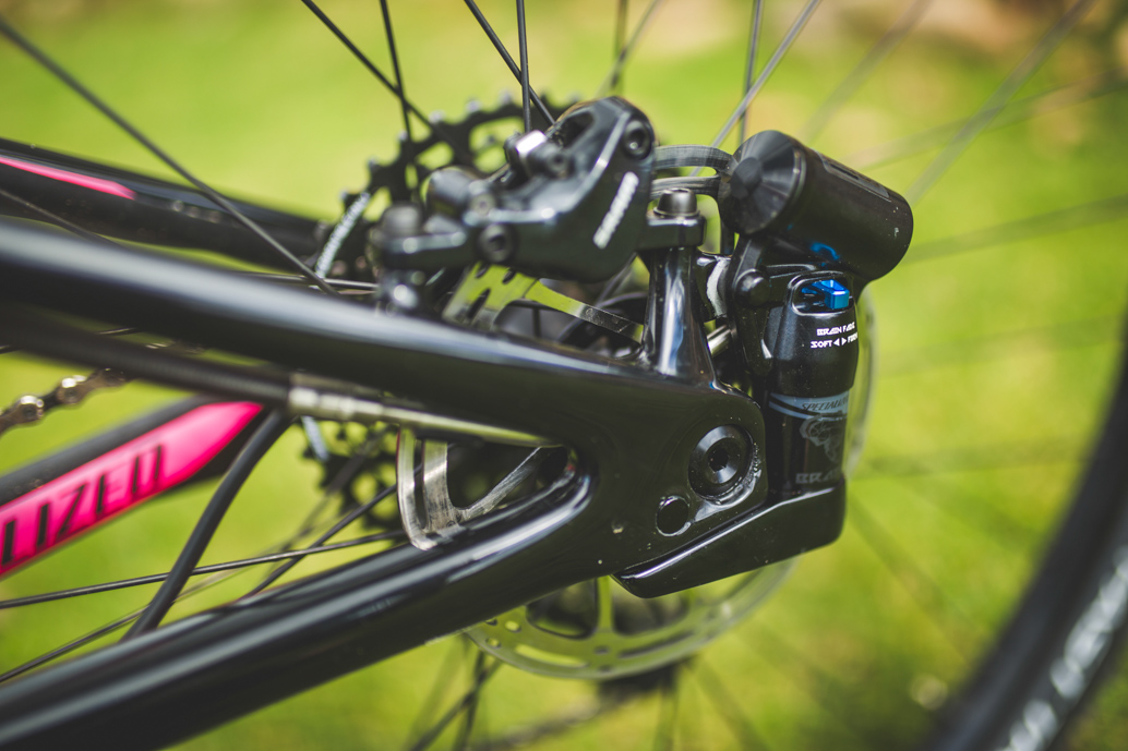

The famous Brain suspension has been relooked and features an updated RockShox damper, a new position closer to the rear axle for improved sensitivity and response time, and the oil hosing has been integrated into the suspension links to create a smoother path for oil flow and to minimise turbulence while keeping the aesthetic clean.
Finally, the rear pivots have been replaced with flex stays in an effort to further shave weight off the frame.

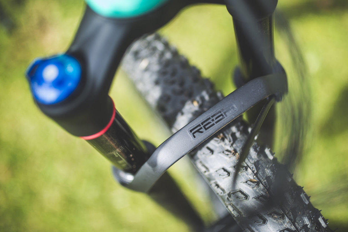

  • ForkRockShox Reba RL 29, Solo Air, compression / rebound adjust, tapered alloy steerer, 42mm offset, 110x15mm Maxle Stealth thru-axle, 100mm of travel, RX Women’s Tune

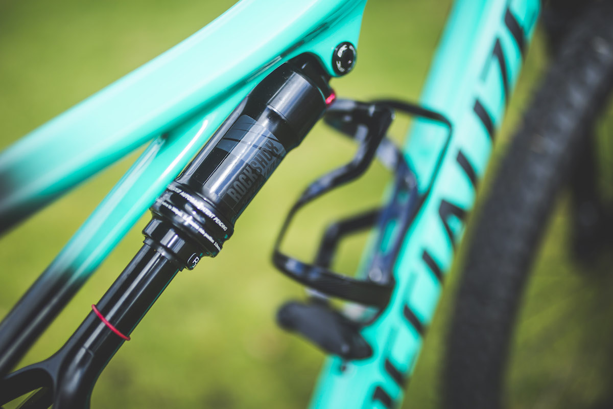

  • ShockRockShox Brain, Women’s Rx Tune, AUTOSAG, 51x257mm

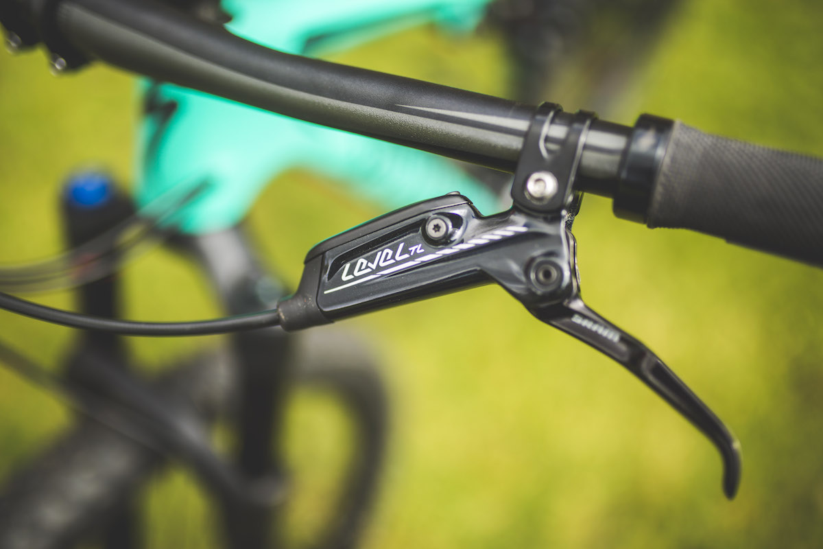

  • Front BrakeSRAM Level TL, hydraulic disc, organic pads, 160/180mm rotor
  • Rear BrakeSRAM Level TL, hydraulic disc, organic pads, 160 rotor

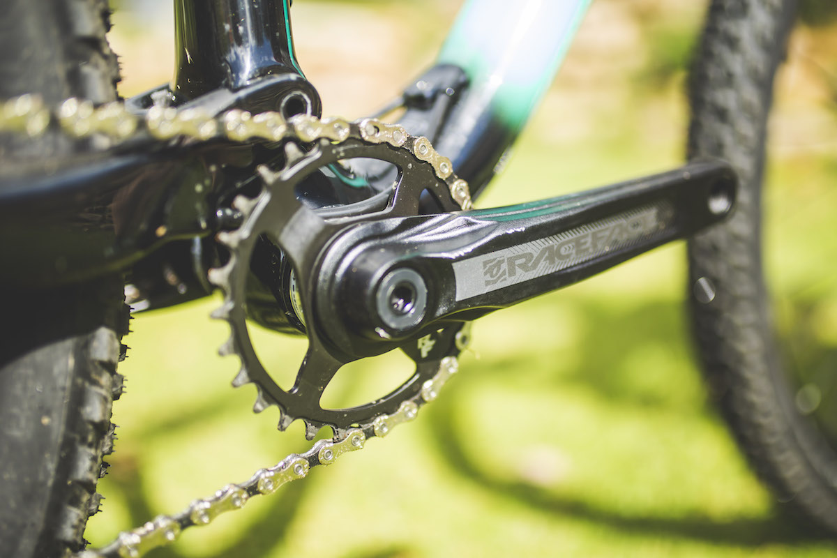

  • CranksetRace Face Aeffect, 6000 Series alloy
  • ChainringSteel, 28T

Geometry

The Brain’s response to bumps can be adjusted between five settings from soft to firm. I initially set it to medium and tried this on the first climb and descent. Due to the way the brain works there is a noticeable knocking noise and slight feedback through the bike when the inertia valve opens as the rear wheel strikes an obstacle. I find this noise mildly unsettling when descending and switched the Brain to soft, which seemed to improve things, and kept the rear wheel tracking beautifully in the damp Boschendal dirt.

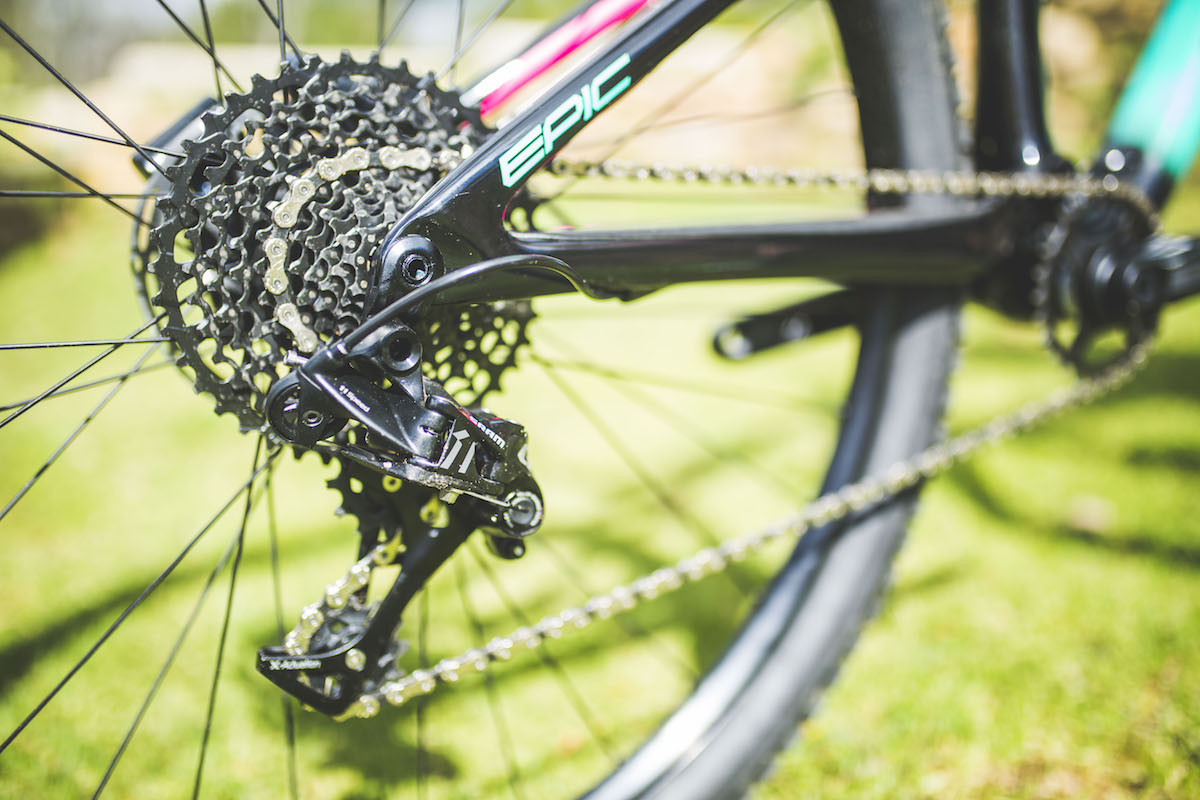

In terms of this specific build, the components seemed well matched. A RockShox Reba fork (sans Brain), SRAM Level TL brakes, SRAM GX 11-speed with a RaceFace Aeffect crank and a reliable Roval Control alloy wheelset. The Fast Trak tyres, 2.3” on the front and 2.1” on the rear, punch well above their weight in terms of grip on offer from what is ostensibly a cross country tyre. For my own riding, I’d swap these out for Fast Trak GRID and the extra sidewall protection they offer.

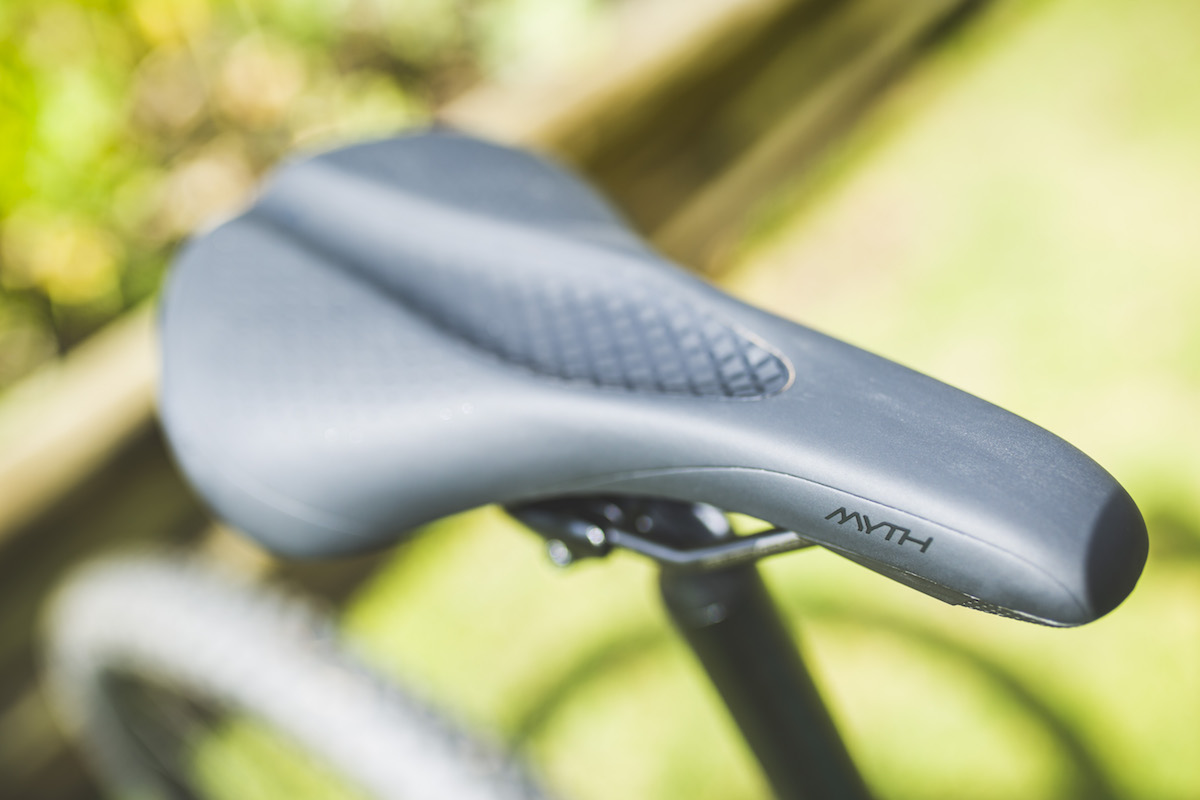

Personal preference would see a bigger chainring than the 28T specced, and the Myth Sport women’s specific saddle doesn’t work for me. Ironically enough I prefer the Phenom that is specced on the men’s model.

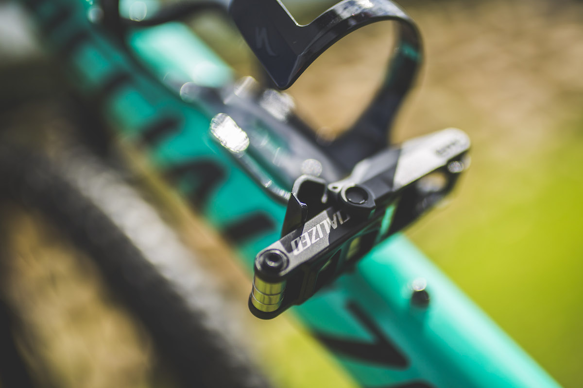

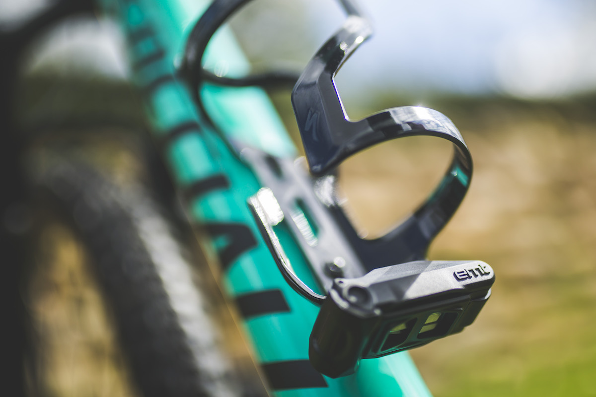

An easily accessible multitool: you won’t know you need it, until you need it.
