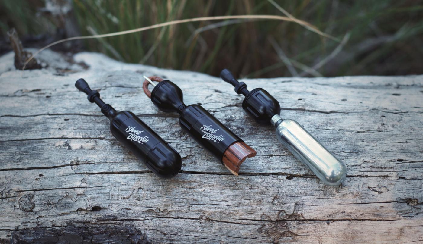

Tubeless tyre technology is arguably one of the most significant improvements to mountain biking over the past years. Although this technology is a massive improvement there is a good chance you have had a ride ruined by a tubeless tyre failure and not having the right tools on hand to fix it. For this reason we developed the Shred Zeppelin all-in-one tubeless repair tool.

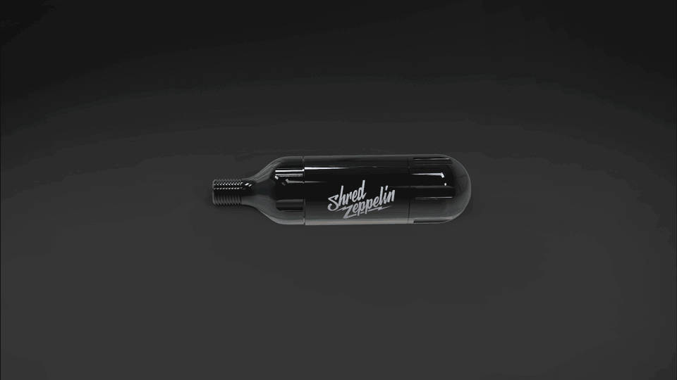

Tubeless repair solutions in the past have been somewhat unrefined and required many separate parts to create a complete kit. Our goal was to design an all-in-one solution that would integrate all the required tools and could also be attached to the bike. The Shred Zeppelin has the same silhouette as a CO2 canister and is compatible with CO2 brackets and includes a tubeless plug applicator, tubeless plug storage, CO2 regulator and a valve core remover.
Tubeless Plug Applicator and Storage

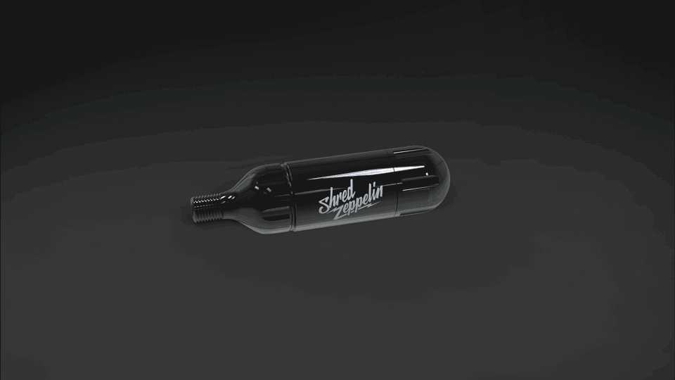

If you unscrew the threaded end of the tool and thread it into the CO2 regulator side the Shred Zeppelin becomes a Tubeless Plug applicator. The tubeless plugs are stored within the body of the tool. The shortened applicator prong design prevents the plug being inserted too far in to the tyre. Simply fold over the tubeless plug after inserting it in to the prong, plug the tyre and pull out the tool, the plug is short enough not to require trim- ming.
CO2 Regulator
Unscrew the back end of the tool and the Shred Zeppelin becomes an in-line CO2 regulator. Screw in a CO2 cartridge fully to puncture the seal then push over the opened valve. Tightening or loosening the cartridge will regulate the CO2 flow.

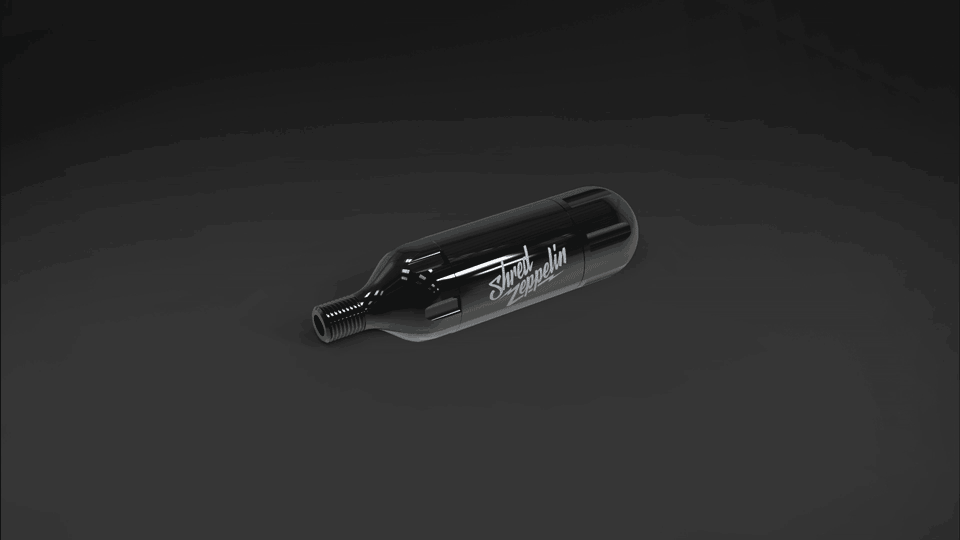

Valve Core Tool
Inside the threaded end of the tool is a valve core removal slot. Simply place the tool over the valve core and turn it to tighten or remove the valve core. It is recommended that the valve core be removed if a tubeless tyre needs to be re-seated on the rim.
Specifications:
Material: CNC 6061 Alloy
Weight: 47g with plugs
Functions:
  • Tubeless Plug Applicator
  • Tubeless Plug Storage (Includes Plugs) CO2 Regulator
  • Valve Core Remover
Price: R349
