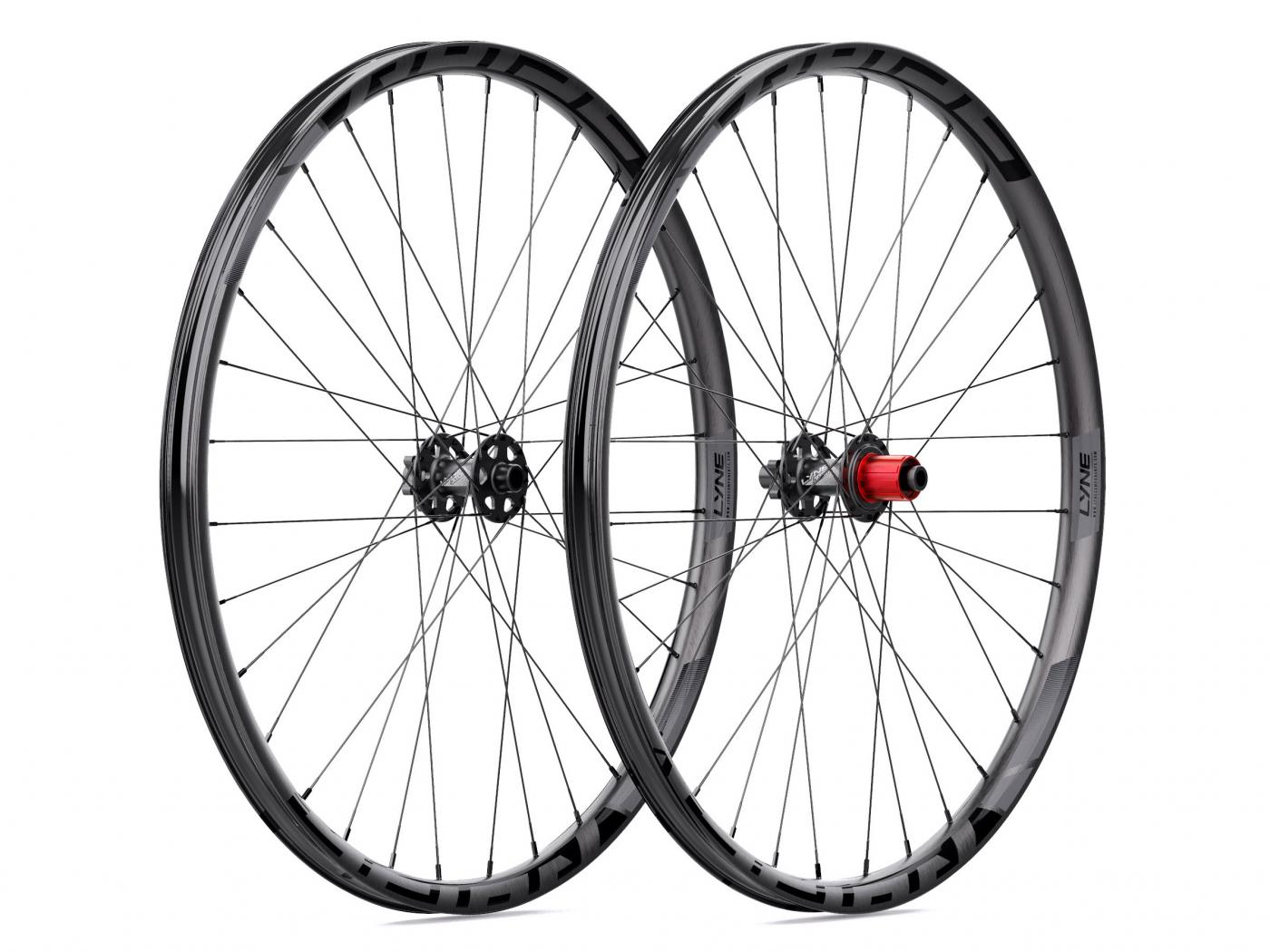

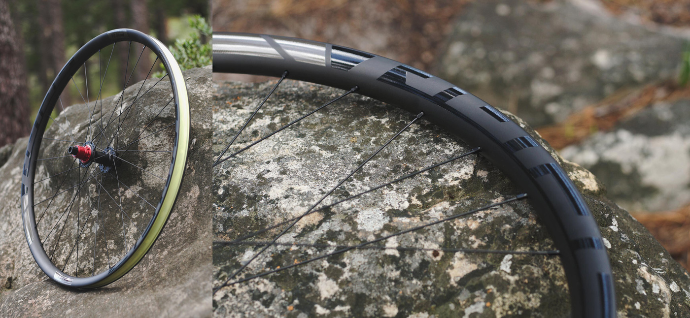

Pulse Carbon Wheelset
The Pulse carbon wheelset uses a wide hookless profile laced to our lightweight JB01 hubs. The result is a stiff & fast, race ready wheelset.

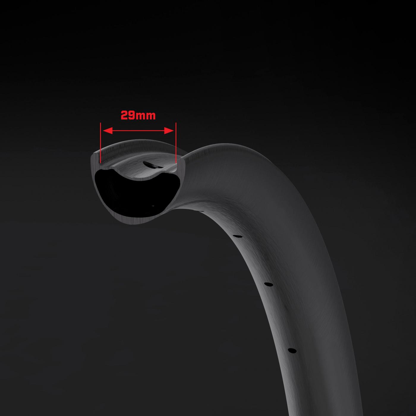

Pulse Carbon Rim Profile
The wide internal width of 29mm sets a stable base for your tyres. This helps combat sideward forces that would typically cause tyre roll and burping. Predictability is key when pushing tyres to their limits and having a stable predictable wheelset makes all the difference.
The hookless profile holds the tyre securely and makes tubeless inflation a super easy process.
Weight is key when offering equipment that is made for racing. Our XC/Marathon layup results in a rim weight of 390g. This is the perfect middle ground between efficiency and durability. Finish the race- first!
The Pulse Carbon rim design is asymmetric. This results in a more even spoke bracing angle which increases wheel stability and overall stiffness. The spokes are also more evenly loaded which increases spoke durability.
Specifications:
Pulse Carbon Wheelset 29”
Intended Use: Marathon, Cross Country
Internal Width: 29mm
External Width: 35mm
Rim Weight: 390g
Weight: Small Bearing Hub +-1490g (+90g for large bearing hubs)
ETRTO: 622mm
ERD: 589mm
Rim Material: Toray T700 carbon
Spoke Count: 28
Spoke Type: Pillar PSR TB 2016
Nipple: Alloy Double Square 2mm
Hub: Lyne JB01 Boost, F: 15X110mm, R: 12X148mm
Free Hub: Shimano HG/Shimano Microspline/XD options, 30 Point (12°) Engagement
Rider Weight Limit: Under 100kg
5 year crash replacement
5 year warranty
Price: R14,999 Available Online

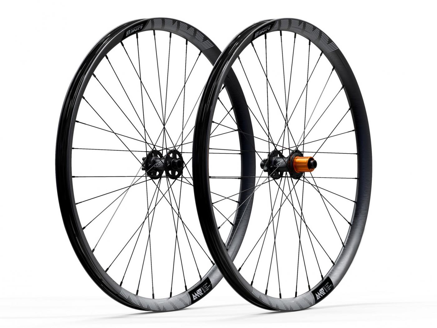

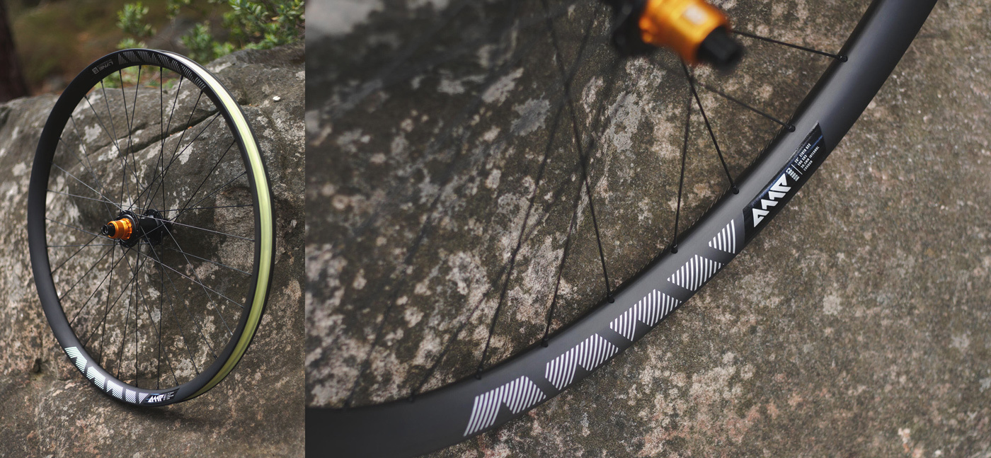

AMP Carbon Wheelset
The AMP Carbon wheelset has been fine tuned to meet the demands of modern trail & enduro riders. The rim profile features a super wide inner and outer width resulting in a stable and durable ride. These wheels come standard with our High Engagement hubs, which offer reliability, fast engagement and a great sound when freewheeling.

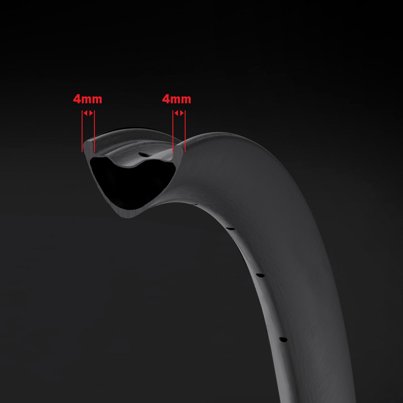

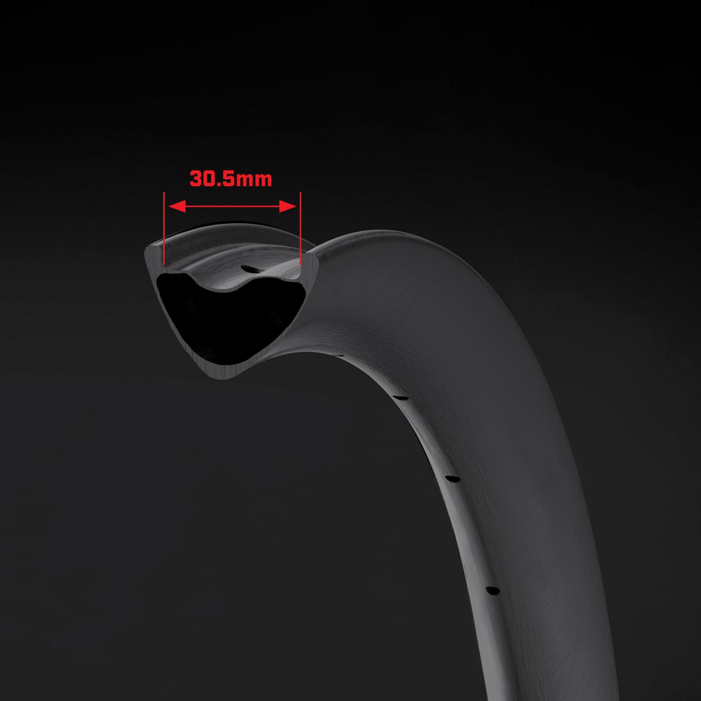

AMP Carbon Rim Profile
The wide internal width of 30,5mm sets a stable base for your tyres. This helps combat sideward forces that would typically cause tyre roll and burping.
Predictability is key when pushing tyres to their limits and having a stable predictable wheelset makes all the difference. The hook- less profile holds the tyre securely and makes tubeless inflation a super easy process.
The AMP Carbon rim features an ultra wide external width making the bead wall of the rim thicker and more durable. This area is usually the first point of impact when encountering rim strikes and is typically where carbon rims fail. By widening this area there is more material present which results in a more sturdy impact surface.
These rims are asymmetric. This results in a more even spoke bracing angle which increases wheel stability and overall stiff- ness. The spokes are also more evenly loaded which increases spoke durability.
Specifications:
AMP Carbon Wheelset 29”
Intended Use: Trail & Enduro
Internal Width: 30,5mm
External Width: 38,5mm
Rim Weight: 450g
Wheelset Weight: JB02HE 1798g; JB03HE 1815g
ETRTO: 622mm
ERD: 583mm
Spoke Count: 32
Nipple: Brass Double Square 2mm
Front Hub: Lyne JB02HE Boost 15X110mm
Rear Hub: Lyne JB02HE/JB03HE Boost 12X148mm
Free Hub: Shimano HG/Shimano Microspline/XD options, 150 Point (2.4°) Engagement
Rider Weight Limit: Under 120kg
5 year warranty
Price: R15,999 Available Online
