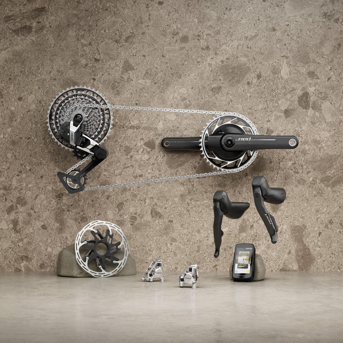

SRAM RED XPLR AXS is our most advanced gravel group, featuring a 13-speed 10-46T range so you’re always in the right gear. Precise shifts with tight jumps between cogs keep you in the gearing sweet spot, and the Full Mount derailleur that fits on frames with the UDH interface ensures this system can take whatever you throw at it. True one-finger braking, and significant weight reductions mean RED XPLR AXS flies up and down any route, with all your effort propelling you forward.

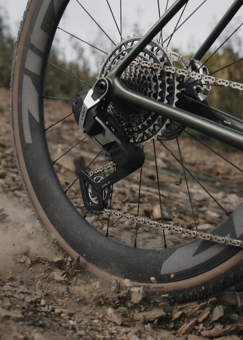

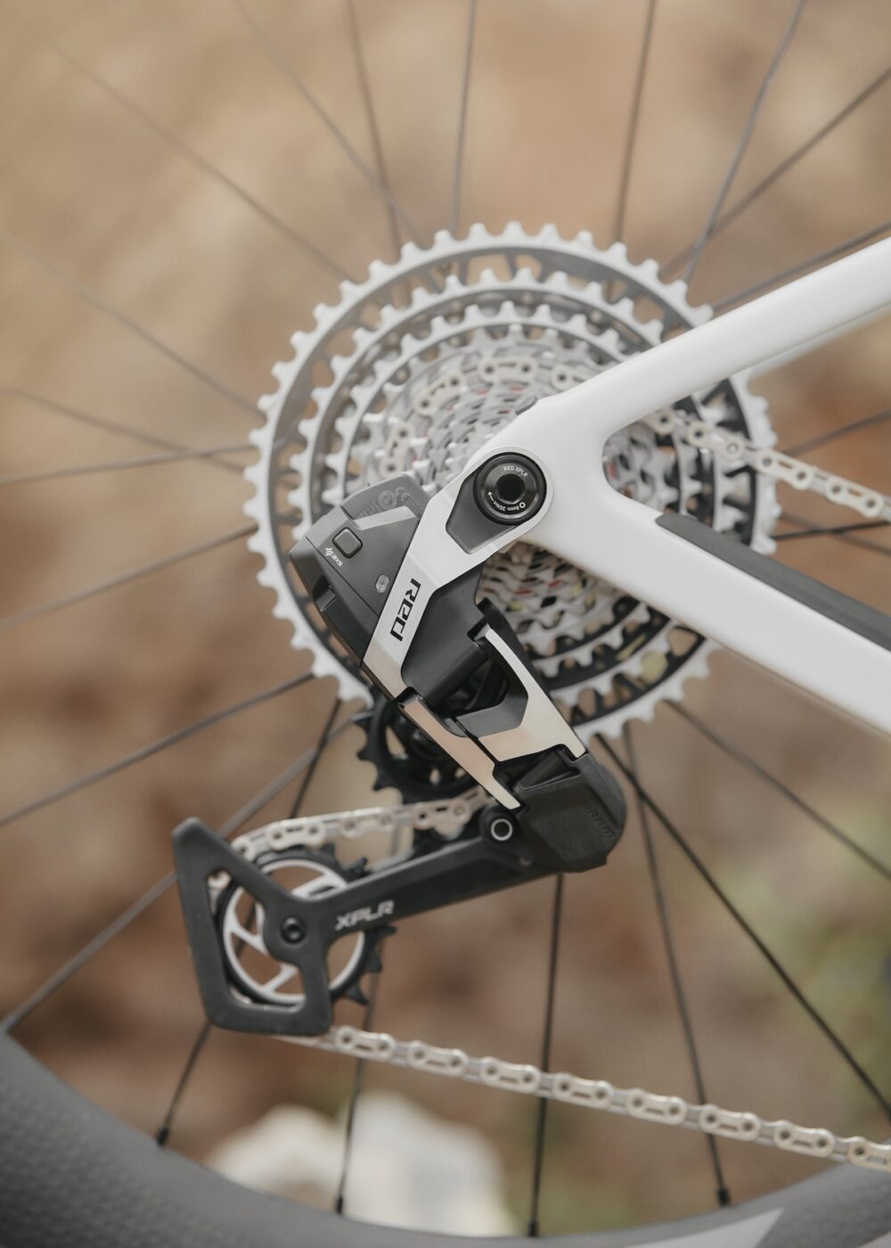

Gravel throws just about everything at your bike, and the RED XPLR AXS rear derailleur will happily take it all. Bring on the sticks, stones, and airport baggage abuse because the Full Mount derailleur design fits onto frames with the hangerless interface to make for the most robust and reliable gravel drivetrain possible. No adjustment screws mean setup is simpler than ever. And a surprise stick is no match for the Magic Wheel, as the debris-resistant lower pulley keeps the chain moving at all times. Purpose built for gravel, this 1x specific unit prioritizes shift precision and chain management no matter the terrain or conditions.
  • 1x specific for use with 10-46T XPLR
  • 13-speed cassette and road Flattop chains
  • Hangerless Interface and Full Mount attachment allow for the most precise shifting and the ultimate resistance to impact
  • Requires frame with UDH interface
  • Simple setup with no adjustment screws
  • Superior chain management with MTB-inspired spring clutch
  • Replaceable and rebuildable parts
  • Magic Wheel keeps the chain moving, even if debris enters the lower pulley
  • Compatible with existing AXS batteries

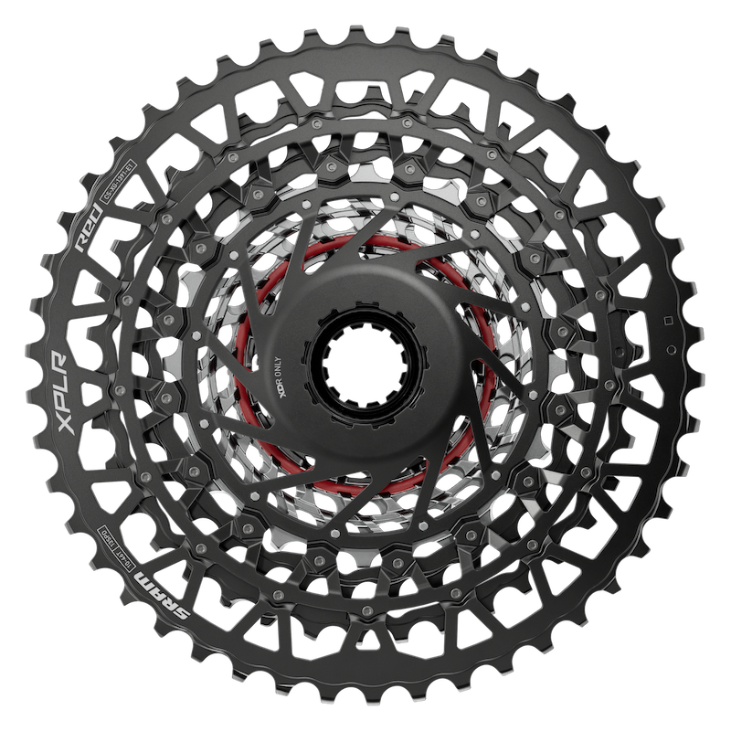

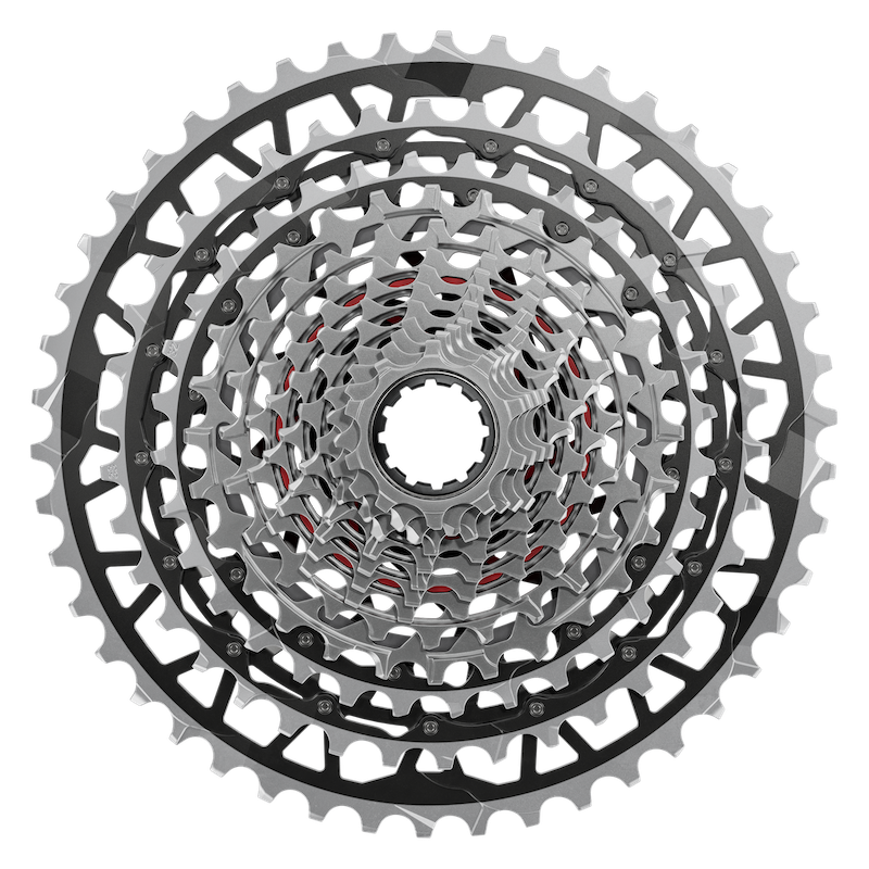

RED XPLR XG-1391 Cassette
As the terrain gets tougher and the pace gets faster, you need the right range to keep moving and the best steps between gears to keep up. The 460% range of the RED XPLR XG-1391 13-speed cassette gives you the climbing gears you crave on gravel and the tight jumps you need on spicy sprints. Enjoy the highest shift quality on even the roughest roads thanks to optimized shift features on each cog, all from a cassette that weighs only 288 g.
  • Expanded 460% range gives the added coverage 1x gravel riders demand
  • For use with XPLR 1x 13-speed rear derailleurs
  • Only 288 g
  • Compatible with all road Flattop chains
  • Compatible with XDR driver body

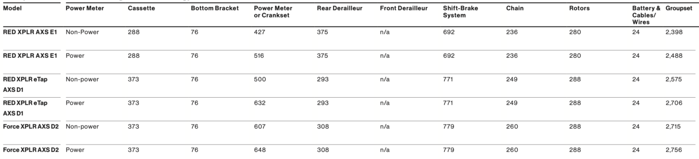

Weights
