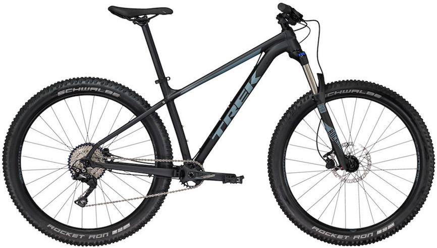

ccs-62657-0-70672300-1508745847.jpgTrek Roscoe 8

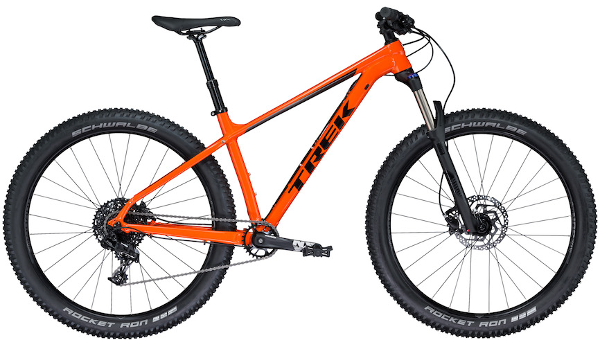

ccs-62657-0-99893300-1508745748.jpgTrek Roscoe 8 WSD.

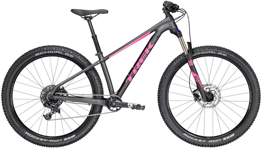

ccs-62657-0-14948900-1508745748.jpgTrek Roscoe 7

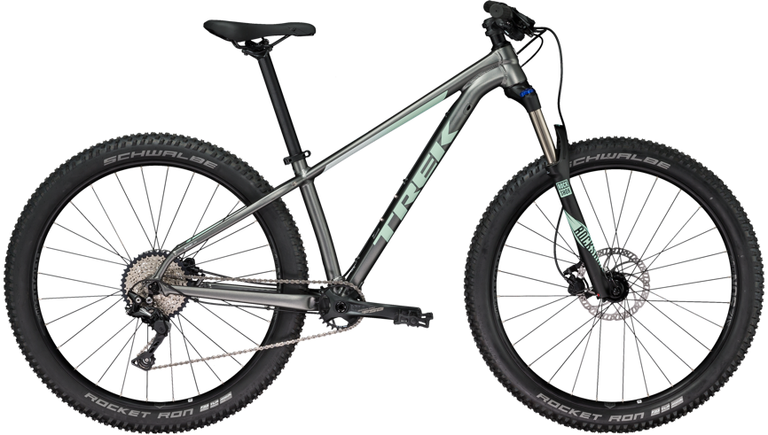

ccs-62657-0-31800500-1508745750.pngTrek Roscoe 7 WSD
