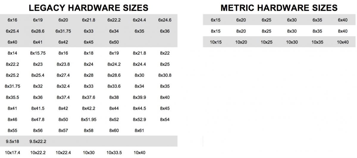

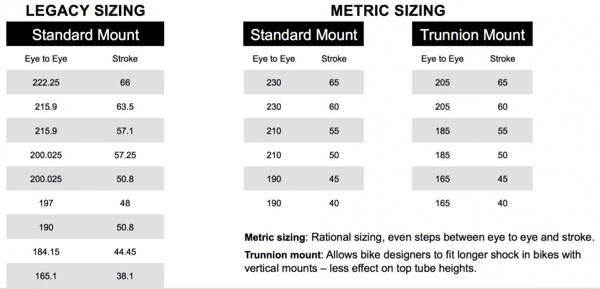

RockShox engineers suggested a metric solution: rational sizing, with even, logical steps between eye-to-eye and stroke, a new relationship between eye-to-eye and stroke, and new mounting options. Implementing these suggestions meant that bike manufacturers would themselves have to question the system that had worked well enough for so many years, and agree that there could be a better way to approach suspension.
Luckily, many of the world’s biggest and most exciting mountain bike manufacturers came onboard with the idea, which is no small ask, considering the fact that existing bike designs would need to be reengineered to work with the new shock sizing.
If the story stopped right here, we’d have enough to celebrate. Simplifying the eye-to-eye to stroke relationship and paring down the insane amount of mounting hardware to a reasonable level is enough to make shop mechanics everywhere breathe a sigh of relief. But the point of changing the approach was really all about performance.

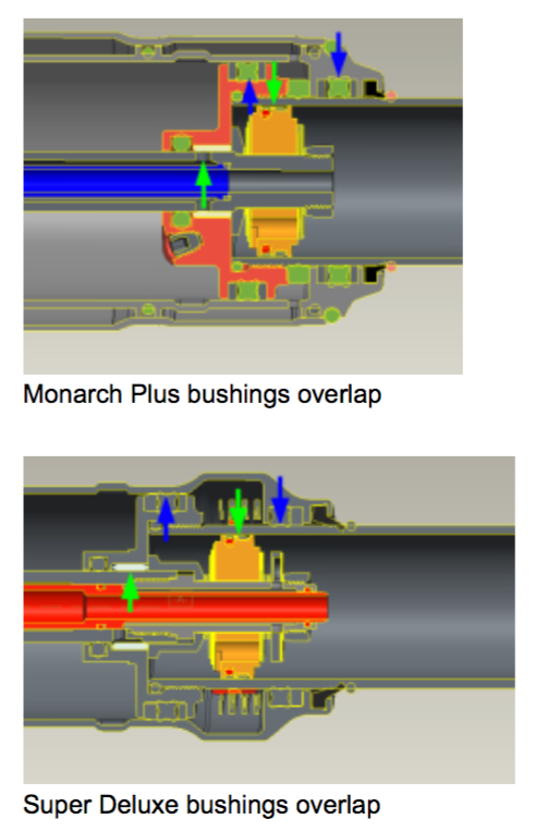

The new, metric-sized Deluxe and Super Deluxe benefit from greater bushing overlap on all moving elements of the shock. This is significant in the fact that it increases lateral stiffness, which, in turn, helps to decrease friction.

Same process described previously. There are currently almost 90 varieties of rear shock hardware being used in the industry.

Performance Achievement 1: Bushing overlap
Starting with a blank slate allowed us to extend bushing overlap between the moving elements of the shock. This greatly reduces system friction under load. Riders benefit from this with:
  • better traction
  • responsiveness
  • increased durability
Air can bushing – 33% more overlap
Piston/sealhead bushing – 90% more overlap

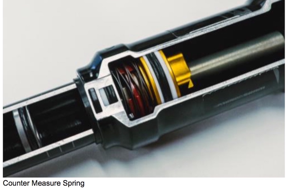

Performance Achievement 3: Counter measure
Introduced in 2013 on Vivid and Vivid Air and highly acclaimed for its effects on shock performance at top-out, the Counter Measure spring works to oppose the effect of the IFP pressure, effectively lowering the initial breakaway force.

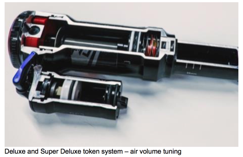

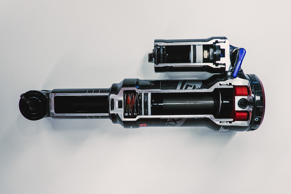

Introduced in 2014, the DebonAir air can option for Monarch and Monarch Plus was a stepping stone in improving the performance and feel of air shocks on all kinds of bikes. Deluxe and Super Deluxe take this to the next level by incorporating DebonAir in the air can design without any added weight or complexity.
The air volume tuning system on Deluxe and Super Deluxe capitalizes on RockShox’s Bottomless Tokens technology, adapting it to its rear shock platform in a clean and easy to use format.

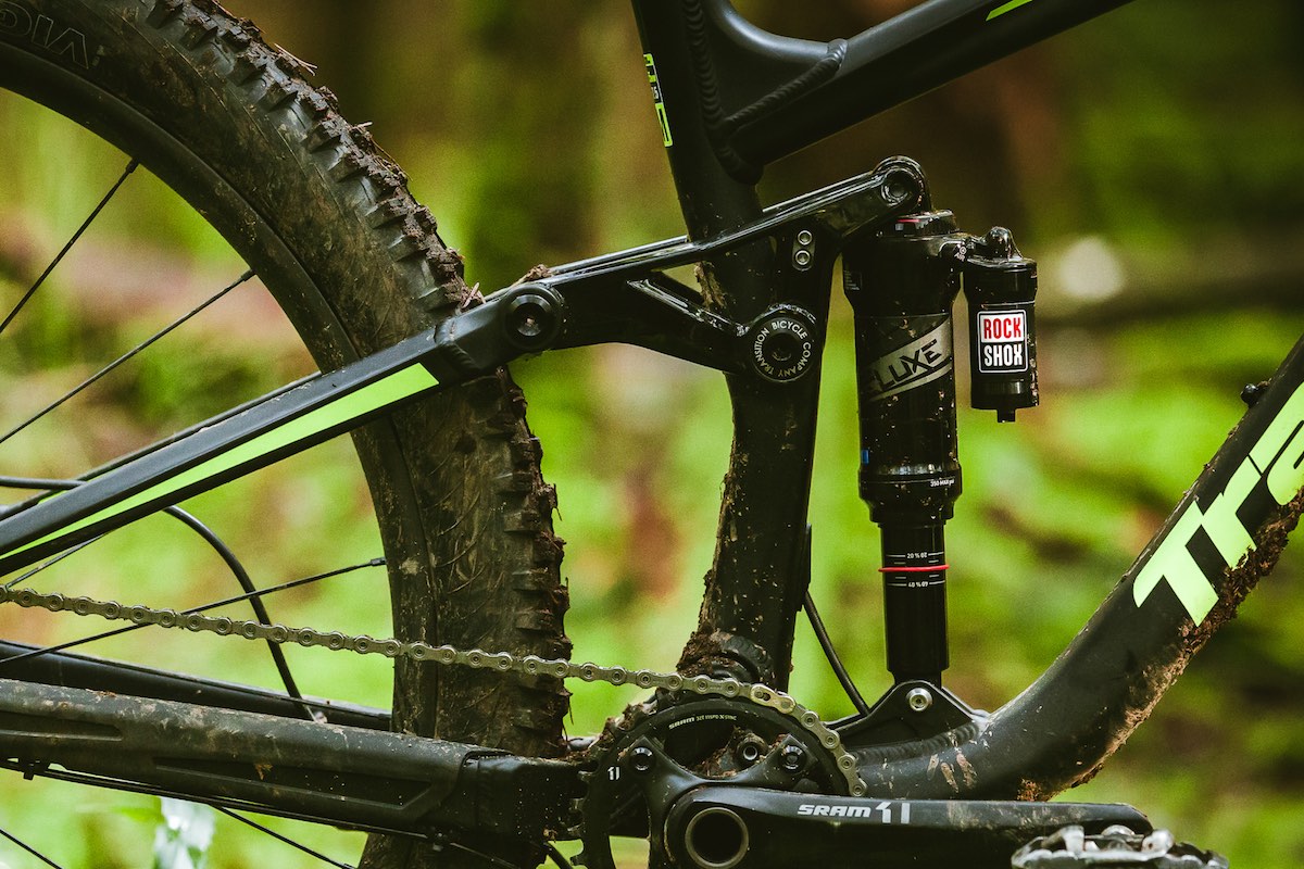

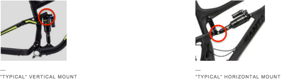

Integration Achievement 1: Mounting System
“Typical” vertical mount:
  • Higher rotation at shaft eyelet (70-120 degrees)
  • Recommend use of Trunnion mount or shaft end bearing mount
  • Shaft end bearing mount is recommended to reduce overall suspension friction
  • Trunnion mount can reduce overall length by 25mm to allow for lower top tube height
“Typical” horizontal mount:
  • Higher rotation at body eyelet (70-120 degrees)
  • Recommended use of body end bearing mount to reduce overall suspension friction
The Trunnion mount allows for a shorter eye to eye length while maintaining a specific stroke size (25mm overall length reduction over standard or bearing mount). Benefits are significant for smaller frame sizes, women specific models and bikes that are designed for low standover height.
  • Designed to be used in conjunction with frame mounted bearings at the mounting bolts.
  • Bearings eliminate friction caused by pivot rotation.
  • Smoother shock action resulting in better traction and responsiveness.
  • Available at both body and shaft ends.
Integration Achievement 2: Metric Sizing
Is this a new rear shock standard? No. It’s a new set of sizes for rear shocks, developed and agreed upon by suspension and frame manufacturers, starting from a blank slate and with the sole purpose of allowing suspension manufacturers to create better rear shocks and frame designers to build better bikes.

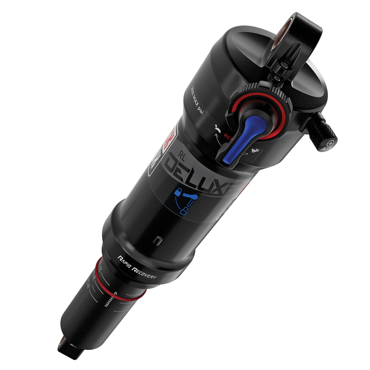

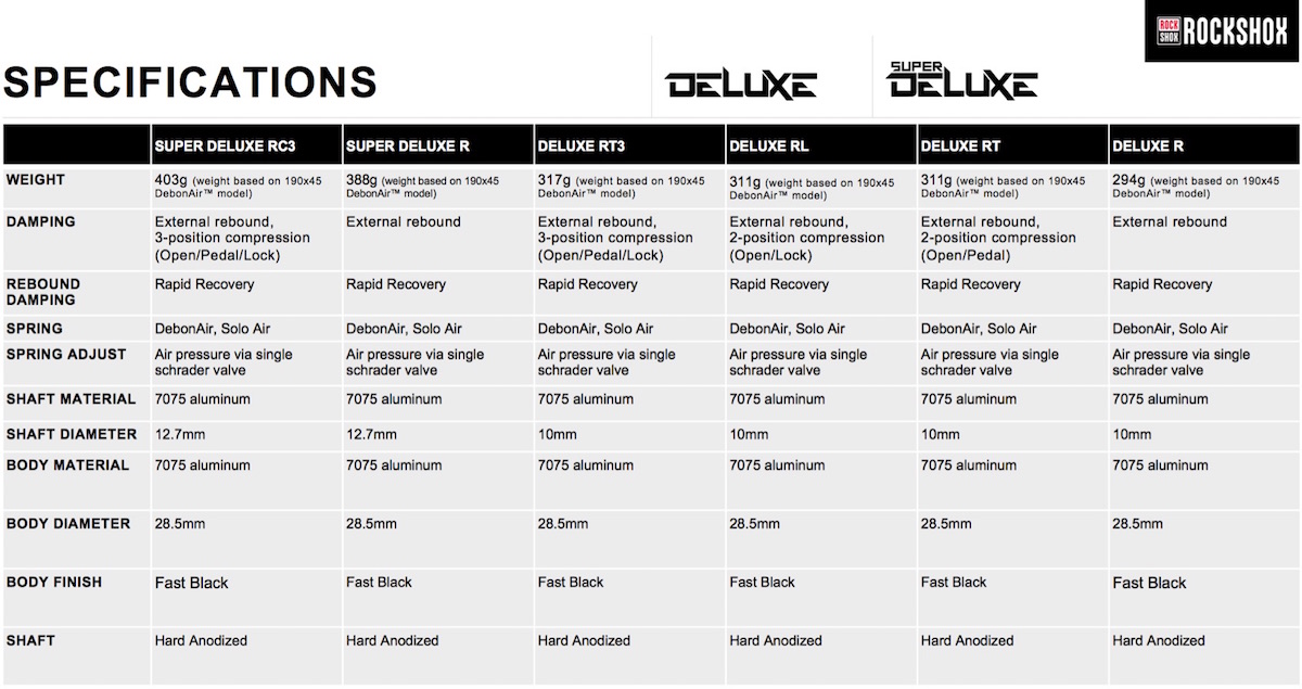

New MY17 RockShox Super Deluxe and Deluxe

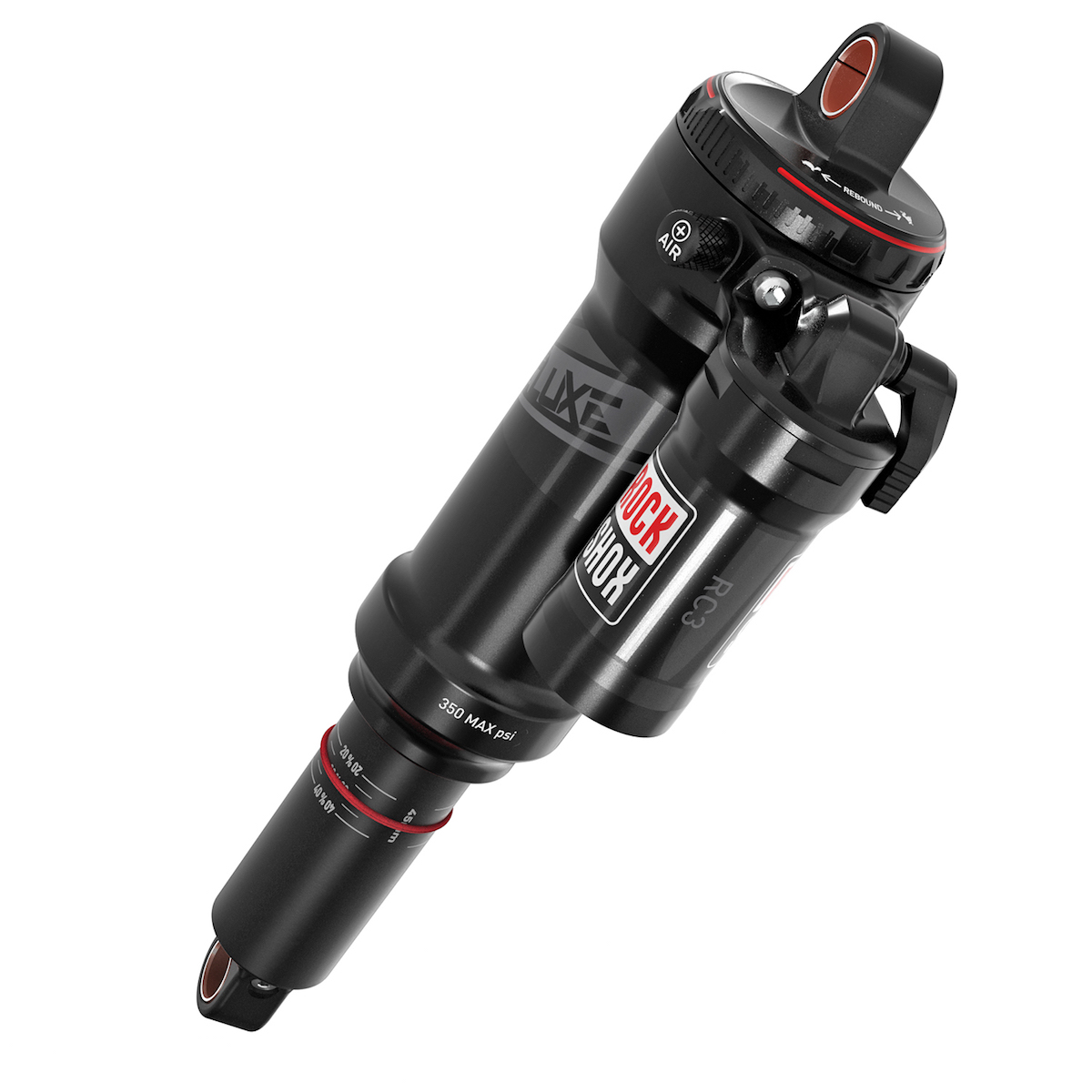

Super Deluxe
The directive was simple. Engineer a shock that does for rear-suspension performance what Pike did for forks. Simple? Don’t bet on it. A gamble? Absolutely. It required a complete change in the way we approach shock design. It meant focusing on performance first and leaving old constraints behind. And it gave us a clear path to develop the world’s lowest-friction shock — Super Deluxe. Metric sizing gives Super Deluxe significantly increased bushing overlap, which, together with a sophisticated new bushing profile, virtually eliminates friction in the shock. A new damper holds the shock high in its stroke and offers unparalleled traction. Unshackled from the old obstacles of shock design, Super Deluxe is free to tackle new ones — on the trail. This changes everything.
ccs-62657-0-62045300-1460034224.jpgRockShox Super Deluxe RC3
ccs-62657-0-13593800-1460034224.jpgRockShox Super Deluxe R
Things to remember:
  • Metric sizing and a sophisticated new bushing design allows this to be the lowest-friction rear shock we have ever made.
  • Super Deluxe has three independently tunable compression settings.
  • Increased bushing overlap allows for better sealing and decreased friction.
  • Mounting options: Trunnion mount, bearing mount, Standard DU.
Features and benefits:
  • Features increased bushing overlap and new bushing design which decreases friction, also increasing on-trail performance and overall durability.
  • New scraper seal technology increases durability, improves performance in colder temperatures and lengthens the intervals between required maintenance.
Technologies:
Solo Air™
Rapid Recovery™ System
Sag Gradients™
Metric Sizing™

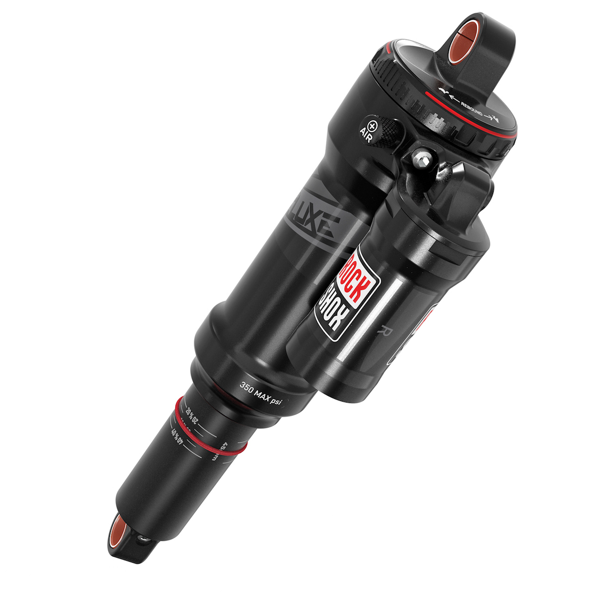

Deluxe
ccs-62657-0-60994500-1460034223.jpgRockShox Deluxe RT3
ccs-62657-0-05140300-1460034223.jpgRockShox Deluxe RT
How do you improve on the success of a rear shock that has received critical acclaim for its stellar performance and supple feel? It’s Simple. You rewrite the rules, throw existing design constraints out the window and focus solely on the best possible performance solution. We took the proven damping performance of our popular Monarch series and introduced it to our new metric-sized chassis. The result is truly Deluxe. With the incredible feel of DebonAir as its standard-bearer and three new mounting options, our new Deluxe is ready to redefine your ride.
Things to remember:
  • Metric sizing.
  • Incorporates proven damping performance of Monarch.
ccs-62657-0-55197800-1460034222.jpgRockShox Deluxe RL
ccs-62657-0-55105000-1460034221.jpgRockShox Deluxe R
  • Increased bushing overlap and sophisticated new bushing design decreases friction, which increases performance and durability.
Technologies:
Solo Air™
Sag Gradients™
Metric Sizing™
