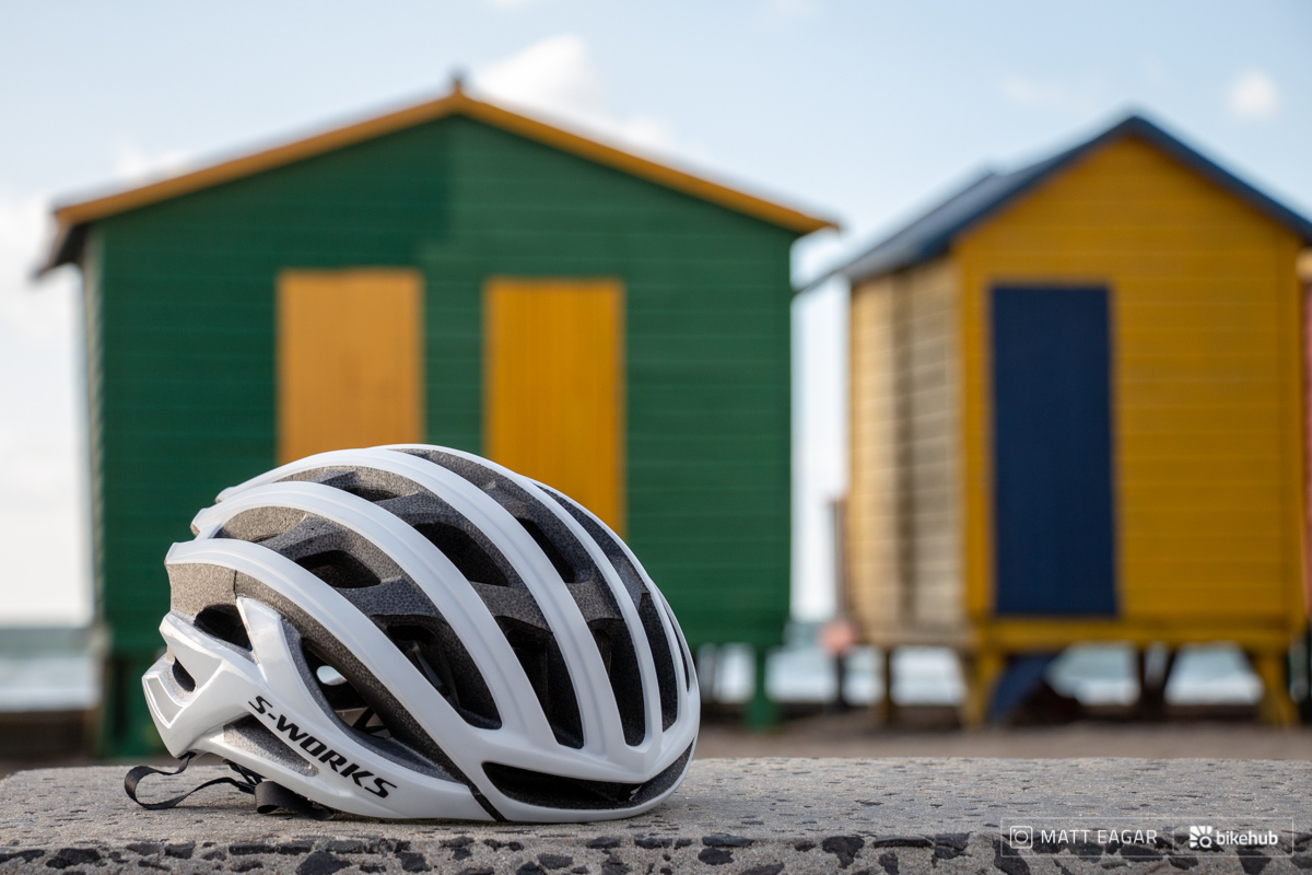

ccs-62657-0-00152400-1543412114.jpg The Specialized S-Works Prevail II sporting the new ANGi sensor and MIPS SL integration.

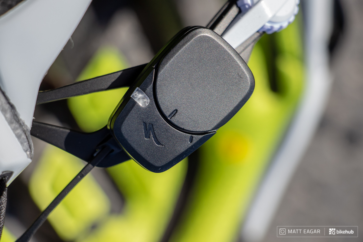

ccs-62657-0-67159100-1543411753.jpgThe ANGi sensor attached to the Mindset retention system on the S-Works Prevail II.

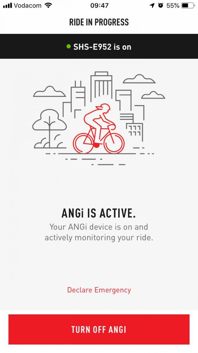

When heading out for a ride, you connect the ANGi sensor to the Ride App on your smartphone and start a ride. If the ANGi sensor detects forces that it associates with a crash, it will notify the Ride App which will start the notification procedure.

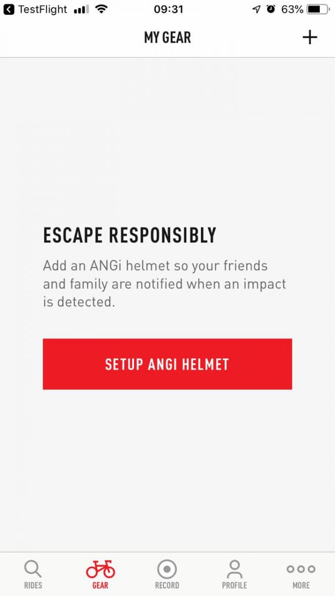

ccs-62657-0-55458700-1543412464.jpegBeginning setup.

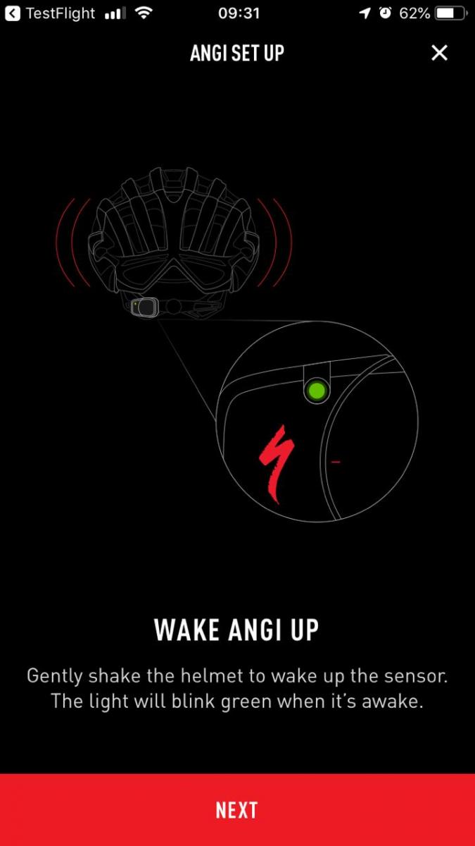

ccs-62657-0-67194900-1543412465.jpegShake to wake.

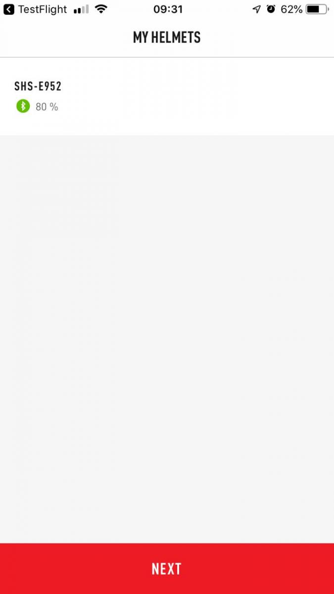

ccs-62657-0-02632400-1543412467.jpegANGi found.

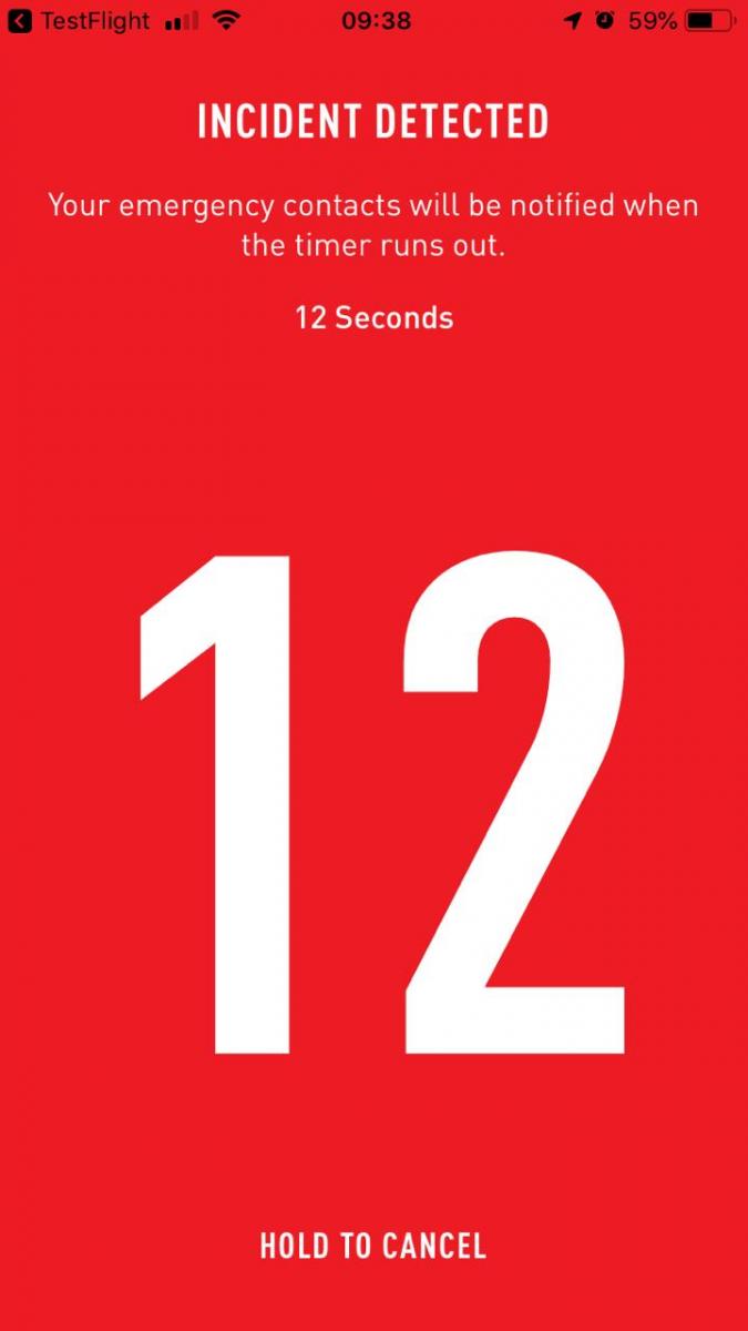

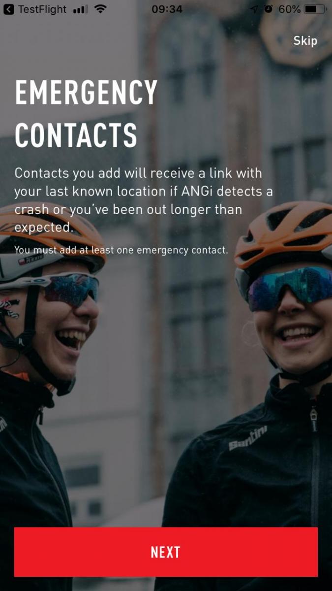

The Ride App will first initiate a countdown which you can cancel should you be alright. If you’re in trouble, however, the countdown will expire and the Ride App will send out an alert to your emergency contacts via text message and email. The warning notifies all your contacts about the potential harm and includes the GPS coordinates (using the GPS functionality of your smartphone) of your position.
ccs-62657-0-08222800-1543412469.jpegReady to roll.
ccs-62657-0-12580600-1543412470.jpegEmergency alert countdown.

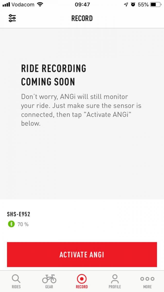

ccs-62657-0-11958600-1543412472.jpegActivity recording coming soon.
When starting a ride, you can also opt to let your contacts know that you are heading out. The notification will include a link to a map where they can track your real-time movement.

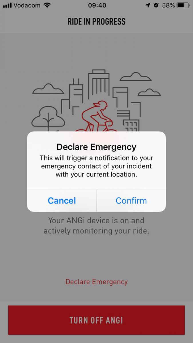

The rider can also send out a distress signal should they be in an emergency that might not have been detected by ANGi using the Ride App on the smartphone.

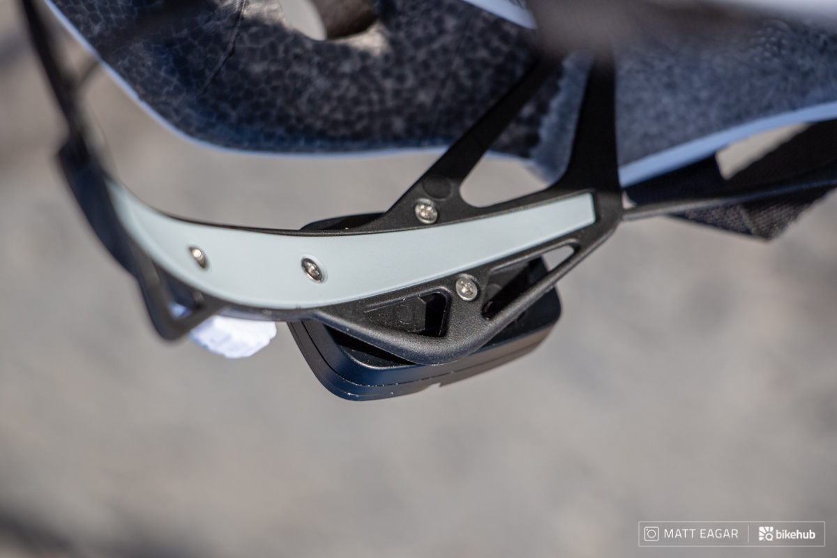

We received an S-Works Prevail II with the ANGi sensor for testing. It is fixed to the Mindset retention system just to the left of the adjustment dial. The sensor is attached with adhesive to a mount that is screwed onto the Mindset system. As you might expect, when wearing the helmet, there’s no indication that the ANGi sensor is attached.
The Ride App version that Specialized provided us with was clearly a pre-release version. It lacked certain functionality like recording the ride data but the core ANGi crash detection and warning system worked a treat. Pairing the ANGi sensor to an iPhone through the Ride App was an intuitive process with no communication problems between the two devices. The sensor requires a gentle shake to wake it up before a ride.

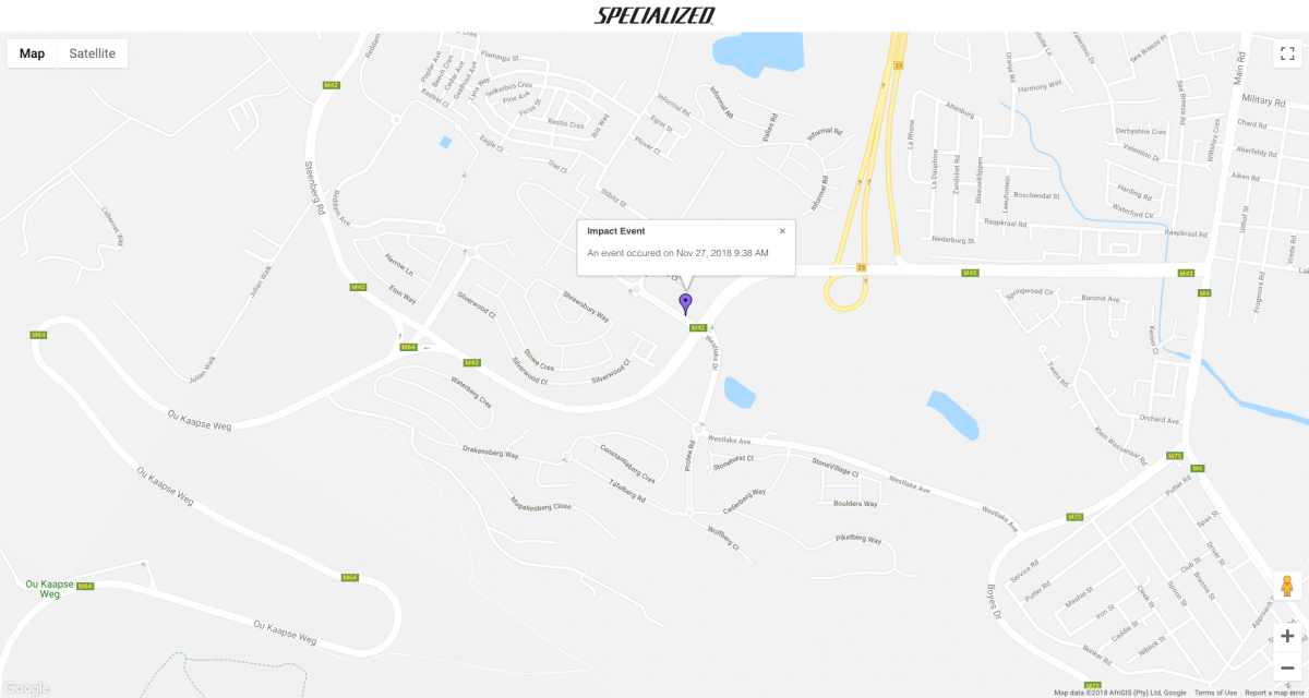

Shaking the helmet around, the ANGi sensor ignored our ‘normal riding forces’ test that we’d expect not to set off the crash alarms. When we ramped up the violence, two of the more vigorous efforts resulted in the Ride App setting off the countdown screen and alarm, followed by sending off notifications of the incidents to our emergency contact. We were satisfied that in the case of both ‘impacts’ having been real crashes, we’d have wanted ANGi to kick into action.
ccs-62657-0-62163600-1543412837.pngThe location of the incident.
ANGi also takes note of the severity of each impact and reported them to the emergency contact differently. It distinguished the more forceful test as an Impact Event while the milder collision was labelled as a Potential Crash.
During the pre-launch testing, the SMS reporting appeared to not be operational. Instead, we received the warnings via email. From the time the countdown alarm expired, it took around 40 seconds for us to receive the email notification.

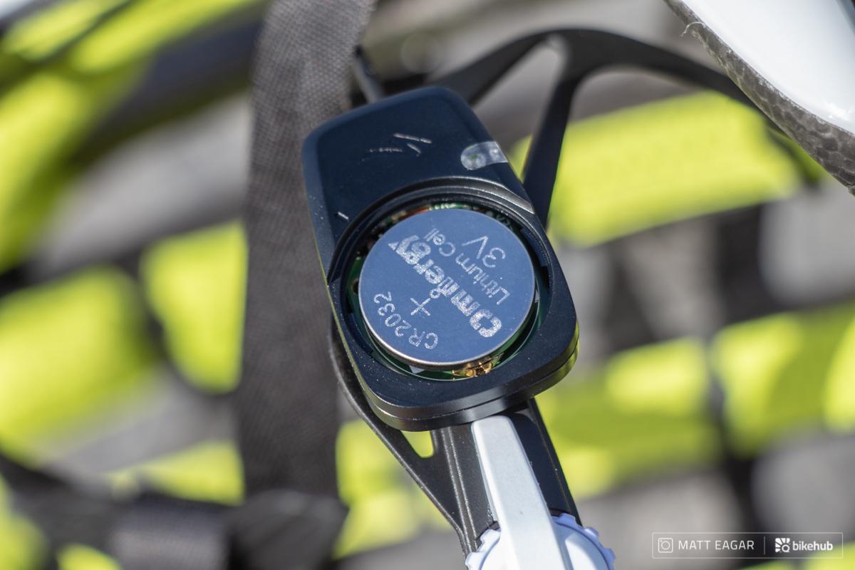

ANGI Technical specifications
Connectivity: Bluetooth
Battery: CR2032
Battery life: Six months
Waterproof: IPx7 (30 minutes at 1 meter)

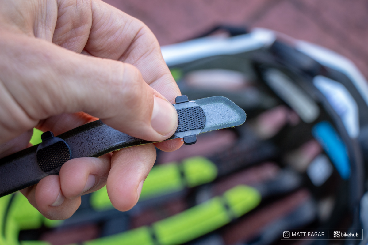

Specialized introduces MIPS SL
In addition to announcing ANGi, Specialized has committed to adding a MIPS option to all its helmets with certain models receiving the exclusive MIPS SL, created in partnership with MIPS researchers.

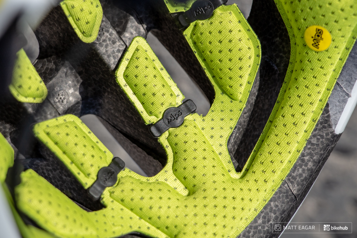

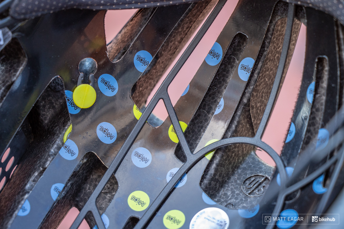

A brief MIPS refresher. While foam is good at absorbing direct linear impacts, it fails to protect against rotational forces created when a helmet strikes objects at an angle. MIPS is designed to allow movement of the helmet to reduce the twisting forces in these angled collisions.

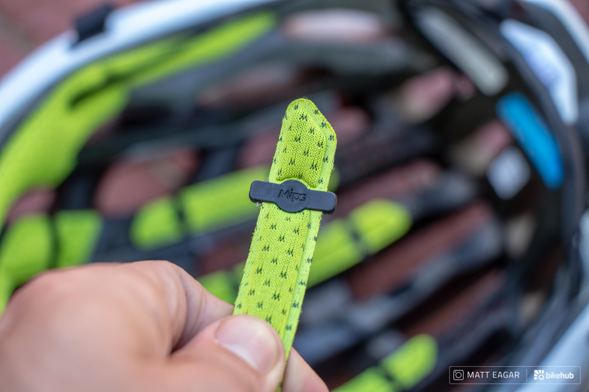

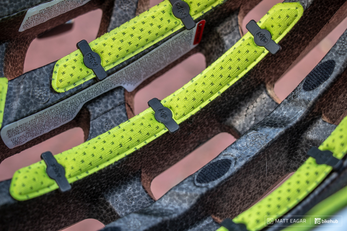

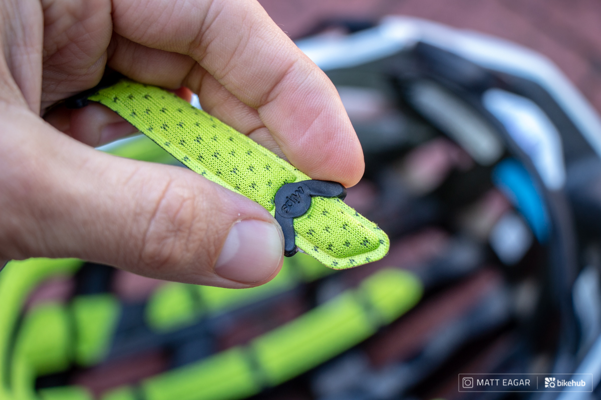

In most applications of MIPS, the system is applied independently between the foam shell and the padding. MIPS SL is different in that it combines the MIPS technology and the helmet padding into a single piece. This more compact system offers weight savings, a more comfortable fit, and better airflow for cooling and ventilation.
This minimalist application of MIPS is claimed to offer between 10 and 15 millimetres of rotational movement in every direction and the same level of brain protection that other versions of MIPS offer.
The MIPS SL technology will debut on the following Specialized helmets: Ambush, S-Works TT, S-Works Evade II, and S-Works Prevail II.

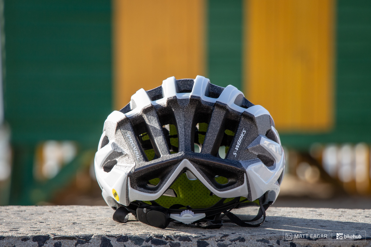

ccs-62657-0-12020600-1543413066.jpgSpecailized S-Works Prevail II with MIPS SL.
ccs-62657-0-82137400-1543413067.jpgGiro Synthe with MIPS.
Our test S-Works Prevail II with ANGi is fitted with the MIPS SL system. We are impressed with how clean the application of MIPS appears compared to other helmets, as it blends in seamlessly with the padding.
