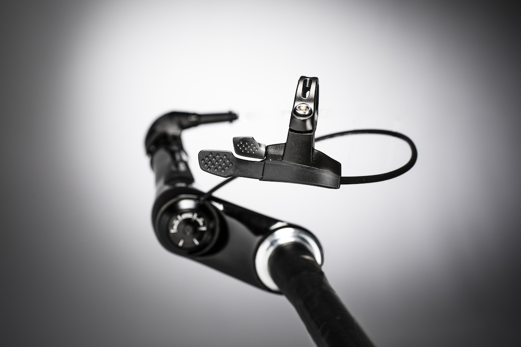

  • The previous hydraulic dual fork and shock lockout is replaced with a simpler cable operated system.

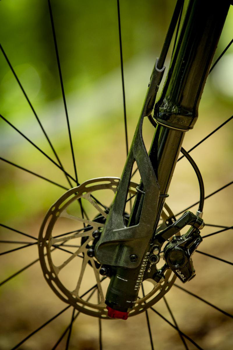

  • There is also a convenient new brake release mechanism that requires a single turn of a hex key and a push of a button to release the front wheel.

  • Simple, reliable cable remote lever engages lockout on the fork or fork and rear shock.

Cable Lockout

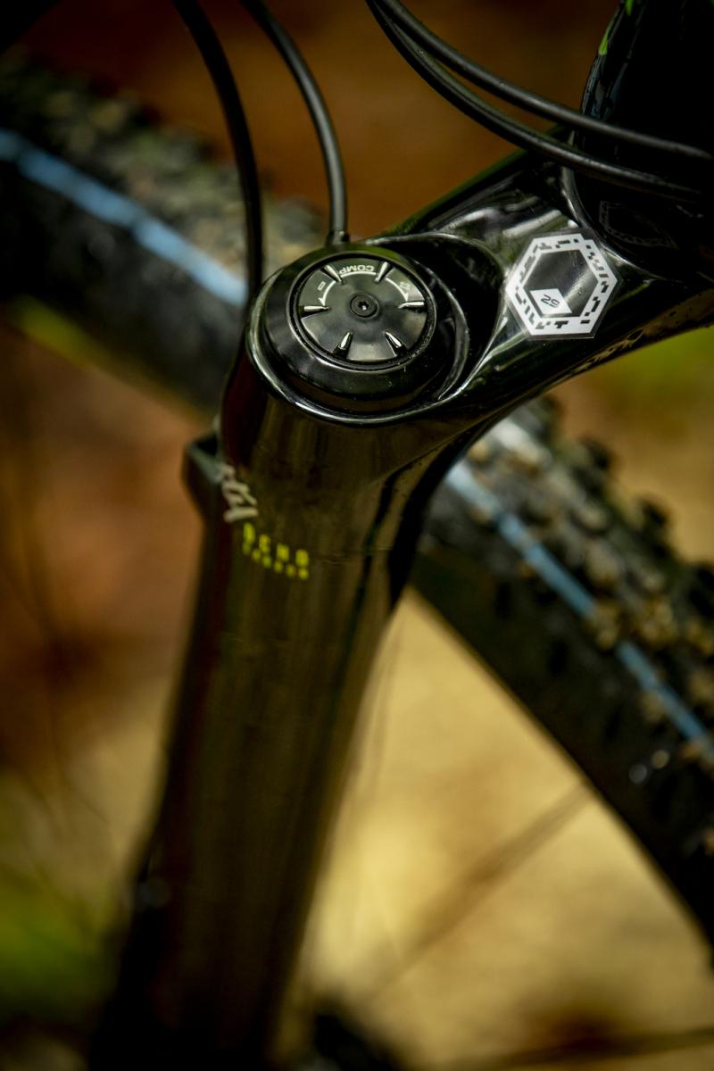

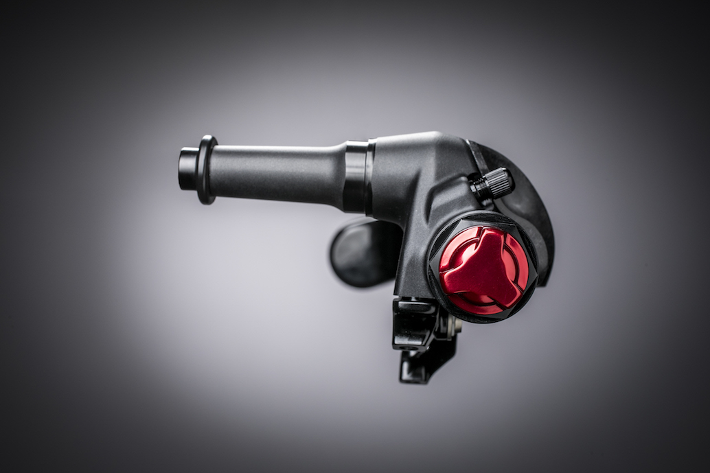

Chamber Damper
All-new self-bleeding, heat compensating, high flow damper, with external compression and rebound adjust. Smooth, supple, spike-free damping in all conditions.

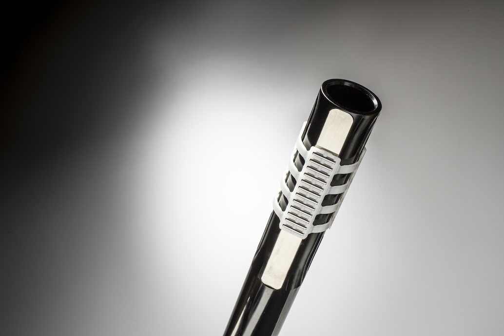

Triangle- in-Triangle
Ocho’s three-sided needle-bearing interface keeps the inner leg from rotating within the outer leg, for uncanny steering precision.
Delta Cage Needle Bearings
Don’t bind. Roll smoother than ever with the new Delta Cage version of Cannondale’s legendary needle-bearing telescope assembly.
Stop Lock Brake Mount
Self-aligning brake mount removes with just one turn of a 5mm hex and the press of a button. Quicker, simpler wheel removal.
