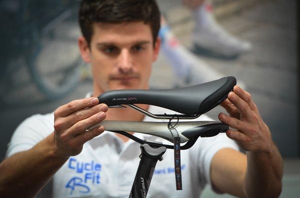

Saddle discomfort
The most common cause of saddle discomfort is a poor saddle. Some saddles are too hard and some are too soft. A saddle that is too thick and soft will make you sink down from the weight of your sit bones and cause the middle of the saddle to push up and place more pressure on your soft tissue.
A firmer saddle is usually better, especially for longer rides. A proper woman’s saddle should have good padding for the sit bones and a cutout or groove in front to provide relief from pressure on the perineum and to improve blood flow. It’s important for the cutout or groove to extend far enough forward to remove. A women-specific saddle is essential for most women.

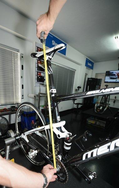

Saddle height
A saddle that is too high will take your weight off the pedals and place more weight on the saddle. It will also cause your hips to rock, causing side-to-side movement and chafing. The perfect saddle height is measured using specific tools. We set the right and left leg at 150 degrees.
