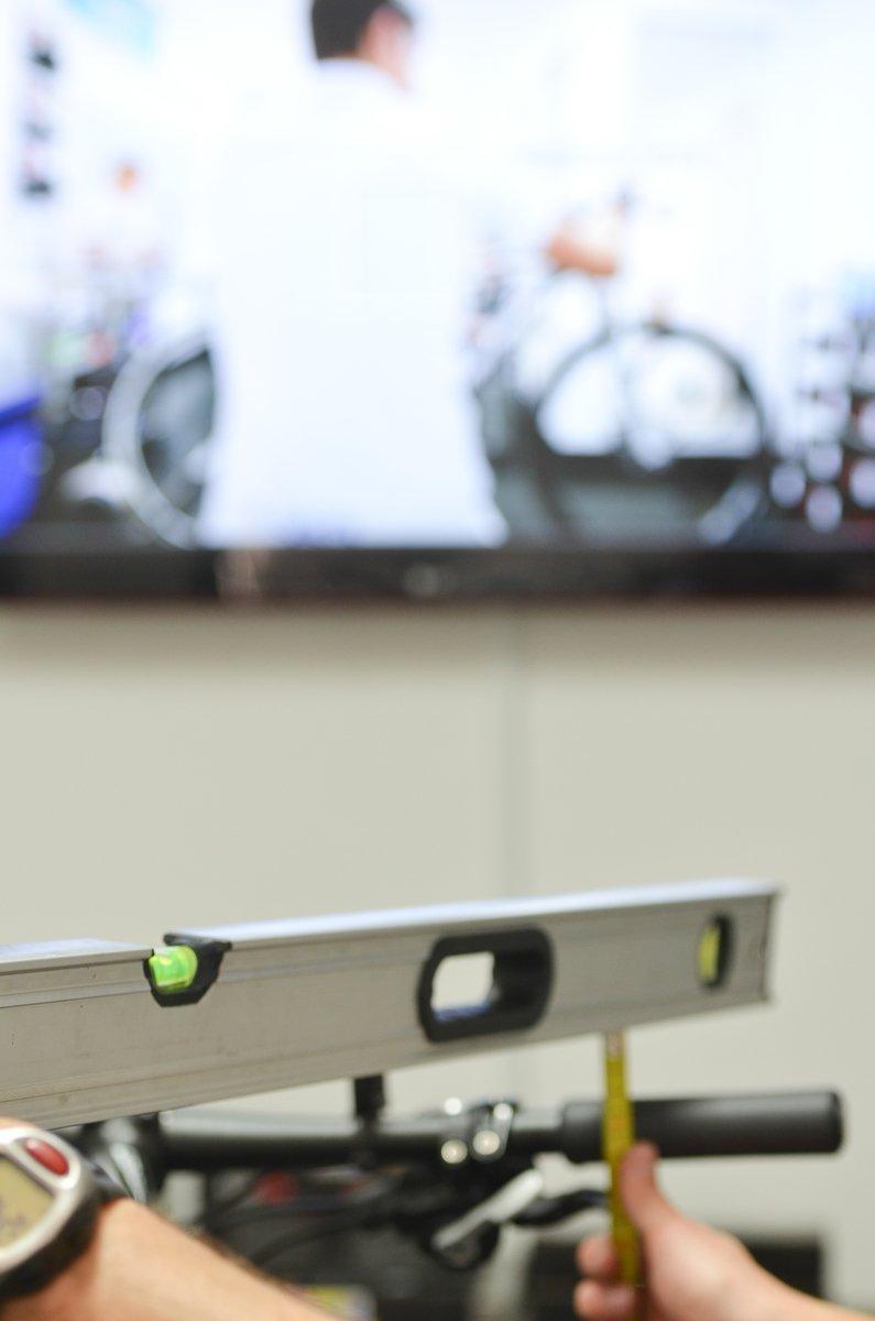

Know all the angles – Stem length and angle
Body position will go hand in hand with stem length and angle. Therefore you will be looking for the correct stem length once you have selected the handlebar suited to your riding style and comfort. To be sure you are using the correct stem length the general rule of thumb that can be used to determine this is to ensure the angle between the torso and the outstretched arm holding onto the handlebars should be 90 degrees. If the rider is too stretched for reach over the 90 degree angle then the stem will have to be shortened until the 90 degree angle is achieved.
ccs-41808-0-56967900-1400752792.jpgImage credit: Zoon Cronje
Now when selecting which stem length is optimal, the stem angle should also be considered as the stem angle will have a direct influence on handlebar height; it is for this reason that many stem manufacturers have started introducing negative degree angle stems from -17degree, -20degree and -30degree. For most, this may seem like an extreme and unnecessary adjustment, however, a more aggressive stem and handlebar position can drastically improve handling and control. Another factor which is affected, which might not be immediately apparent, is the bike stack height. In simple terms, stack height is the distance between the handlebars and the top of the bike tyre. If the stack height is bigger and there is more space between the tyre and handle bar, then there will be an increased amount of flex between the fork and headset of the frame. Increased flex will cause the bike to feel less responsive and direct when negotiating loose rocky sections, and may cause the bike to feel very flimsy when performing out the saddle efforts.
