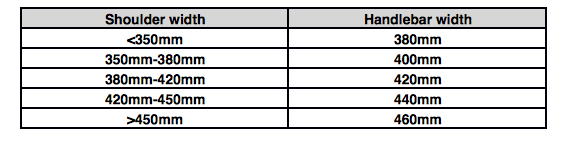

Assuming you’ve read the previous article on handlebar width, and you have had your shoulder width measured from outer to outer, using the bony intrusion as a point of reference, you can now determine the correct bar width. Let’s take a moment to discuss road handlebar width, and translate the measurements.
ccs-41808-0-77207600-1399893592.pngThe above measurements are measured from centre to centre of the handlebar.

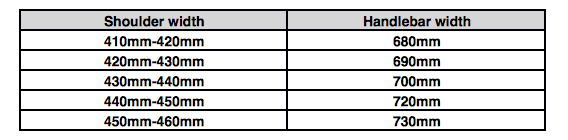

Using the same shoulder width measurement mentioned earlier in the article, you may use the following translation into handlebar width as a basic guide to what width would work best for you for mountain biking.
Any person with a shoulder width lower than 410mm should consider the narrower option of a 660mm handle bar, this is the lowest recommended width on 29 inch mountain bikes; it is a common width used for woman cyclists, as a shoulder width broader than 410mm in woman is fairly uncommon. A bar width of less than 660mm is not advisable as this will result in you losing the leverage and control necessary to steer the bigger 29 inch wheel.
