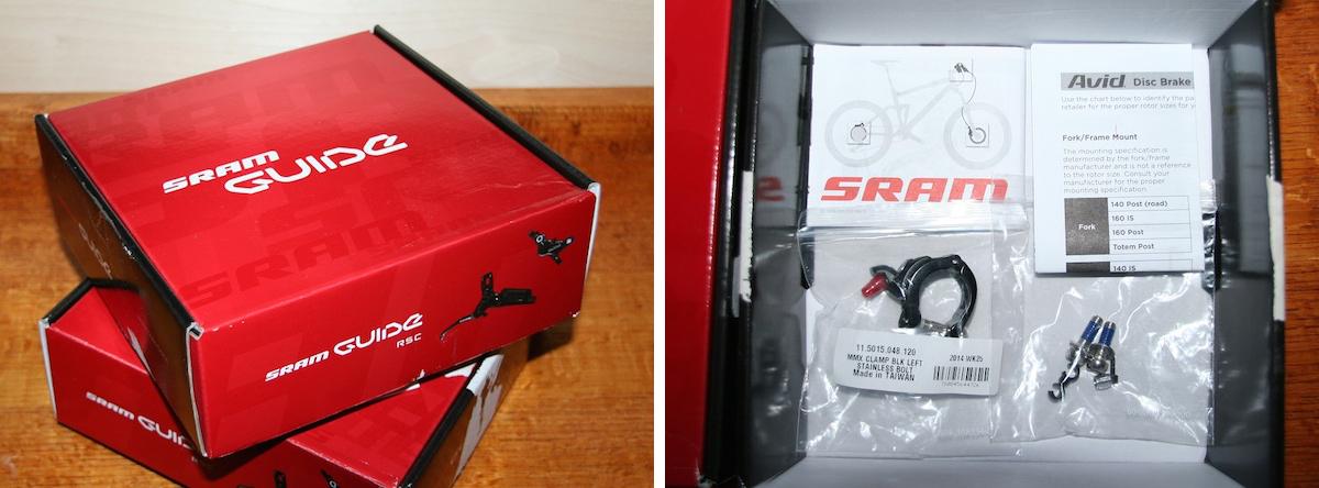

Packaging:
The box is all SRAM. Gone is white and yellow Avid branded boxes. It’s been replaced with red and white, and SRAM branded
detailing. The contents include left or right caliper and lever, MMX clamp,instruction manual, and some bits and bobs. The
calipers ship with organic pads pre-installed.
One major noteworthy departure from previous models, is the omission of brake rotors. The new SRAM centerline brake rotors are a completely separate purchase. Unless you don’t already own brakes, it wont be a problem as the calipers are compatible with HS1 and HSX rotors shipped with the more recent models of Avid Elixir brakes.

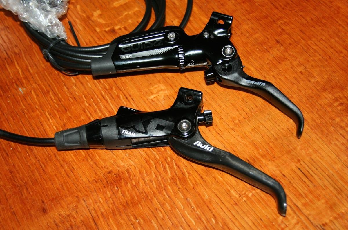

Comparison: XO Trail vs Guide RSC lever
The XO Trail lever versus the Guide RSC lever.
Contact point and reach adjustment dials have moved. Lever itself is slightly shorter but the hinge point has been extended. The overall length remains the same. The lever itself is aluminium compared with the carbon lever of the XO Trails, and has subtle changes to its design. But it remains comfortable and well matched for single finger braking.

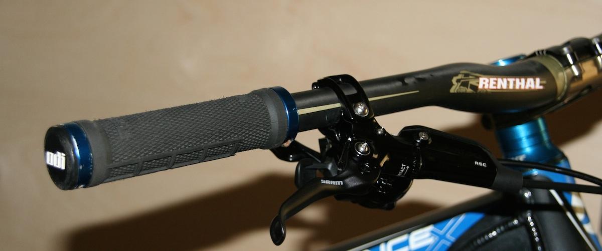

Installation:
Installation is pretty straightforward, along with setup. The front brake hose length is pretty substantial. In my haste to test the brakes, I left the hose uncut, but it will need to be trimmed down as it’s flapping in the breeze.
I like running my levers close to the bars, so some adjustment was required. The little reach adjust thumbscrew was stuck, seemingly screwed in all the way and jammed in that position. I had to use a pliers to get it to turn back out again. I checked the dial on the other lever, but it didn’t exhibit the same problem. So it seems it’s just an isolated and minor issue, not a generic factory fault.

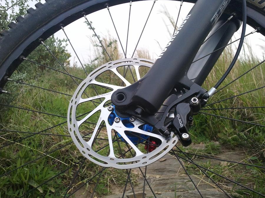

SRAM Guide silver caliper and Centerline rotor.
As mentioned previously, the Centerline rotors are a separate purchase, and those arrived after I had completed the first round of testing. For the second round of testing which included steeper terrain, I installed both guide brakes for front and rear brake duty, as well the new Centerline rotors. I still used the old worn sintered metal pads removed from the XO Trails brakes. Using worn-down pads was not only useful for playing around with contact point adjustment, but also to check if the Guides displayed any noticeable variability in braking performance. Or that’s the hope anyway.
Suffice to say, they are phenomenal! In fact, the word I’d really like to use is LETHAL. In capitals. On a highly subjective level, they probably offer the same braking force as previous Avids, notably the Code and XO Trail brakes. but the major difference is When.
That same power is on tap so much earlier, I’ve locked up where previously I would have expected some modulation. I don’t think you can use the phrase bottomless with respect to brakes, but that’s how early really powerful braking comes into action, that you still have plenty of lever travel left before crushing your other fingers or hitting the bar. Remember, these are worn brakes.
Is it grabby? Not at all, as there’s plenty of modulation capacity available, its just a case of having to adapt to the new behaviour. Important to note: how ‘grabby’ depends on the pads used, with resin or organic pads definitely offering more bite than sintered metal pads.
