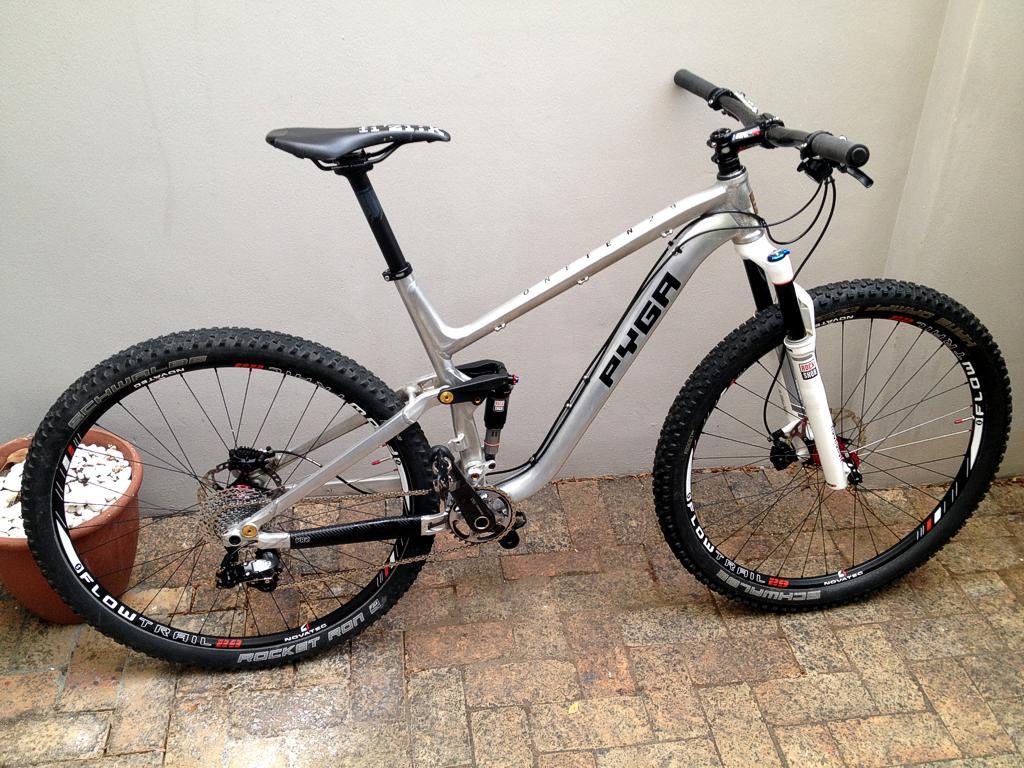

I’d cobbled together everything needed to build the OneTen29 in the two weeks leading up to the Argus, which forced me to spend a few nights tinkering myself, seeing as the friendly local mechanic was fully booked with servicing road bikes. This gave me an excellent opportunity to get up close and personal with the frame, and to completely take it apart and inspect every little gusset, weld, bolt, bushing, bolt and bearing.

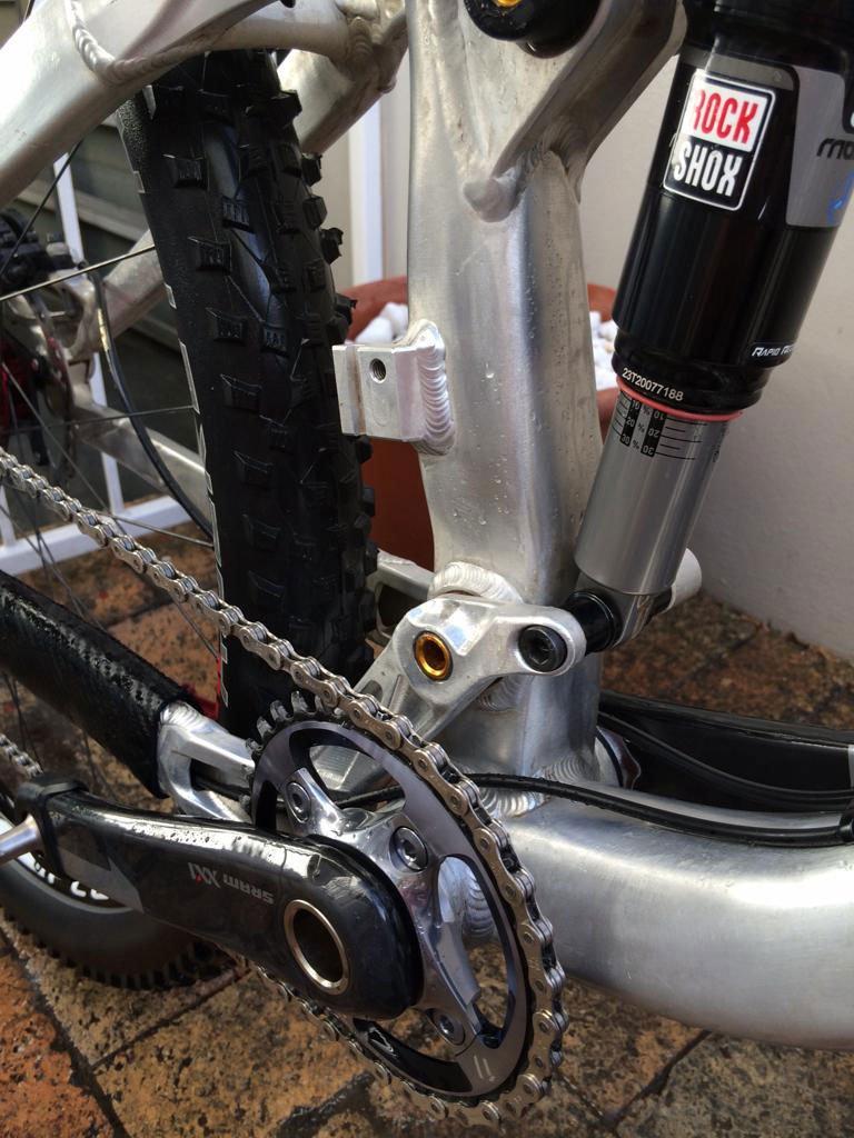

The PYGA is an exceptionally well bolted together piece of kit. The pivot design has clearly been carefully considered and lends itself to easy servicing and very little chance of anything loosening over months of riding, not something which can be said of many other bikes I’ve owned. In fact, the only bolts which have loosened at all have been the shock eyelets. Nothing a bit of Loctite can’t resolve, and certainly not PYGA’s fault. The X12 rear axle is a surprisingly simple system to use, counter-intuitively much less hassle than a traditional QR setup. It provides a real sense of security and compliments the generally solid and stiff nature of the frame. It means business, something which can be immediately felt when picking it up. Yes, it’s slightly portly, but not excessively so. I think the most apt word would be “robust”.
The bulging seat tube and pivot setup takes no prisoners
My build spec can probably be best classified under a “trail” heading, with a few weight weenie parts (XX1 cranks, Truvativ Noir T40 bar) but mostly efficient (120mm Revelation RCT3 with 2014 upper assembly, Novatec Flowtrail 29 wheelset, X0/X9 short cage shifting, Rocket Ron rear & Hans Dampf front tyre combo, XT trail pedals). All in all, the build compliments the bike’s best attributes well, with enough weight saving to prevent bulge, but enough strength to encourage properly fast riding.

Important to keep it all stiction free, even the slightest bit seems to harm the ride more than my previous ride (probably because one is so much more aware of what is possible, she is the sweetest thing when tuned, soaks up everything that should be soaked up, leaves you to handle the rest).

I've found the only stiction to be at the shock eyelets. Seeing as they're (as on almost all bikes) not bearing-mounted, they don't pivot perfectly smoothly unless they're only partially tightened. Not fully tightening them of course means that they very quickly rattle loose. Not an ideal setup. I'm going to experiment with Loctite, but I don't know if it will hold things in place solidly enough in a partially tightened state...
Just read this bit now, using nylon washers and a nylock nut might help. Would need to replace the nuts as the nylock does wear out if they're installed/removed repeatedly.
Worth a try as it's a cheap fix if it works.
