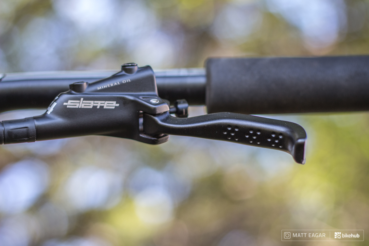

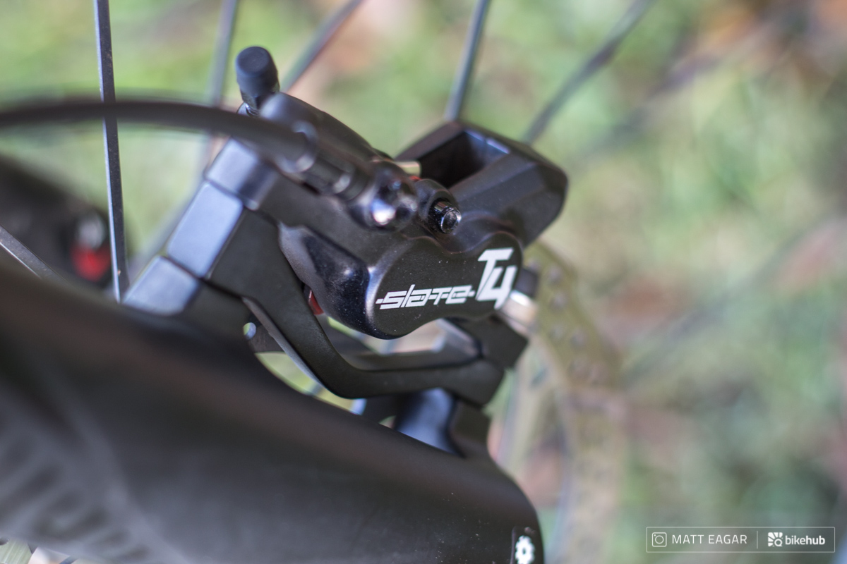

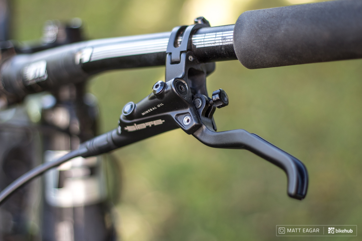

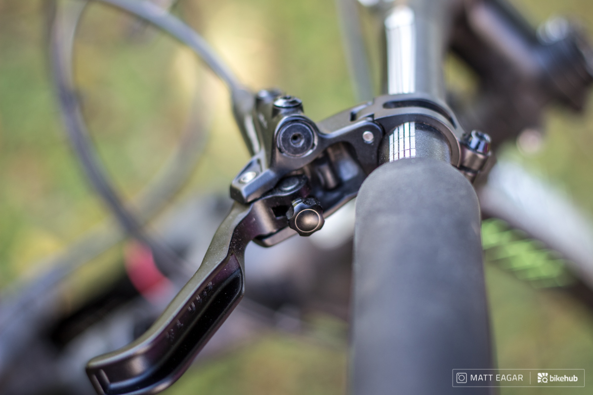

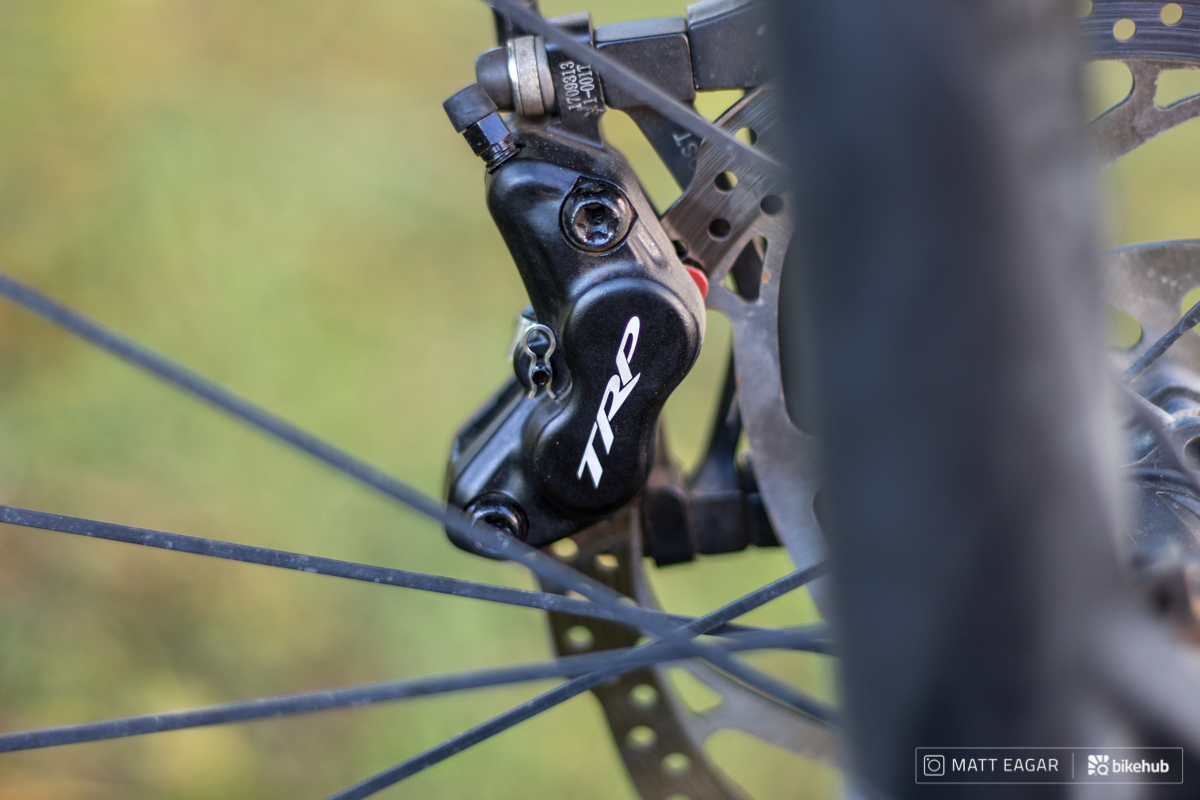

The TRP Slate T4, with a 4-piston caliper, is aimed at cross-country, trail, and enduro type riding. The brake set is constructed from cast aluminium with a sleek black finish. The brakes lack the polished look of its competitors but on the bike, they tend not to detract from the overall look. The lever reach can be adjusted tool-free using the dial found at the base of the lever. The brake lever clamp supports I-Spec mounting system for tidy integration with Shimano shifters.

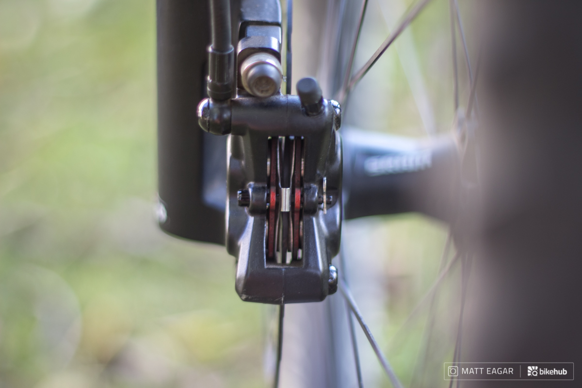

The Slate T4 arrives with semi-metallic pads fitted and is also compatible with full metallic pads. The caliper can support finned pads for additional cooling. The pads are replaced from the top side of the caliper for easier access.

The Slate T4 uses mineral oil which TRP say is more environmentally friendly and improves performance as it less likely to absorb water than DOT based oils. The brakes arrive fully bled with a generous length of hose that was a good fit for my extra large bike but smaller frames may need to trim the hoses for a neat look. The hoses connect to the caliper via a banjo fitting to accommodate the various angles that frame manufacturers route the hoses.

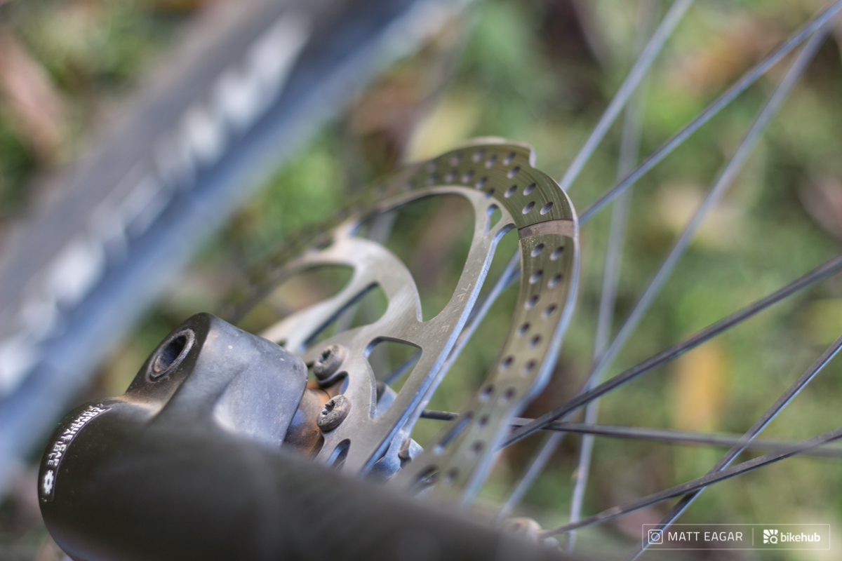

Our test brakes arrived with a set of TRP rotors (usually not included with the brake set). A 180 mm and 160 mm combination. While TRP does say that the Slate brakes work best with their own rotors, they are compatible with other rotors.

The Slate brakes borrow from the input from Aaron Gwin using the lever he designed for the beefier Quadiem brakes. The lever feels bulky at first, especially compared the slim Guide lever it replaced on my bike, but it fitted well in my fingers. I found myself locking my finger into the bend of the kinked tip on rougher trails, where they felt comfortable and confidently secure.

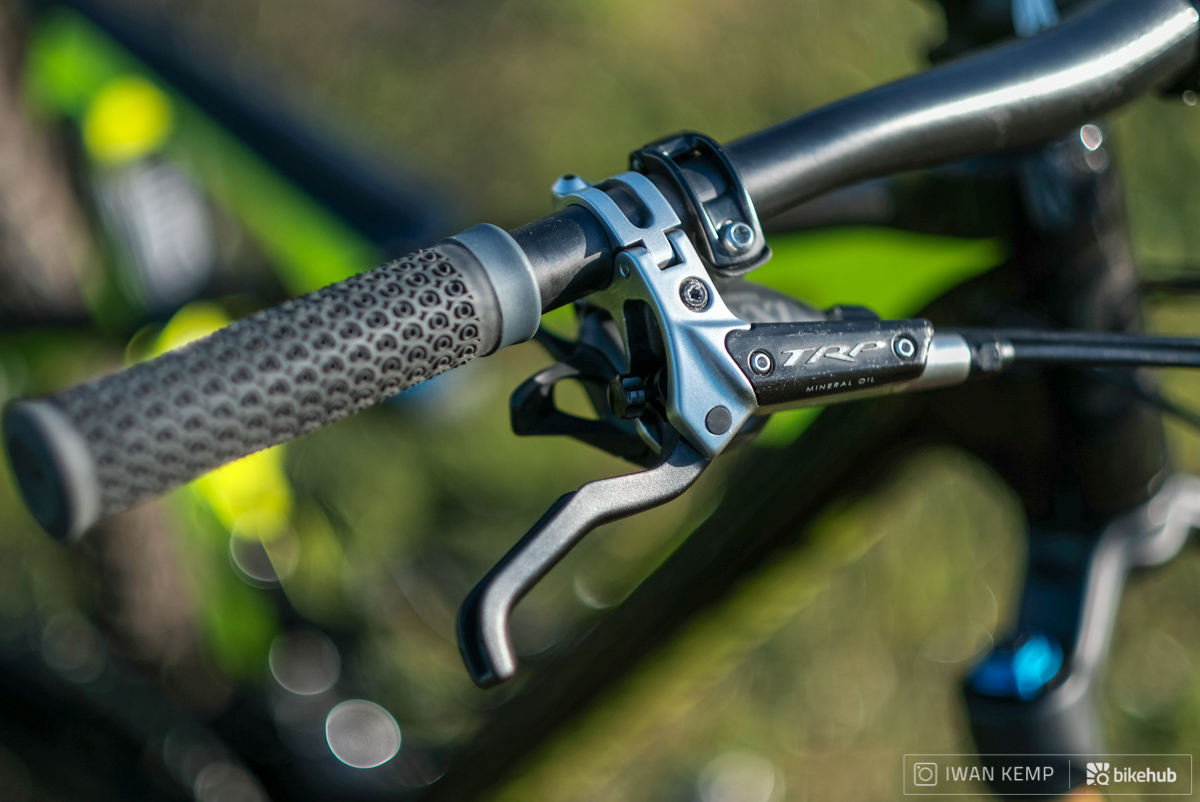

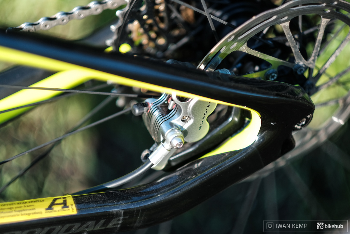

The Quadiem brakeset is TRP’s gravity offering which was developed with direct input from Aaron Gwin. It’s a four-piston design with a finned caliper for cooling with a similar dimpled lever as the Slate 4 and I-Spec compatibility. The Quadiem brakes retail for around R3,500.
We did not ride the Quadiem brakes for as long as the Slate T4 brakes. Here is Iwan Kemp’s impression after a few weeks of riding the Quadiem brakeset:
I spent a couple of weeks riding the Quadiem brakes on a trail bike. On the first couple of rides, the lever feel was spongy and it took some proper force to get these to bite and slow the bike down. After a handful of rides, they began to bed in well and from then on the performance was on par with what one would expect from a four-piston brake.
There were no signs of excessive heat build-up that hampered performance and the overall feel stayed controlled and consistent. The shape of the levers was spot on for me and allowed one or two finger braking
