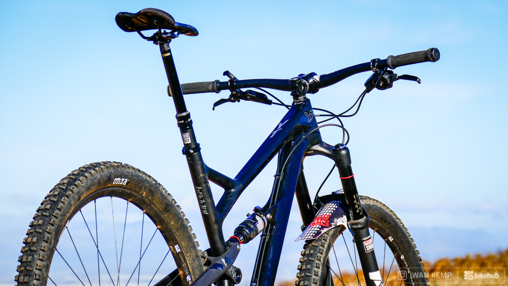

For those who are not familiar with the Jeffsy 29, it is a 140mm trail bike designed around 29-inch wheels with adjustable geometry using a flip chip that changes the bottom bracket height, head angle, and seat tube angle.

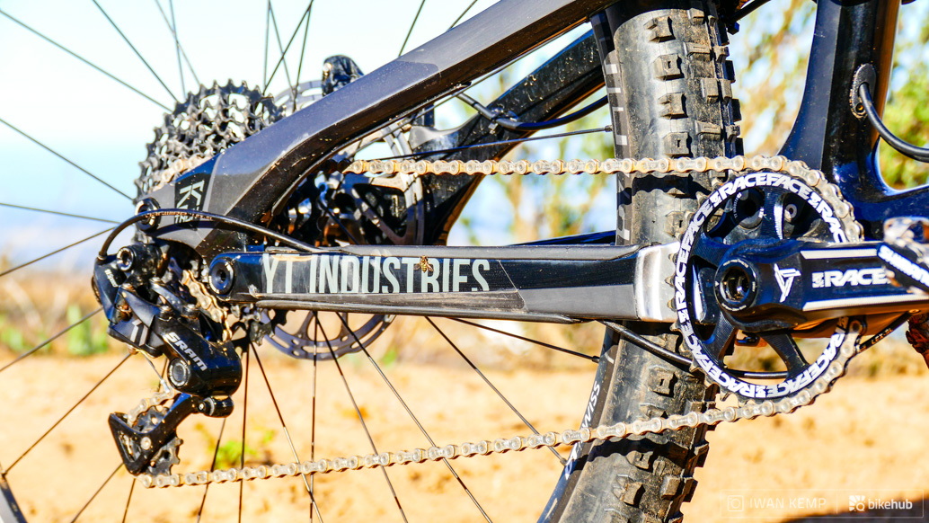

Cable routing is mostly external apart from the house for the dropper that enters the seat tube just above the bottom bracket junction and the rear derailleur cable which runs internally. Fortunately, the other cables run neatly on the top of the down tube with guides doing a good job of keeping them in place and minimising excessive rub.
As with their Capra and Tues, the Jeffsy makes use of a Virtual 4 Link suspension system.

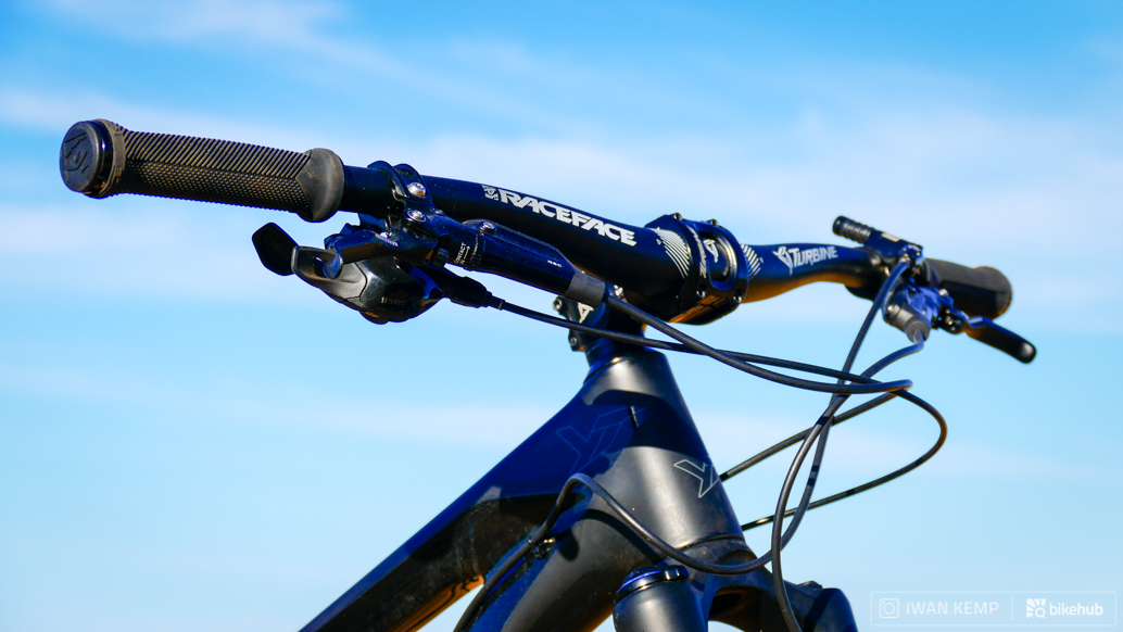

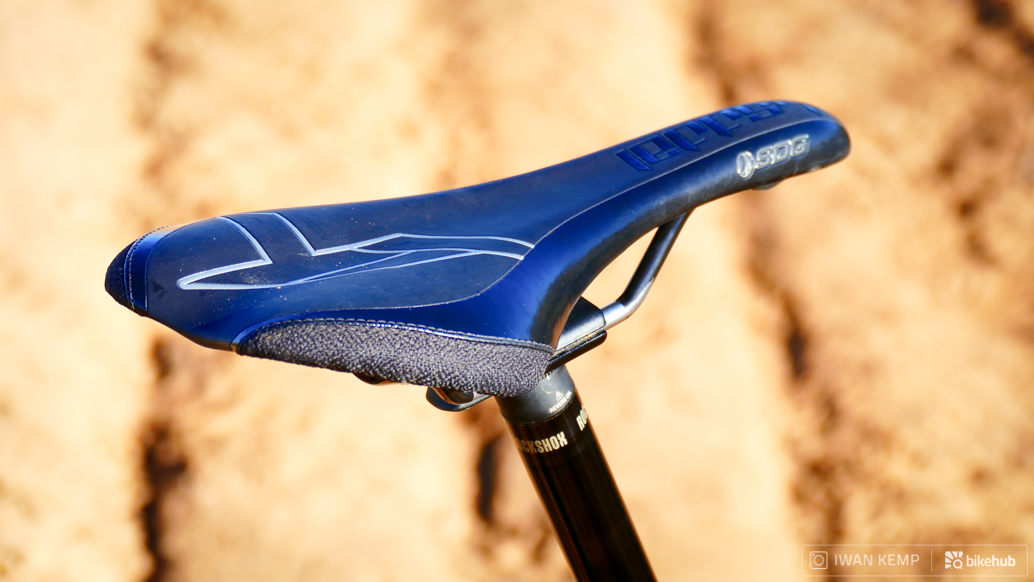

Such is the nature of the specification that, other than the saddle (which is a personal choice), the only thing I’m looking to change is the dropper post lever. To date, I have always run a right-hand lever on the left in order for it to sit below the bar. This makes pushing it easier as it requires less movement of the wrist. I will most likely replace it with RockShox’s 1 x remote lever sooner rather than later.

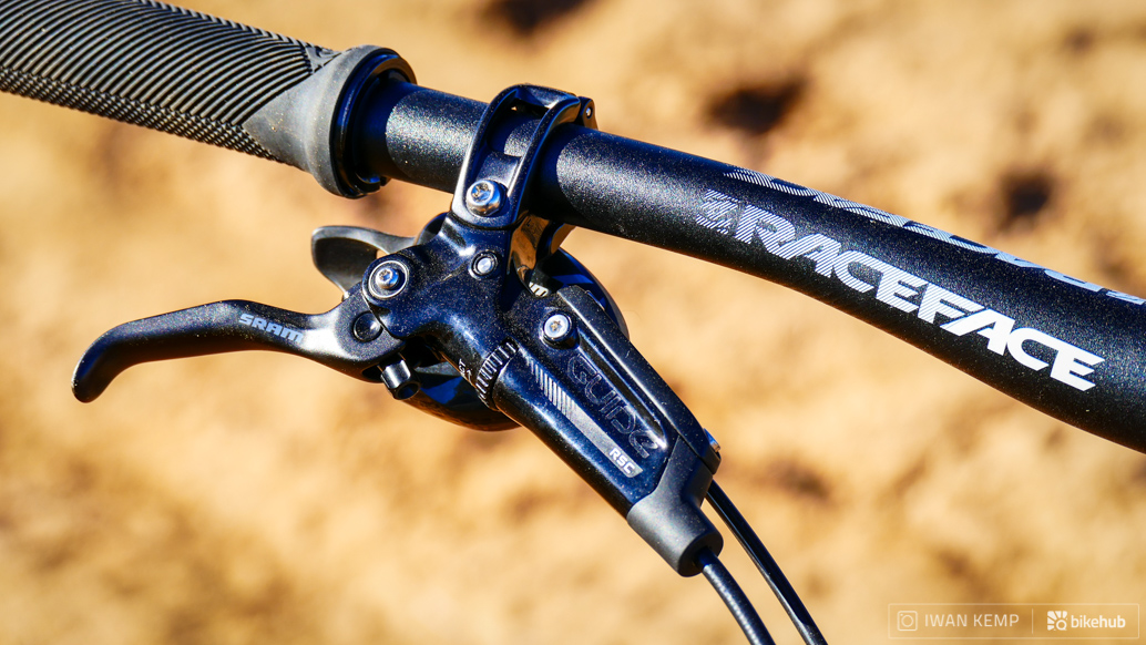

The only component niggle to date was the Guide RSC brakes that suffered the same fate as the ones on Nick’s Transition Smuggler and had to be warrantied. Thankfully turn around time was quick and they have been perfect since then.
