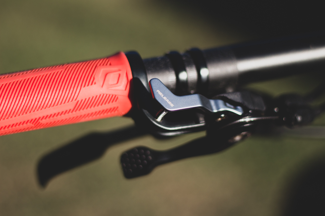

The system works by connecting the shock, fork, and ultimately the frame via a handlebar remote. With the remote, the user has the ability to choose from three ride modes, Descend, Traction Control and Lockout. Let’s explain each of these modes independently.

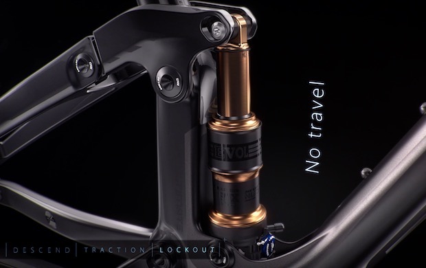

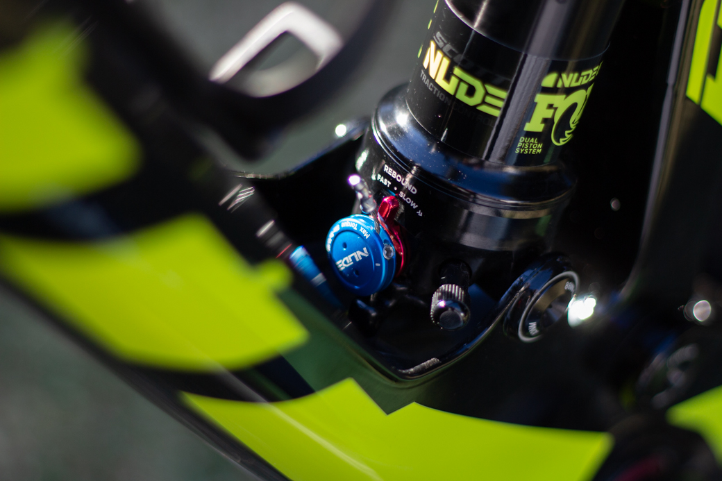

Our Proprietary FOX Nude shock features two positive air chambers. In Descend mode, both chambers are open, essentially creating one large volume chamber. This gives you the full amount of available rear wheel travel. Both fork and shock are fully optimized for downhill performance with regards to both air spring rate and damping.
2. Traction Control
As mentioned, when you go from the fully open, descend mode into Traction Control mode, one air chamber is closed off, reducing the effective travel of the rear shock. This necessitates two changes- increasing damping and increasing the progressivity of the spring curve. Making one change without the other drastically reduces performance. The TwinLoc suspension system is the only system that can simultaneously change both spring curve and damping, leading to a ride that isn’t harsh off the top and still provides incredible traction.
3. Lockout
Lockout mode gives you the firmest of the three suspension settings for when total efficiency counts. Be that up a fire road or on your way to the trailhead, front and rear lockout makes sure that you’re saving all of your energy for the trail.

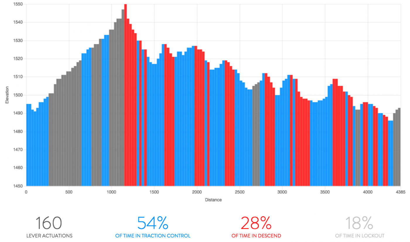

World Champion Nino Schurter has used the TwinLoc Suspension System for many years now, claiming multiple World Championships, World Cup Overalls, and individual World Cups among numerous other titles. Below you’ll find some statistics from a World Cup Cross Country lap in Lenzerheide showing just how often Nino is switching between modes in relation to the type of terrain he is using. Spending a majority of his time in Traction Control mode, Nino switches to Descend mode often, gaining time on his competitors with every meter. When the climbs smoothen out, or when there is an option to really put the hammer down, Nino opts for the Lockout mode guaranteeing efficiency in power transfer.

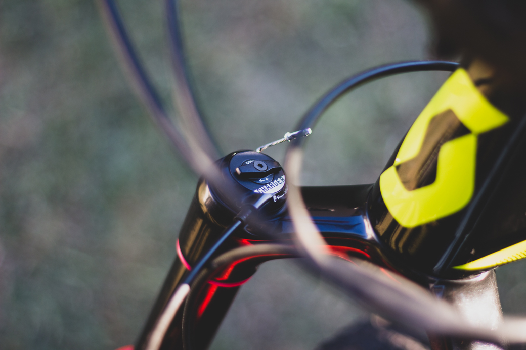

No. The Fork is a standard Fox Fork with a custom-tuned 3 position damper. We use the fork as part of the system to make sure that we maintain balance during each mode, which we feel is important to the quality of the ride!
