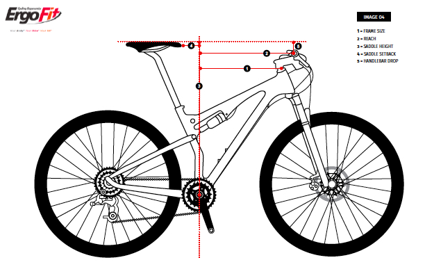

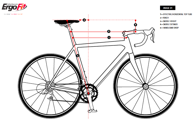

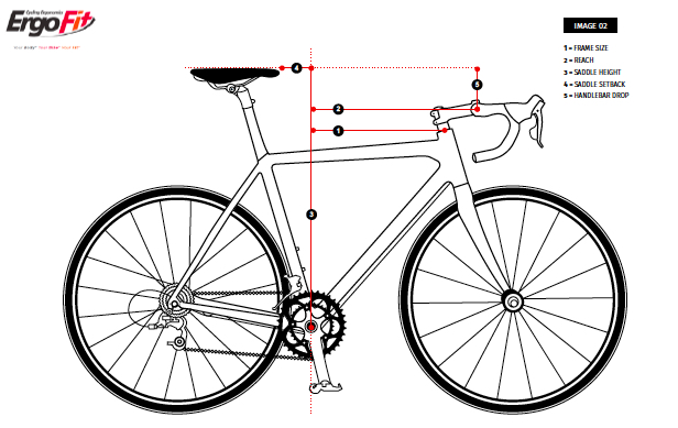

It is also very important to measure the bike parameters accurately. Many bike fittings are performed without objective measurements. Performing objective measurements requires a universal reference point. The simplest reference point is the crank axle or bottom bracket. All measurements should therefore refer to their position relative to the crank axle. An example of a measurement which is not objective is measuring the distance from the tip of the saddle to the handlebar.
Two ways of performing objective measurements are highlighted in the diagrams below. The first uses a set of traditional measurements related to a line along the bike seat-tube. However, due to the advent of the 29er mountain-bikes, aero-bikes and other advances, many manufacturers are no longer creating bikes with seat-tubes set at 73-74 degrees. This makes it impossible to perform traditional measurements without the use of a mechanical jig or a laser reference line. As such, we are advocating for a move to a very simple X-Y reference for all bike parameters. Some manufacturers such as Open bikes have already started referencing frame size in this way as opposed to the traditional measurement of horizontal top tube length. Over time we hope that all bike fitters will move to this more objective and accurate measurement system which can be achieved by using a simple self-levelling cross hair laser available at most building supply stores.
Traditional measurements
Simplified X-Y measurements
Simplified X-Y measurements demonstrating absence of traditional seat-tube position.
