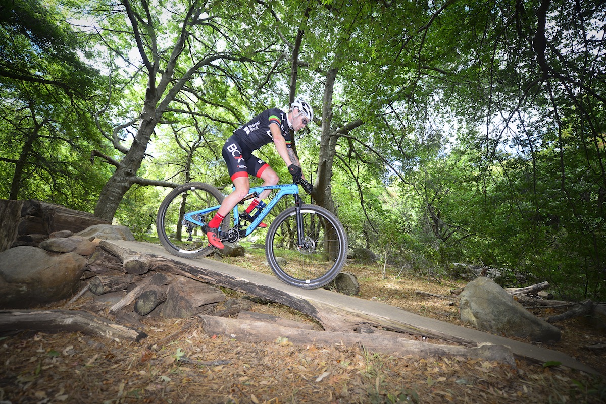

Tell us about the frames you’re riding:
WW: SwiftCarbon Evil Twin full suspension, both size Medium. It’s really great that frame holds two bottles – a must, as most of the Cape Epic stages are over 100km, sometimes in severe heat.
HB: I like a bike that is extremely stiff on the climbs and when you stand up, this bike goes forward. Climbing is great…
WW: Yes it’s very direct. It’s go more of a ‘hardtail’ geometry so it’s able to make direction changes quickly, but it’s also pretty composed on the descents. Once you have the suspension dialed to your style, it handles very well.

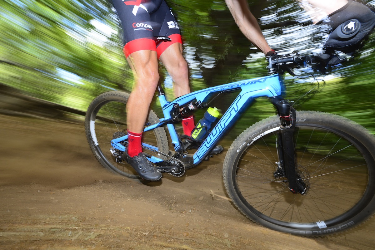

What set up do you have, with shock pressures and dampening?
WW: I run around 85-90psi in the fork and 120psi on the rear shock. I like to have a softer, plush suspension and harder tires for puncture safety. I run the rear open mostly – the climbs are often very rough and this gives extra traction.
HB: We had the old RockShox forks and tried them at the early season races, and we swapped them out for the new SID World Cups for Epic – they’re really nice.

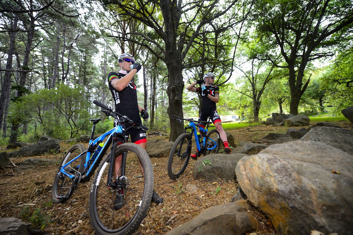

What kind of cockpit setup do you like?
WW: I use nothing less than a 710mm bar. I prefer to have the wider bar for the control and comfort.
HB: We both have Ritchey WCS. I run a 100mm stem with 710mm bars, which fits my shoulder width – grips are ESI Extra Chunky.
WW: Brakes are super important with the speeds we ride at, close to the other riders in the bunch with all the dust, and rocks flying up… we’re really happy with the SRAM Guide Ultimates we picked. 160mm rotors front and back.

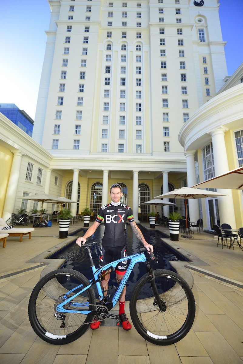

Any particular reason you went for a 1×12 setup on the drivetrain?
WW: When we had 1×11 we would swap between a 32T and 34T depending on the stage profile. 1×12 has changed the game though, and riders are using 36T and we don’t have to swap blades between stages because of the gear range.
HB: We run SRAM XO1 Eagle 1×12. I also will be riding 36T in front and the 10-50 combination at the back – perfect for the Cape Epic stages that require small gears up the steep climbs without spinning out on the flats and downhill sections.
WW: I like the Rotor Rex 1 cranks because they make 172.5mm length arms (HB has 175mm). I like it to be the same as on the road – personal preference. I also prefer standard round blades. I have tried oval before but went back. Maybe I’m just old school…
HB: We will have full shifter/cable/derailleur spare in our tech boxes, with gears already preset. If we break a derailleur we just replace the entire setup, quickly.

What’s your hydration arrangement?
HB: 2x Lezyne bottle cages
WW: Evox Nutrition bottles. Conditions are usually always hot this time of year so I try carry as much on me as possible.
Any other additions and accessories? Where do you put spares?
WW: I prefer to have some of my spares in my pockets. I put different tools in different pockets for easier retrieval. I do however mount my plug and CO2 canister on my bike for the quickest reach. My CO2 canister is mounted behind my seat post and a plug underneath my top tube.
HB: I will be carrying a multitool with a chain breaker, some plugs and the Sahmurai sword tyre plug devices in my handlebar ends. I will also take a couple of chain links as spares, plus one tube between Waylon and I for emergencies.
