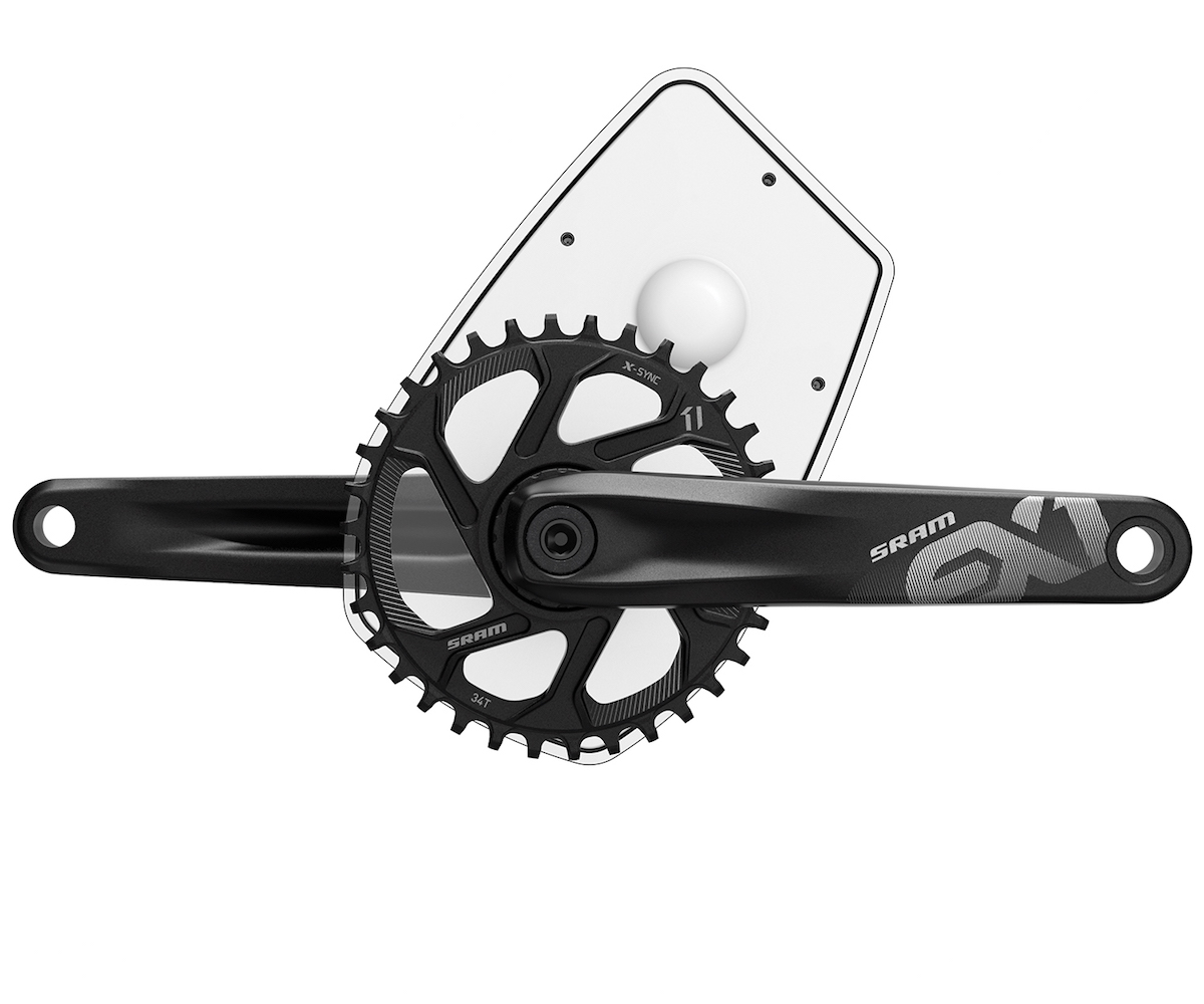

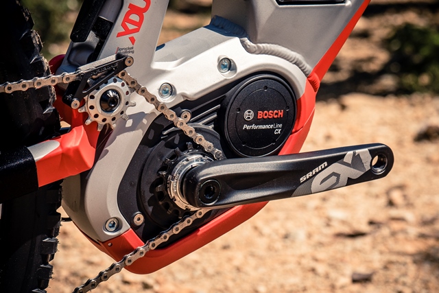

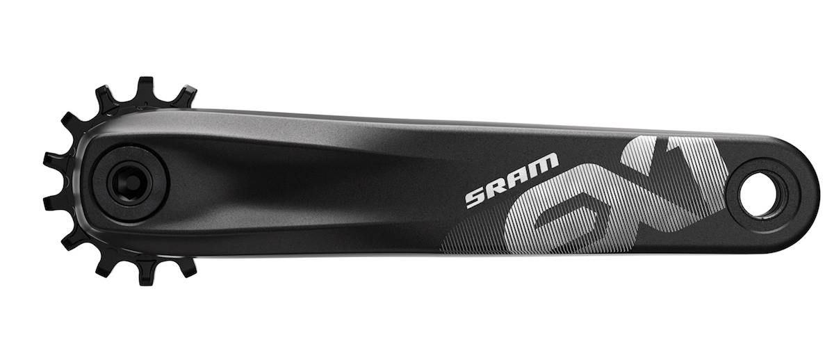

EX1 E-Crank
Lightweight, durable, stiff and designed specifically to work with Bosch and Brose mid-ship motors, EX1 crankarms are purpose built for the high-torque E-MTB environment.
Features and Benefits
  • Proven SRAM technologies adapted for the demands of midship-motor E-MTBs
  • Compatible with Bosch, Brose and Yamaha bottom bracket interfaces
Specifications
  • BB compatibility – ISIS
  • Crank arm length – 170mm, 175mm
  • Colour – black
  • Crank arm material – aluminium

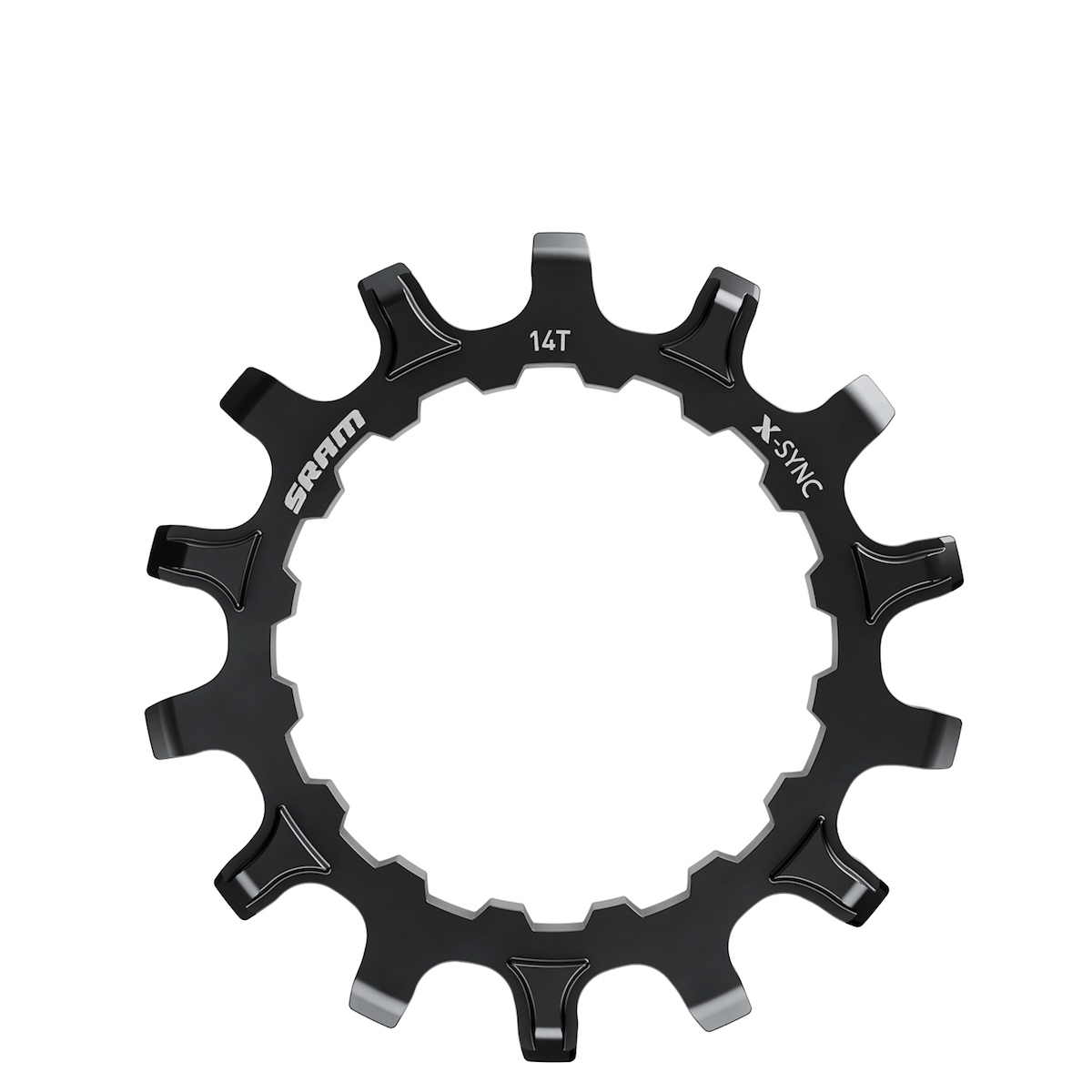

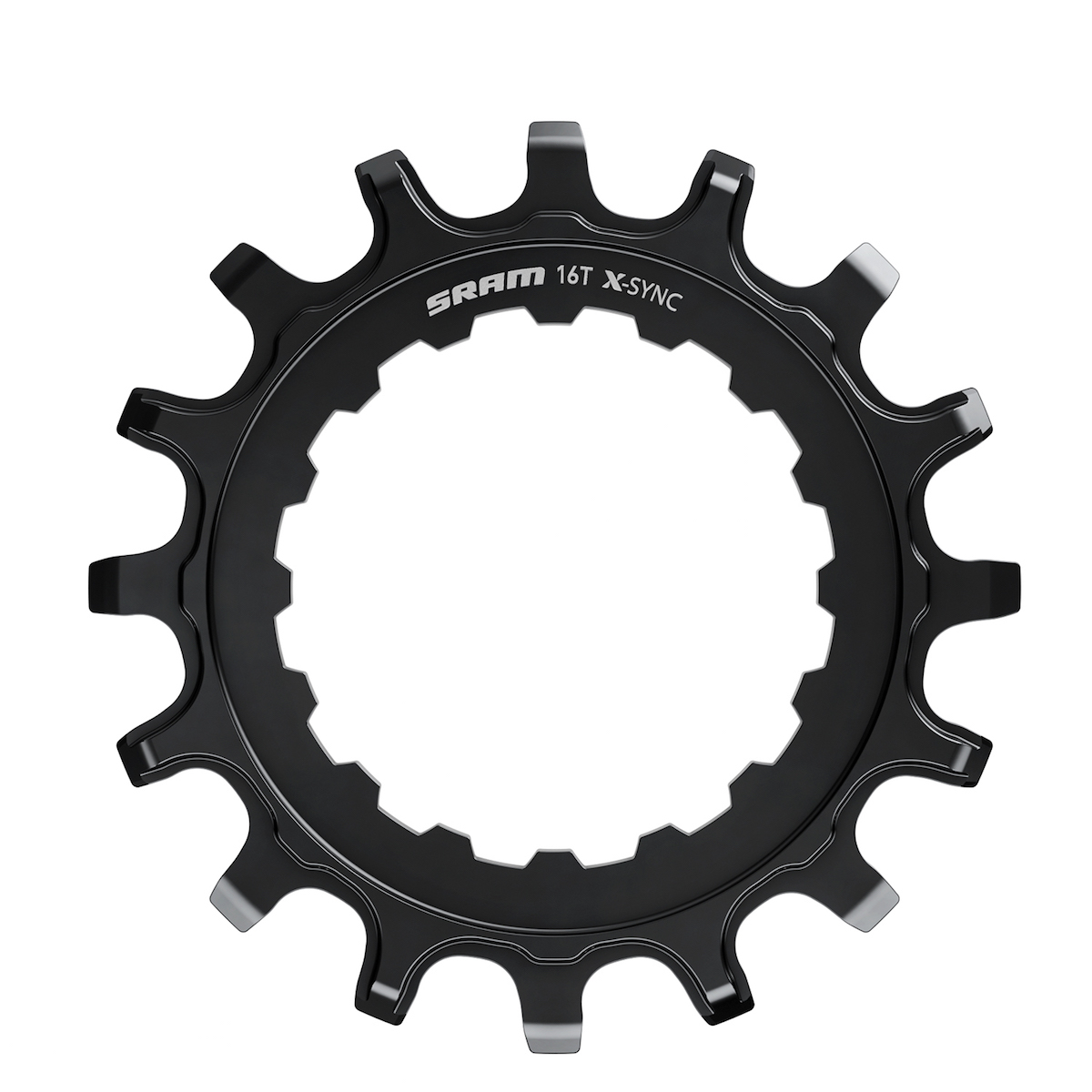

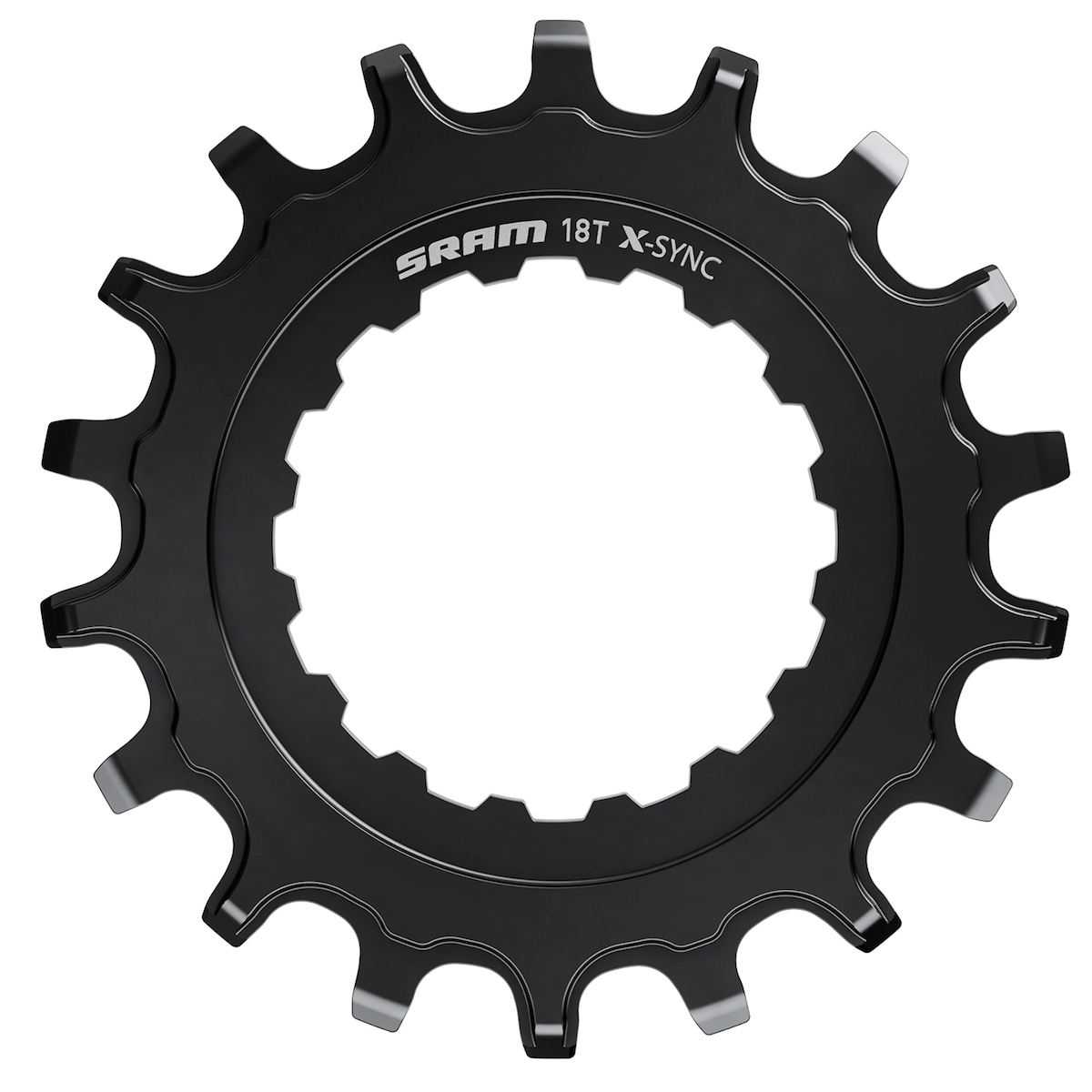

SRAM X-Sync Sprockets
Built with the needs of E-MTB riders in mind, and incorporating the same X-SYNC chain management technology found in every SRAM 1x drivetrain, EX1 offers 14-, 16- and 18-tooth sprockets for Bosch motors.
Specifications
  • Bolt circle diameter – Direct mount
  • Teeth – 14, 16, 18
  • Colour – Black
  • Material – Steel

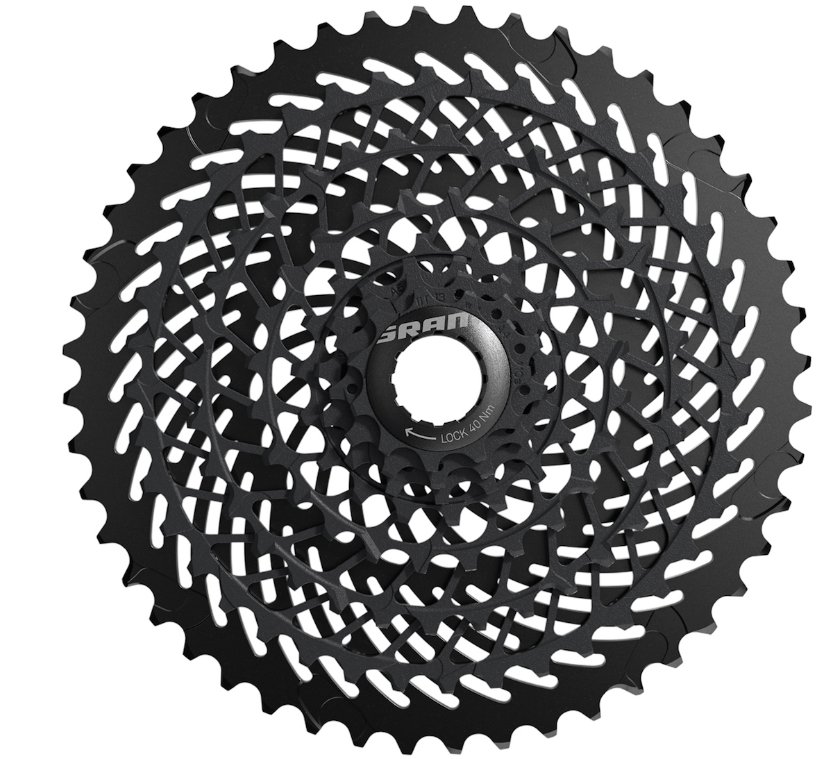

XG-899 E-Block Cassette
E-BLOCK shifting technology is a fundamental redevelopment of external drivetrain shifting. On the E-BLOCK cassette, the chain has a defined link position on each cog. Cog architecture has been engineered to work with both inner and outer links of the chain, which allows extremely refined shifting for both inboard and outboard shifts. The result is precise and robust shifting performance in any situation, even with full motor support.
Features and benefits:
  • 11-48t, 8-speed cassette machined from case-hardened tool steel
  • Ideal mid-ship motor gear range
  • Increased chain wrap on climbing cogs
  • Symmetric shifting geometry allows fast, precise gear shifts
  • Optimal inboard and outboard shifting performance
  • The big steps between cassette cogs is a completely new cassette technology engineered specifically for the demands of E-MTB
  • Non XD driver body compatible
Specifications:
  • Speed – 8
  • Gearing – 11-48t
  • Cog finish – black
  • Technology – XG
  • Cog sizes – 11t, 13t, 15t, 18t, 24t, 32t, 40t, 48t
  • Cogs on cluster – 5

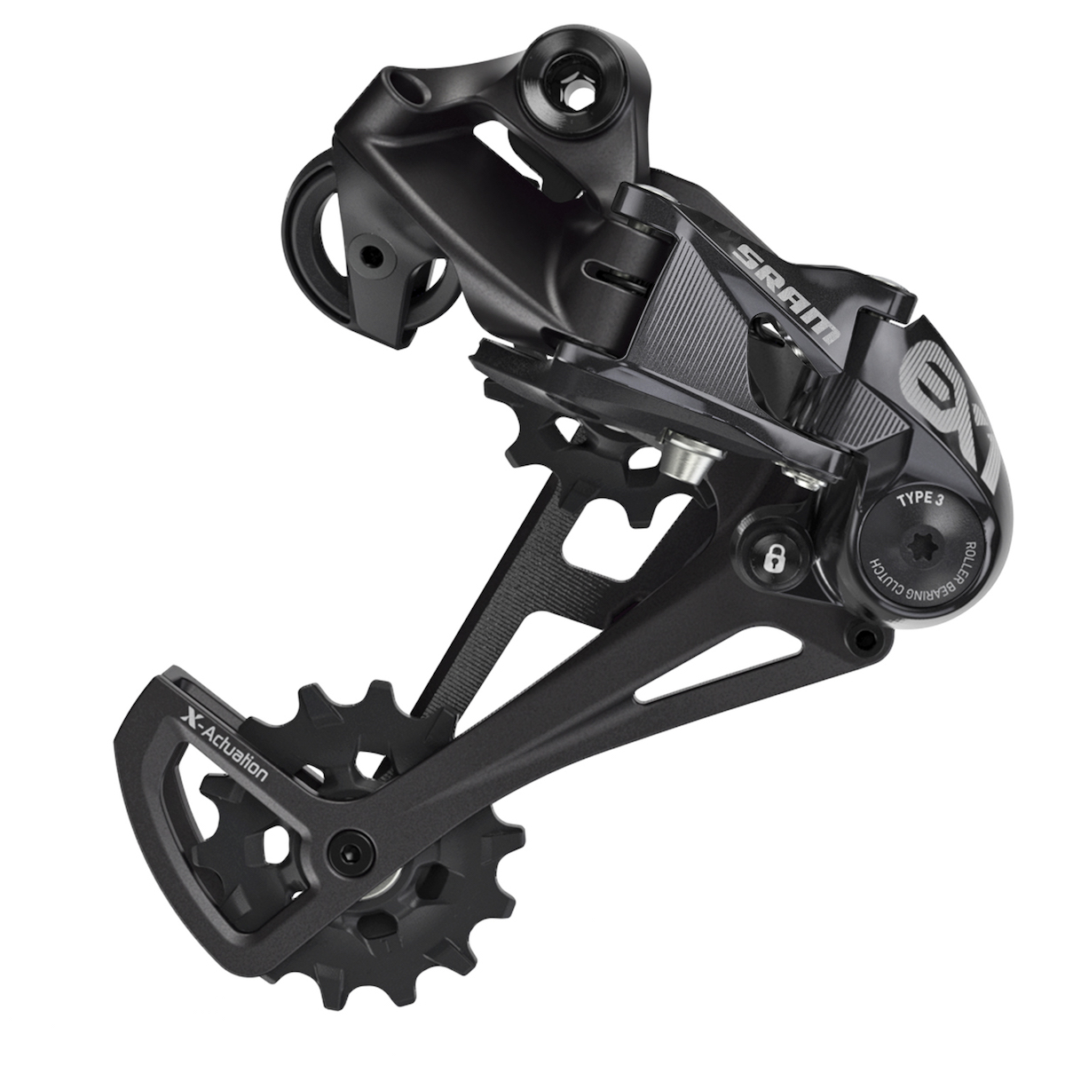

EX1 X-Horizon Rear derailleur
The EX1 derailleur capitalizes on the robust build and precise shifting attributes of the X-HORIZON design, to create the world’s first derailleur specifically made for E-MTBs. Engineered to handle high-torque, low-cadence shifting across the 11-48 tooth E-BLOCK cassette, the EX1 derailleur gives E-MTB riders clean, confident shifts, so they can spend more time enjoying the ride.
  • Proven SRAM X-HORIZON design that reduces shift force, ghost shifting and chain slap
  • 12-tooth X-SYNC pulley wheels
  • The EX1 derailleur is purpose built for E-MTB
Specifications
  • Speeds – 8
  • Cable pull ratio – 1:1
  • Max tooth – 48
  • Colour – black
  • Pulley bearings material – steel
  • Cage material – aluminium
  • Weight – 289g

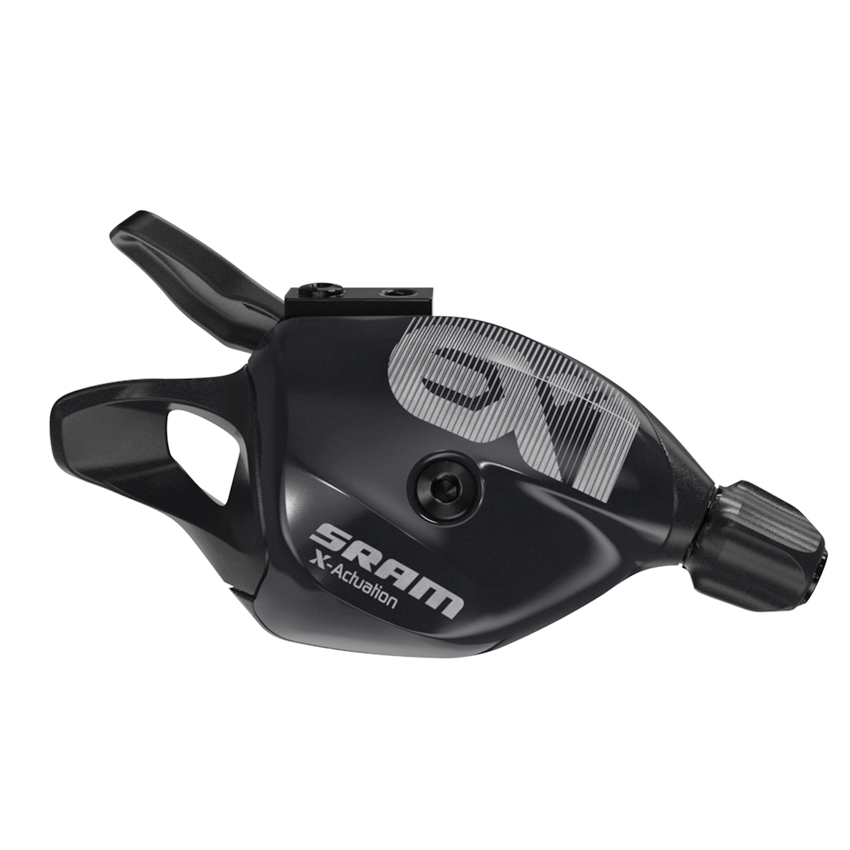

EX1 X-Actuation Trigger Shifter
It has the proven SRAM shifter technology and authoritative lever feel, but the EX1 shifter has been engineered to deliver one perfectly accurate shift at a time, alleviating double shifting and over shifting. Single precise gear changes increase battery life and help to decrease component wear.
  • X-Actuation for precise and dependable performance
  • Single shifts reduce over shifting and increase battery performance
Specifications
  • Speeds – 8
  • Compatibility – 8-speed rear derailleur
  • Cable pull ratio – X-ACTUATION
  • Colour – black
  • Cable length – 2200mm
  • Shifter type – trigger
  • Matchmaker compatible – yes
  • Max upshifts/downshifts – 1
  • Multi-position – yes
  • Part weight – 122g

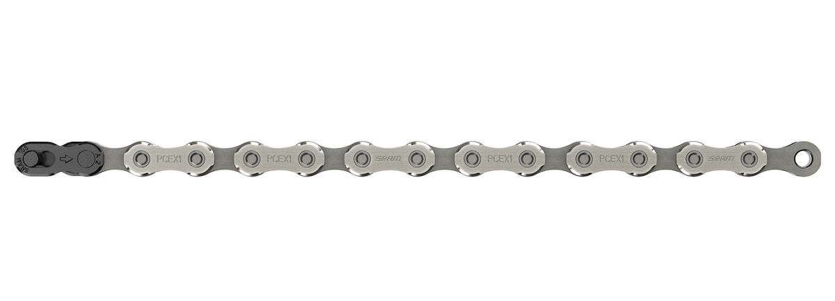

EX1 Chain
The high torque loads of E-MTBs require tough components. The straighter chain line EX1 offers allows the use of a chain that is wider and more robust than those found on drivetrains not specifically engineered for E-MTBs. The 8-speed EX1 chain has been engineered to run quiet across the gear range and transmit more power to the rear wheel.
Specifications
  • Colour – Grey
  • Chain connector – PowerLock
  • Inner link finish – Polished
  • Outer link finish – Nickel
  • Pin variant – Solid Pin
  • Pin treatment – Chrome Hardened

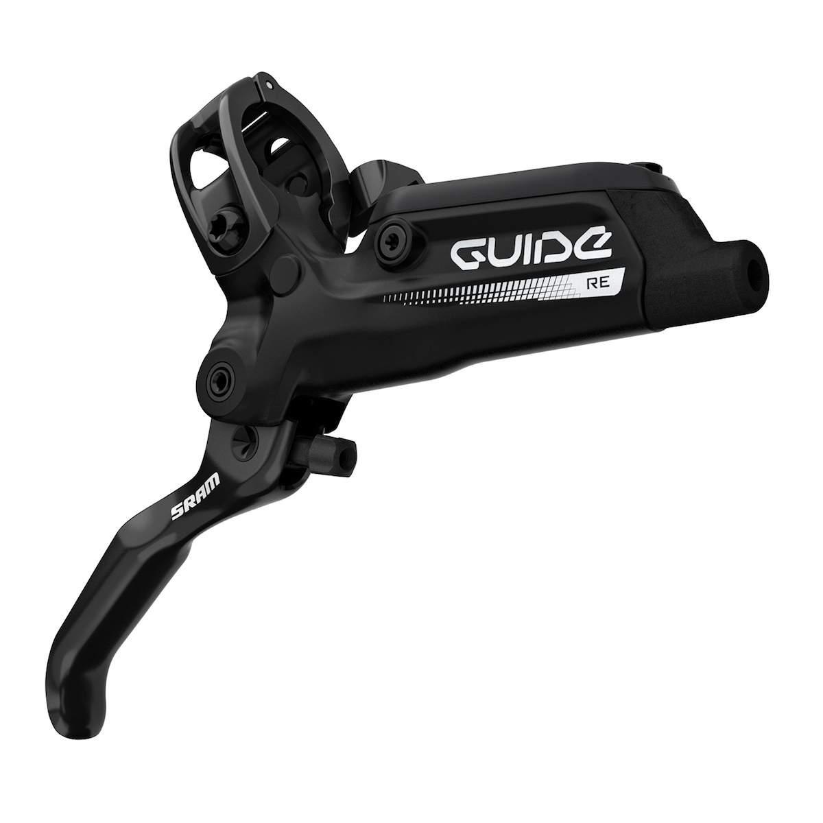

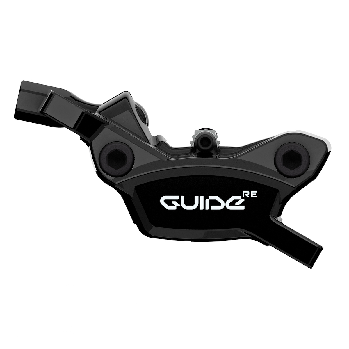

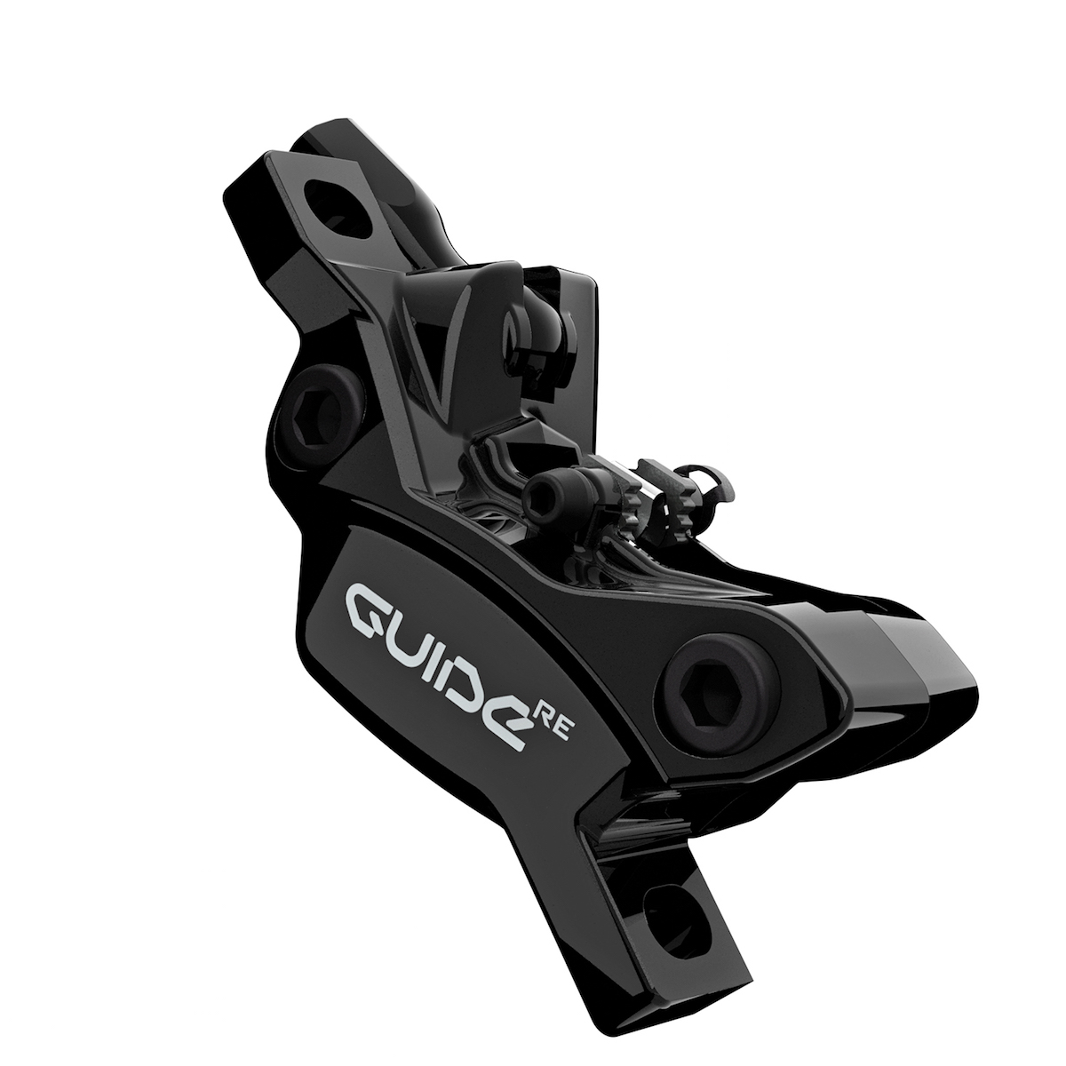

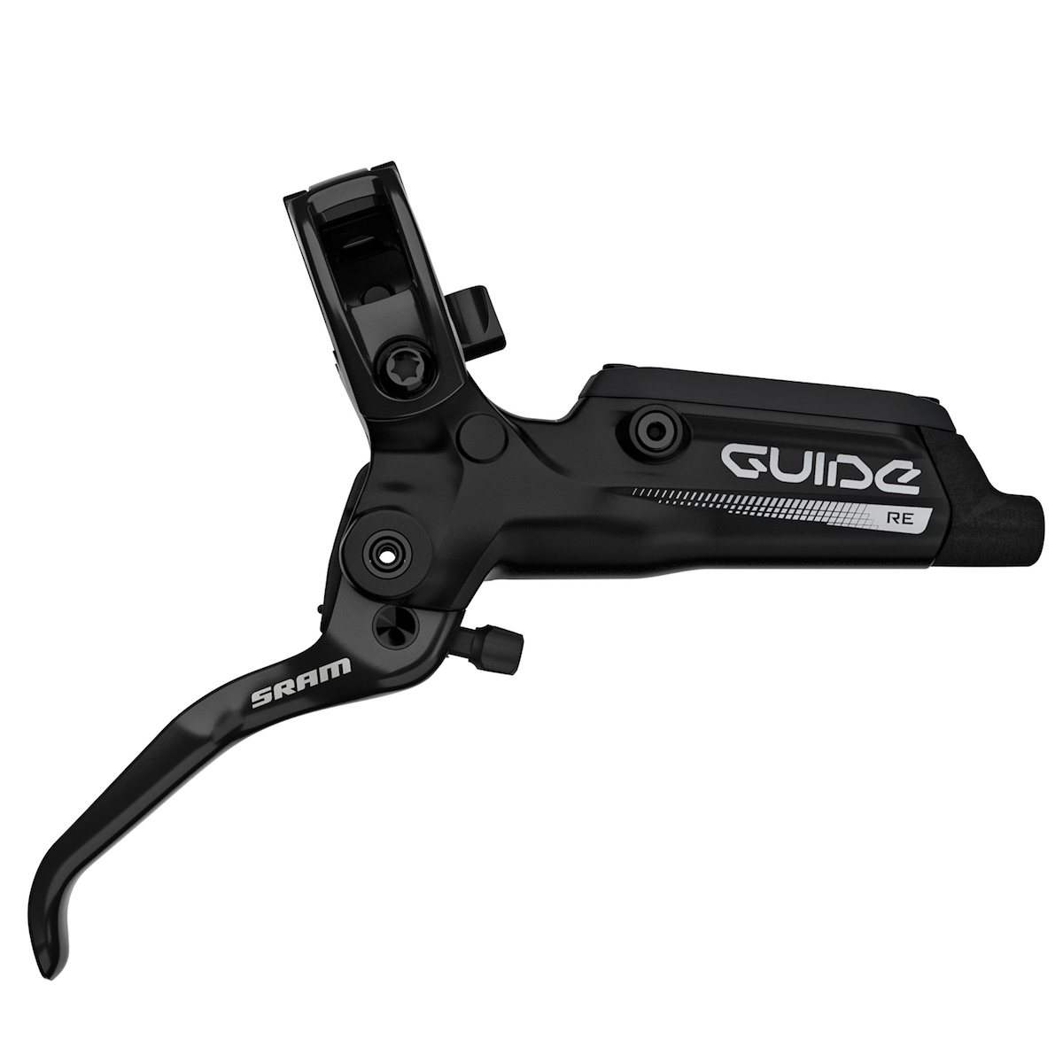

Guide RE
Guide RE is SRAM’s optimized braking solution for today’s exciting category of E-MTBs, capable of handling the higher average speeds, more intense use and increased mass due to the presence of the motor and battery. It combines SRAM’s proven Guide R lever assembly with a powerful 4-piston caliper derived from the gravity-focused Code brakes. Guide RE provides real, usable on-trail control—optimal power and modulation mean speed can be controlled in all terrain and in all situations, both uphill and downhill.
  • Guide R lever assembly with proven Guide technologies
  • Powerful 4 piston caliper derived from the Code gravity specific brakes
  • Sintered pads for better pad life in intensive use
  • MatchMaker X compatible
  • Ambidextrous lever mount
  • Tool-free reach adjust
Specifications
Weight: 415g (based on direct mount, 800 hose, 160mm CL Rotor)
Blade material: aluminium – stamped
Lever body material: Forged aluminium
Caliper construction: 2-piece
Caliper material: Forged aluminium
Finish: Gloss black
Pad type: Steel-backed metal sintered
Hydraulic fluid: DOT 5.1
Reach adjust: Tool-free
Hose routing angle: Adjustable banjo
Brake type: Hydraulic
Lever pivot: Bushing
Caliper hardware: Steel
Pistons: 4
Piston material: Phenolic plastic
