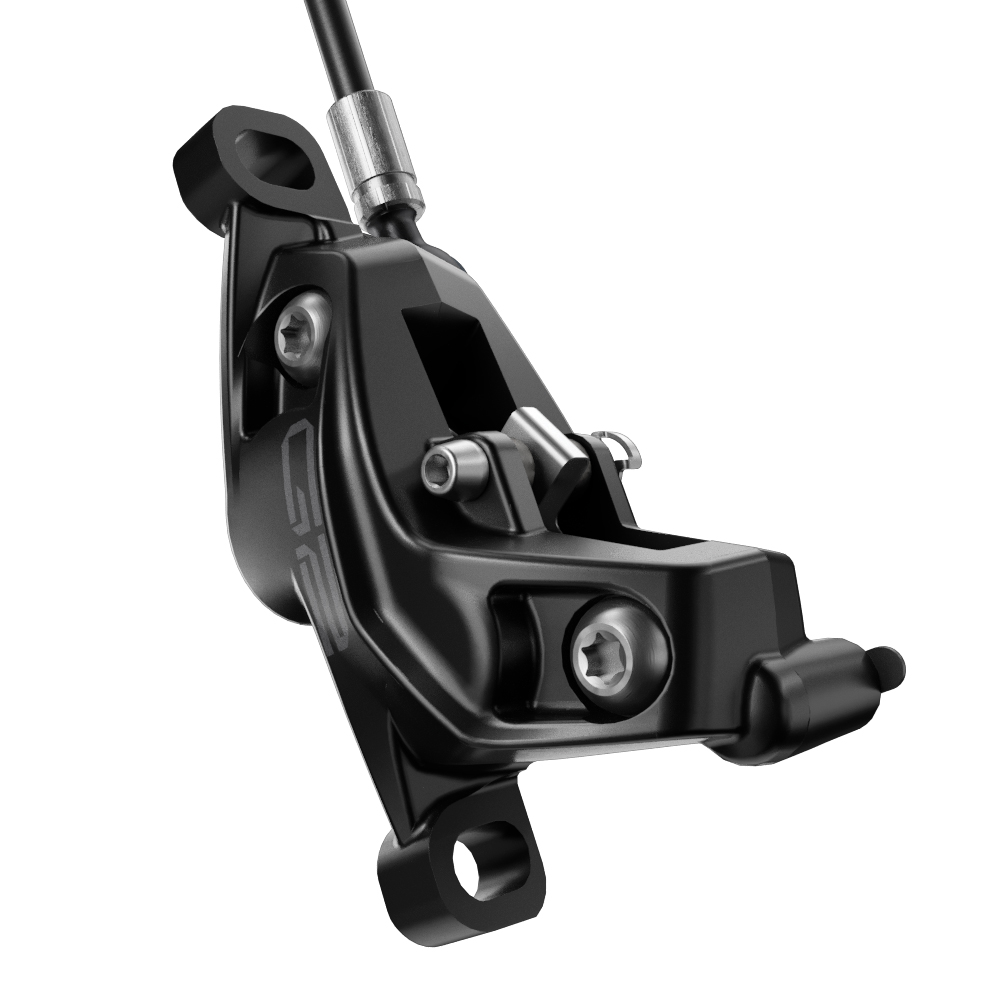

The new G2 brakes are an evolutionary replacement for Guide brakes. SRAM promises stronger braking force (likening them to mini versions of their downhill Code brakes), even pad wear, and has launched a new pad compound that offers more bite. The new G2 brake will be available at launch in two models: G2 Ultimate and G2 RSC.

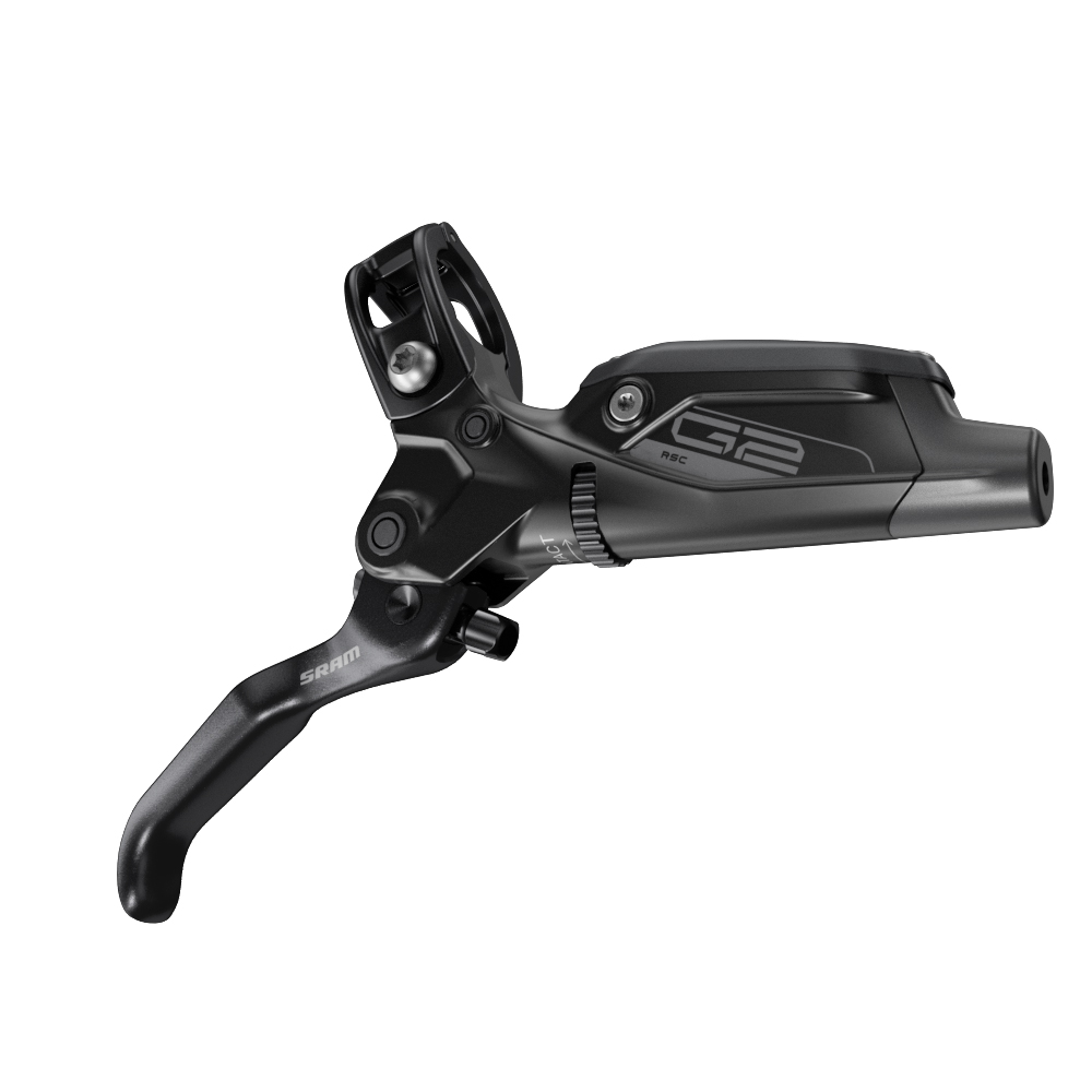

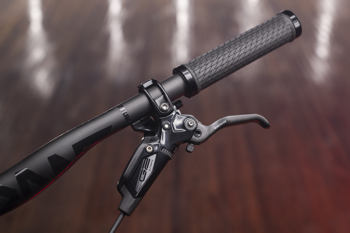

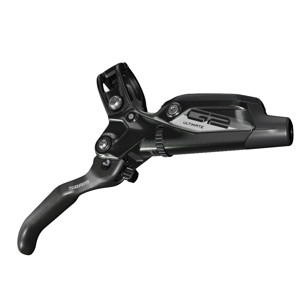

G2 Ultimate
This is our all-new, lightest 4-piston brake outfitted with every feature and material you’ve come to expect from something called Ultimate. Our engineers built it with what they would want on the trail: power, modulation, silky-smooth lever feel, complete adjustability. Our test riders dubbed the new design “mini-Code” for its Code-like performance.
  • All new brake delivering mini-Code power
  • Added stiffness in the caliper
  • A new pad compound that offers more bite
  • The pivot bearing offers a snappier lever feel
  • Offering a finger fatigue-free ride
  • SRAM’s lightest four piston brake

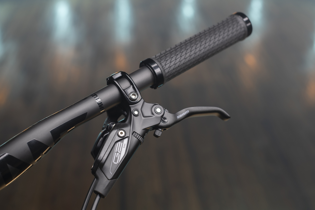

G2 RSC
G2 RSC is the half-ton pickup truck of the mountain bike brake world — dependable, go anywhere, do anything, plenty of power when you need it, and all of the features you need. The new G2 RSC is based on the SRAM Code design, so it puts Code-like power and modulation into a mini-Code package. And of course the signature Guide lever-feel and contact-point adjustability ensures that this brake works great for every rider. The G2 RSC presents rider-controlled offering with an alloy blade, lever pivot bushings, stainless steel hardware.
  • Reach and contact point adjustments for every type of rider
  • Delivers the mini-code feel

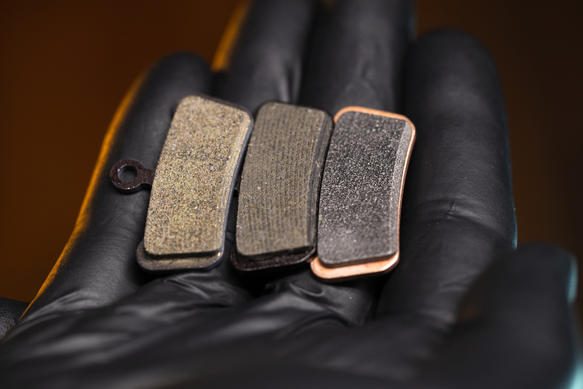

What are the brake pad compound offerings? What are the technical differences and intended uses of the different offerings?
We developed a new, more powerful organic pad compound for G2. This pad will have a “Lunar” grey backing plate and will be available as a replacement part. Our pad offerings will include:
  • The new Power Organic configuration — Grey backing plate
  • Quiet Organic pads – Black backing plate (currently used in Guide and Level brakes)
    • A good all-around pad, quiet, but not as powerful as the Power Organic version.
    [*]Metallic – copper backing plate
    • Our most powerful, hardest hitting pad compound. Long lasting and great in wet and muddy conditions.

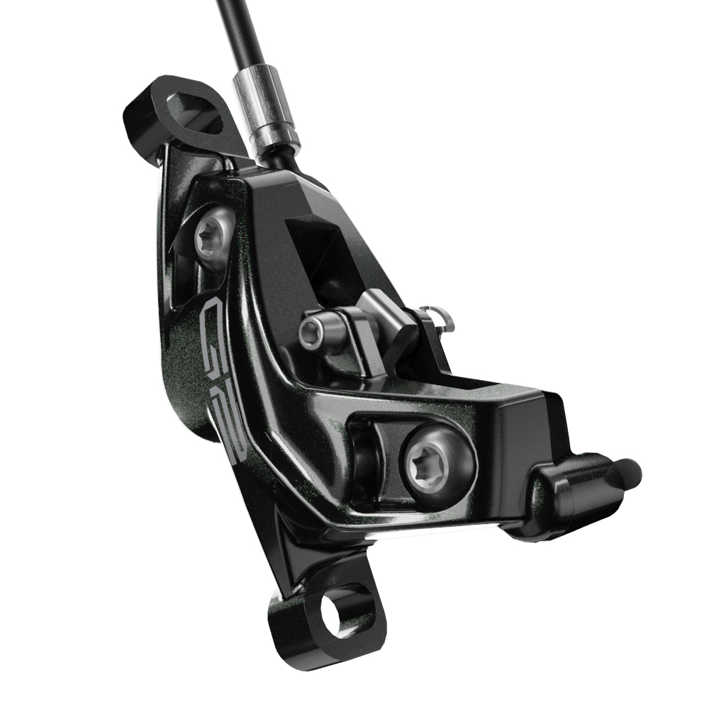

How did you achieve the increase in brake power over Guide?
Every part of the Guide system has been improved. In designing a new caliper, we looked to the lessons learned when we designed Code. We focused on stiffness, so the pad pocket is a little narrower and the connection points around the body bolts are larger which results in less caliper flex, which therefore provides more direct power transfer than in previous designs. We also developed our new Power organic pad compound. This compound delivers a more aggressive “bite” and increased power during sustained braking

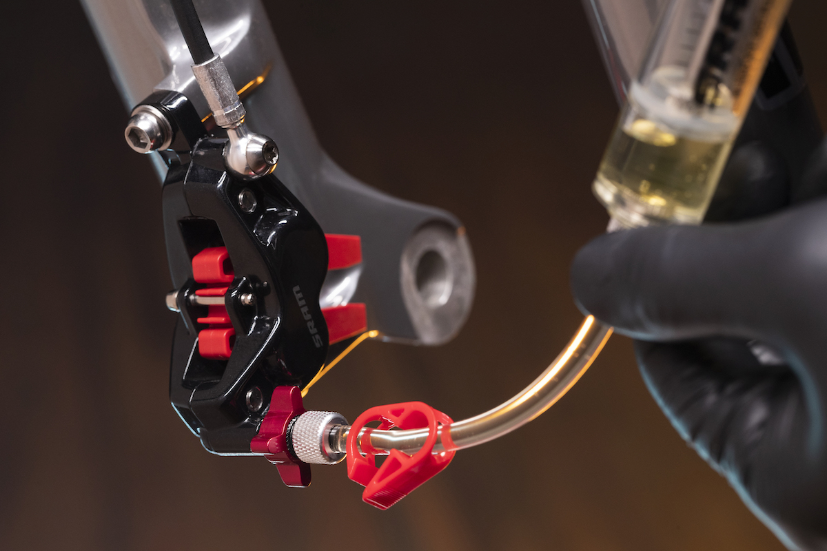

Is the DOT brake fluid the same as the brake fluid used in Guide?
Yes. We use Ravenol DOT 5.1 brake fluid.
Can you explain the reasons you choose to use DOT brake fluid in your brakes?
There are many reasons why we firmly believe DOT brake fluid is the best option for brakes:
  1. Higher boiling point than mineral oil systems
  2. DOT brake fluid manages water effectively. Absorbing water inside the brake system rather than pushing it to the edges. This helps maintain brake performance and does not allow water to collect in a brake system. Water can cause corrosion and will boil at 100C.
  3. Material selection. The EPDM seals we use have a much broader operating temperature range than the buna rubber (NBR) used in mineral oil systems. This temperature range isn’t just for sealing, but for elasticity.
  4. DOT brake fluid allows the calliper seals to behave more consistently at varying temperatures. Meaning SRAM brakes can have a large amount of pad roll back and consistent lever throw. These seals also maintain performance when the temperature of the brake is high.
  5. DOT brake fluid has a higher bulk modulus than any of the variety of mineral oils used in bicycle brakes. DOT brake fluid compresses less than mineral oil at the pressures found inside of a brake. That means mineral oil systems may have a softer feel than DOT brake fluid-based systems.
  6. DOT Brake Fluid can be cleaned off a bike or brake with just water. Mineral oils are “sticky” and require a solvent to remove.
  7. DOT and Mineral oil should be handled the same way – wear gloves, catch, and recycle.

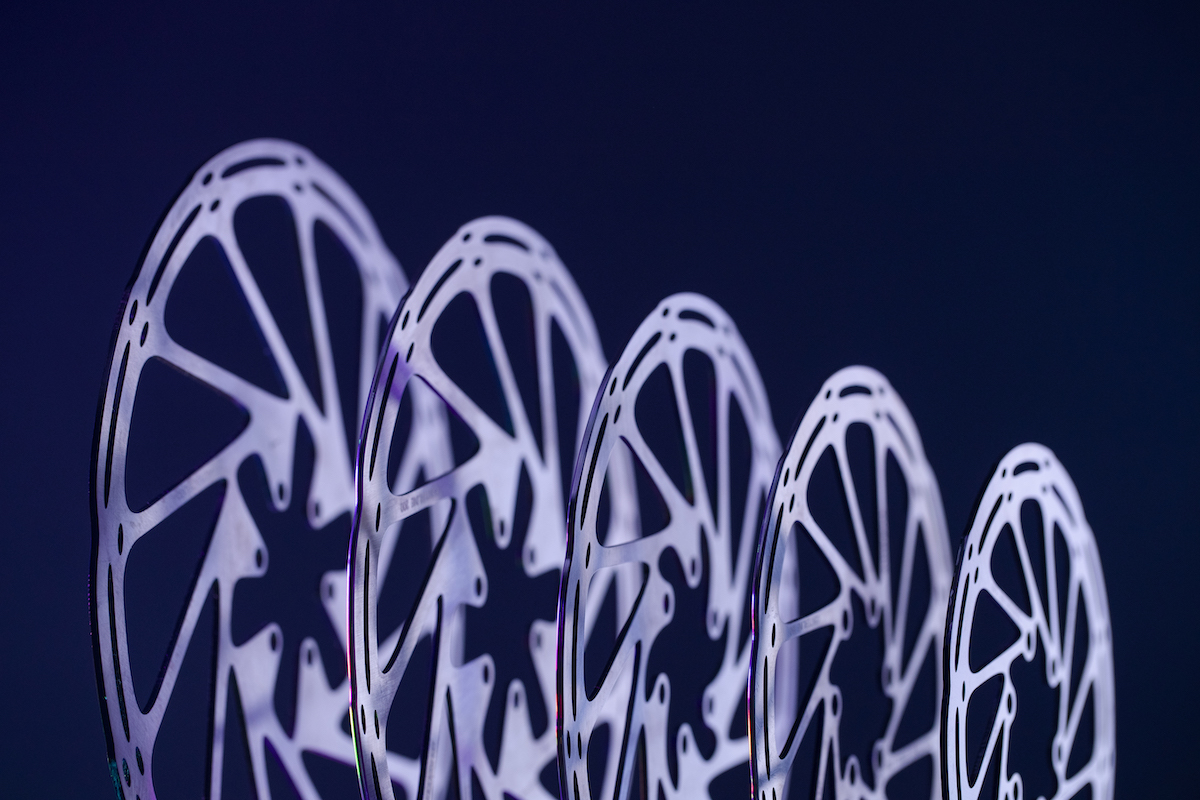

Is there a difference in power output on standard rotors and 2 piece rotors of the same size?
Power is similar between these two configurations. Our CLX rotors were designed to save weight. Our one-piece CenterLine rotors do a better job managing high temperatures because they are heavier.

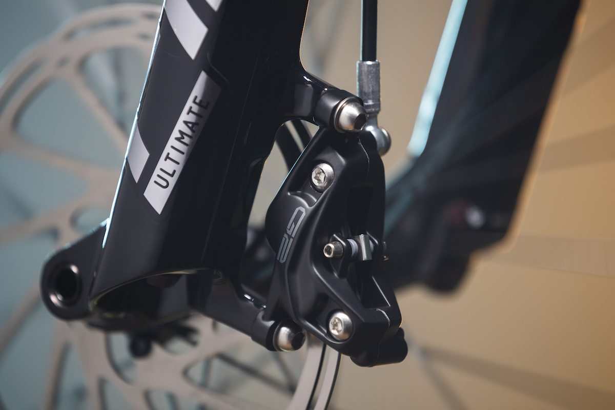

What are the main differences in the new G2 caliper from the S4 caliper?
The G2 caliper has all-new caliper machining to refine control of seal/piston/caliper interface, which results in some great benefits. It’s easy to align the caliper by having an improved pad gap. G2 brakes have a consistent bite point as the pad gap remains the same as pads wear – this means the lever will hit at the same spot throughout the life of a set of brake pads. The caliper is also stiffer which increases braking power.
How has the piston square seal changed on G2 and how does this help with more consistent and increased rollback?
The square seals remain consistent, but the way in which they are held in the caliper has evolved. The gland which contains the square seal within the caliper controls how far the brake pads move and when the pistons slip past the square seal to advance the brake pad toward the rotor as the pad wears. We’ve refined the gland in the caliper to make a best-in-class brake with respect to these critical aspects of brake performance.

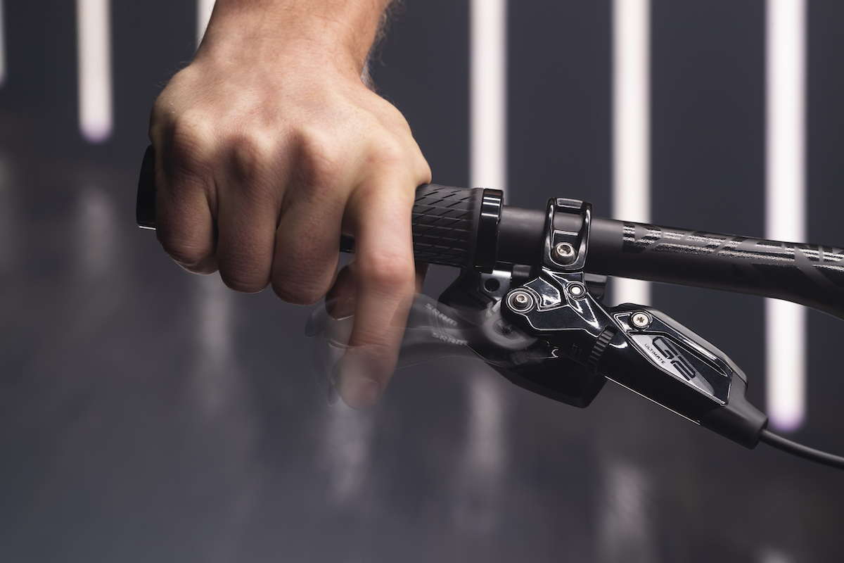

Can you explain the differences in the lever from Guide to G2? Is the lever more similar to Code?
The leverage ratios of Guide, Code and now G2 SwingLink brakes are all the same. We tested a variety of new curves during G2’s development, but deliberately used our current ratios. The leverage rate defines our on-trail feel, and that’s important.
We refined the small parts and assembly approach of G2 RSC to reduce the cost and bring contact point adjustment to more riders
G2 RSC features a new pivot dowel and bushing that provides a laterally stiff connection for the lever blade with minimal deflection at the tip.
G2 Ultimate improves on all of this by incorporating lever pivot bearings and a carbon blade
