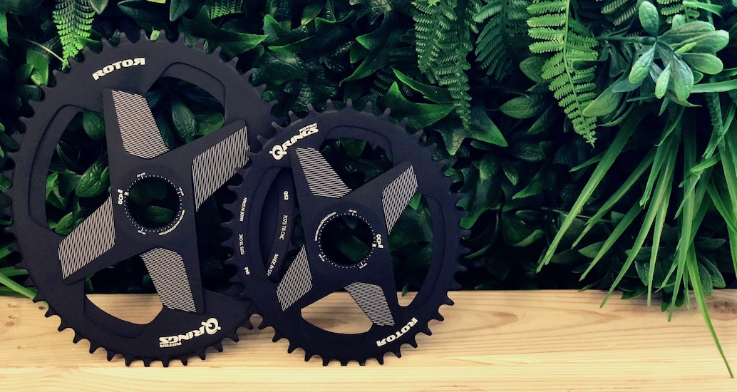

Combined with a wide choice of 1x chainring sizes (38, 40, 42, 44, 46, 48, 50, 52, 54) our 13s cassettes can match and improve gear range and gear steps of the traditional 2×11 drivetrains.

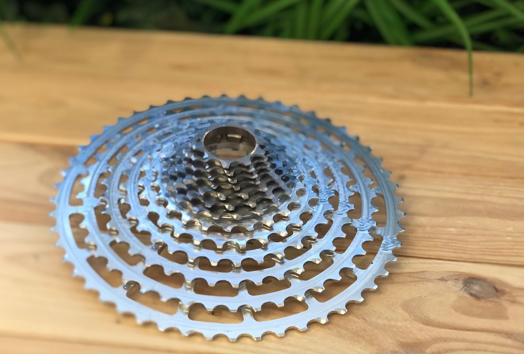

The foundation of our faith in the one-by groupset configuration is firmly based in the unique aero design of the world’s first 13s cassette.

Unique 1×13 modular platform concept fits different cycling needs with the choice of shifters, cassettes, optimised direct mount chainrings and cranks.

Simplified 1x chainring without front derailleur means reduced weight and mechanical complexity with improved aerodynamics.

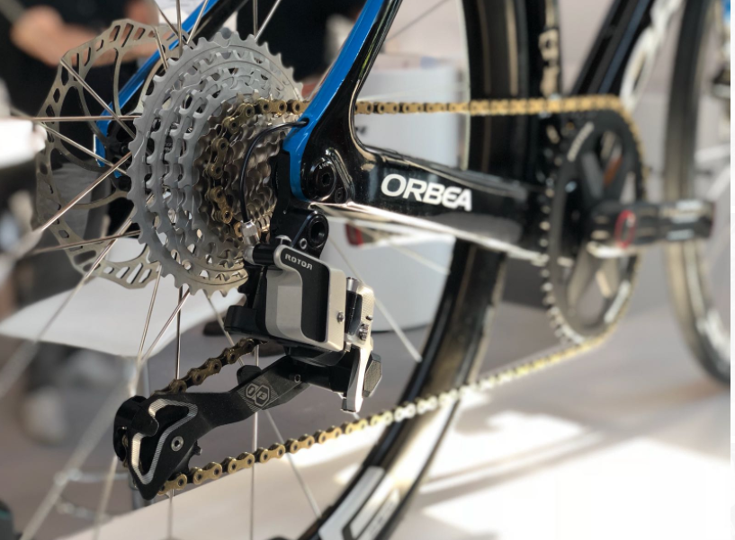

6. Hydraulic actuation benefits
● Maintenance free: Install, Bleed, Forget. No cables to replace, no batteries to charge.
● Internal routing ready.
● Lighter than battery powered and mechanical systems.
● Hydraulic technology with proven reliability.
With 1×13 you can bypass the traditional challenging 2x front derailleur shift so you can focus on fluid rear shifting with reduced chance of chain loss or chain suck.

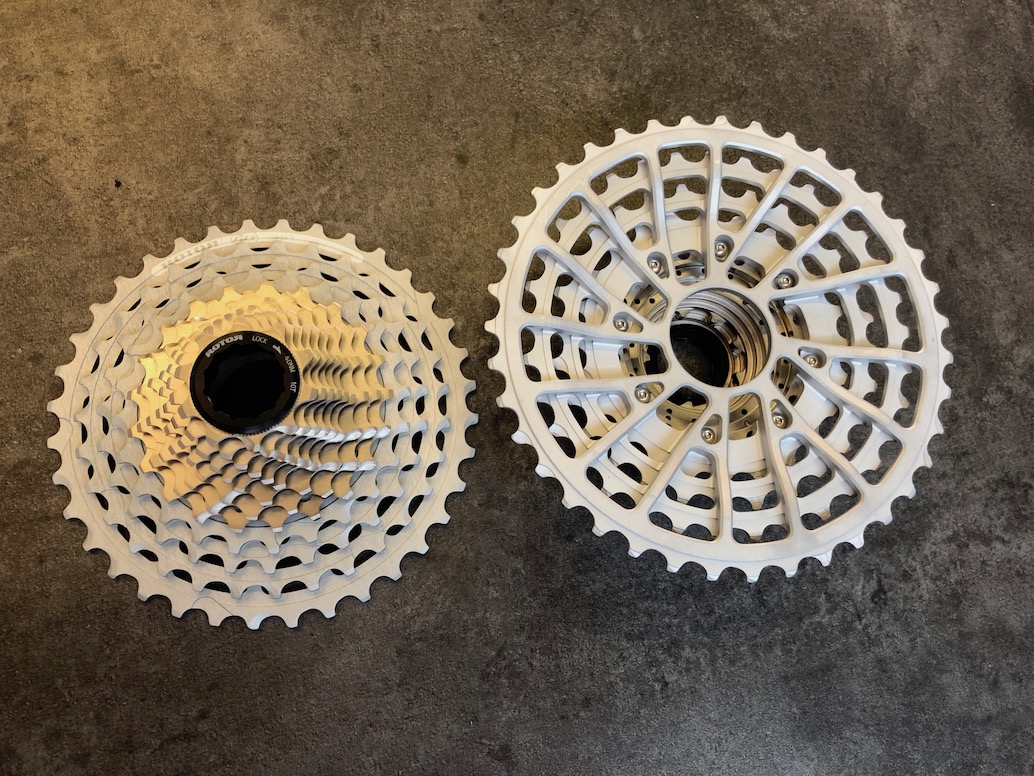

The 1×13 platform includes a range of 4 new cassette options for Road, Gravel, Cyclocross and MTB including sizes: 1 0-36, 10-39, 10-46 & 10-52 . Our 13s Cassette family has been developed to deliver the optimal shifting performance for the 1x system to select the most advantageous gear ratio combination that best suits your cycling practice.
By analysing real user-data via our sophisticated INpower technology, ROTOR engineers have developed a unique design that provides a real alternative in range and gear steps to the traditional 2×11 drivetrains. The number of teeth and the steps between gear sprockets are conceived so you can maintain your optimal cadence range for the best possible cycling experience.
The cassette structure combines 2 solid pieces, 1 of Aluminium and 1 of strengthened Steel to create an incredibly lightweight yet durable Cassette solution to complement our 1×13 drivetrain platform.
The rear derailleur also features a regulation bolt that allows you to convert it to 12-speed, so it will also work with cassettes from other manufacturers.
