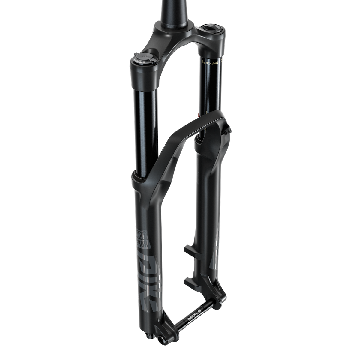

Pike
Designed for today’s top trail-dominating dream bikes and ready for any conquest you’ve got planned. Ticking all the boxes, each and every detail made to reduce friction, minimize rider fatigue, and provide unmatched control over any trail.
PIKE ULTIMATE (FS-PIKE-ULT-B4)
A true trail machine we couldn’t wait to have on our bikes and get to you. Featuring an updated DebonAir air spring paired with our Charger 2.1 damper for unmatched trail control for every sweeping corner or loamy drop in. Ultra-low friction SKF wiper seals and Maxima Plush damping fluid all work overtime to reduce friction, silence noise, and provide lasting fork performance.
Features:
  • Updated highly-tunable DebonAir air spring offers a buttery smooth feel off the top and maintains a higher ride height for increased confidence in steep terrain
  • Designed to reduce hand fatigue and fight unwanted friction, the Charger 2.1 damper increases confidence and control over every trail
  • Charger 2.1 RC2 damper option featuring independent high and low speed compression adjust
  • Ultra-low friction SKF wiper seals provide long lasting fork performance and improve overall suspension feel
  • Maxima Plush damping fluid reduces friction and silences damper noise
  • Gloss Silver Signature colour option
Specifications
  • Wheel size: 27.5″, 29″
  • Travel: 130mm, 140mm, 150mm
  • Damper: Charger 2.1 RC2
  • Offset: 37mm (27.5″), 46mm (27.5”), 42mm (29″), 51mm (29″)
  • Upper tube: 35mm tapered wall aluminium
MSRP: $899 | €979* | £869* | *INCLUDES VAT

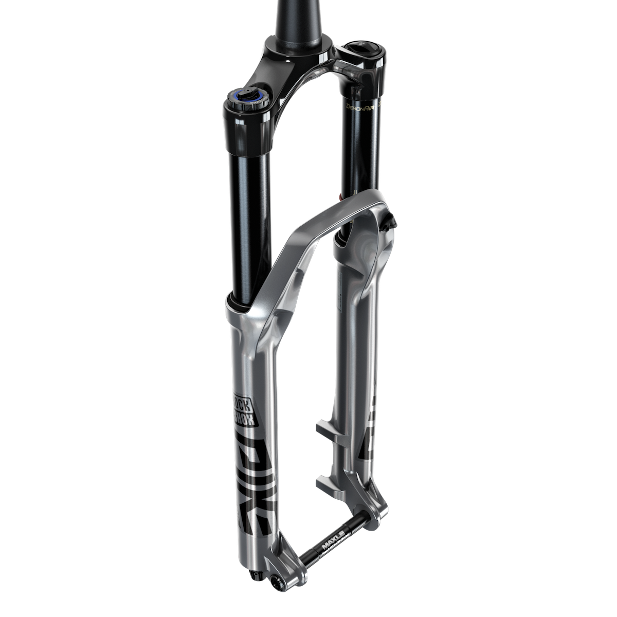

PIKE SELECT (FS-PIKE-SEL-B4)
Pike Select combines an updated DebonAir air spring with the Charger RC damper, perfect for any trail junket you have planned. As a bonus, we included race-proven Maxima Plush fluid to help reduce friction, silence noise, and keep things running smooth ride after ride.
Features
  • Charger RC damper featuring low speed compression adjust
Specifications
  • Damper: Charger RC
MSRP: $699 | €759* | £679* | *INCLUDES VAT

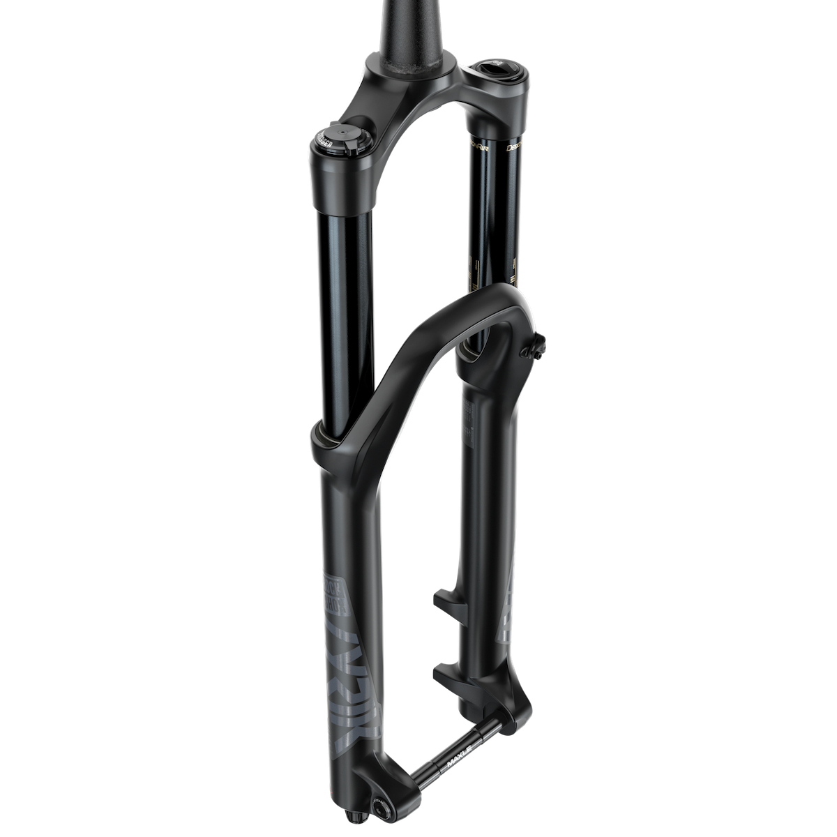

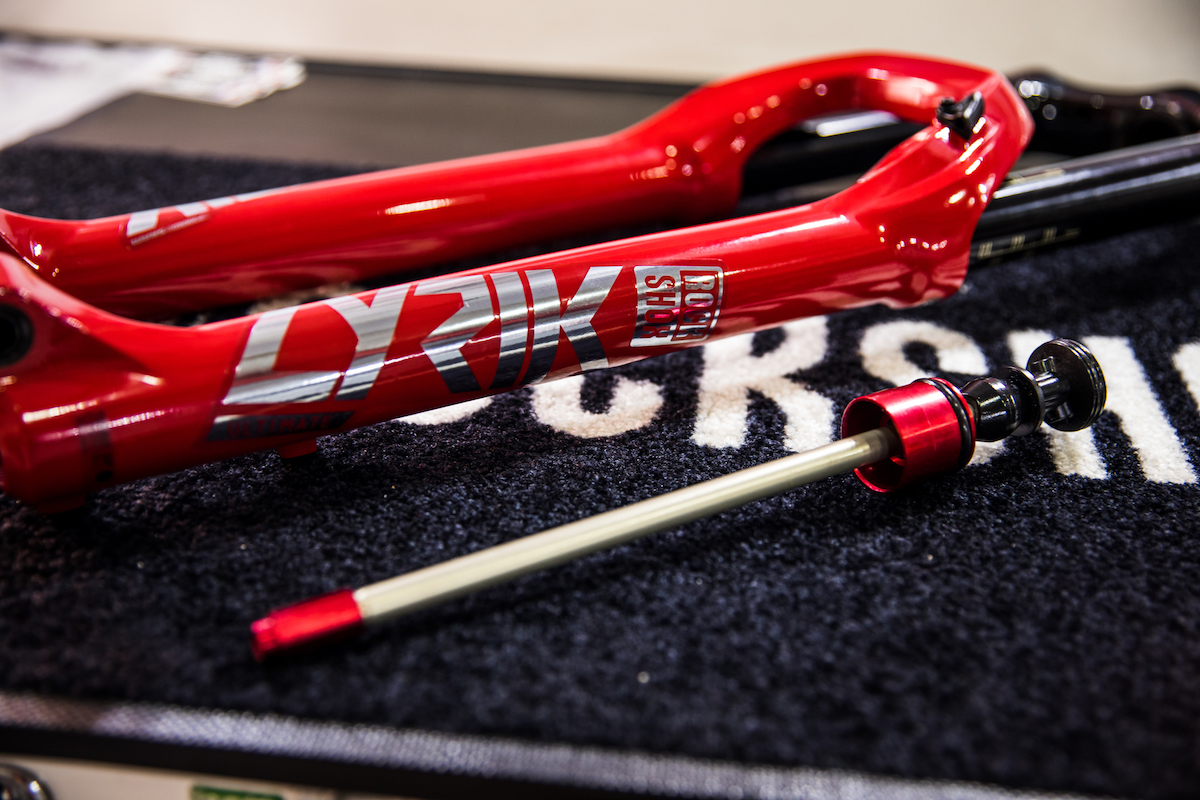

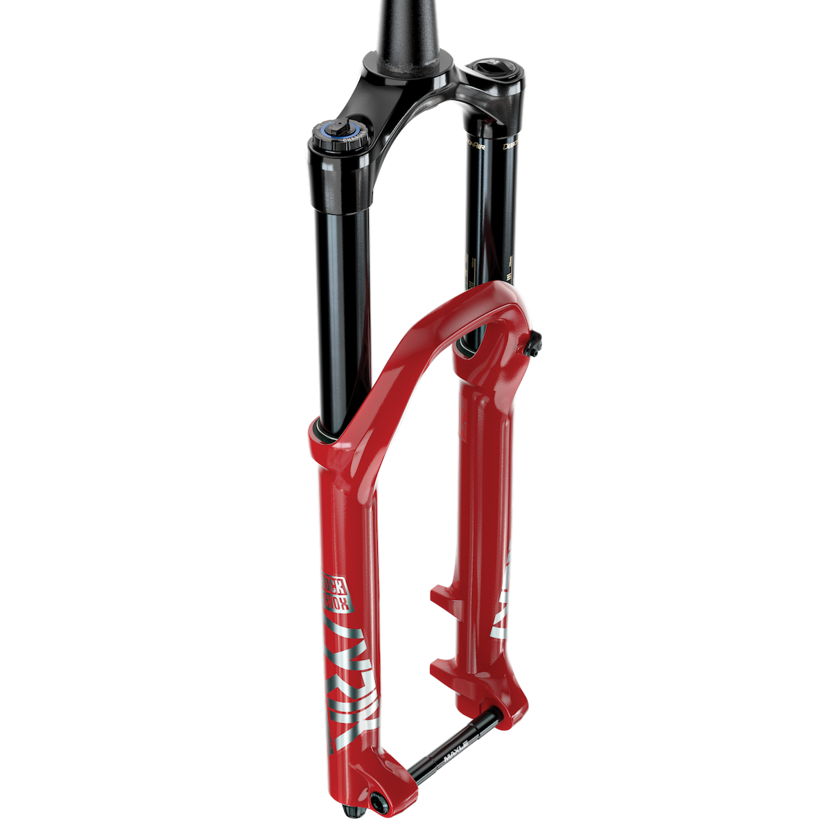

Lyrik
Gotta get up to get down. We’re all about the earned bliss. Steeper, longer, rockier and now with more transfers in between— enduro riders all over the world are upping their game. If it’s a big mountain excursion or the coveted weekend podium you’re after, Lyrik is ready to help you conquer it all. Bring snacks and enduro on.
LYRIK ULTIMATE (FS-LYRK-ULT-C3)
Designed not only for the race down, but the ride up. Holding onto every critical line, Lyrik Ultimate features an updated DebonAir air spring paired with our Charger 2.1 damper for unmatched trail control and precision. Ultra-low friction SKF wiper seals and Maxima Plush damping fluid all work overtime to reduce friction, silence noise, and provide unmatched fork performance sun up to sun down.
Features
  • Charger 2.1 RC2 damper featuring independent high and low speed compression adjust
  • Ultimate foil graphics package
  • “BoXXer” Red Signature colour options
Specifications
  • Travel: 150mm, 160mm, 170mm, 180mm
ccs-62657-0-35376700-1586265011.pngLyrik Ultimate
ccs-62657-0-11500300-1586265010.pngLyrik Select
MSRP: $949 | €1,039* | £929* | *INCLUDES VAT

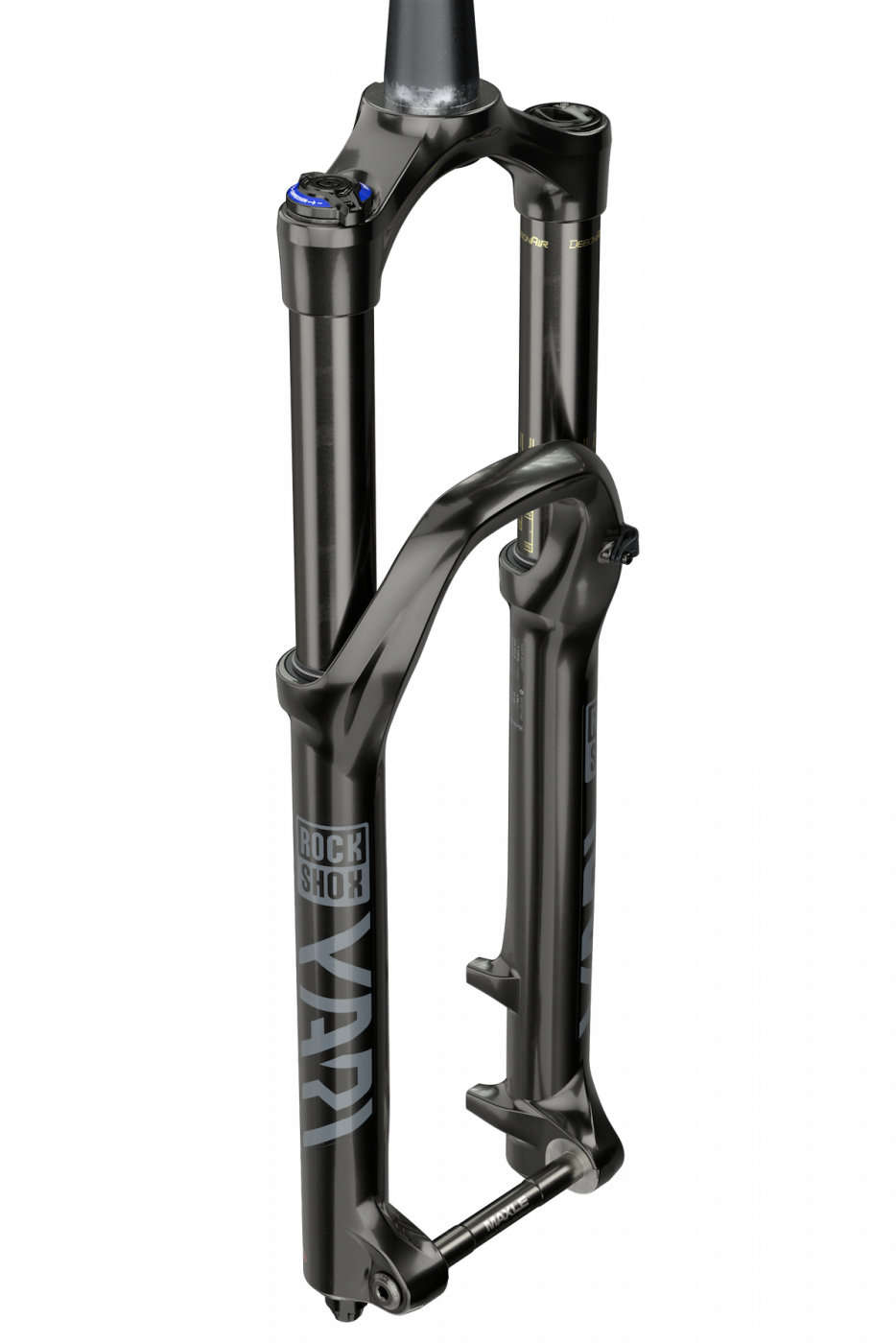

Yari
Yari shares the stiff, hard-hitting Lyrik chassis designed to inspire confidence for those hard-hitting enduro riders and E-MTB riders alike.
YARI RC (FS-YARI-RC-B3)
Yari shares the stiff, hard-hitting Lyrik chassis and combines it with the updated DebonAir air spring and proven Motion Control damper. Designed to inspire confidence for those hard-hitting enduro and E-MTB riders alike.
Features
  • New graphic package for a fresh, premium look
  • Motion Control damping featuring low speed compression adjustment
  • Chassis derived from Lyrik
Specifications
  • Wheel size: 27.5″, 29″, 29″+
  • Damper: Motion Control
  • Offset: 46mm (27.5”), 42mm (29″), 51mm (29″+)
MSRP: $499 | €539* | £479* | *INCLUDES VAT

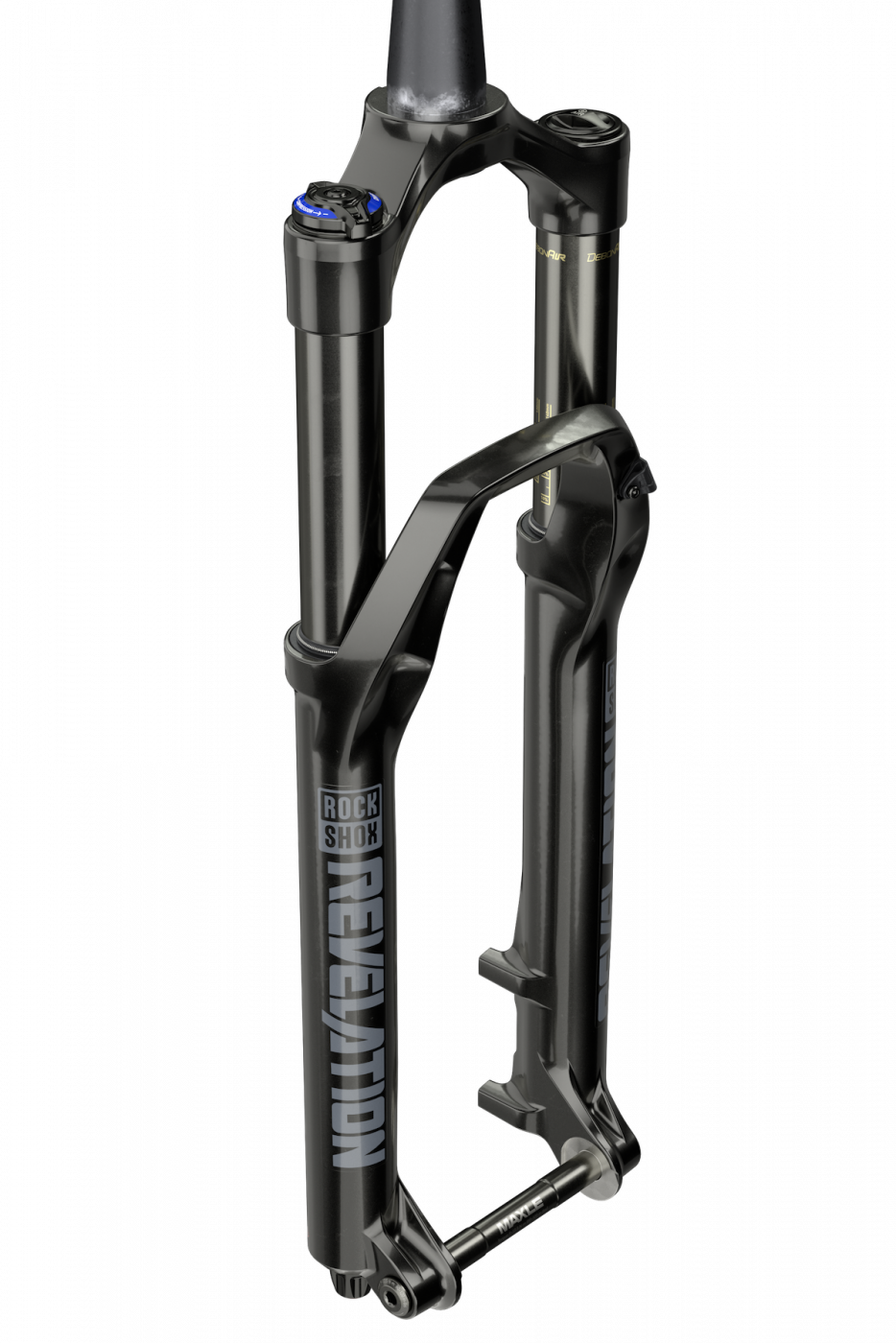

Revelation
With 35mm upper tubes and a chassis derived from Pike, Revelation is ready to tackle the ever-changing challenges the trail may take.
REVELATION RC (FS-RVL-RC-A3)
Revelation is all grown up and ready to explore wherever the trail may turn. Value packed, the Revelation features the updated DebonAir air spring paired with the Motion Control damper and 35mm Fast Black upper tubes.
Features
  • Motion Control damping featuring low speed compression adjustment to firm
  • 35mm Fast Black upper tubes
  • Chassis derived from Pike
Specifications
  • Travel: 120mm, 130mm, 140mm, 150mm
  • Upper tube type: 35mm tapered wall aluminium
