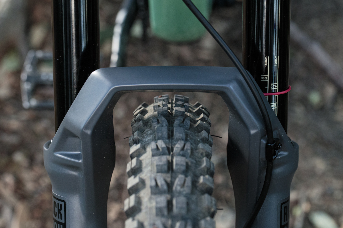

A lean, mean, fighting machine. ZEB’s aggressive good looks add stiffness in all the right places, while maintaining meaningful compliance where required. Even on this heavy-hitting fork, we know gram counting makes a difference. We’ve chiseled away anything extra without compromising the integrity of ZEB’s design.
When The Going Gets Rough, Zeb Plows Right Through It
The new world order of Enduro racing has raised all the limits. Holding every critical line, when it matters the most, has never been more important. ZEB’s new chassis design maximizes bushing overlap. This reduces friction and keeps your fork sliding perfectly smooth. No matter how rough the terrain, ZEB gives you the confidence to plow right through it.

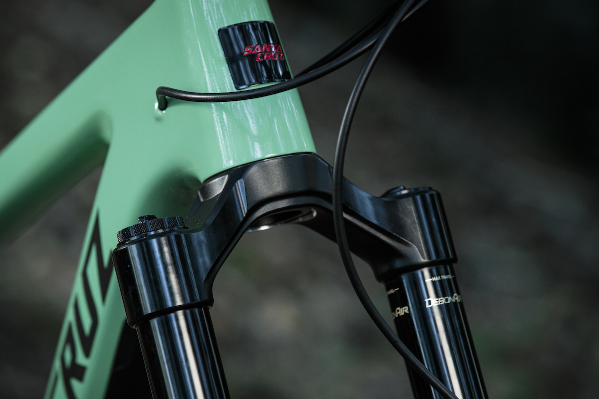

Crown Jewel
Minimal in weight, and tough by design. ZEB’S aluminum crown is built to withstand the elements. Extra durability with added machining shaves away the unwanted grams to keep things light and looking fresh.
Mind the G A P
From full travel to bottom out, mind the gap. With all things going big, the ZEB lower leg arch was designed to ensure plenty of clearance for beefier headtube profiles and our integrated fender.

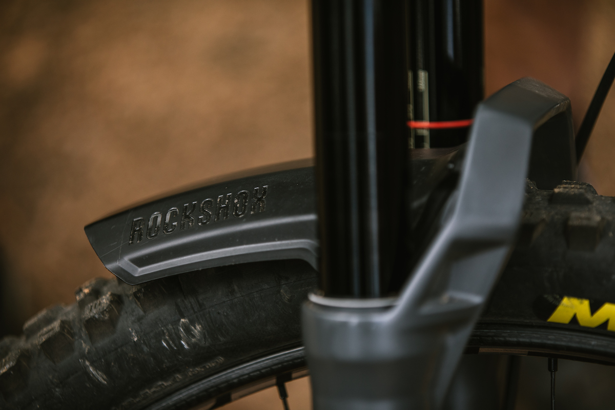

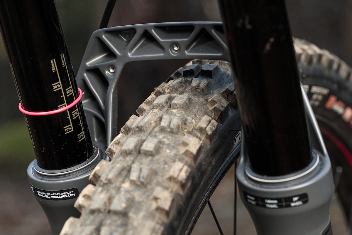

Fender Mounts
ZEB makes fender integration a breeze. Featuring a new RockShox 3-bolt fender, available on all models.

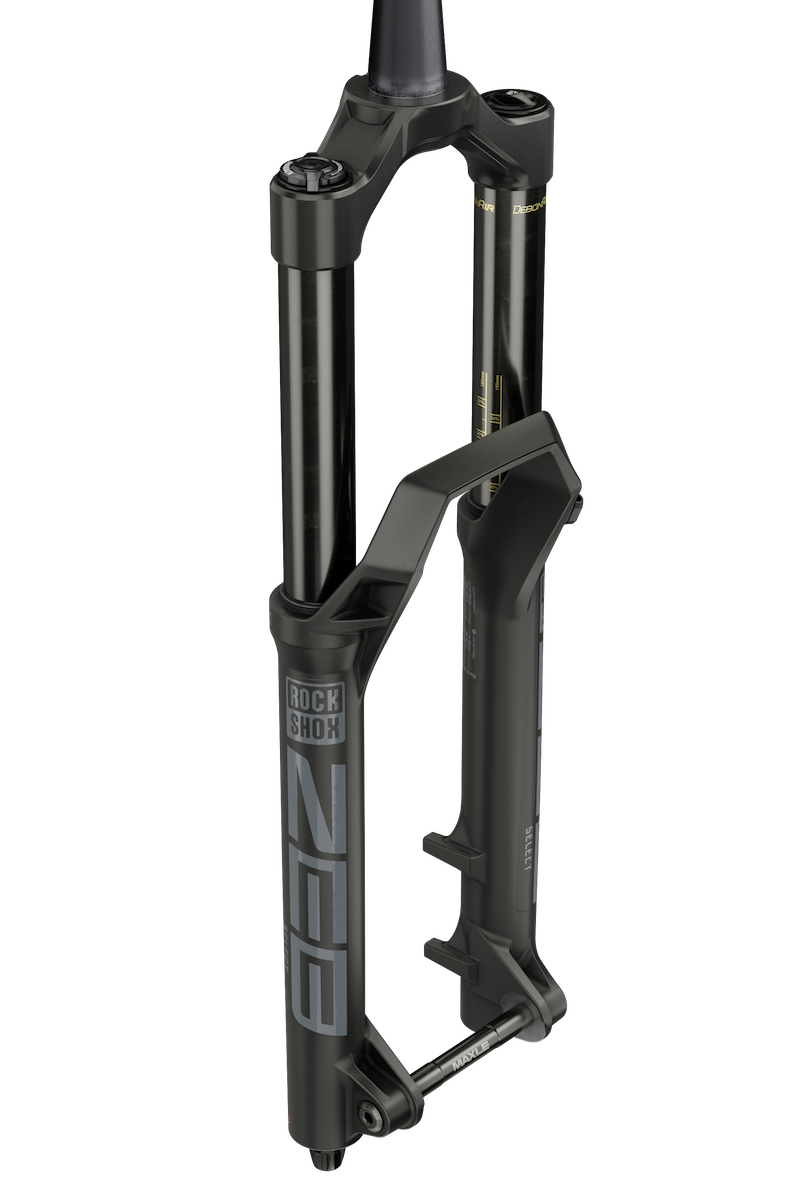

ZEB ULTIMATE
ZEB Ultimate is a whole new breed of fork, designed to challenge the limits and take on the world’s toughest Enduro tracks. Going Ultimate has its advantages. Featuring an all-new stiff 38mm chassis designed with the Charger 2.1 damper, DebonAir™ air spring technology, SKF Wiper Seals, and Maxima Plush Fluid. Our highest performing, athlete-proven technologies matched with premium style plays. An anodized crown and ZEB’s signature colour – Slab Grey – make a rocking debut.
Features
  • New 38mm chassis for increased stiffness and rider confidence
  • Highly-tunable DebonAir™ air spring offers a buttery smooth feel off the top and maintains a higher ride height for increased confidence in steep terrain
  • Our highest performing Charger technology. Charger 2.1 RC2 damper features independent high and low speed compression with rebound adjustment – designed to reduce hand fatigue and fight unwanted friction, the Charger 2.1 damper increases confidence and control over every trail
  • Ultra-low friction SKF wiper seals provide long-lasting fork performance and improve overall suspension feel
  • Maxima Plush damping fluid reduces friction and silences damper noise
  • Available in the Signature Colourway Slab Grey or Ultimate High Gloss Black with foil graphics
  • Short fender compatible (RockShox fender sold separately)

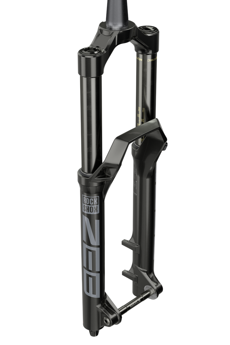

ZEB SELECT +
ZEB is a whole new breed of fork, designed to challenge whatever limits you find. ZEB Select+ features an all-new stiff 38mm chassis designed with the Charger 2.1 RC damper, DebonAir™ air spring technology, SKF Wiper Seals, and Maxima Plush Fluid.
Features
  • Our highest performing Charger technology. The Charger 2.1 RC damper features easy to adjust low speed compression and rebound – designed to reduce hand fatigue and fight unwanted friction, the Charger 2.1 damper increases confidence and control over every trail
  • Ultra-low friction SKF wiper seals provide long lasting fork performance and improve overall suspension feel

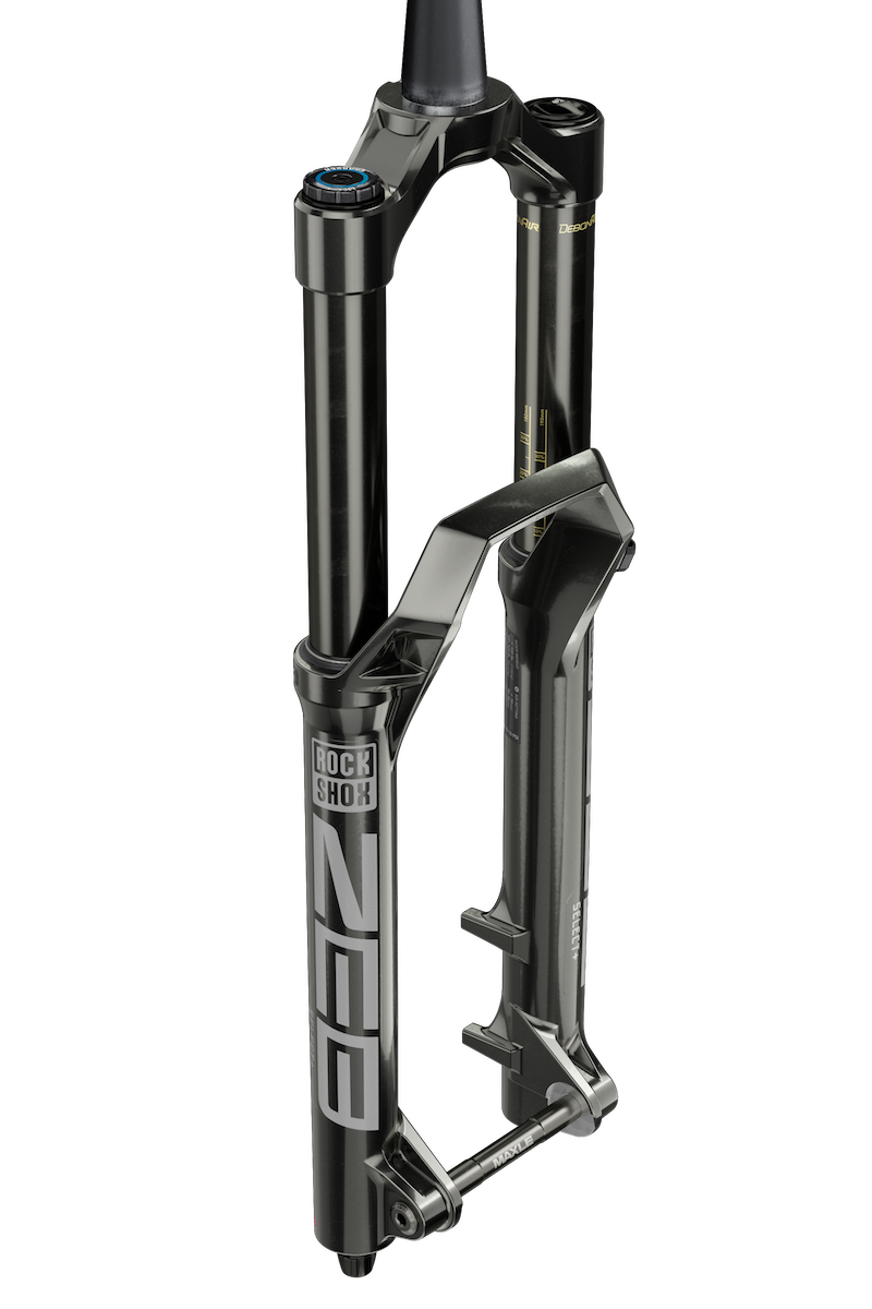

ZEB SELECT
ZEB Select features an all-new stiff 38mm chassis designed with the Charger RC damper, DebonAir™ air spring technology, SKF Wiper Seals, and Maxima Plush Fluid. A whole new breed of fork, designed to challenge whatever limits you find.
Features
  • Charger Technology – The Charger™ RC damper features easy to adjust low speed compression and rebound

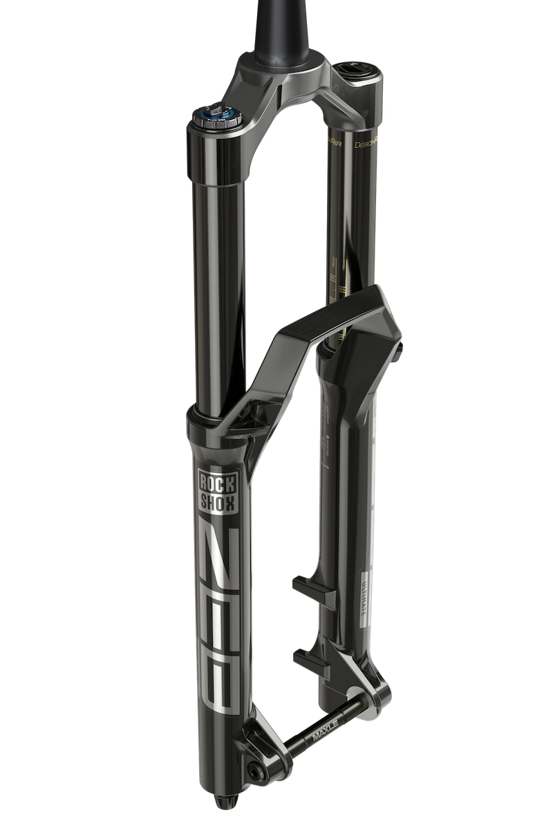

ZEB
ZEB features an all-new stiff 38mm chassis designed with the New Charger R damper, DebonAir™ air spring technology, SKF Wiper Seals, and Maxima Plush Fluid. A whole new breed of fork, designed to challenge whatever limits you find.
Features
  • Charger Technology – The New Charger™ R damper features factory tuned compression with easy to adjust rebound
  • eMTB endorsement decal
