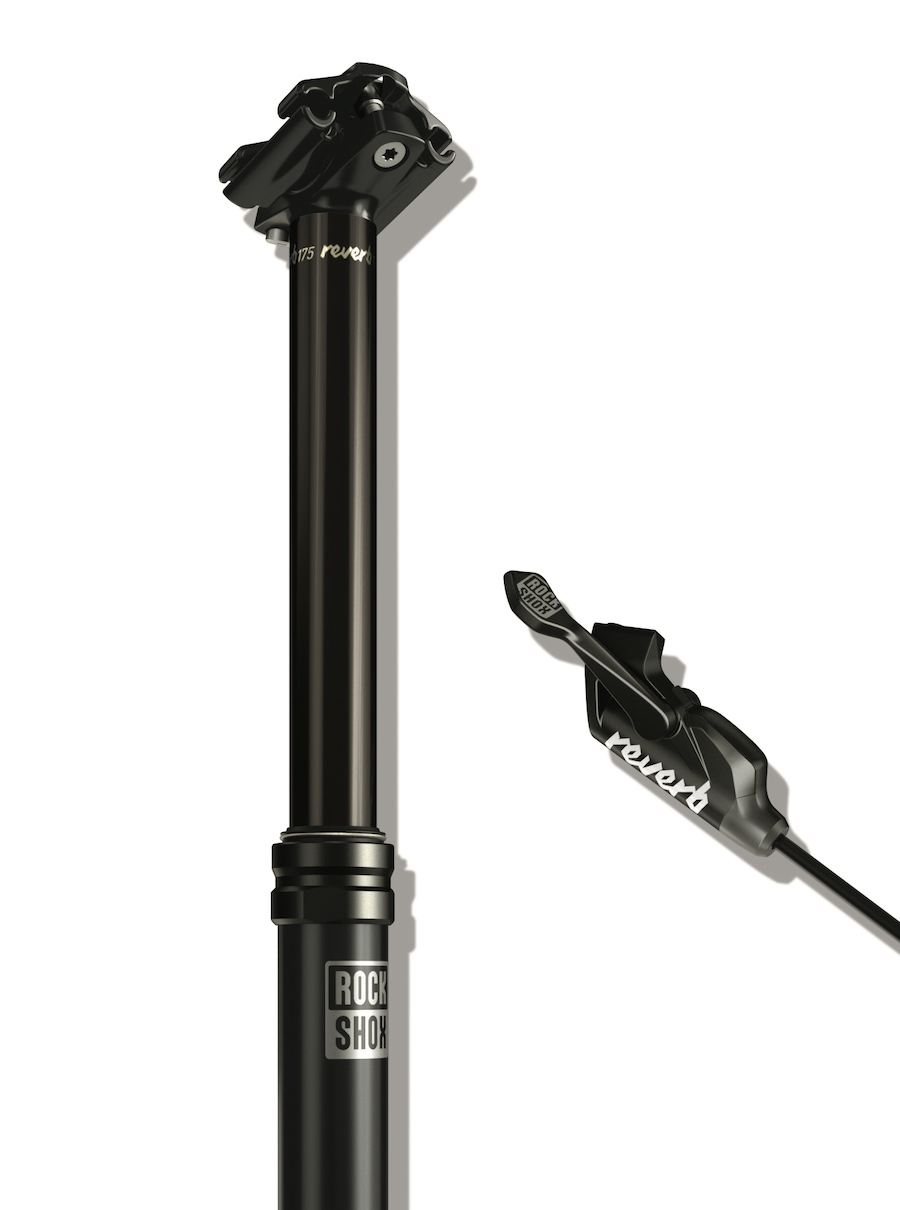

We’ve taken the RockShox Reverb family to new heights, recently with Reverb AXS, and now with the new Reverb Stealth. Redesigned internals provide effortless actuation and increased reliability featuring new Vent Valve Technology. With reduced overall post lengths and new travel options, riders of all shapes and sizes benefit from more travel than ever before. The new Reverb Stealth redefines what it means to simply go up and down.
Features
  • Minimal length for maximum drop. New shorter overall post length allows fit of a longer travel dropper on more bikes.
  • What goes up fast, comes down even faster. New internals decrease the amount of drop force needed by over 50%.
  • New grease, a new Internal Floating Piston (IFP), and new Reverb Serene Fluid developed by our friends Maxima all come along for the ride, reduce friction, and result in faster actuation and return speed in all conditions.

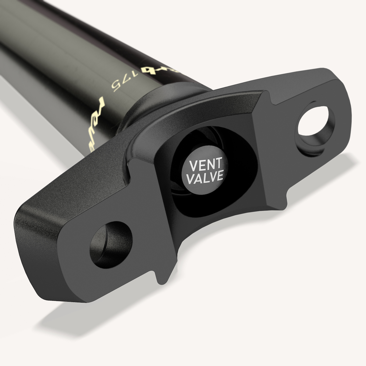

  • New Vent Valve technology, a simple and reliable built-in service solution without disassembly of the seatpost.
  • New Longer travel post options in 175mm and 200mm.
  • Keep it neat. Stealth internal cable routing for a clean finish.
  • Speed adjustment to fine tune the return speed of the post to your liking.
Specifications
Post Diameter: 30.9mm, 31.6mm, 34.9mm
Travel: 100mm, 125mm, 150mm, 175mm, 200mm
Post Length: 301mm, 351mm, 414mm, 467mm, 519.5mm
Remote: 1X, Standard (L-Below, R-Above)

Vent valve technology
We don’t want you to have to use it, which is why we’ve created the most robust seatpost to date. We also know, sometimes the inevitable happens. Over time, air and oil may mix resulting in that annoying post “squish” and the need for additional service. Vent Valve Technology allows you to do this simple service within a few steps without disassembly of the post. Simply depress the Vent Valve, compress the post, and you’re good to go.

How do I use Vent Valve? Do I need to remove the saddle to use vent valve?
The procedure is the same as Reverb AXS, but the Vent Valve is at the top. You must remove the saddle and clamps to use the Vent Valve, but you don’t need to remove the post from the bike. See the Reverb Stealth C1 user manual for the step by step procedure.
How does Vent Valve work?
In certain circumstances, air can potentially swap to the oil side of the IFP. If this happens the seatpost develops “squish.” The Vent Valve works by moving the air back into the air chamber and out of the oil. Depress the Vent Valve, compress the post, and you’re good to go. No disassembly required.
How many times can I use Vent Valve?
There is no limit to how many times you can use the Vent Valve.
