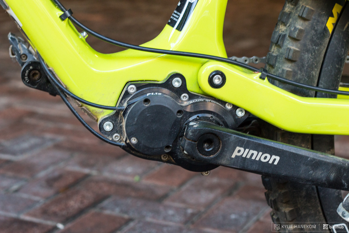

The Pinion P1.12
Pinion came about when two engineers (and mountain bikers) looked at the exposed derailleur gearing system and considered it outdated. With experience from the German sports car industry, they set out to create an alternative.

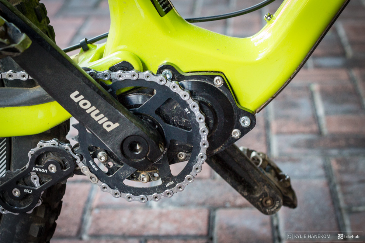

Zerode have opted to use Pinion’s P1.12 gearbox system, designed specifically for mountain bike use, on the Taniwha. The gearbox features 12 gears all equally spaced with a 600% gear ratio, putting it ahead of traditional 2×10 or 1×12 derailleur systems in terms of gear range. Our test bike was fitted with a 30T sprocket and chainring.
The weighty gearbox is placed exactly where you want it, low and centre.

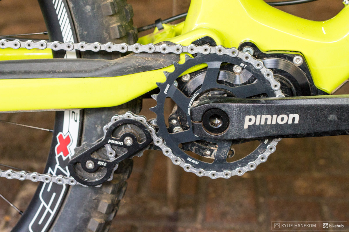

A major benefit of having a closed gearbox system is that there are few external parts to maintain with the exception of the chain, sprockets, and tensioner arm tucked behind the crankset. The result is a drive system that only requires a basic oil change (60ml) every 10,000 kilometres or once a year.
The sealed system means that you no longer have to worry about water, dirt, sticks, and other trail debris getting into the drivetrain. Shifting remains consistent no matter the conditions and there is no fear of grinding your precious parts to death when the trail is damp. There is also no rear derailleur hanging awkwardly between the bike and trail obstacles or waiting to fall apart under the strain of a poorly judged shift.

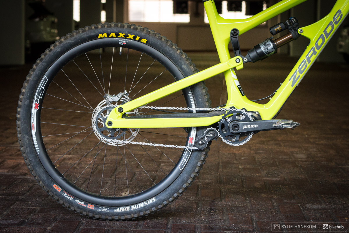

Doing away with the rear mechanics reduces the unsprung mass on the rear of the bike. Pair this with a fixed chain position and the Taniwha should boast excellent suspension performance.
The claimed weight of the P1.12 gearbox is 2,350 grams. While I’m not certain what parts that number includes and how much overlap is accounted for with common parts like chains and sprockets, it is still heavier than its closest rival: SRAM X01 Eagle. That said, the bulk of the Pinion systems weight is tucked low down in the bottom bracket area minimizing the impact of the extra weight. Even with the Taniwha’s full carbon frame construction, our test bike weighed a hefty 16.08 kg.

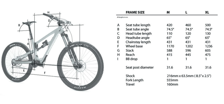

The gearbox drive system aside, the Taniwha meets all modern enduro bike expectations. The geometry is sufficiently low and slack, and although the reach is perhaps not the longest in the game, it still makes for a roomy fit. The bike is attractive in the carbon and gives you an immediate sense of its big mountain capabilities.

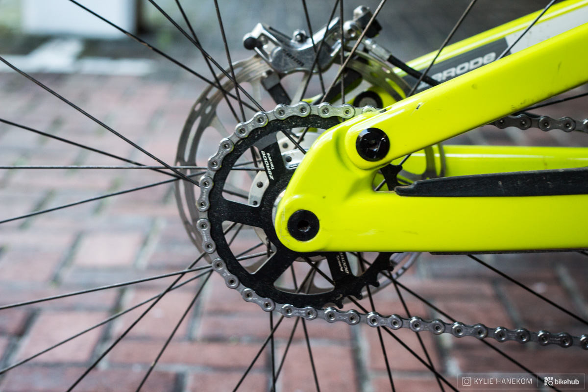

While the fork supported a boost hub, the rear remains 142 mm. Due to not having to accommodate a cassette, a single speed hub can be used to build the rear wheel with a symmetrical dish, making it stronger.

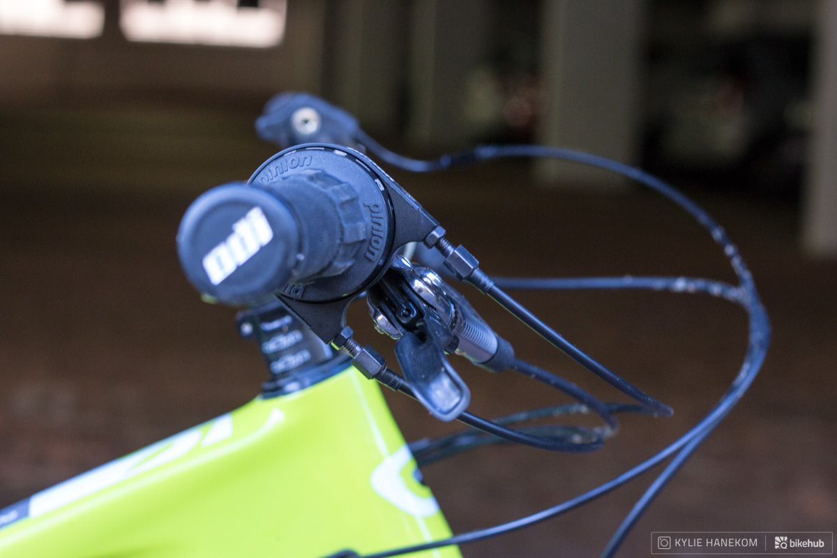

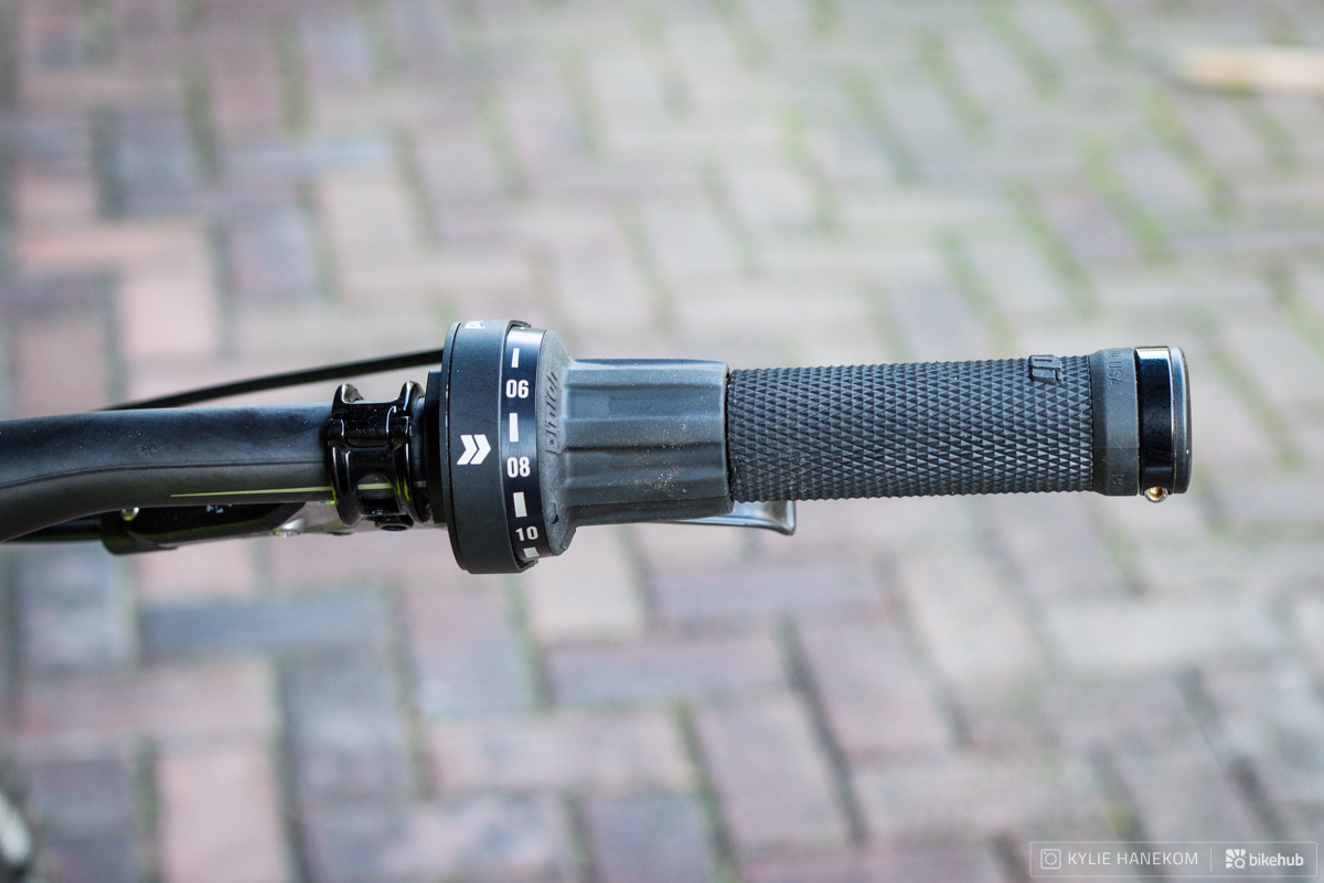

Shifitng is performed via a familiar gripshift system.
While the Pinion system is excellent on the descents, I struggled to appreciate its operation on the climbs. The act of pausing your pedalling while changing gear is severely disruptive to your momentum and cadence, especially on technical climbs.
The Pinion P1.12 shifts gears through a grip shift system which functions very well. One nitpick is that it is hard to shift gears while covering the brakes: at least I was unable to master the technique.

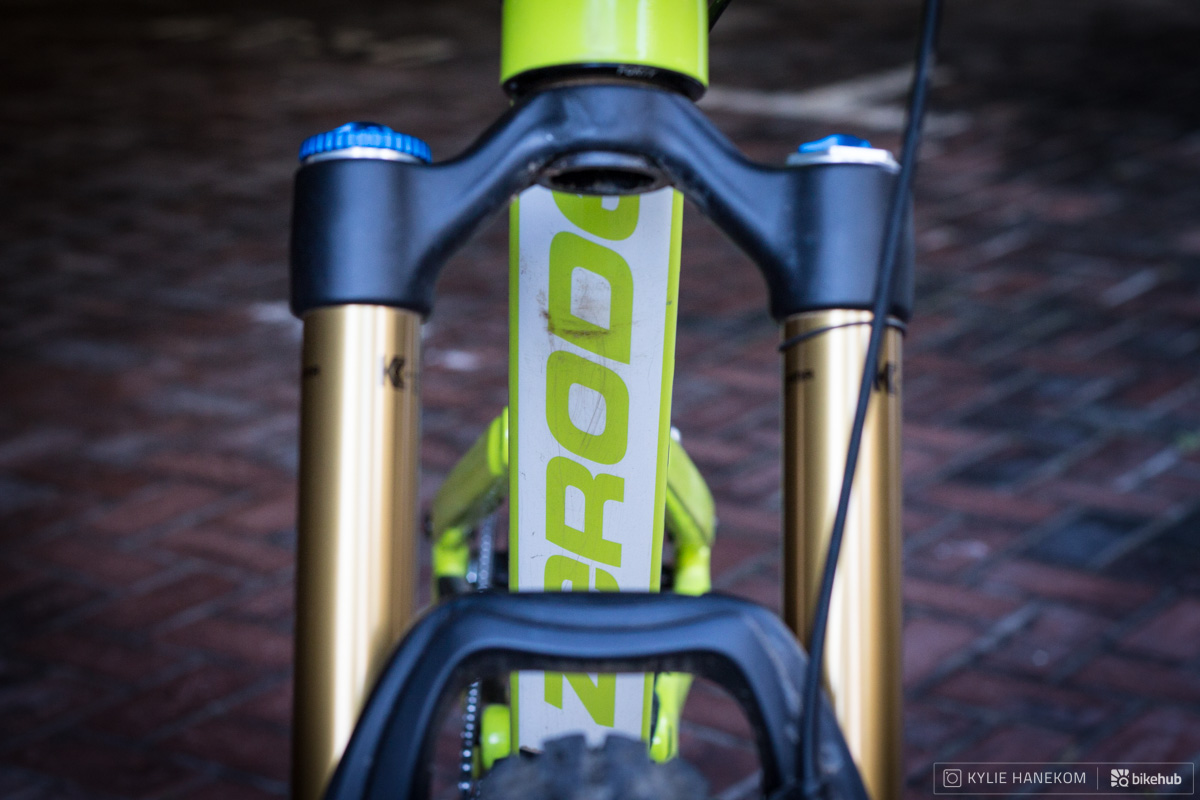

The specification choices on our Taniwha test bike complemented its ability. The Fox Float X2 embraced its newfound freedom and outperformed my expectations with the Fox 36 continuing to prove itself as a world class fork.
