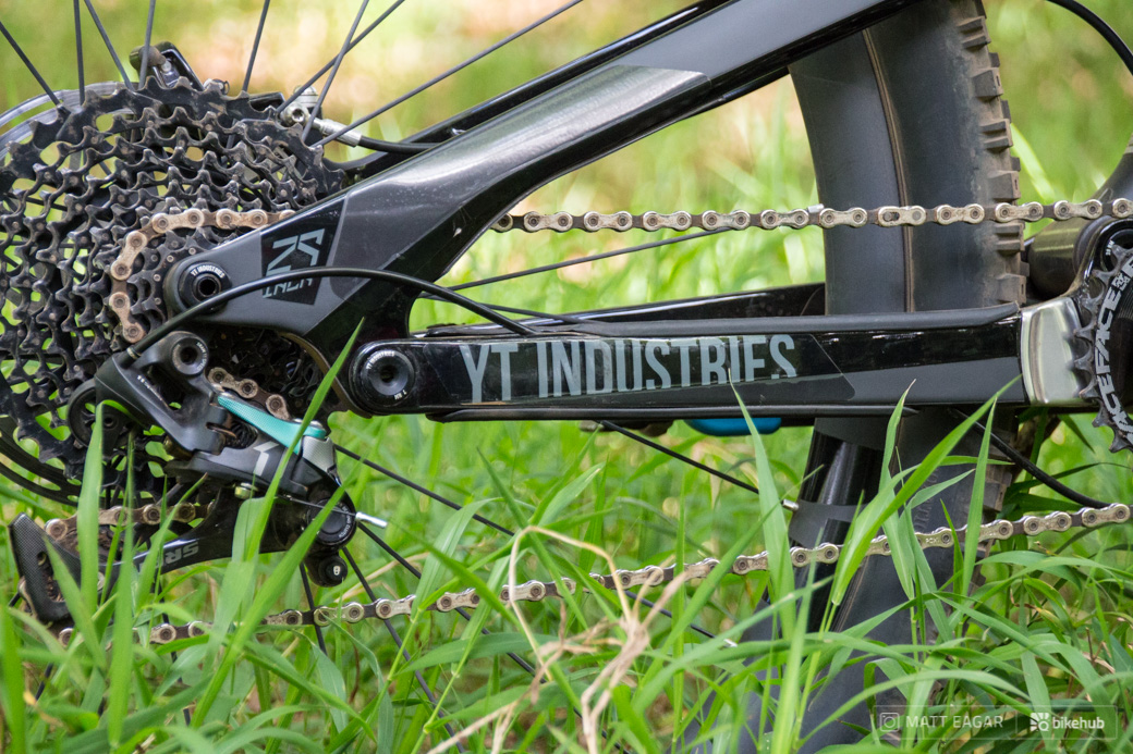

The Jeffsy is a 140mm trail bike designed around 29-inch wheels. While the Jeffsy looks similar to the Capra, it does appear as if the bigger brother hogged all the food, giving the Jeffsy a more slender build. Unlike the Capra, there is no strut between the down tube and seat tube supporting the linkage. The rocker link bolts are also very neatly hidden under the seat stay. This has freed up some space in the front triangle to fit a small water bottle. The mounting and bottle can be added to the bike at checkout and did not come with our test bike.

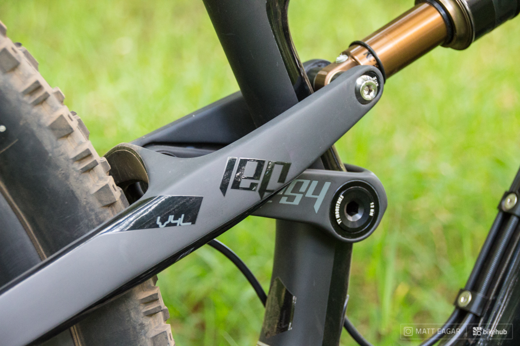

The Jeffsy makes use of the same Virtual 4 Link suspension found on the longer travel Capra and Tues. The design uses a pivot just in front and below the rear axles with the seat stays connecting to the seatpost with a short link on their way to the shock mounting. As expected from a YT bike, the suspension travel is progressive with easy movement through the mid travel and support ramping up close to the end of the range.

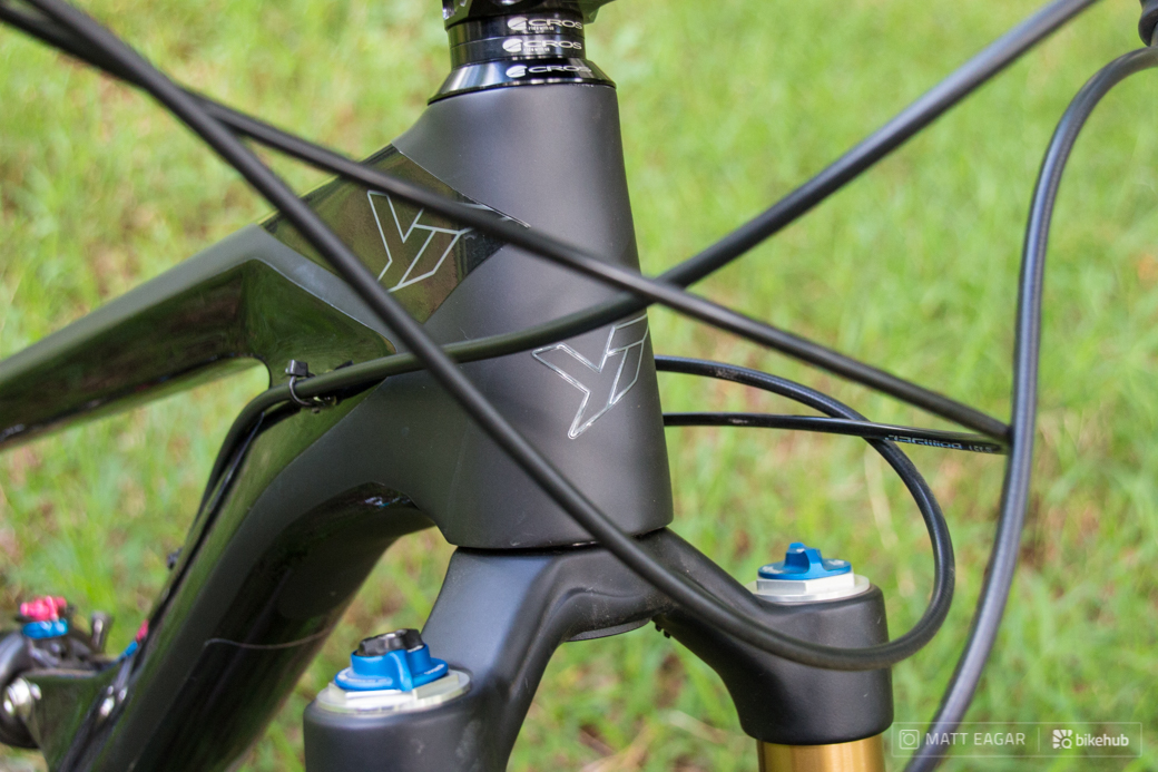

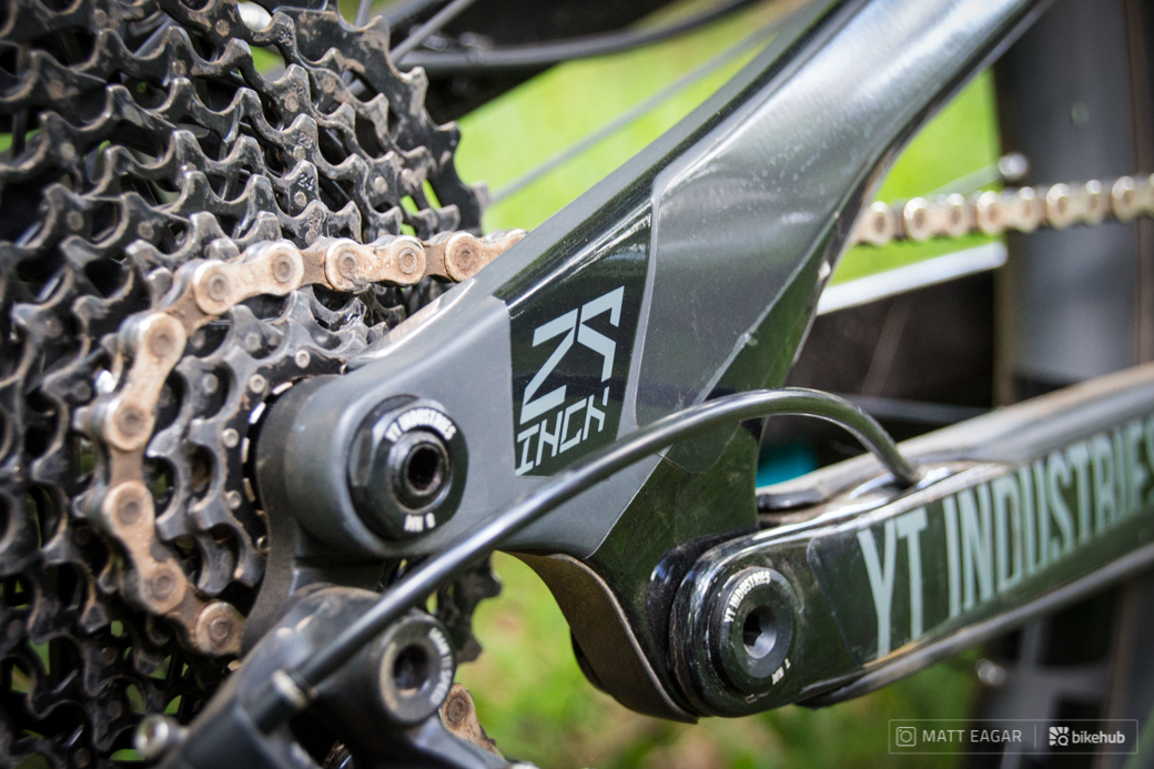

The Jeffsy is bang up to date making use of Boost 148 rear axle spacing. Interestingly, YT has decided not to go Boost on the front axle, meaning the front wheel is not as stiff as it might have been. Not that I noticed any unnecessary flex, to be honest. Cable routing is mostly external with the exception of the path through the down tube for the rear derailleur. The drive side seat stay comes with a useful integrated slap guard. There are no ISG mounts for a bash guard but in single chainring mode, the front derailleur mounts are suitable to run an upper chain guide.

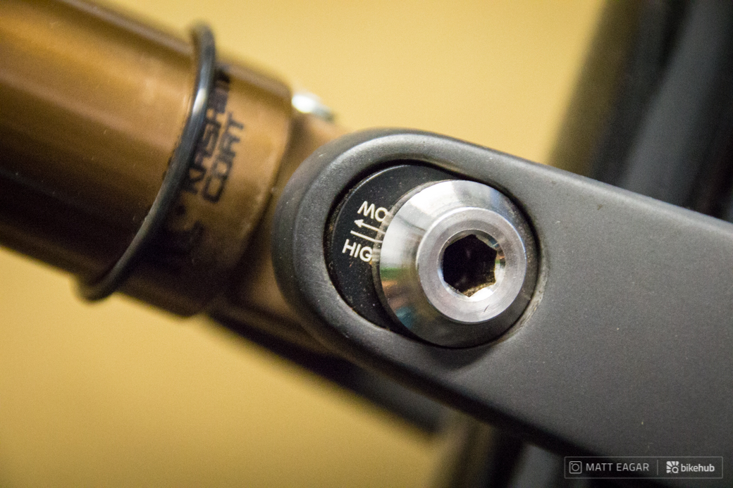

The Jeffsy’s geometry can be adjusted using a flip chip that changes the bottom bracket height, head angle, and seat tube angle. In the high setting, the head angle sits at 67.6°, bottom bracket drop is 24 mm, and the seat tube angle is 75,3°. In the low setting, the head angle slackens by 0.7° to 66,9° with the seat tube angle at 74,7° and the bottom bracket is lowered by 8 mm. The idea is to have a better climbing, more agile turning bike with better clearance in the steep setting. Flipping the switch should turn the Jeffsy into a slightly more capable bike for rowdier trails, but makes it a touch more sluggish on the ups.
ccs-62657-0-81560400-1486989520.jpgThe Jeffsy flip chip found on the shock mount in the seat stay is used to adjust the geometry.
The flip chip forms part of the shock mounting at the end of the seatstays. To change it between modes requires the removal of the mounting bolt. While a relatively simple task, it does take a couple of minutes and is not ideal for constant changing on a ride.

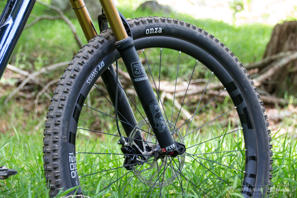

Fork: The Fox 34 plays a difficult role as a trail fork filling the gap between the purpose built 32 and 36 forks. While not as light as an XC fork, it’s also thinner than the beefier 36 all mountain fork. There is, however, little sign of compromise in the 34 and I was able to confidently take on any piece of the trail without the fork feeling out of its depth. I know there will be those that cry out for a 36 on this bike but I really did not see the need.

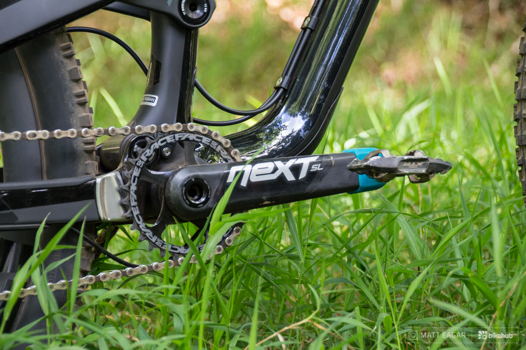

Drivetrain: The SRAM X01 drivetrain with a Race Face Next SL crankset is not an uncommon combination and has proved to be reliable. The top of the range Jeffsy CF Pro was revealed just after the announcement of SRAM’s 12 speed Eagle groupset, meaning it was a tight squeeze to specify the bike with these components. This, however, has been addressed and the updated CF Pro now boasts X01 Eagle components.
Wheelset: The wheelset is a carbon pair of DT Swiss XMC 1200 Spline. The wheels proved to be tough with predictable steering and excellent power transfer. The carbon rims played a huge part in the feel of the bike. The inner rim width is 24 mm which some might expect to be too narrow but in reality, I never felt like I needed anything wider.

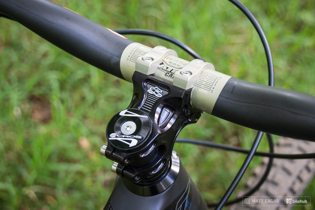

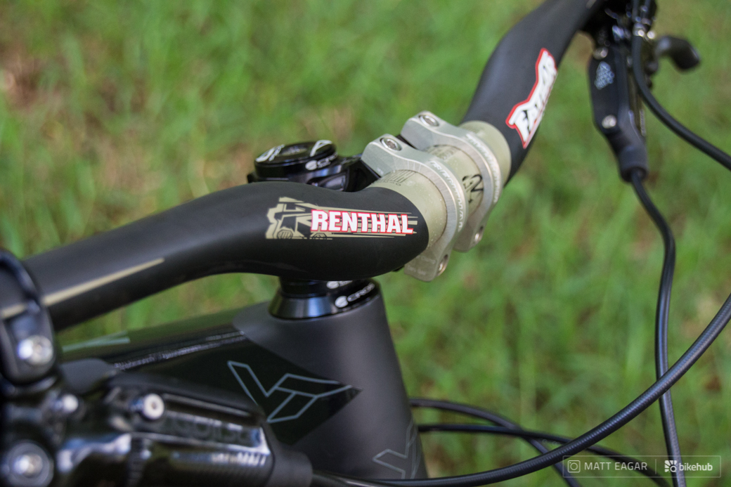

Controls: The Renthal Fatbar is a reminder of the gravity roots of YT Industries and signals the type of riding this bike is built for. The 780 mm width and 30 mm rise is spot on for my tastes and is paired with suitable length 60 mm stem in the large and extra large sizes (the medium and small get 50 mm stems). The CF Pro features a RockShox Reverb with a healthy 150mm of travel, the small size is a bit shorter at 125 mm.

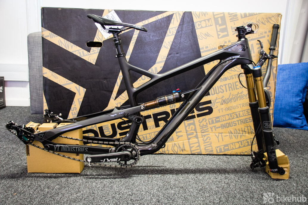

This does, however, mean that you need to unbox and build the bike yourself. While I can’t think of a better way to get to know your new bike, I acknowledge that not everyone has the time, skills, or interest for the job. Thankfully, YT Industries have given this a lot of thought and have made the process (almost) fool proof.
When you cut the tape and open the box, an instruction manual sits on top. The manual is very clearly written with picture examples to guide you through the build. Pulling the bike out the box, you’ll notice that it can stand freely on the cardboard cut-outs attached to the front and rear axles, creating a bike stand to build the bike. YT have done their best to set up the bike in their factory but they leave the fitting of the wheels, rear derailleur, handlebar, and pedals (not included) up to you. Some adjustment might be needed to the brakes and shifters to get your preferred angle of attack.
