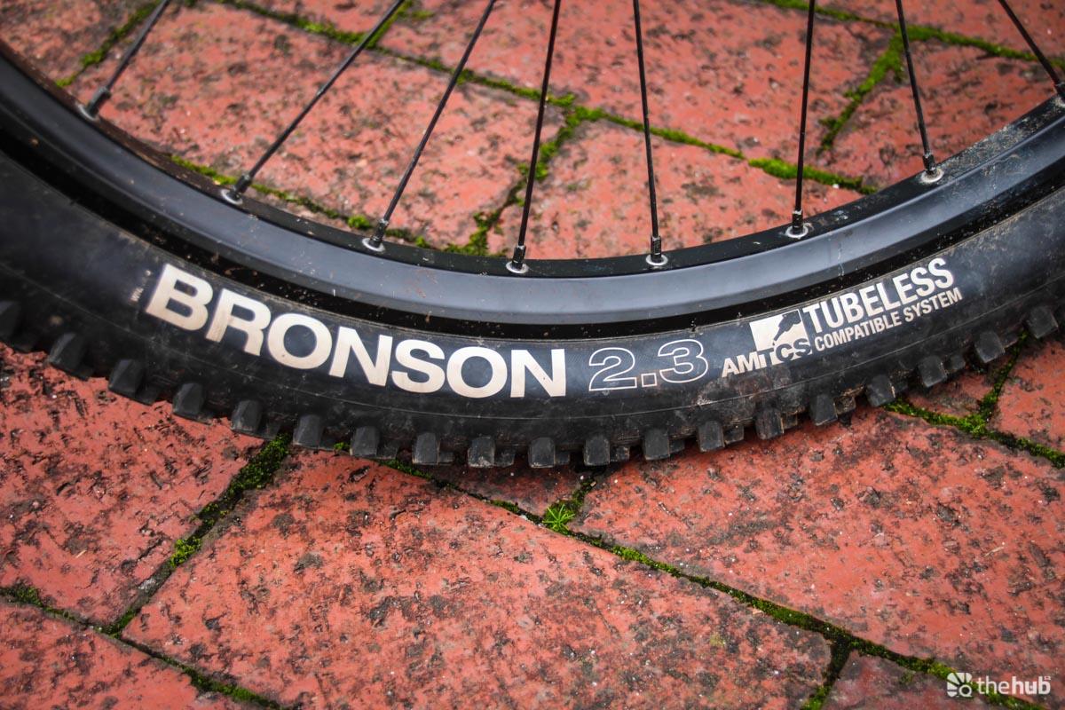

Bronson 2.3 AM TCS
The Bronson is toted as being able to handle a wide variety of terrain, from hard packed to muddy and a few others in between. It doesn’t have the more popular square shaped knobblies that many manufacturers have opted for recently, but sticks with WTB’s traditional V-shaped kind for the sides and ramped centre knobs for less rolling resistance. The entire Bronson TCS (Tubeless Compatible System) line features dual compound rubber, meaning the centre is a harder 60a while the sides are a softer 50a. This makes the centre better for rolling and the sides grippier, obviously, and aids in durability.
WEIGHT: 825g
COMPOUND: Dual DNA (60a/50a)
CASING: All Mountain 60 tpi
BEAD: TCS aramid
TIRE SECTION WIDTH: 54mm
TIRE OVERALL WIDTH: 59mm
Terrain
I would have to agree with most of the marketing claims of the Bronson being a tyre for diverse conditions, but certainly not all. I had my fair take at muddy conditions in Contermanskloof, having basically no tyres at one point with mud caking everything. But the Bronson slogged of the mud really well thanks to the well spaced knobs, and held its own in the wet surprisingly well. The side knobs were great for this.
Wet roots and rocks didn’t cause too much concern for the Bronson, being predictable with it’s grip. Where it fell short was in really loose situations. Sand made it wash out quickly, as it would most tyres, but it wasn’t predictable. It became quite hairy when riding on really loose conditions like small rocks over hardpack. Again, most tyres would struggle here, but the Bronson just didn’t cope. On a few occasions I only just managed to get a foot out in time so as not to see my face in the trail. Unlike in most of conditions, the Bronson was not predictable here, letting go at a moment’s notice.
Durability

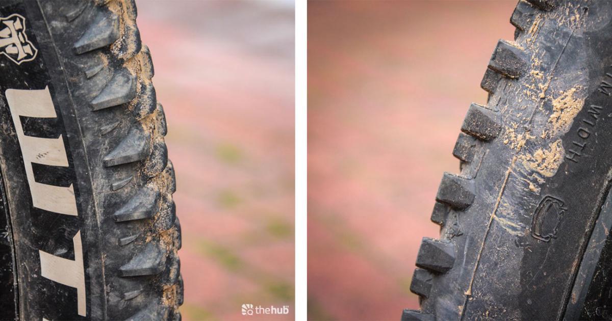

I’ve been riding the Bronson for a few months now in a variety of conditions – even, dare I say, on the road a couple times. The side knobs looked at first like they wouldn’t be down for too much abuse as they stick out quite a bit and are very soft. But I have to say, they have held on admirably despite being heavily siped about half way through the tread. The middle, harder compound has also worn well so far, giving just as much grip as it has from the beginning.

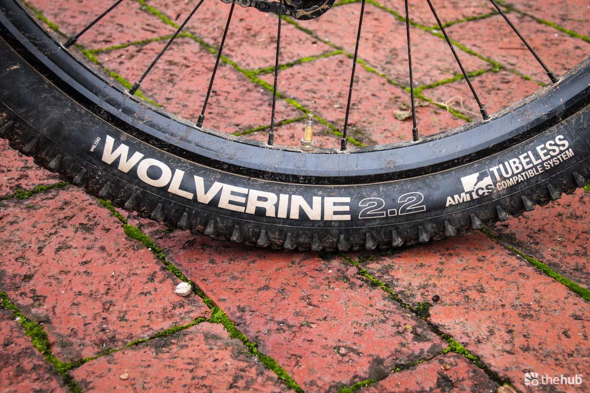

Wolverine 2.2 AM TCS
Like the actual wolverine of the Siberian tundra, these tyres are meant to pack a big punch for their slight profile. They are definitely sharp-looking treads, presumably like a wolverine’s mouth daggers and has a distinct arrow tread pattern and quite a round profile. Like the Bronson, it is supposed to be able to handle a variety of terrain, from dry to damp, from hardpack to loamy. Also like the Bronson, it is the TCS option, featuring a harder 60a centre compound with a softer 50a outer compound.
WEIGHT: 810g
BEAD: TCS aramid
TIRE OVERALL WIDTH: 52mm
It’s quite a fatty tyre for a size 2.2, having the same section width as the 2.3 Bronson. Not only that, but it’s quite tall too, which helps with the cushioning and allows for less air pressure needed in order to protect the rim.
Terrain
I found that the favourite terrain of the Wolverine was relatively hard and damp, where it could dig into the ground enough but also not be overwhelmed. It tended to get filled by mud rather quickly, and the moderately spaced treads didn’t do the best job of chucking off the slog. During techy climbing in loose conditions, the Wolverine struggled a bit to keep traction, spinning here and there, but nothing too bad.
In all but the loosest conditions, the Wolverine kept up very well with the Bronson and when it did lose traction it did so predictably and in a gentleman-like fashion. It only let go sharply once, but that was on a wet wooden bridge, so there’s not many points to be deducted there. Considering its slight profile, it packed a ton of grip and was very controllable on the descents.
Durability
Perhaps not surprisingly, but the side knobs of the Wolverine have shown the most wear out of the two tyres. It must be all that hero cornering I’ve been doing. It isn’t that they won’t last much longer, quite the contrary, but the sides have shown some depreciation. The centre has held admirably. The wear hasn’t affected the performance, though, and I can see many more rides happening on the Wolverine.
