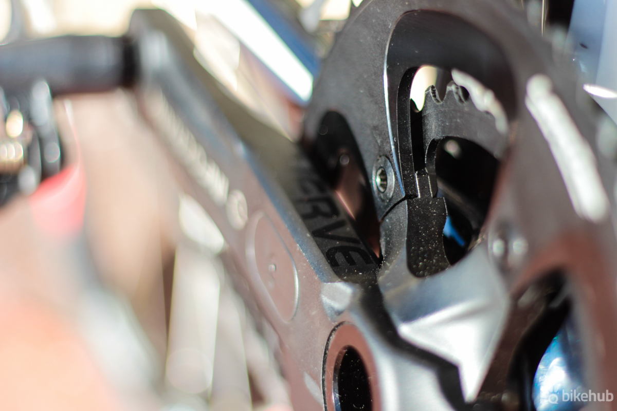

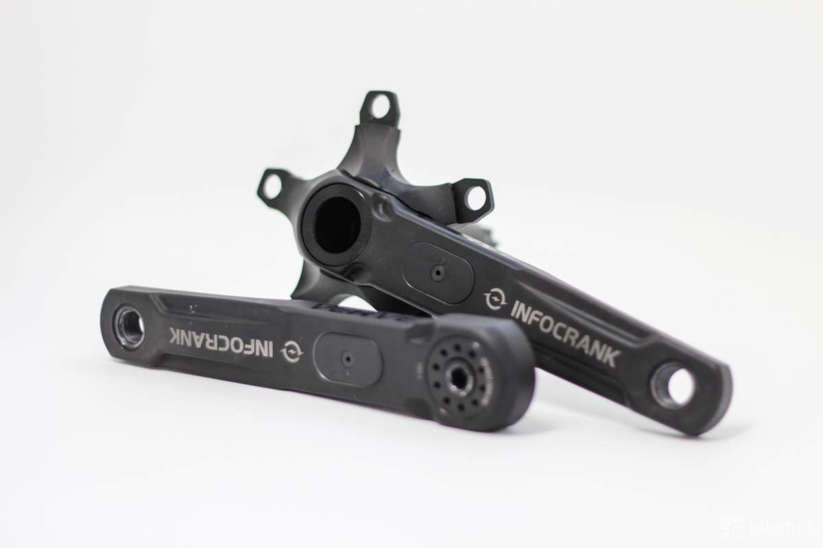

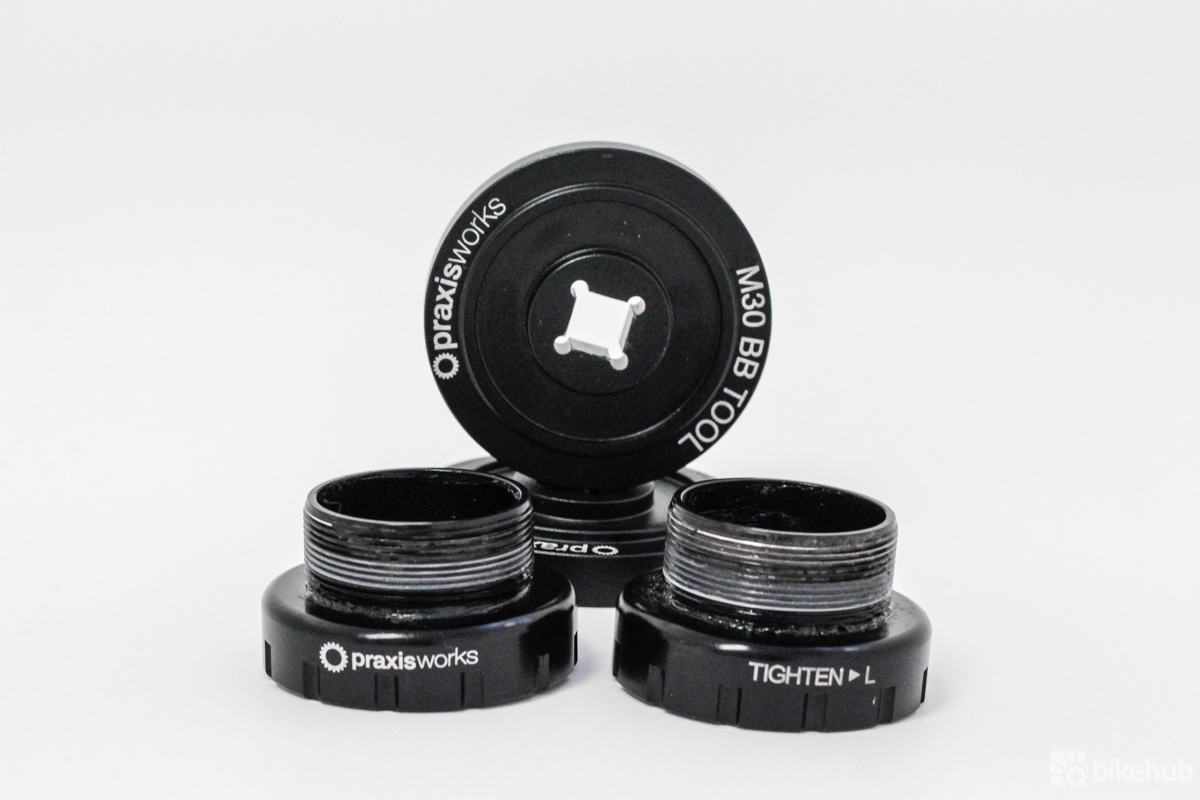

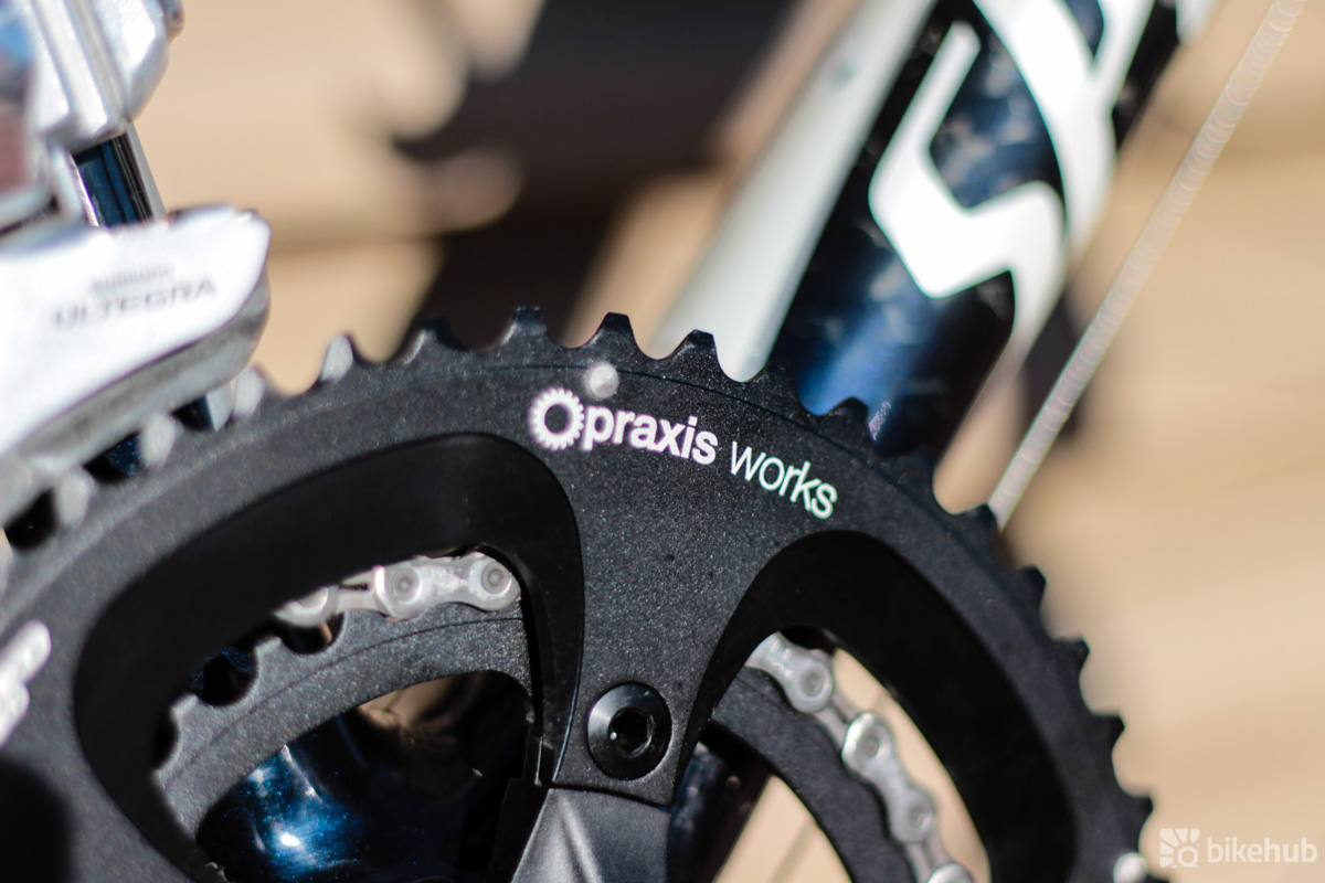

The InfoCrank unit includes the crank arms (available in 170, 172.5 and 175mm), Praxis chainrings (Compact 50/34 or Mid-Compact 52/36) and Praxis M30 Bottom Bracket (options for BB30, PF30, OSBB, BSA, BB86 frames). The crank spider has a standard 110BCD which means you’ll easily find aftermarket rings if those ratios are not to your liking. Also included is a BB tool for the Praxis BB – a nice touch since it’s a unique design.

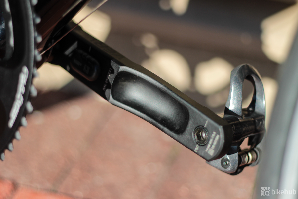

Installing the InfoCrank is no different from a typical standard bottom bracket and crank, which if you’ve got the required tools is fairly straightforward. For our test a threaded BB was used which was easily installed with the included BB tool and a rachet. From here fitting the cranks themselves requires only an 8 mm allen key to secure the non-drive side crank onto the spindle.

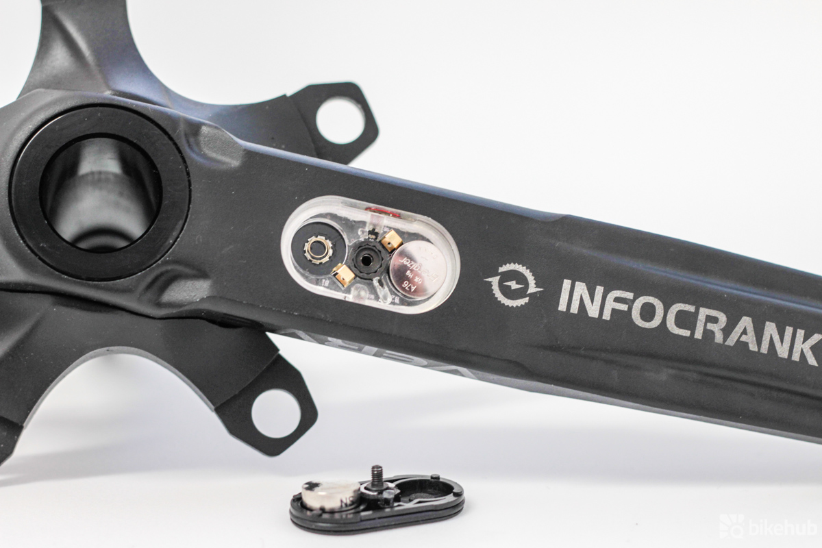

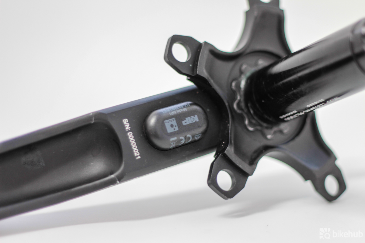

The battery compartment for each crank arm is easily accessible on the outward side of the cranks allowing for easy replacement by the user. Each crank requires two SR44 (Silver Oxide) batteries which, although not that commonly available, InfoCrank say are good for 500 hours and are key in maintaining accuracy over time. From my experience these aren’t readily available at the typical stores you might expect to find standard watch batteries. The more commonly found and same sized LR44 batteries will power the unit as a quick fix, but Verve say won’t give the same level of accuracy as the SR44s as these batteries degrade over time. The best would be to stock up on the SR44 type which are available from various sources online and specialist retailers.

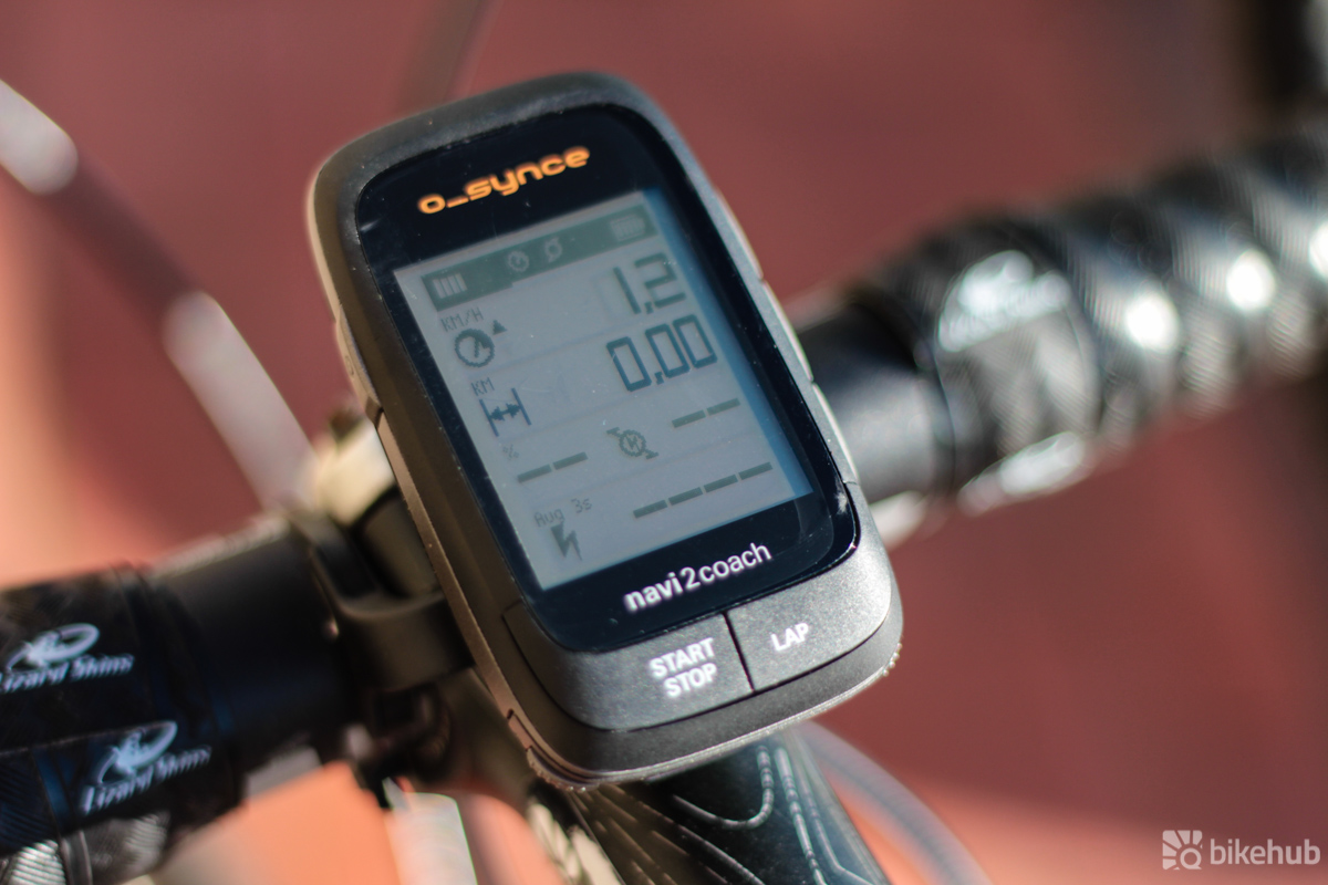

The InfoCrank speaks ANT+ and should be compatible with most power capable ANT+ head units. Our test model arrived with the navi2coach GPS unit, which does not come included but is available via the same local agent as either a complement to your InfoCrank or a standalone, fully functional GPS computer (price at the time of publishing: R 4180.00). For the bulk of testing though, I had the InfoCranks paired with my trusty Garmin 510.

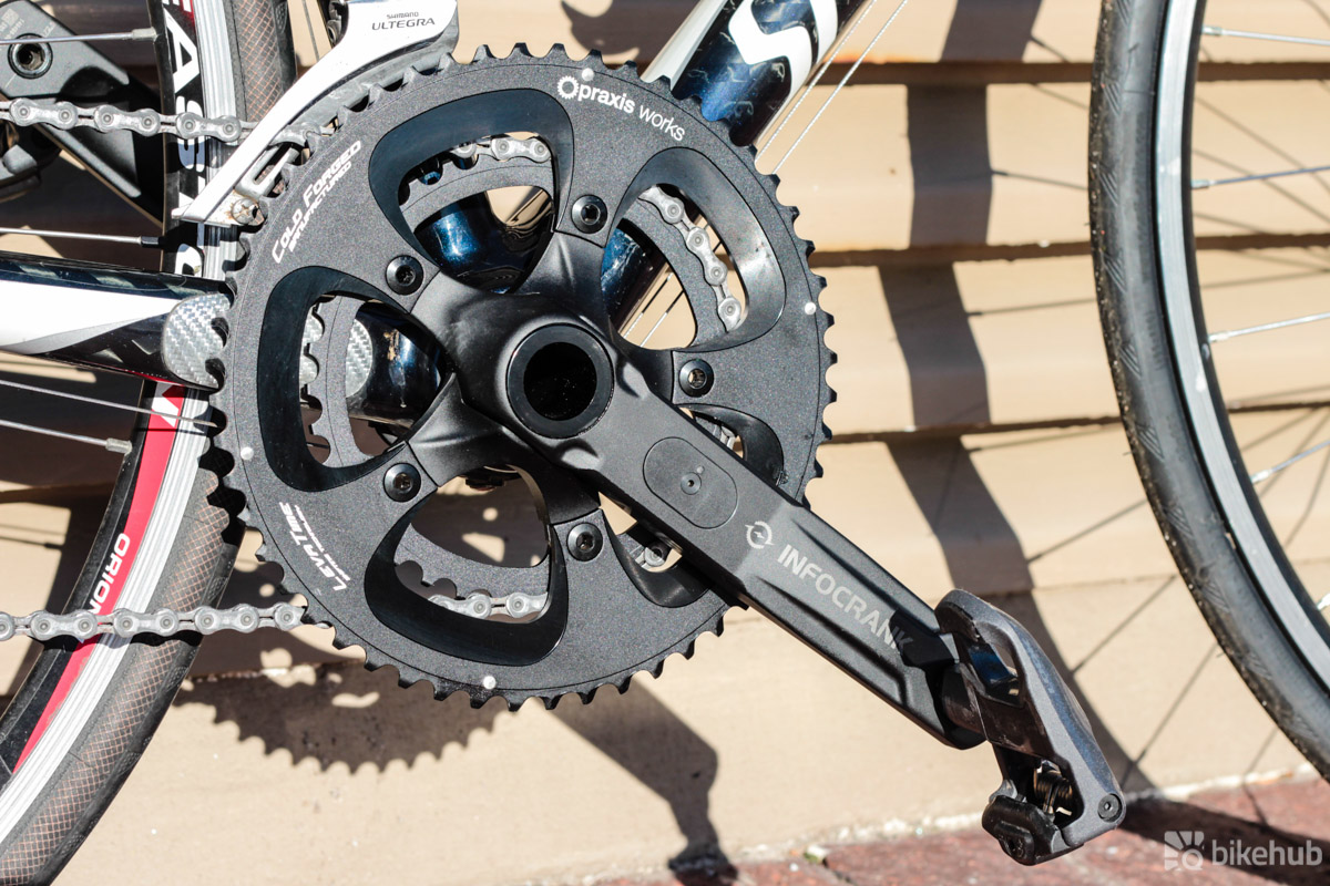

Before stepping into the world of power, let’s take a more superficial look at the InfoCrank. Aesthetically the cranks ooze function over form with a chunky, industrial feel. Although I quite like the sturdy matte black look, the forged alloy cranks may not be to everyone’s taste. And no, they’re not available in carbon.
